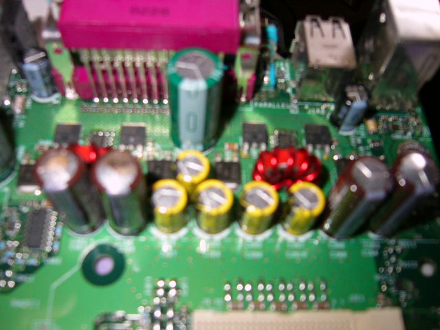

    i got one for free today. they said it worked...
    i looked inside:
    time to order caps!

    KZGs from the blurry looks of it..
    combined with a hot-running P4 -> bad idea

        yup, we have blown kzg, likely dried kze, and 2 nihicon hm 2002 caps.

                ...likely dried kze...
                KZE are not bad caps. they are as reliable as the other japanese brands. It's only KZG and KZJ that can't handle any heat.
                    i was told they are heat sensitive. they are replaced in the msi k7t-turbo kit for a reason...
                    if not, then i'll leave them alone.

                      watch out for electrolyte on the vrm chip near those blown caps.causes a no post.cleaning with a bit of carb cleaner and a toothbrush does the trick.
                        Re: dell dimension 4550
                        the vrm chips are clean.
                        ill replace the kze to be safe.
