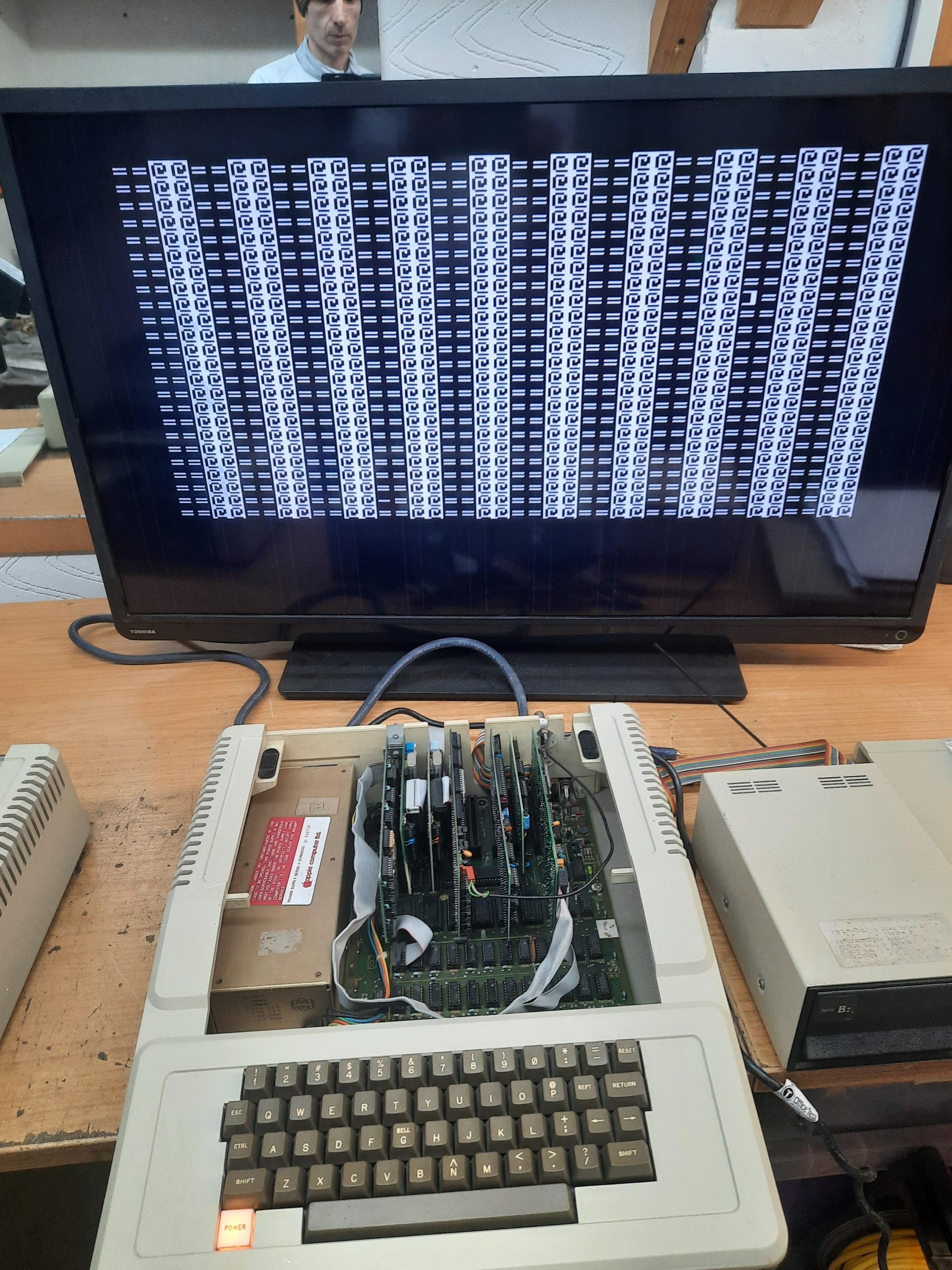

      Re: Apple 2 europlus , characters on screen help
      Thanks , will do
      • zen
        • 511
        Suspecting RAM issue , as you suggested .
        Pulled out all the RAM chips , cleaned pins & re-seated .
        Still characters on screen , but altered .

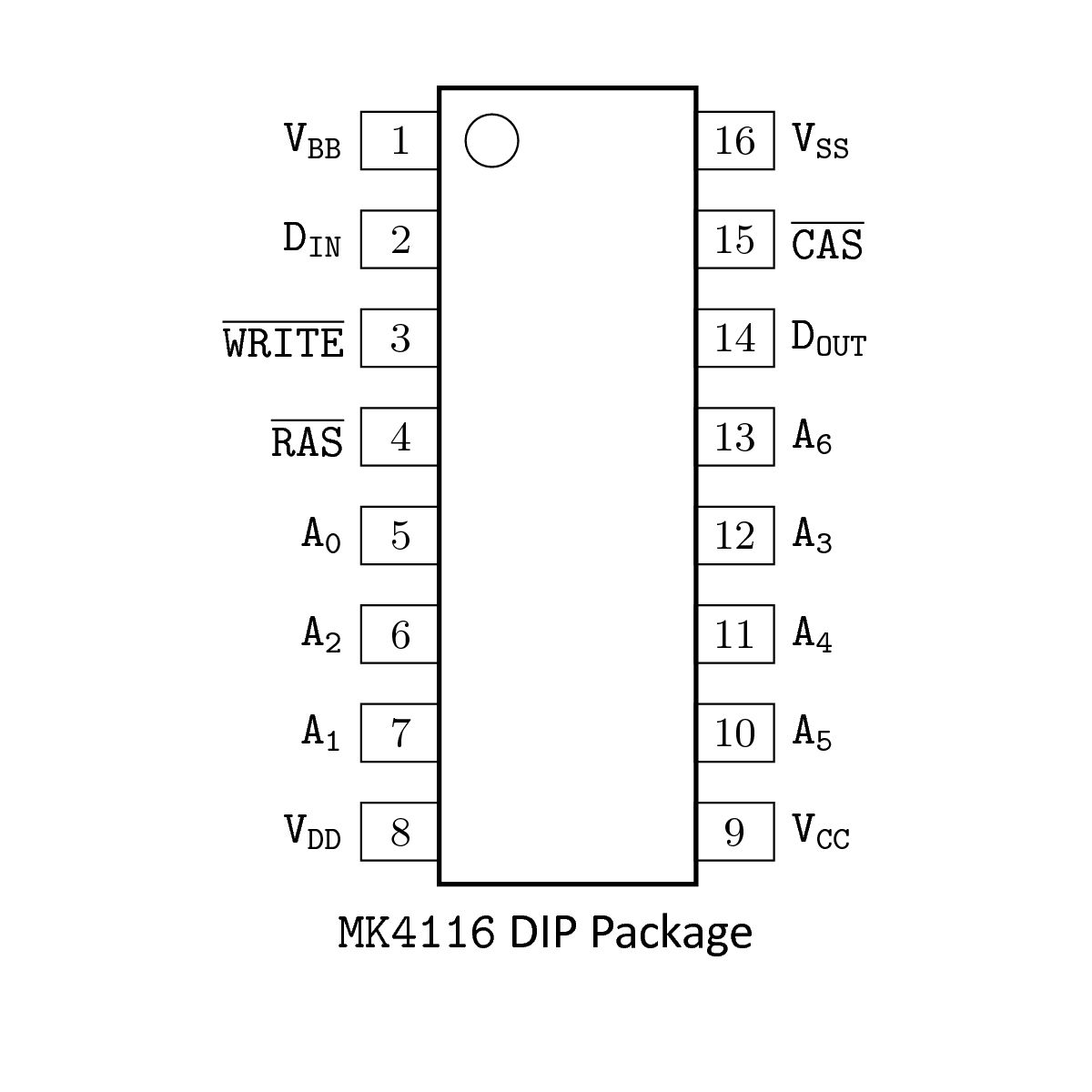

        Anyone know a trusted source for RAM chips ?
        Type MK4116N-3 GP

          4116 needs 5v, 12v and -5v
          before you replace any - check those voltages.
          if any are missing, it can kill the chip.
          also touch each chip while it's on - bad chips often get VERY hot.

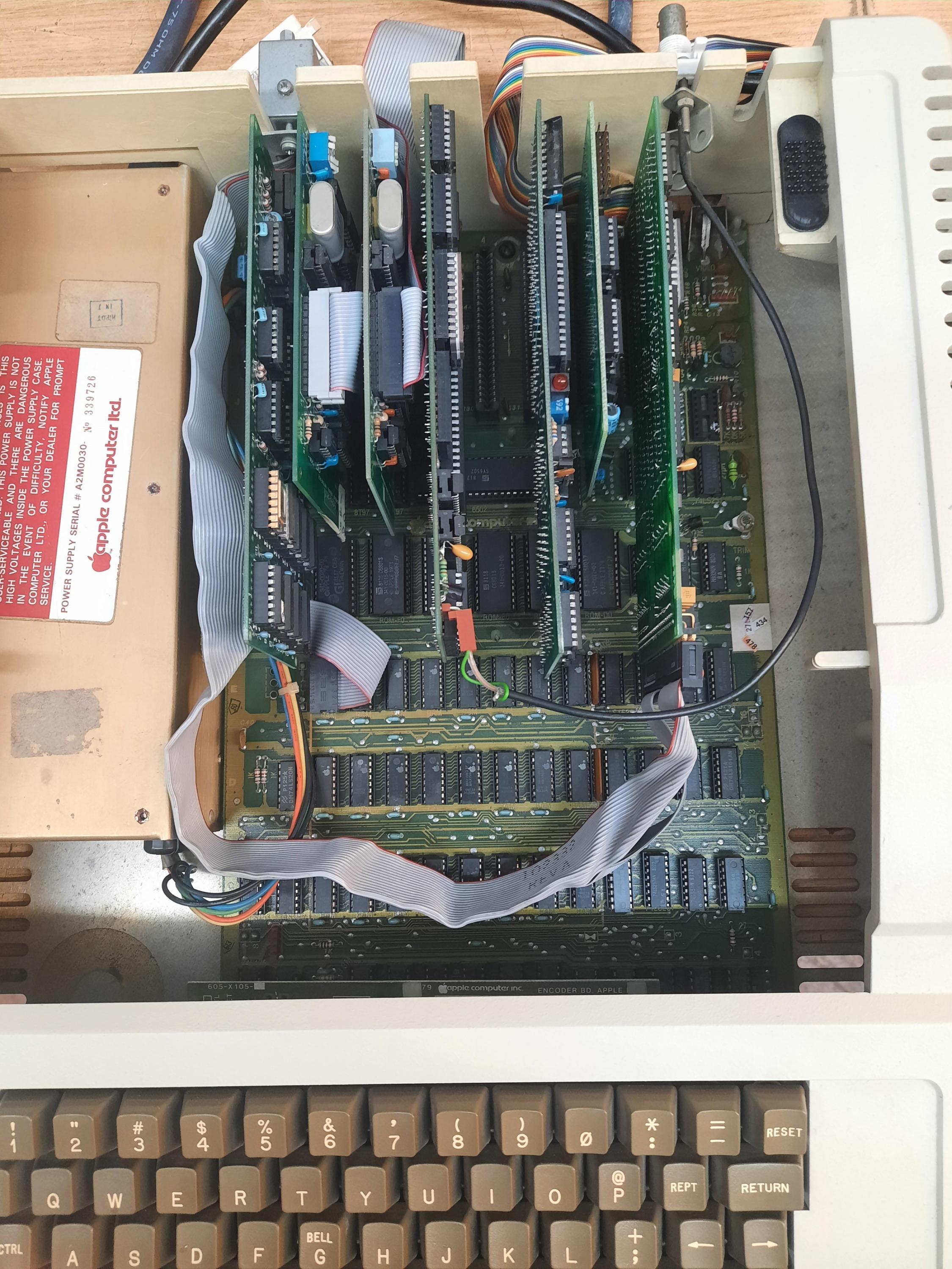

              I see a lot of ICs in a lot of sockets... so that's a lot of failure points, especially in this age. Might be a bit tedious, but probably worthwhile to remove every IC and make sure the contacts in the sockets are clean and tight, then re-insert the IC. These aren't machined sockets, so they tend to not be as good.
                Thanks for the info .
                Have tried already with all the RAM chips , cleaning pins , plus spraying out sockets using switch cleaner .
                    printed out pin out of RAM chip .
                    PIN 1 ( VBB ) MINUS 5 VOLTS
                    PIN 8 ( VDD ) PLUS 12 VOLTS
                    PIN 9 ( VCC ) PLUS 5 VOLTS
                    I assume supplies are common to all the RAM chips .
                    Customer ordered 4 RAM chip for me , therefore will have a play .
                              Tester arrived & seems to work quite well .
                              Detected 4 faulty chips , which i replaced using ones ordered by customer without the GP at the end .
                              Repaired a further 2 working chip , by adding pins , where the legs fell off .
                              No strange characters on display now & Apple logo present .

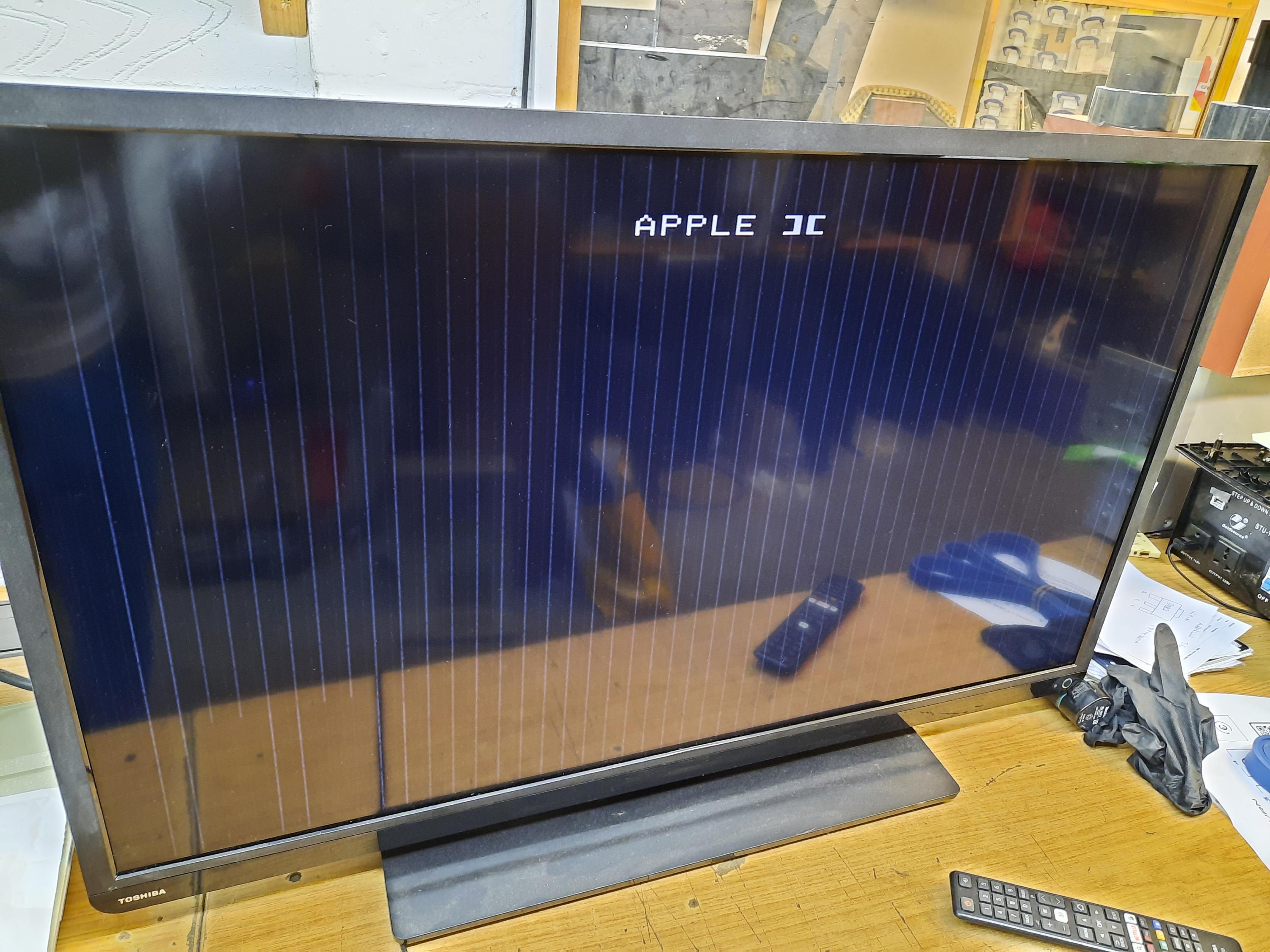

                              Issue now is that there are horizontal lines on display .
                              Any advice ?
                                • 31291
                                that still looks like a vram problem - or the associated circuits.
                                got any multiplexers like 74ls157, 158, 257 or 258 on the board?
                                  I see vertical lines.

                                  • zens electronics
                                    • Jan 2021
                                    • 31
                                    • uk
                                    Yes sorry , meant vertical .
                                    Will check out suggestions .
