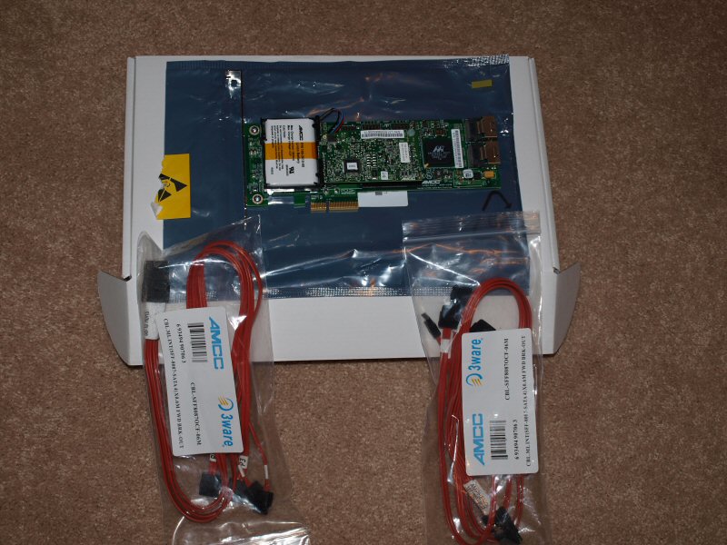

          The 3ware 9650 and its goodies arrived a few mins ago!!

            The 3ware controller in its box:

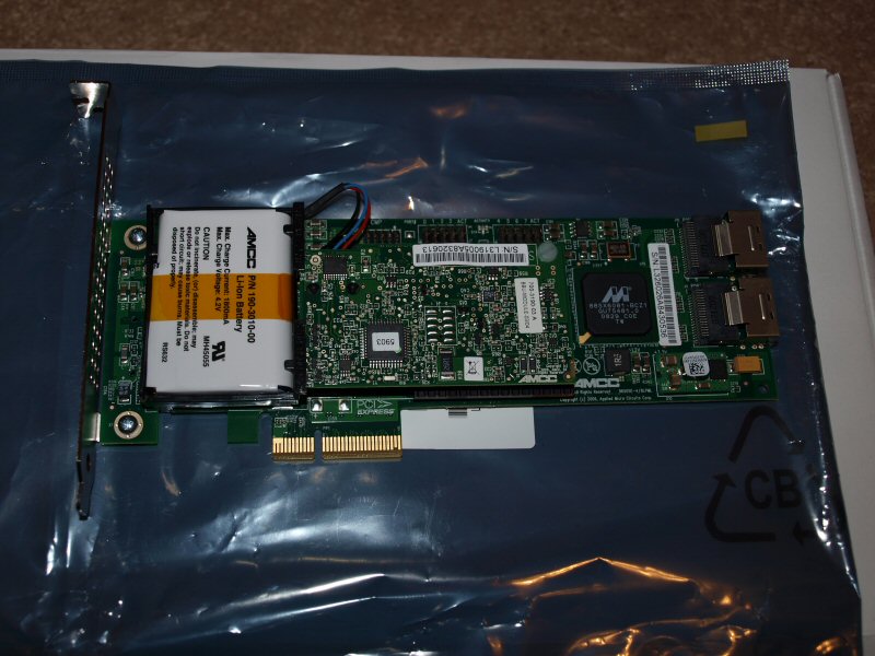

            Out of its box:

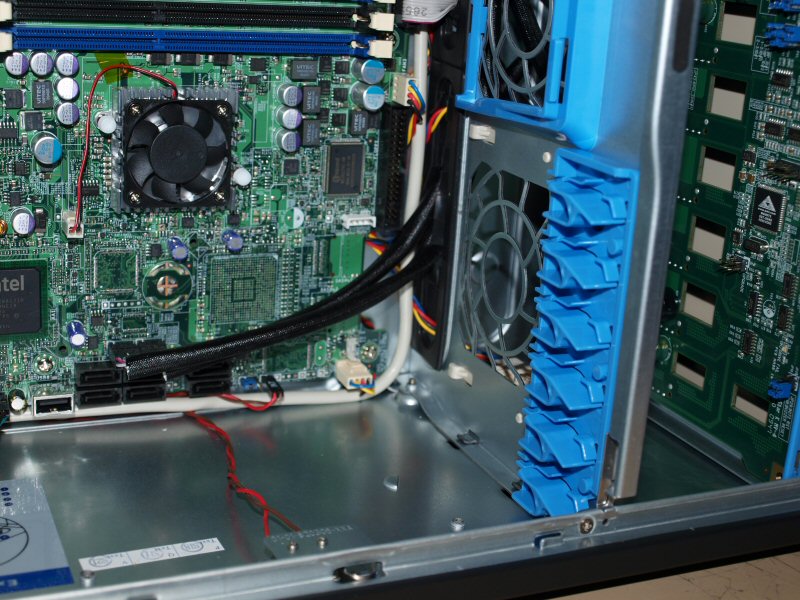

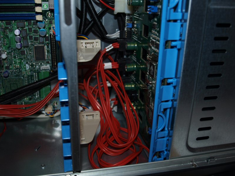

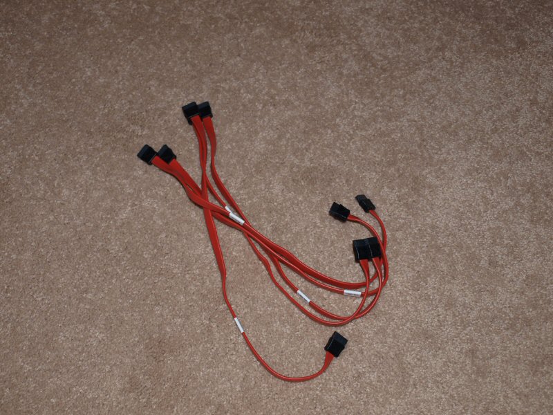

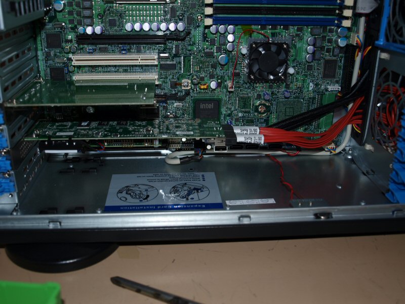

            Removed cables from Supermicro to the SAS backplane (not needed, the 3ware has proprietary cabling):
            Adios onboard raid....its good enough to run opticals, thats it:

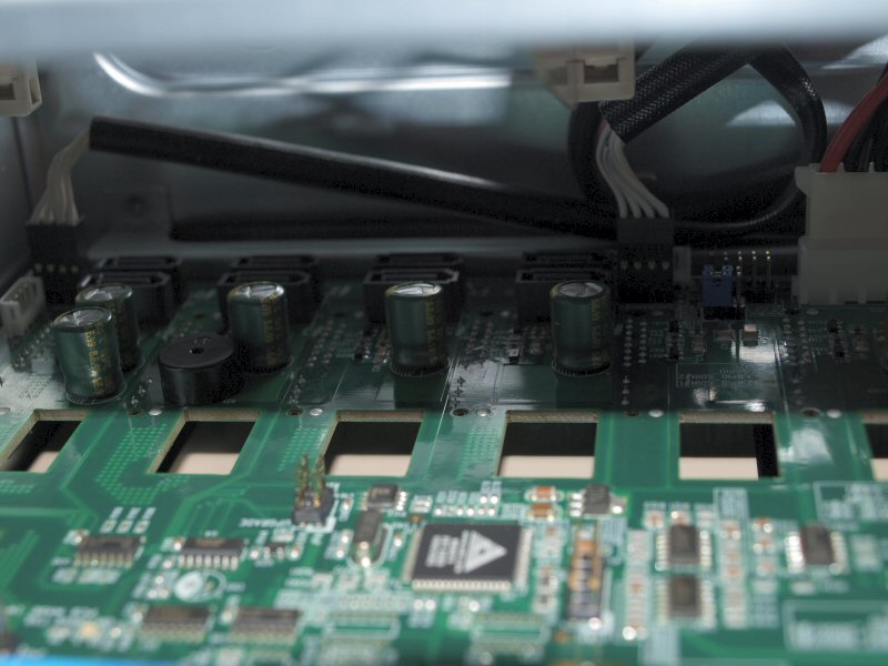

            SATA connectors on the back of the SAS backplane:
            Getting messy looking:
            That looks kinda sexy. The PCI card is a USB2 card. My only gripe about this system, its lacking USB ports. Only 2 in the front and 4 in the back, so I added the extra card:

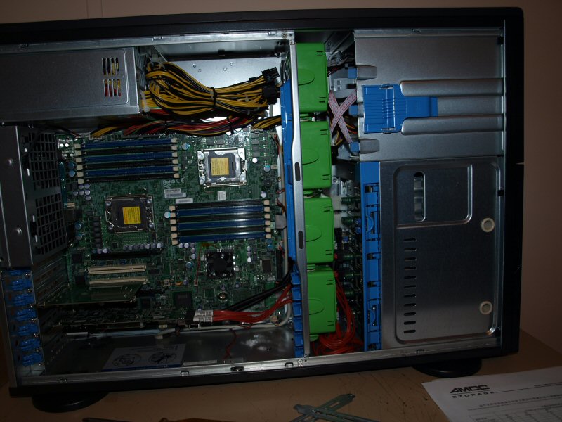

            Fans back in place:

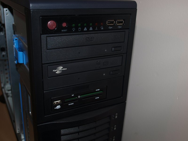

            Nifty card reader and those opticals again:

              why does the raid-card have batteries?
              i'v noticed batteries on some scsi raid too, but never knew why.
              • 370forlife
                Large Marge
                • Aug 2008
                • 3112
                Re: HMMM....What could this be....
                They have a CMOS that keeps settings like the mainboard. I think that big of battery may also keep the data that is on the card's ram/buffer too.
                • Topcat
                  The Boss Stooge
                  • Oct 2003
                  • 16958
                  No battery is required for the controller to retain its RAID configuration, but as you said, it will prevent dataloss if the system crashes or power is lost. it is an optional feature for the card, I just thought what teh hell, why not get the whole works....
                  The module and batt will retain data stored in the cache at the time of the failure and rebuild it upon powering back up or system reset. This nifty little add on allows you to enable write caching without worrying, which increases performance.
