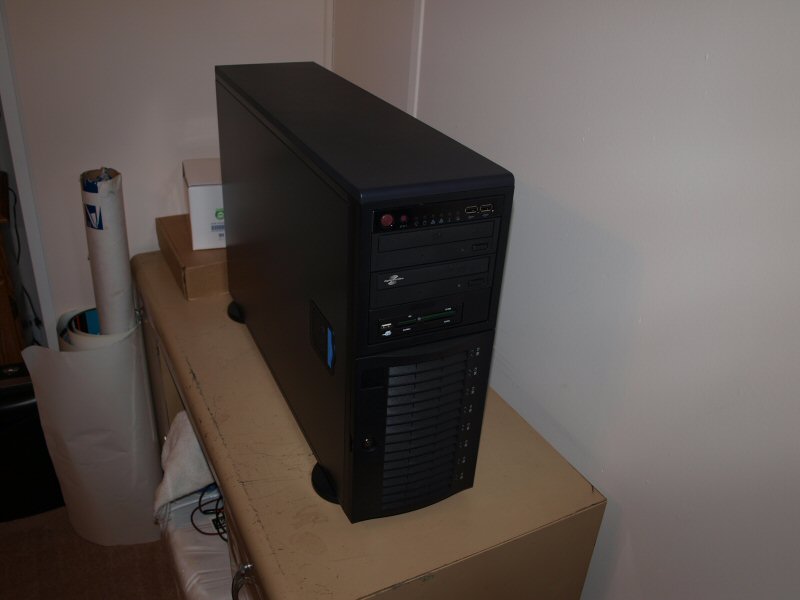

HMMM....What could this be.... ;) TC's first X8DAi Build!

    Re: HMMM....What could this be....
    badcaps.net's new server?
    looks sweet.
    specs?

      Nope, not a server.....replacement for the system mentioned in this thread:

        Looks like a dual Opteron S1207 or whatever the newer AMD socket is.. Looks like a Tyan motherboard, if i had to guess.

          i like the case, well fanned-up
          like a newer version of my intel sc5000 case.

            If I had to guess, I'd say that's LGA1156?
            VERY nice btw! Can we get a few shots once everything arrives and you have it nice and buttoned up?

              LGA1366

                Optiarc drives?
                  Originally posted by weirdlookinguy
                  Optiarc drives?
                  Yup. Have had good luck with them in the past. Top one is a plain DVDROM, the bottom is a DVDRW, both SATA.

                    what psu is it?
                    my case like that has a double-length shell with 2 hotswap psu's slid into it.
                      865W. I opted to not get the dual redundant, as it's not as powerful. For a personal system, a redundant PSU isn't as crucial. If this were a server, I'd have gone for the redundant, absolutely.
                      This is the specs on the case/motherboard.
                      http://supermicro.com/products/syste...YS-7046A-T.cfm
                      I won't be using the onboard SATA RAID. I'll be using the SATA backplane with a 3ware 9650SE-8LPML 8-Port RAID Controller. The only true hardware driven SATA raid controller in existence. It will also allow me to use all 8 bays, instead of 5~6 if I use the onboard. This is the FIRST system i've built for myself since 1995 that wasn't SCSI.

                        Smart choice on the 3Y 865W beast.
                        God I love the looks of those supermicro cases, so simple and industrial. Bet that is build like a tank.
                                  Originally posted by dood
                                  So what are you putting in it? Specs, man, I want specs!
                                  Alright, I'll spill the beans.....
                                  Here's the CPU's (pair of them of course):
                                  http://www.newegg.com/Product/Produc...82E16819117185
                                  Here's the RAM I got to start. I ordered 2 of these kits (6x 4gb reg/ECC DDR3 DIMM's). This gives me 24gb of RAM, and leaves half the slots open, so I can add 24gb more later.......
                                  http://www.newegg.com/Product/Produc...82E16820161337
                                  Hard drives will be:
                                  2x 150gb Raptors in a mirror (boot and OS)
                                  2x 1tb in a mirror for all my other crap.
                                  The cost breakdown:
                                  The supermicro barebones = $900 or so
                                  CPU's = $800 or so for the pair
                                  24gb of RAM = $790 or so
                                  3ware 8ch SATA2 raid controller w/ backup module and batt = $600 or so
                                  hard drives = $500 or so
                                  video card (9600GT 1gb) = $200 IIRC
                                  Opticals = dont remember how much they were.
                                  Total cost = $3790 roundabout.....wowza...
                                  Yea I know.... I overkill the hell out of my personal systems. The one I'm about to phase out was the same way 7 years ago, and now its old and slow. I'd rather have the horsepower and not need it, than need it and not have it. On top of that, I'll be using this thing for atleast 7~8 years.....and being my personal system, I don't want to mess with it. I just want to use it when I want/need it. I dont mind fixing other people's crap systems, but I absolutely can not stand fixing my own broken stuff...so overkill it is!!

                                      Originally posted by Topcat
                                      .....This is the FIRST system i've built for myself since 1995 that wasn't SCSI.
                                        I recognized the drives because I have that exact same Optiarc DVDRW/LightScribe drive in my system. Make sure you upgrade the firmware on that puppy, I was getting nonstop errors burning music CD's in iTunes until I did that. No problems ever since.
