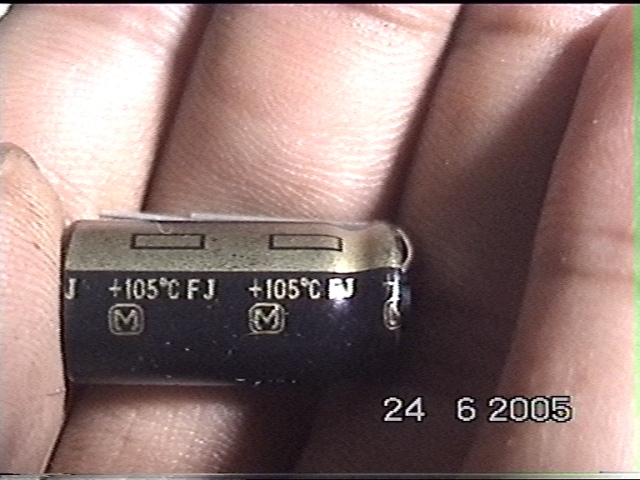

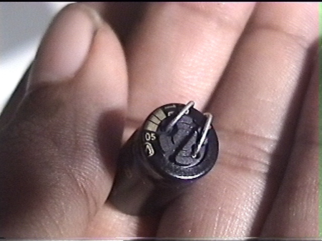

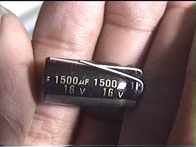

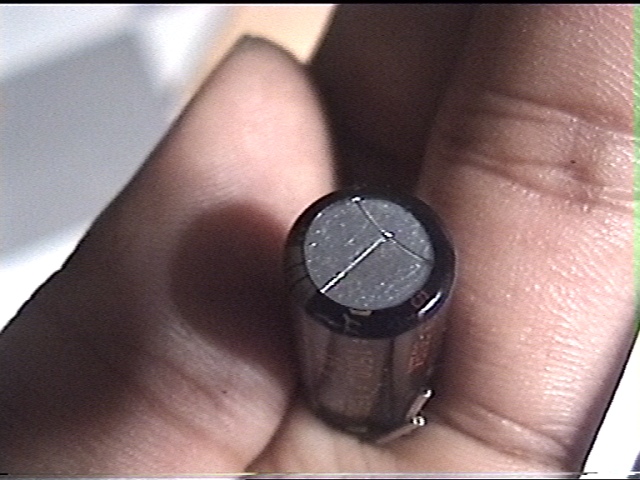

    Panasonic FJ capasitor
    This is my dirty hand (and a panasonic FJ)
    I still couldn't find the datasheet of this pannys while more and more motherboards and vga cards use it.
    Compared to the FC..
    Code:
    [series]		[size, mm]		[ripple current, ma]
    FJ 1500uF 16v ->	10x23			unknown
    FC 1500uF 16v ->	10x30			1815
    			12.5x20			1655
    			16x15			1690
    ..at the same capacitance and diameter, their height are different. What do you think?

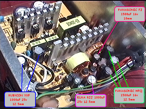

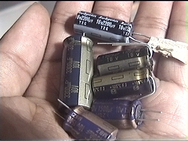

      i've already use it for recaping some mobos and psu's, and find no problem. the quality of this caps remains mistery, but i got the feeling that this caps is between FC and FM. at least that's what i hope.
      this is a generic psu that i've recapped a while ago. we can accept weak psu's as long as they are reliable, so i recaping most of them in my netcafe and office systems (tea plantation/pabric). the original caps are some su'scon and koshin.
      that 10mm FJ is very suitable for such a tight room while other 12,5mm caps (elna RJJ, ruby YFK, panny HFQ) are placed with such a luck to fit in there.
      compared to the FC and FM, the FJ are smaller in dimension in regards to their voltage rating and capasitance.
      uh. and i wish i can edit my post!!
      the FJ i am talking about is 10mm x 20mm, so it is even smaller then the FJ or FM!

                            When I looked at the pix last week, something seemed odd to me about the logo and series markings:
                            "+105 C FJ"
                            "M" (logo)
                            When I looked at some FCs and FMs that I'm currently torturing, I realized what seemed odd last week - the order of the markings is different:
                            "+105 C"
                            "M (logo) CE FM" or "M (logo) CE FC"
                            Something I just noticed, the legs of the "M" in the logo of the FC and FM parts I have are straight and turned in at the bottom of the legs. The legs of the "M" in the logo on the parts in the pic seem crooked in the middle of the legs. Also, the "M" in the logo of the parts I have is thicker than on the parts in the pic.
                                "+105 C FJ"
                                "M" (logo)
                                "+105 C"
                                The ones I have here look just like yanz's :
                                Code:
                                +105°CFJ
                                M
                                But now I see some like this :
                                Code:
                                +105°C FJ
                                  M

                                  C FJ as opposed to CE FJ is ok in my opinion.
                                  I was looking at positioning of the logo also compared to the text but on each value of FC i have it is different.
