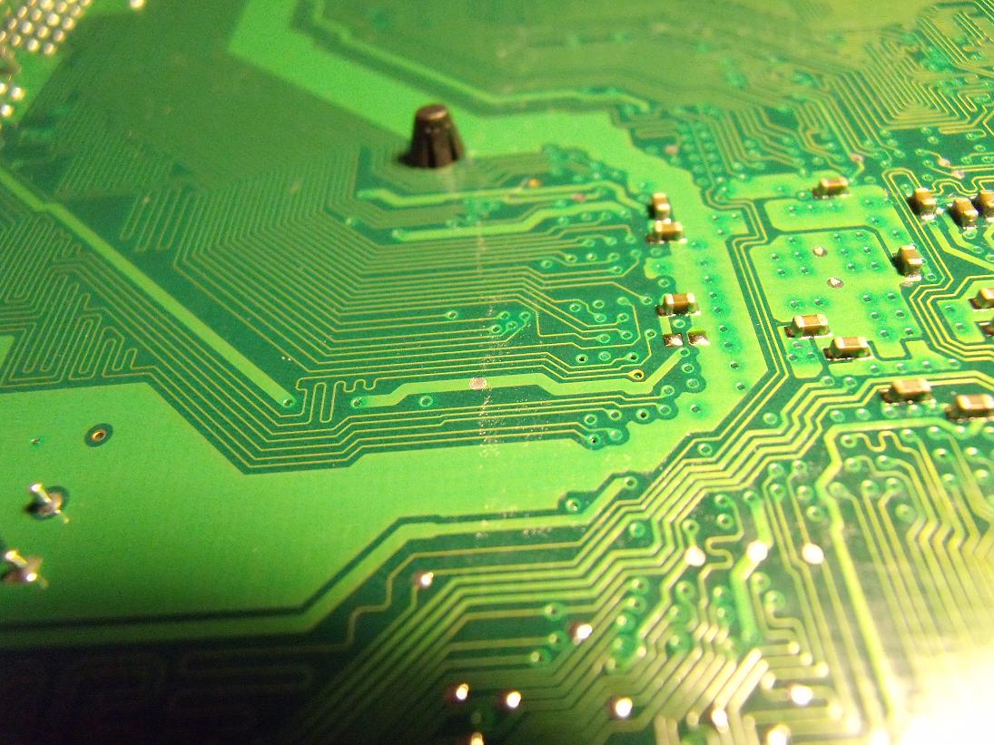

    Got this motherboard from one of the computer shops and i cant get past the videos bios msg. any ideas?

    well the usual - make sure the RAM, CPU, cards, etc are all seated properly, try resetting the bios, remove the bios battery for a while (replace it if it's dead), check for bad caps that could be causing bad voltages to appear.

      evey thing looks good but i cant get past that video bios tryed removeing the bat even replaced it with one i had in a difrnt board and even the clr cmos jumper

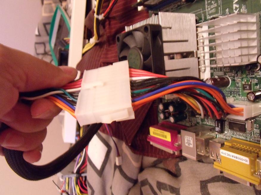

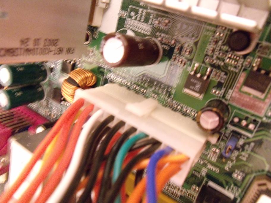

        does it have an 8 pin 12v atx connector? I had a board that wouldn't boot if you plugged a 4 pin cable into the 8 pin socket.

          it only has one power connector as far as i can tell.

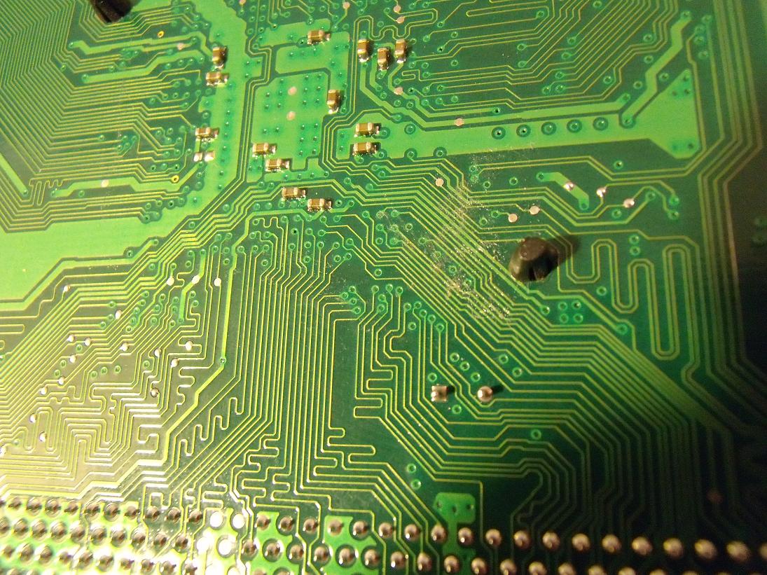

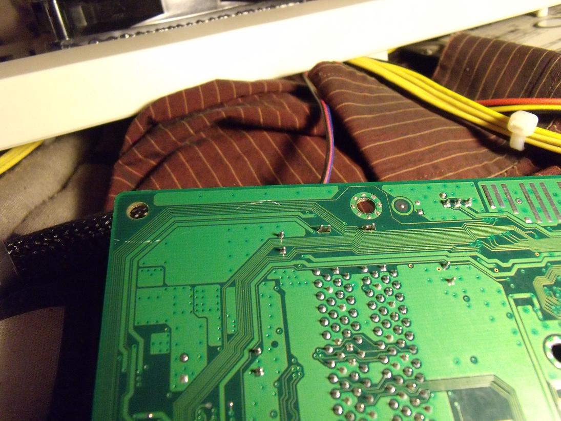

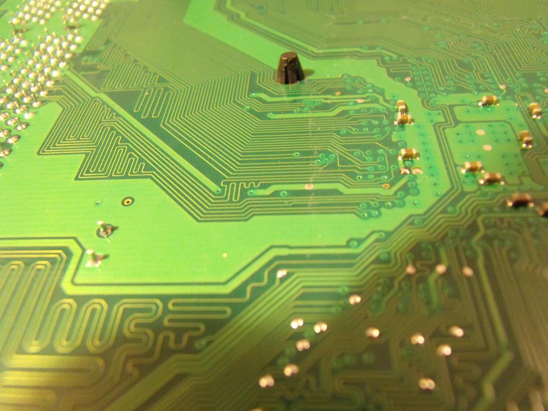

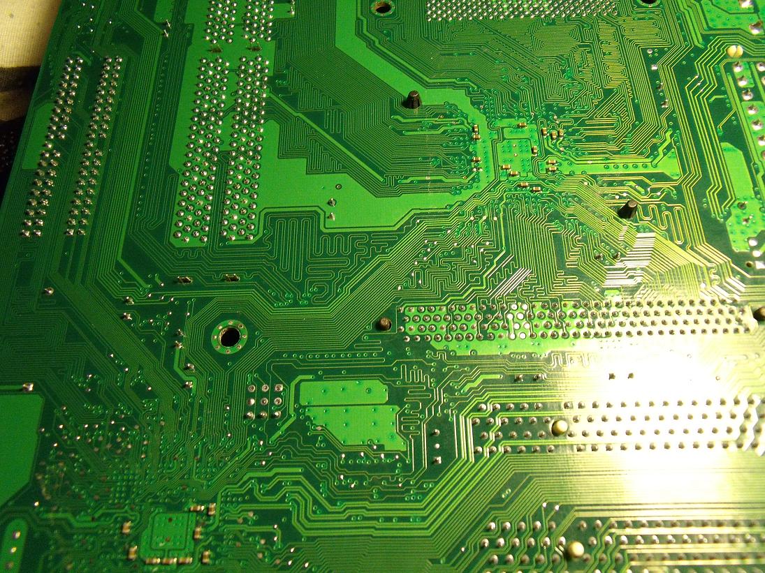

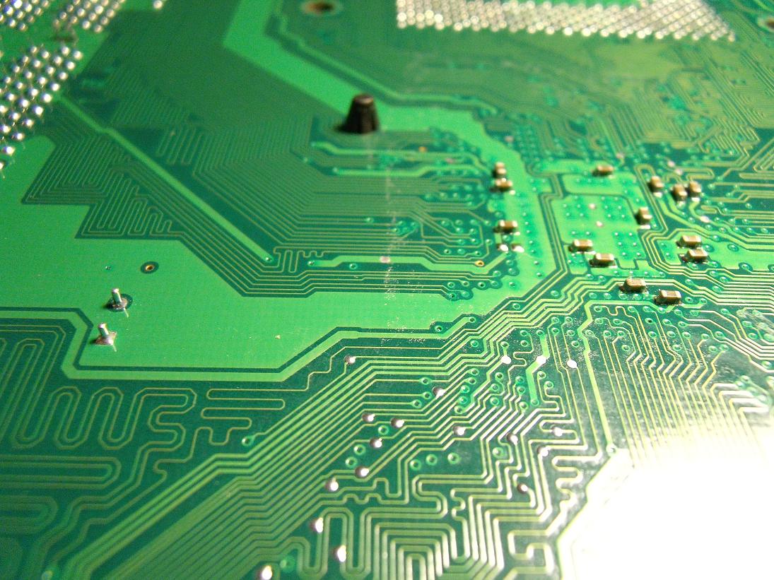

                This doesnt look good does that look like broken leeds?

                • kikkoman
                  • Jul 2007
                  • 691
                  Re: K7vm4

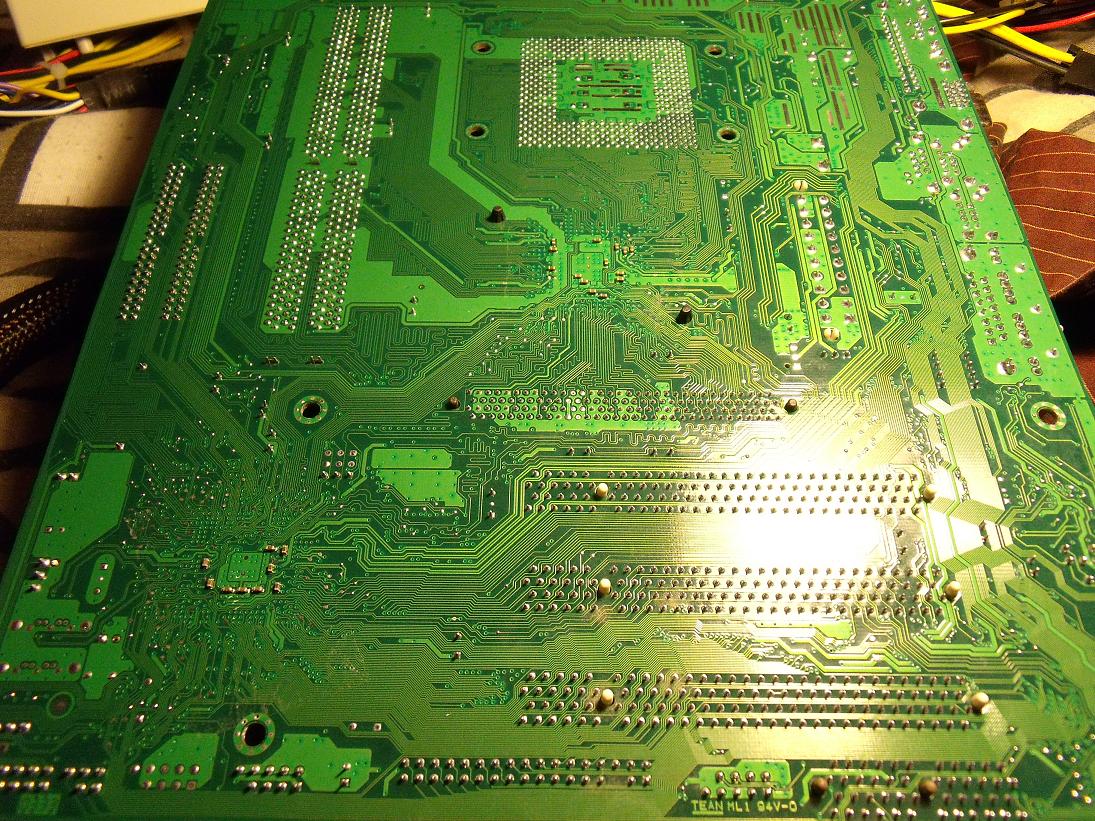

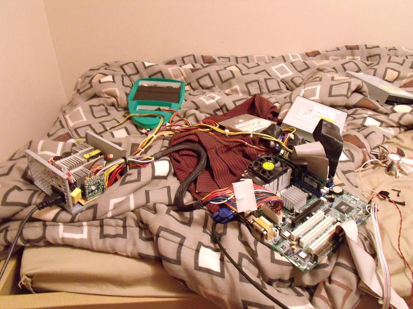

                  whoa.. do you try to run that thing ON A BLANKET?
                  ps: or a shirt?
                  pic #5 could show scratches, but it's hard to tell by the picture.
                  pps: do you have a port80 card? if no, the mobo speaker might be helpful too.

                    lol improvise and no port80 card i dont even know what that is and those scrachs in pic are kinda deep i am thinking its hooped but i got a good cpu out of it.

                        Put the lid back on the power supply before you electrocute yourself!

                          rather elaborate bedwarmer you have there!

                            It looks like a scratch. Check the ends of those traces with a multimeter and see if they still connect. We had a Compaq laptop that did that. Showed the logo and then froze, no input, beeps or codes. Couldn't get that one repaired, the RTC got really hot.
                              yeah as soon as i find all he parts for it.

                                  Dont have one. as ii can see it goes down to the metal.

                                    Go to "harbor freight" or the canadian equivalent and buy a $10 multimeter. You can't really troubleshoot electronics without one.
