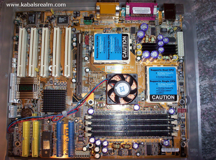

    If you're one of the many that have an Iwill DVD266u-RN motherboard, and have encountered some instabilities with it, here's a couple things you can do to improve it.
    First of all, this board has ALWAYS been a bit on the 'quirky' side... Once you find its 'sweet spot', it does make a good server or usable system! The biggest creator of instability I've found on this board is graphics issues. ANY All-in-Wonder (whether it be an ATI Radeon, ATI non-radeon, 3dfx, ETC) card I've ever used always had problems on this board. I've used a Radeon 8500 AIW and a standard Radeon 8500... Strangely, using the non-all in wonder 8500 counterpart had no issues, while the 8500AIW was always experiencing freezes and errors of all kinds.
    From all the research I've done, this is caused by the AGP being underpowered for some reason, and the added TV tuner of the all in wonder was enough to cause power shortages, resulting in crashes. Unfortunately, Iwill wouldn't even acknowledge this issue or aid in a home remedy for it. I was a regular in Iwill's forum, and they mysteriously removed it about a month ago... I guess too many compaints...
    I've also done a few other mods which helped with stability significantly.

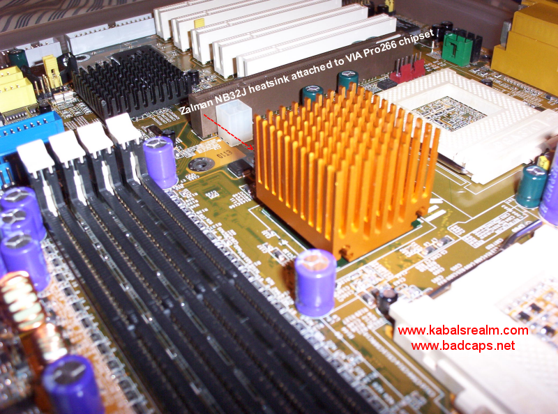

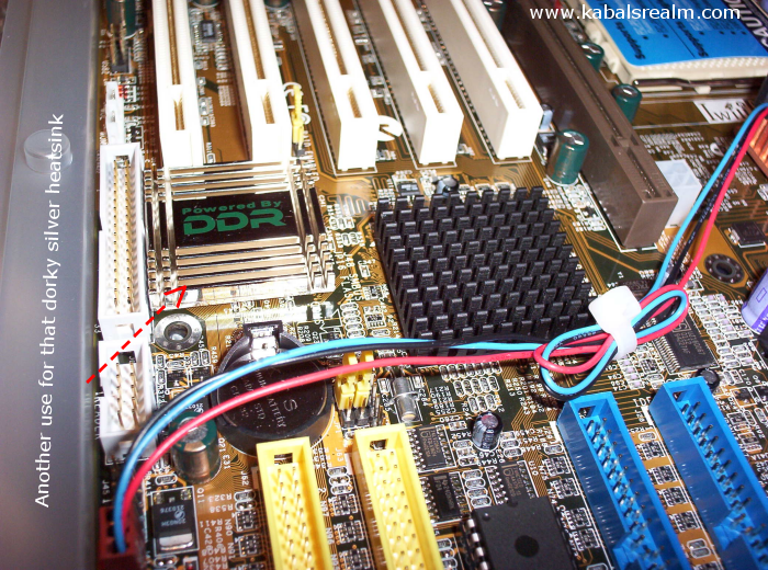

    The first was to install a REAL heatsink on the northbridge. The cheesy chrome one is a JOKE!! If you remove it and look at the bottom, it is very poorly machined and the contact surface is VERY rough. Iwill used NO heatsink goop on this, and it made virtually NO contact with the actual chip! Thus when the system was loaded, or had been running for a while, it would crash or become flaky. I replaced the crappy one with a Zalman ZM-NB32J heatsink, which is readily available on Ebay and many other outlets. This heatsink can be installed either by using the included hardware to mount it to the holes next to the chip, or it can be installed using thermal epoxy included. On the DVD266u-RN, there's a capacitor RIGHT NEXT to the northbridge, so using their mounting hardware interferes with this cap. I installed it using the epoxy.

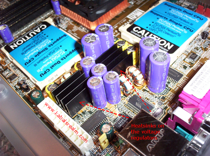

    Along with the northbridge heatsink, I noticed that the VRM's were unusally hot! Hot enough that you didn't leave your finger on them very long! The problem those presented is the small space they are crunched into... I chewed on this one for a few days, and then payed my local Radio Shack a visit... I went back to their home-builders' area where they keep their individual components, and saw the PERFECT solution to this problem! This came in the form of small aluminum heatsinks designed for a T-220 transistor package. They fit the small space, PERFECTLY covering all 4 VRM's with NO MODIFICATIONS to the heatsinks or the VRMs!! The Radio Shack part# is 276-1368, and they cost $1.59 (US) either at your local Radio Shack, or Online @ www.radioshack.com. I attached them with the remaining thermal epoxy I had from teh Zalman NB32J heatsink.
    These mods took my DVD266u-RN from a flaky piece of sh*t to a very reliable server, which has given me NO troubles since!
    Here are a couple of pics of the mods:
    http://www.kabalsrealm.com/images/dv...orthbridge.png
    http://www.kabalsrealm.com/images/dvdurn/dvdurn.png

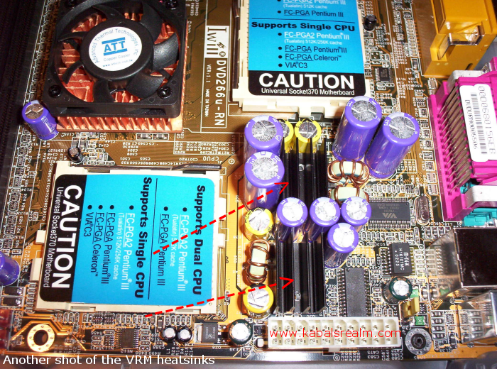

    UPDATED Info and Pics!
    Ok, the pics below show a better view of the heatinks attached to the voltage regs. I hope this answers the requests. Also shows a good use for that almost useless chrome heatsink. It fits perfectly on the Highpoint chip!! The heasink has to be modified a little for that. The ears that attach it to the northbridge need to be snipped off with a pair of side cutters, and then ground flush. A Dremel tool works perfect for this! If you don't want to use this heatsink on the Highpoint chip, it is also acceptable for use on the southbridge chip.
    http://www.kabalsrealm.com/images/dvdurn/0141.png
    http://www.kabalsrealm.com/images/dvdurn/0143.png
    http://www.kabalsrealm.com/images/dvdurn/0145.png
    http://www.kabalsrealm.com/images/dvdurn/0147.png

    Here's a quick rundown on some DO's and DONT's for your DVD266u-RN:
    1) DO NOT use low-quality RAM! Try to use Micron/Crucial, Kingston, Corsair, and Samsung! This board loved those brands.
    2) Use a GOOD power supply! Nothing less than a 400w true power! Recommended: Antec, Enermax, and Sparkle.
    3) KEEP IT COOL!! if your case has fan ports, make sure there are fans in those ports!
    4) Don't use an 'All-in-Wonder' type video card, nothing but a HEADACHE! If it's being used as a server where graphics performance isn't as important, I'd recommend using a PCI video card if you have an open PCI slot. That eliminated ALL video problems.
    5) DO NOT use an Adaptec AAA-131U2 SCSI RAID controller! This board (and MANY other boards I've had) did NOT like this controller and constantly corrupted data. This controller was a big blunder on Adaptec's part, as it had problems in many other boards aside from the Iwill.
    If you have this board, you might give these a try if you've had any trouble with it....
    Good Luck!

                sorry i forgot to ask you about the vrm's....i don't have any thermal epoxy to secure new heat sinks to them but can i use j-b weld?? someone told me that was a alternative to epoxy and still has good thermal conductiveity ?!?!
                • Topcat
                  The Boss Stooge
                  • Oct 2003
                  • 16959
                  Latimo!! when I saw that name, I knew that I remembered that from somewhere!! Glad to see ya back again, and that you haven't used your DVD266u-RN for target practice!
                  Anyway, try the heatsinks and my modded BIOS, that has remedied 5 thought-to-be FUBAR'd DVD266u-RN's... If uusing XP, I don't install any VIA service packs, as XP has the best drivers embedded in the OS. As far as memory timing, if you're not into hardcore gaming and tweaking, I would use the default settings that your RAM is spec'd for, that will eliminate a bunch of instabilities... I'll trade off a couple frames a second for a reliable system, although, I'm not a gamer anymore these days...
                  The heatsinks! VERY BIG HELPER, especially the VRM heatsinks! Yes, they can be attached with JB Weld... I believe I told ya about that one back in the Iwill forums before they canned them... JB Weld is a VERY good conductor of heat, and will obviously not conduct electricity! I've JB Welded many heatsinks, and off the record, it seems to work better than the \"thermal\" epoxy that's supposed to be designed for this application.
                  On 2 identical VP6's, running the same RAM and CPU's, and Zalman northbridge heatsinks, the chipset runs 5-8 degrees cooler on the board with the JB Welded heatsinks versus the other one attached with the zalman thermal epoxy. However, the JB Weld does have a drawback! It takes FOREVER to set!! You also have to watch it closely while it sets. The JB Weld will shrink a little bit when setting up and slightly change shape. If you don't watch it for the first hour, the heatsink may shift and set crooked... That annoys me, so for the first hour, keep an eye on it, and adjust as necessary. JB weld on the VRM's don't need that attention, since they're in such a small space, there's nowhere for the heatsink to shift, and they stay in place.
                  Good Luck!

                        hey top cat....today i went and bought the heat sinks for the vrms from radio shack.how much of the j-b weld do i apply? just a thin coating on the sink it's self or the the vrm...what works the best?
                        thanks...
                        L.
                        • Topcat
                          The Boss Stooge
                          • Oct 2003
                          • 16959
                          I just buttered the bottom of the heatsink with a thin layer of mixed JB Weld, then pressed the heatsink onto the VRM's. I pulled the heatsink back off to make sure all the VRM's were covered and then put the heatsink back on... That was it... Don't ever try and take 'em off after it sets, the VRM's will come off with the heatsink... :o
