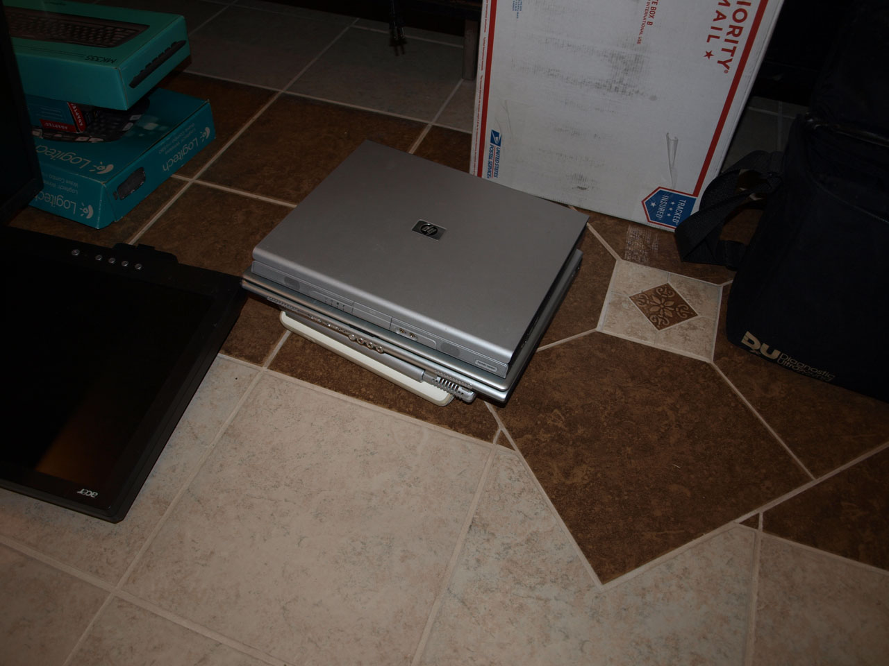

      Some laptops & tablet, untested so far.
        https://www.badcaps.net/forum/attach...1&d=1619147730
        LOL. That HP on top looks THICC. Let's hope it's not one of those with a desktop P4 chip. I have a VAIO like that here, and it's a miracle the whole thing can work without overheating. Its "power brick" really is a brick.
