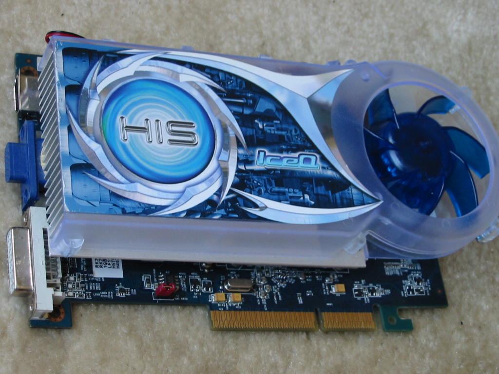

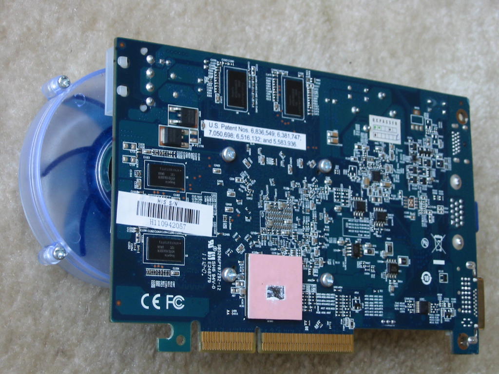

              Re: best cheap/free scores 1.1 - HIS Radeon HD4670 AGP
              I want to give a huge THANKS to Mr. Per Hansson here for sending me this:
              It's a rare HIS Radeon HD4670 AGP video card with 1 GB DDR3 VRAM that he mentioned is not working... and indeed when I installed it in my GPU test PC, it wasn't. Or wasn't it?
              Turns out my video card test PC was having some issues that I actually caused myself (corroded pins in the CPU socket from flux... long story. ) After sorting those out, the HD4670 AGP detected and seemed to work just fine - or at least for the brief testing I did with it.
              Only thing that seems to need work with that card is an IO bracket (original is missing and VGA connector has its outer metal case gone.) Also, the card had a severe bend in one corner (not sure if from shipping or before that), but luckily it was in an area with no important components, so I straightened that out. Only thing that took slight damage from that bend was one of the two Teapo SZ 16V caps for the GPU VRM high side - nothing that I mind, since I will likely be changing these anyways.
              Probably the biggest item that needs work is the bridge chip. Like all of the latest/last ATI AGP vidoe cards, this one uses a bridge chip between the GPU and AGP connector, which runs hotter than anything else on the card. So that's why I didn't really do any extensive stress-testing. Just power-up, detected, and then afterwards I put a small heatsink over the bridge chip core (hence the white thermal compound still on it there in the pictures), which was OK enough for the brief tests I did, but not attached securely in any way (and I didn't want it falling off and shorting out something.)
              Anyways, I'm already working on the IO bracket, so that should be done soon. The bridge chip HS might wait until I test some prototypes on a few lower-tier ATI AGP cards, to see how well (or not?) my design works.
              So again, thank you Per!

                • Per Hansson
                  • Jul 2005
                  • 5895
                  • Sweden
                  #4588
                  <snip>
                  This is how the card arrived for me from eBay, the seller actually had a generic render of the card in his ad, not an actual picture showing the missing bracket and no mention of it in the ad itself.
                  So I was quite disappointed at that and asked for a partial refund over that and the severe bending of the PCB.
                  The issue I had with this card (sorry for not telling you) is that it would crash when I installed the drivers, i.e. only worked fine in basic VGA mode without drivers.
                  But as can be seen in your photos it has drivers so maybe it was repaired by sitting in a box at my place for close to 8 years and then being mishandled some more by our respective countries postal services
                    master hoarder
                    • May 2008
                    • 12175
                    • Bulgaria
                    #4589
                    Originally posted by Dan81
                    I have a X1650 Pro with that bridge chip and I flat out superglued a nForce 2 southbridge heatsink to it lol
                    It's been running fine ever since. I also have a HD3450 AGP done in the same way.
                    Good to know.
                    I actually bought Arctic Silver thermal epoxy for this (and similar tasks) a while back, but just haven't determined what size of heatsink would be appropriate on the bridge chip to keep it cool enough.
                    Well, the card is no longer missing an IO bracket anymore
                    https://www.badcaps.net/forum/showpo...&postcount=526
                    Not the best looking jobbie, but should do OK.
                    And yeah, I've seen eBay sellers eBay use a generic picture and then ship a slightly different item without mentioning anything about that. I actually got a BFG GeForce 7300 GT AGP that was pictured as a blue card with the slightly better cooler. Instead, I got the one below with the crappier U-bracket cooler:
                    https://www.badcaps.net/forum/showpo...0&postcount=27
                    But the card worked and was still the same card in terms of specs, so I couldn't complain. Not to mention I got it shamefully cheap already.
                    LOL
                    Could be!
