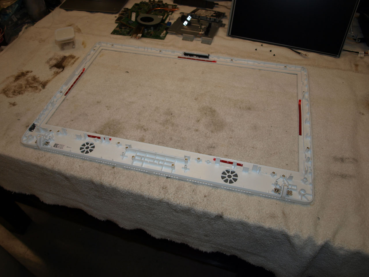

      Beyond this point, this one is kind of an experimental.... I located a new-old-stock non-touch bezel on ebay for $27 shipped.....so a little gamble as to whether this thing will go back together....so while I wait for parts to arrive, I'll reassemble what I can and prep for the new fascia.
      Panel separated from the destroyed bezel....yea, I busted it even more in the process.
      The perfect condition panel, hidden behind the glass. The glass digitizer is not polarizing....so no affecting panel function without it.
      Backplate.
      Removed the USB controlled touchscreen control board and all the ribbons.
      Ready for the new bezel.
      Trash.
      Now for the stand... Paint is good and set up now. Smell is gone, and it sure looks better!!
      Bottom reassembled.
      The rest reassembled.
      Set aside....can't go any further. I need to get new foot pads for the stand. The originals are smelly and gross, I have thrown them away. These are nothing unusual, just stick-ons....can get them anywhere.
      Stay tuned.

            Got to work on this a little today. The bezel is a perfect fit, not much to assembling it other than a bazillion little screws....but here we go!
            The new bezel:
            ...and the box it came in....
            about half way there...I also deleted the camera & microphone....I hate them. If the buyer wants them, I will put them back in.
            Not bad!

                              ...and this one is now complete...
                              This was the fastest shipping from China I've ever seen, the USB3 header arrived today.....so here we are, motherboard removed....again (I was getting real good at this)...
                              Soldered in....
                              I did have to trim those small tabs off the new slot, they interfered with the housing. It wasn't a big deal.
                              Slot works.
                              Now here's where it gets fun, and as mentioned earlier in the thread about repurposing that internal USB connection that used to run the touchscreen that has been removed.... Inspired from THIS POST, I found a complete boardset from a ET2203 that had a broken screen from ebay and it had the wireless keyboard/mouse controller....for pretty much the cost of shipping. It was originally intended for 'Project:PAT'.....but the rack cabinet and a different route because of it left this kb/mouse+receiver unassigned.
                              Then I found a brand new compatible keyboard & mouse:
                              ...but there was a problem...the plugs were same/compatible on both the Dell & Asus harnesses, but they were not wired & pinned out the same. The Dell pinout did not match the Asus harness at all. The Asus cable was a simple passthrough. The Dell OTOH did a weird crossover from one connector to the other.....so some voodoo had to be done. I chose to modify the Dell cable, as it was a little longer, and the Asus cable was potted with some kind of glue to prevent depinning it....so here we go!
                              Asus on the left, the way I had to wire the depinned Dell connector on the right.
                              Completed.
                              ...and the acid test...
                              Nothing went *poof* and I heard the 'new device' chime....and Winders detected it!
                              Married the new KB & Mouse to the receiver...they work.
                              Now to reassemble. I routed the cables in an existing trough and ziptied the receiver to some cabling....easy peasy.
                              Reassembled & done! Things are happy and this one is finished!!
                              This one was a mild challenge, but came out well and for not much money. When I sell it, I'll wipe S2K12 and doom it to it's native OS, W10.....but that'll be someone else's problem...but until then, I'll leave it as it currently is.
