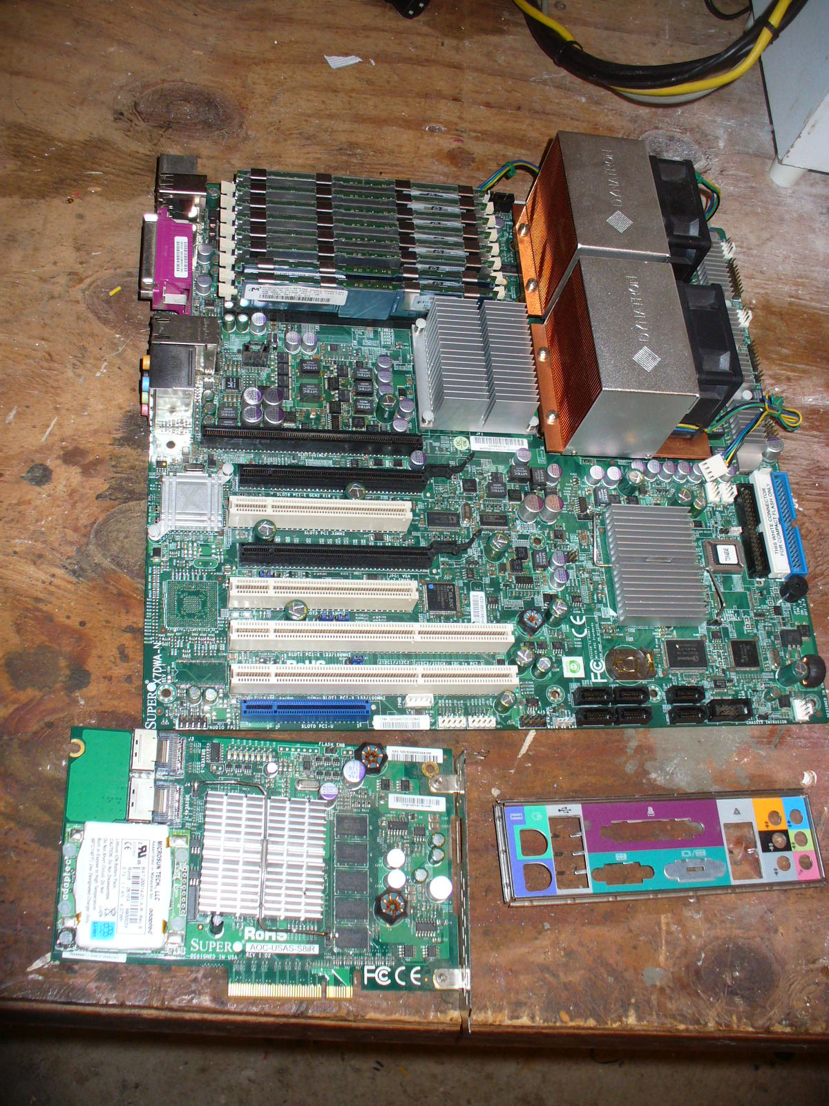

    Anyway, so here's the project:
    Some of you may recognize that as the notoriously unreliable Supermicro X7DWA-N from Main Rig 5. Topcat tipped me off to an auction w/ best offer for another board... and was able to best offer it down to $72 shipped (cheapest I've ever seen on eBay is $100). The board isn't here yet, but I can still mock things up.
    The plan was to gut out Main Rig 4.1 (see above) and move this board into it... it's a supermicro case with a midplane, so this ought to work, right? I knew that I'd need to add some missing parts to make it run right based on past experience with FB-Dimms:

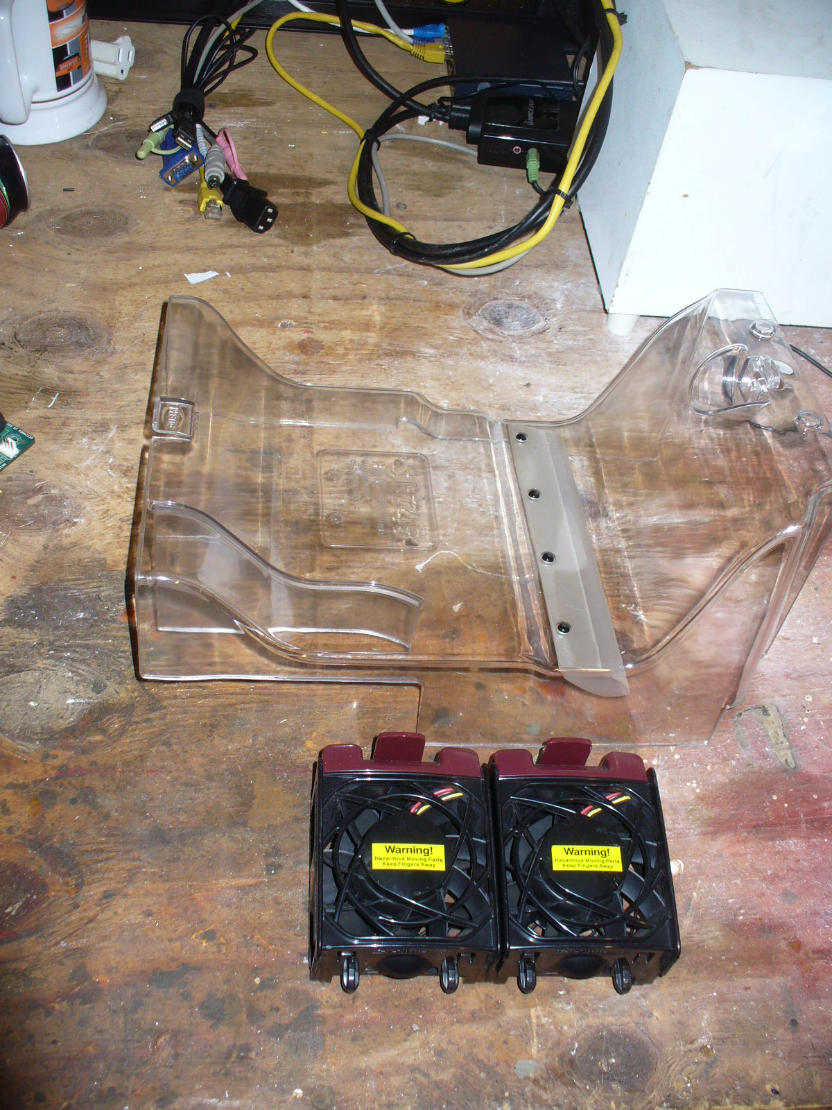

    These being the air duct and rear fans... this case is missing the duct and had dummies in place of the fans in the back. In addition, I'd need to upgrade some things:

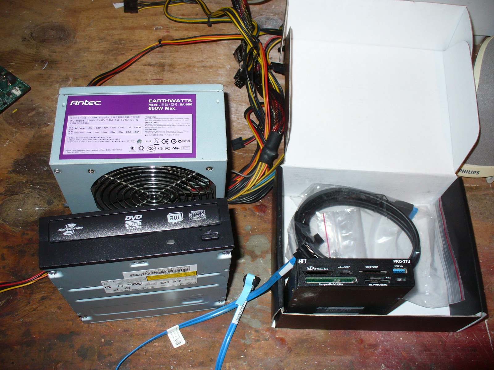

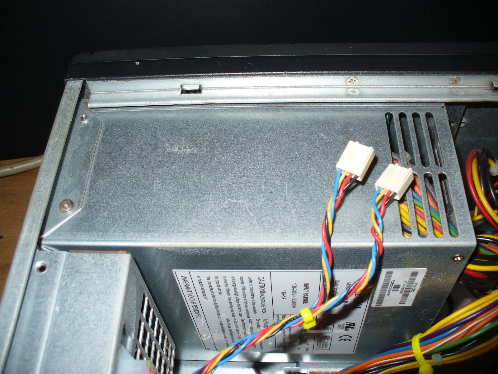

    The PSU is due to the 545W unit currently installed not having any PCIe connectors (and being marginal for running this board). The Optical drive is because while the IDE drive I currently have would work, I might as well upgrade here. The card reader is due to the lack of a 2nd USB header, I have to use a USB card to use a card reader, so I might as well use a USB 3.0 card with this reader pulled from Main rig 5 (card ordered, not here yet).

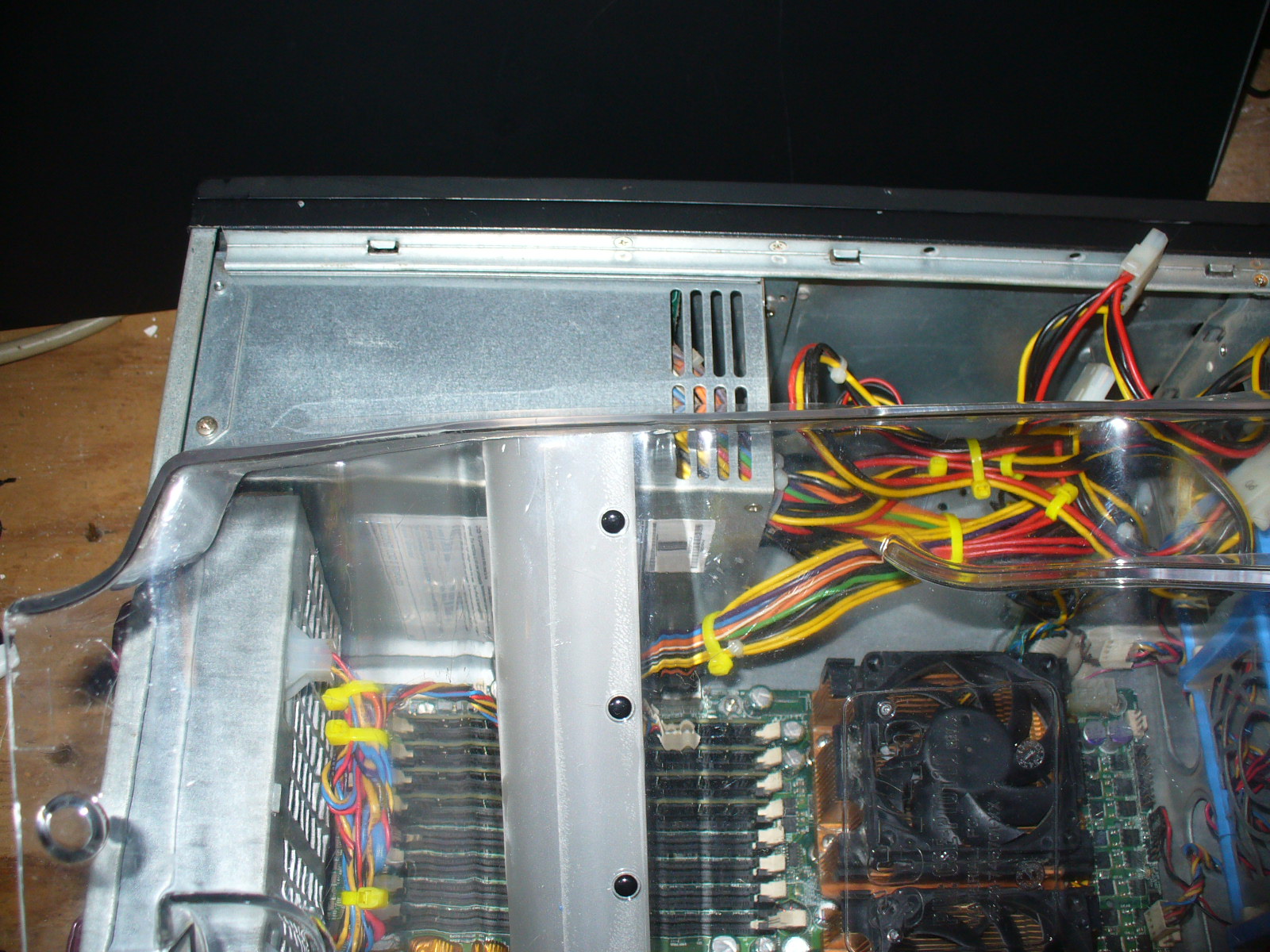

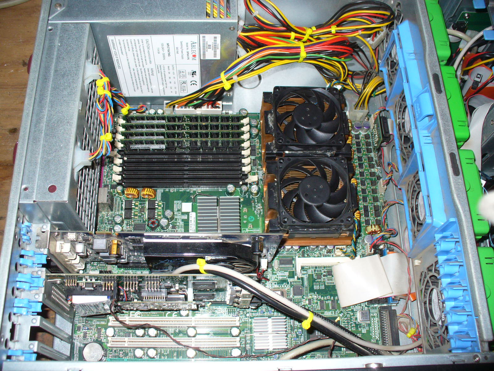

    Ok, let's tear into the transplant recipient:
    Good old Irwindale netburst awesomeness (with 16GB of DDR2!).

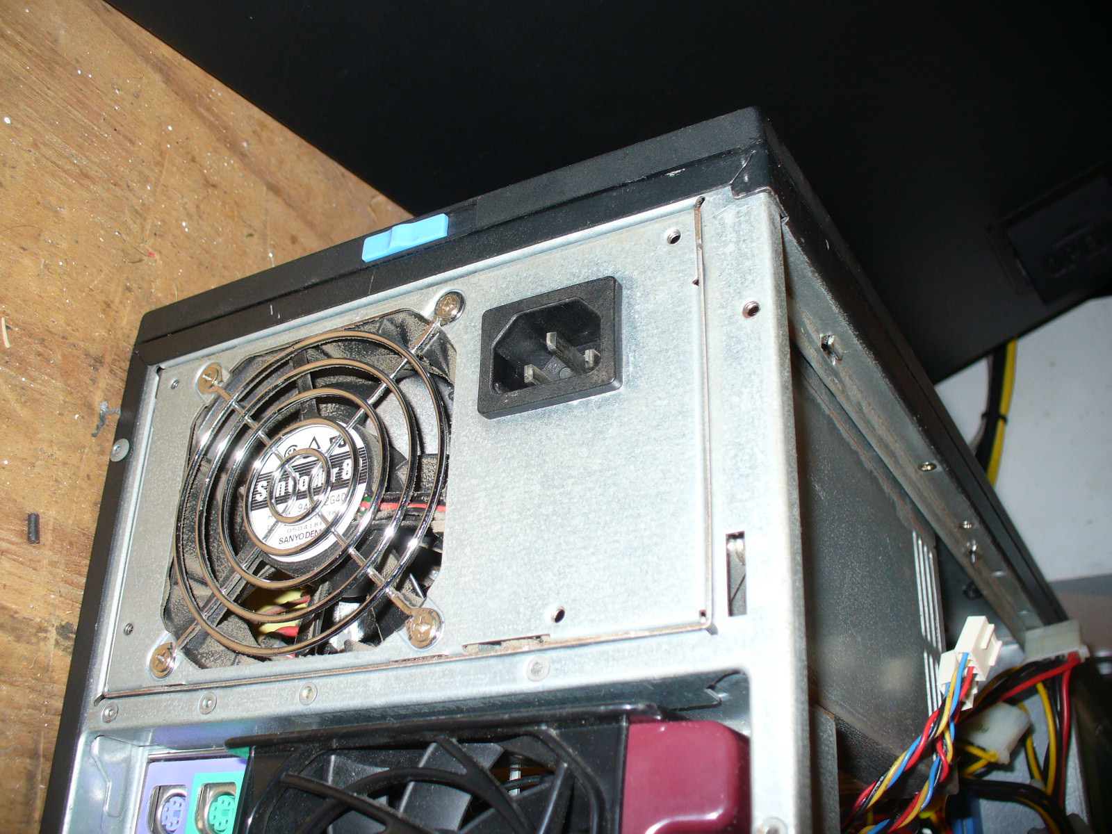

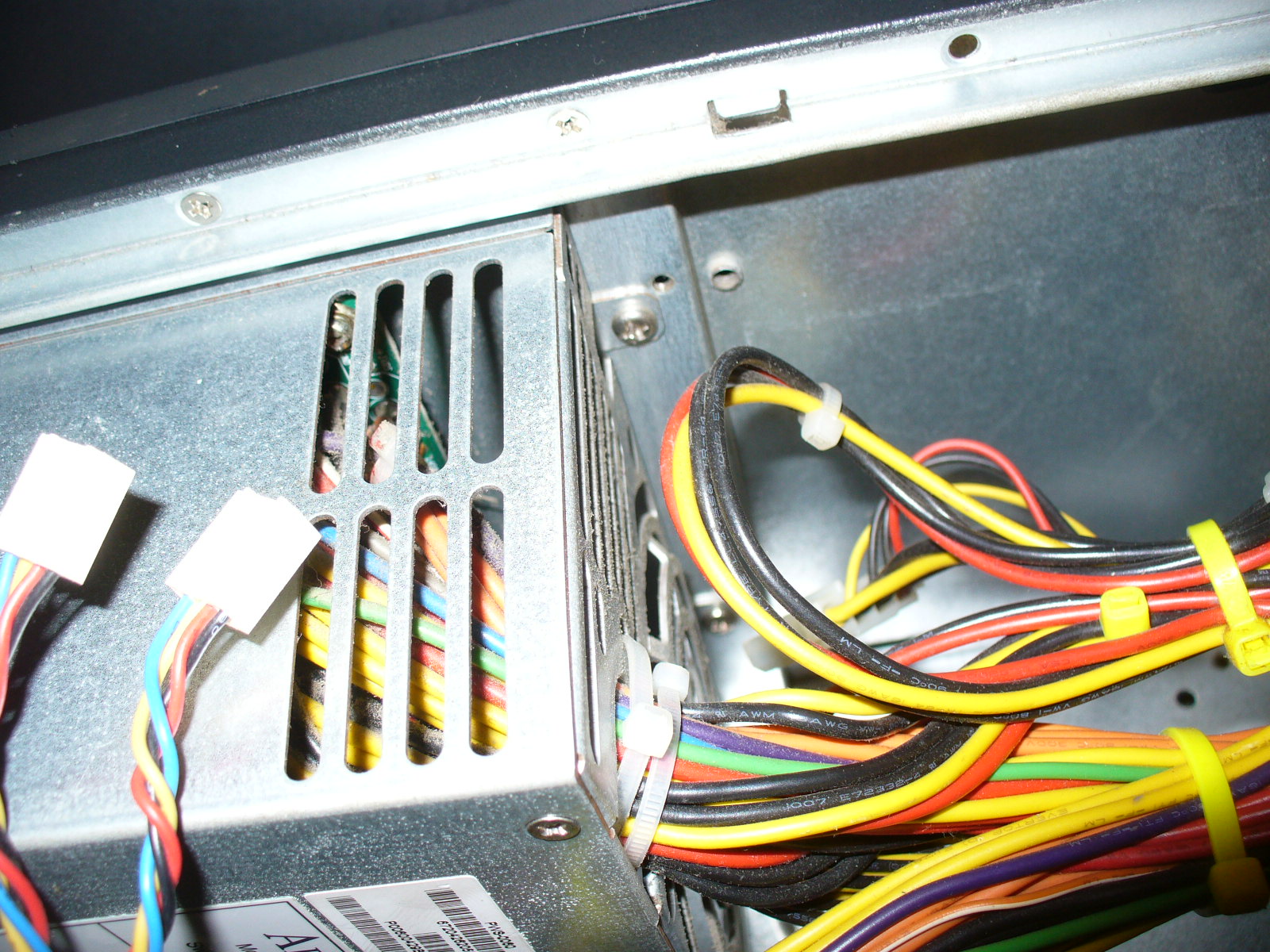

    Started pulling it apart... and very quickly some issues cropped up. First, while it does use an ATX sized PSU, the mounting isn't standard:
    Unless I drill out the PSU and make a custom bracket, that ain't going to work. The air duct also is a no-go:
    This was made for supermicro eEATX cases with 1U modular power supplies, like main rig 5 and 6 used:
    Hence why the case was missing the air duct

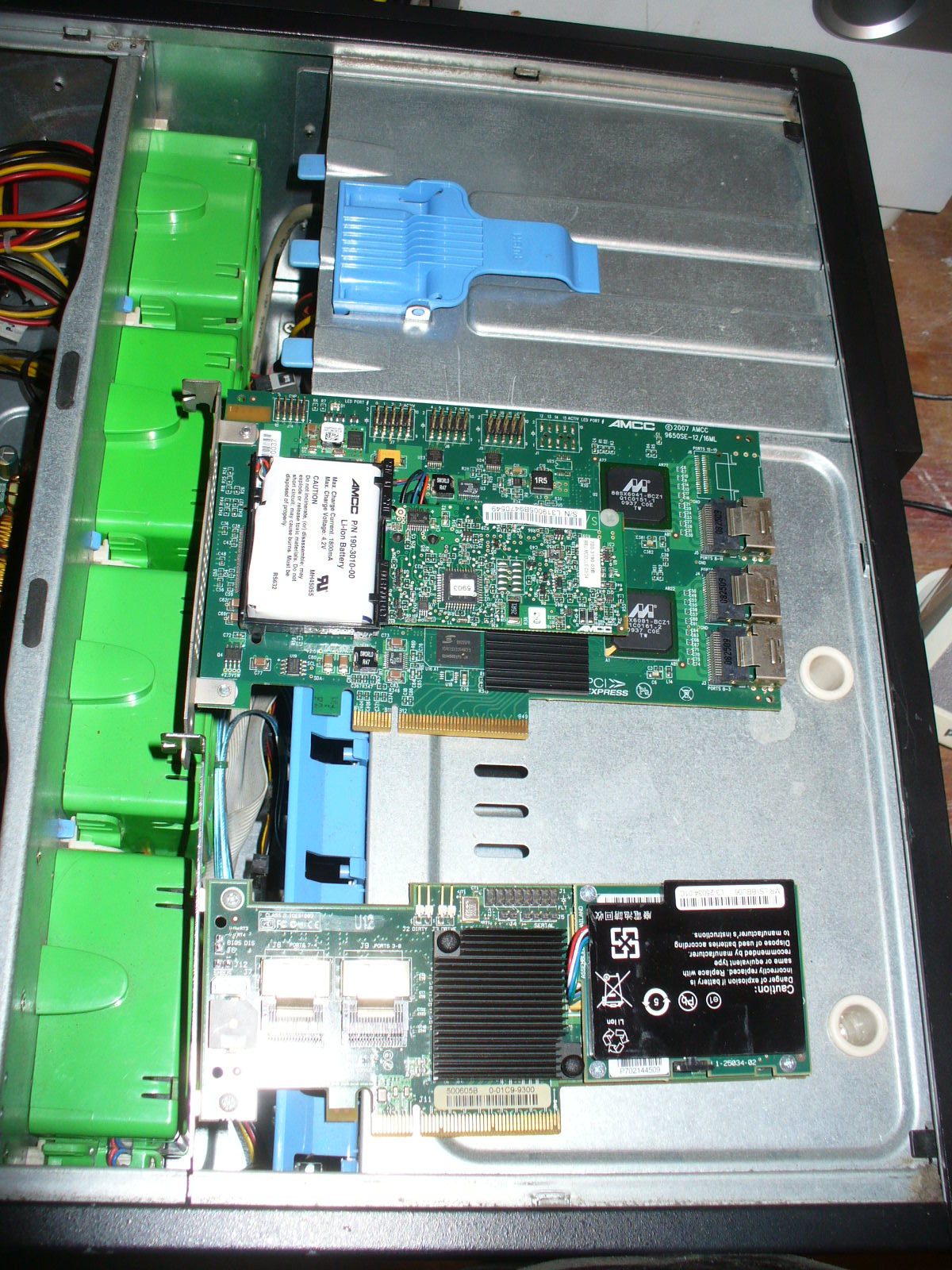

    Due to these, I'm not feeling that the X7DWA swap is going to be a good idea (better keep an eye out for a deal on a fresh EATX case). While I'm here, I might as well upgrade the AMCC 9650SE to an LSI 8708EM2 SAS card I had sitting:

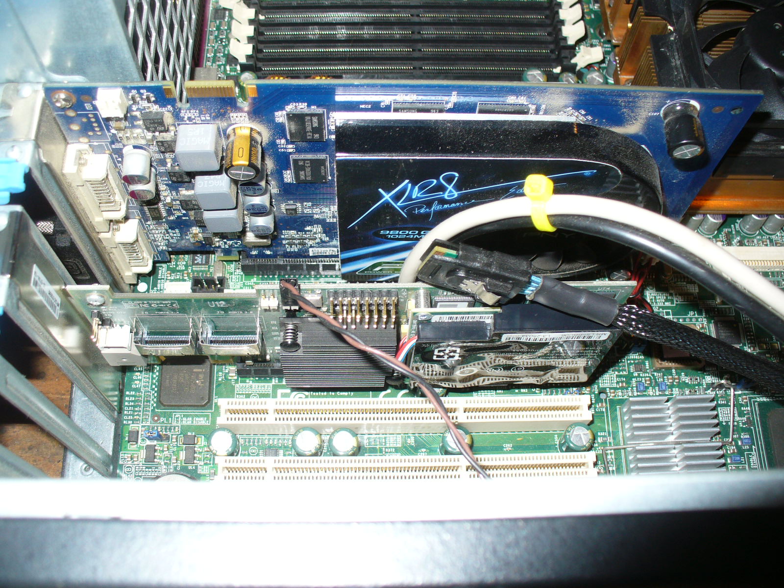

    ...but wait, that doesn't fit either!
    The bleeping mini-SAS is too short... *sad trombone*

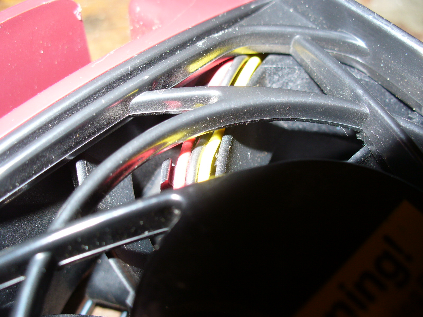

    Put it back together, at least the rear fans fit... but why won't they throttle down like the other fans? Well, here's why:
    Apparently they made these fans in a non-PWM version... great.
    So after all of this mess, main rig 4.1 is literally right where it started.

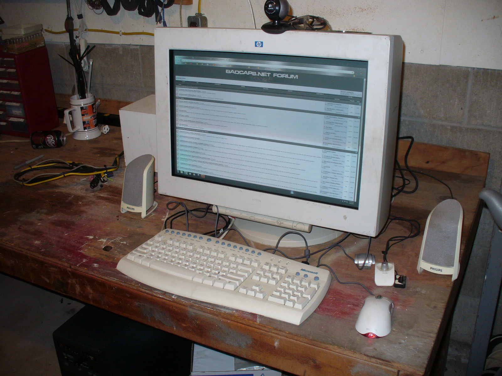

      I think you need to degauss that old Triniton monitor....what's with the blue lower left corner?
        I said that already:
        Yes, this is Topcat's old 24" trinitron monster... needs some degaussing work (need to get a proper coil) but otherwise it works great and is the highest resolution monitor in the house.
        I'm a cheapskate... will check ebay for deals. It's been that way ever since it came home from your attic.

          Re: Ratdude's computer workbench... and epic fail build
          Check the settings first, theres actually some settings that will alter that....I don't remember what it's called....but its along the lines of convergence....that is if a blast of degauss doesn't cure it.
            The internal Degauss didn't help... I tried to fix it using fixed magnets but to no avial.
              Check some of the more obscure settings & convergence stuff....I remember dealing with discolored corners on Trinitrons that these settings fixed. I have a good degauss coil from my TV service center days....I'd be glad to let you borrow it....I'd just have to have it back.....its been with me a lot of years.

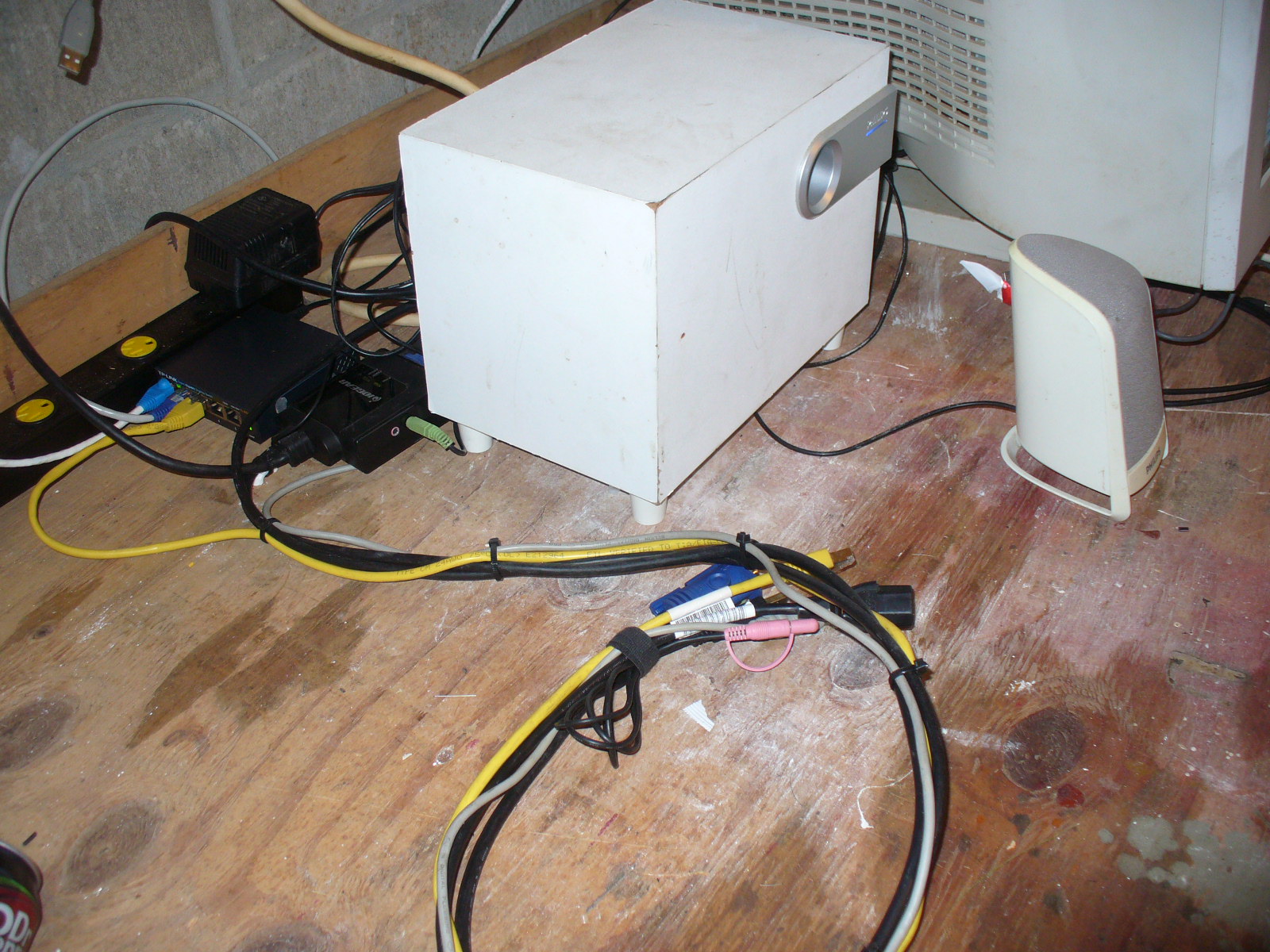

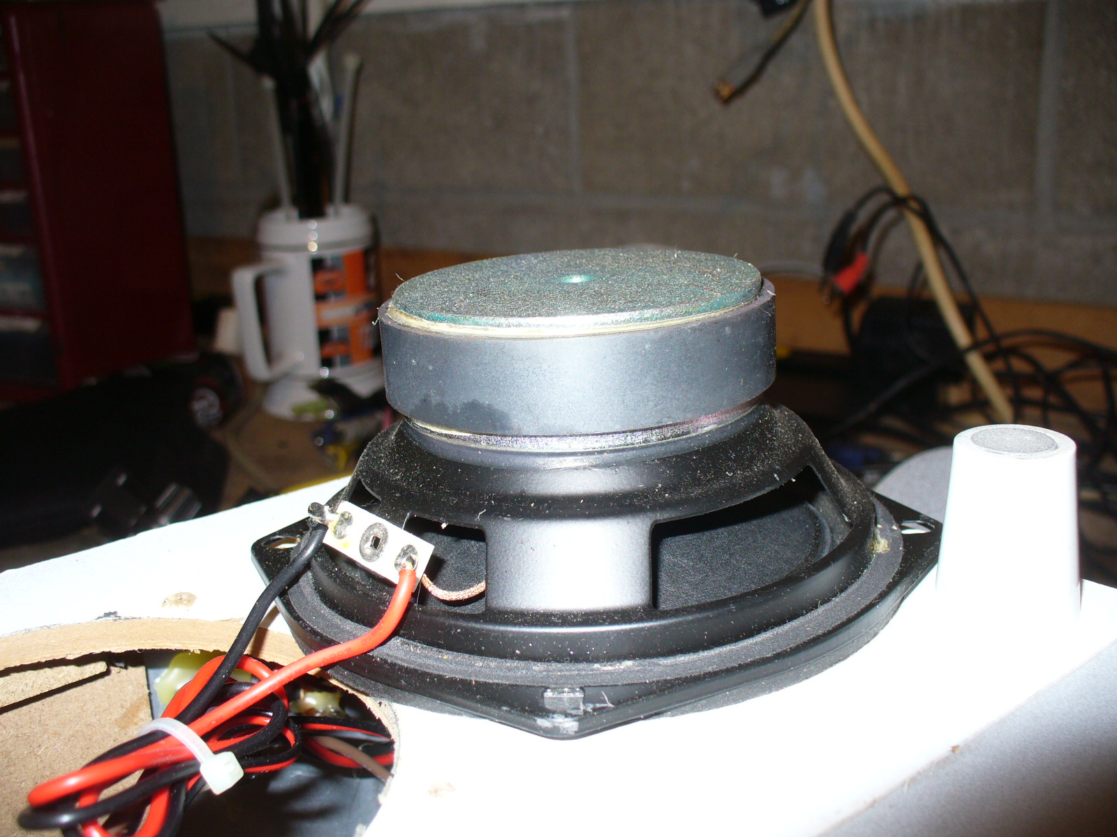

                RD- Try moving that subwoofer housing away from the monitor. I don't think the magnet inside is shielded.
                  Nope, it's definitely a degaussing issue. It's only one corner. I have a thread on this:
                  https://www.badcaps.net/forum/showthread.php?t=66844
                  What it does (I have videos if interested) is I'll command it to degauss, it does it, and for 1 second or so it's good before the corner "pops".
                  Good catch! I was able to move the subwoofer and make the corner de-distort... but now the upper right corner is out. Even moving the subwoofer to the back of the bench doesn't help... moving the subwoofer 5' away causes both corners to distort. Moving the satellite speaker has no effect. I guess this sound system and the monitor are incompatible... or I need to somehow shield the subwoofer?
                  Edit- the subwoofer is totally un-shielded:
                  Not sure where I could move it... Either this system was made after CRTs fell out of favor or they intended for the subwoofer to go somewhere far away. Ideas?
                  Edit- auto degaussing after moving the subwoofer to the "corner correcting" position causes the issue to return... which leads me to believe that the subwoofer is a red herring. Sure, moving the subwoofer has an effect, but degaussing seems to undo it.
                    The larger Sony's are really sensitive to magnetic fields -- they even tweak the magnetics based on whether you purchase it for use in the northern hemisphere or southern!
                    Also, a nearby lightning strike will screw monitors up for scores/hundreds of degauss cycles.

                      Yup...definitely needs a good degaussing then. Lemme know if you need my coil.

                          RD, got something with a C frame shaded pole motor?
                          Small fans, electric pencil sharpeners (of all things), can openers, etc.
                          These motors give off a large stray field and can be used to degauss shadow masks & aperture grilles.
                          FWIW, the grille wires in the bigger Trinitrons can get stuck to each other, giving the appearance of a degauss-stubborn purity/convergence error. Gentle tapping on the side of the monitor, closest to the error, while degaussing usually corrects this. If the internal degauss doesn't work, use an external one.

                            Yep. In the Old Black and White single gun crt days that was how you got rid of black or gray spots in the corners or the sides when the tvs were sitting in one location for a very long time and then suddenly moved elsewhere.

                                Have you considered moving those speakers and the subwoofer away from it. If anything, I am betting it is the subwoofer. Remember, CRT monitors don't like magnets around. In my college apartment a few years back, I had floors speakers next to my desk - a set of Realistic Nova-18. Didn't realize they had absolutely no shielding and for a the first month I had that setup, I always wondered why one of my CRT monitors was looking a bit "off". Eventually I changed the speakers for a different set and noticed the affected monitor was now fine too. Put back the Realistic speakers again just for a test, and there it was the problem again.
                                *EDIT*
                                Seems that I didn't read the thread fully, as someone already suggested that.
                                https://www.badcaps.net/forum/attach...1&d=1548042930
                                If your desk is near a corner in the room, place the sub in the corner, on the floor - that way you will get the best/most sound output too.
