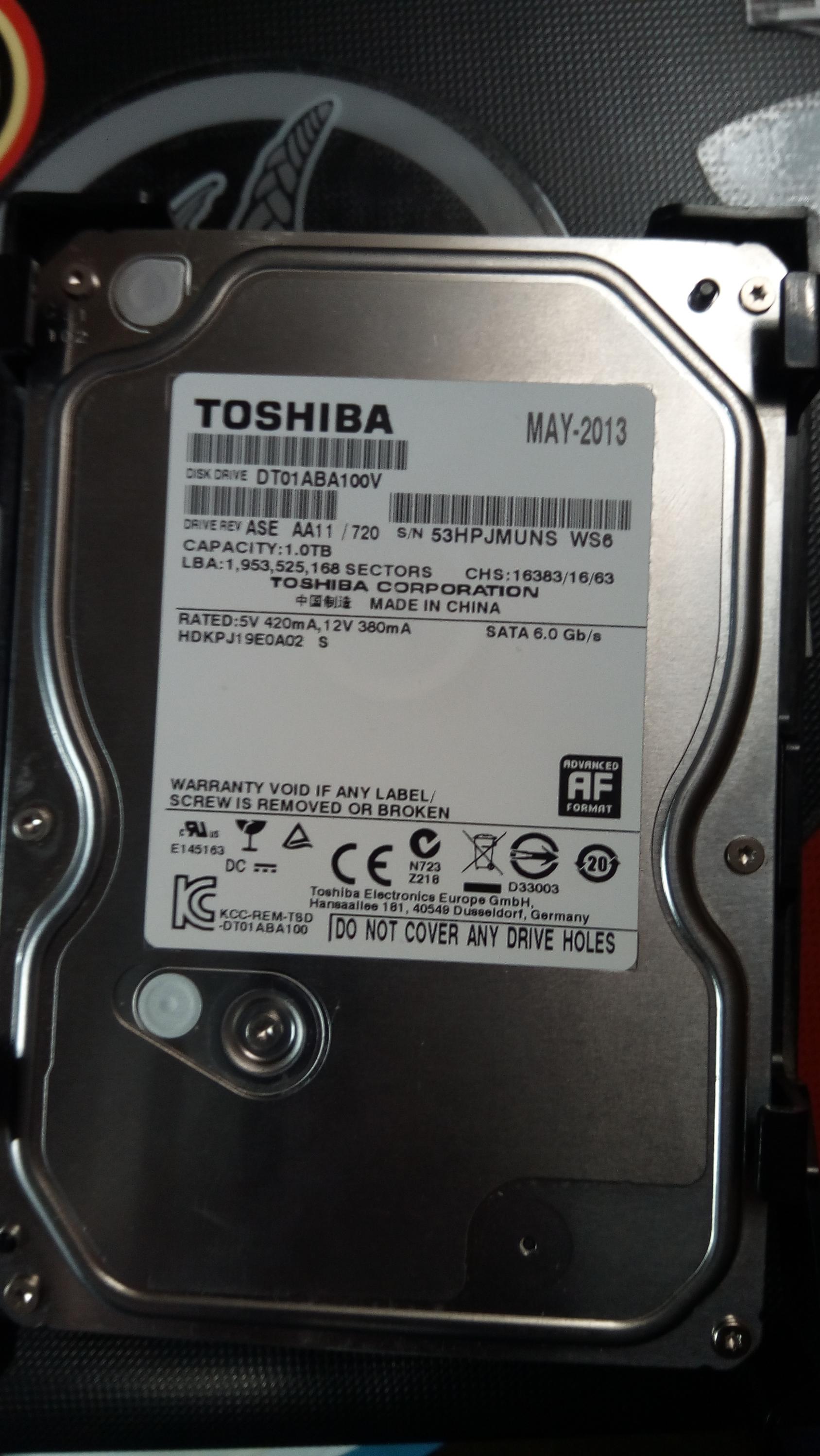

    Hey guys, I've got what I feel is a bit of a strange problem. I have a 1TB Toshiba sata hard drive that will not spin up when connected to a pc diectly with a sata cable. I've tried it in several different PC's and nothing happens. The drive does not spin up or make any noise at all and the pc doesn't detect it.
    However, it will work absolutely fine when connected to a computer through a usb to sata converter.

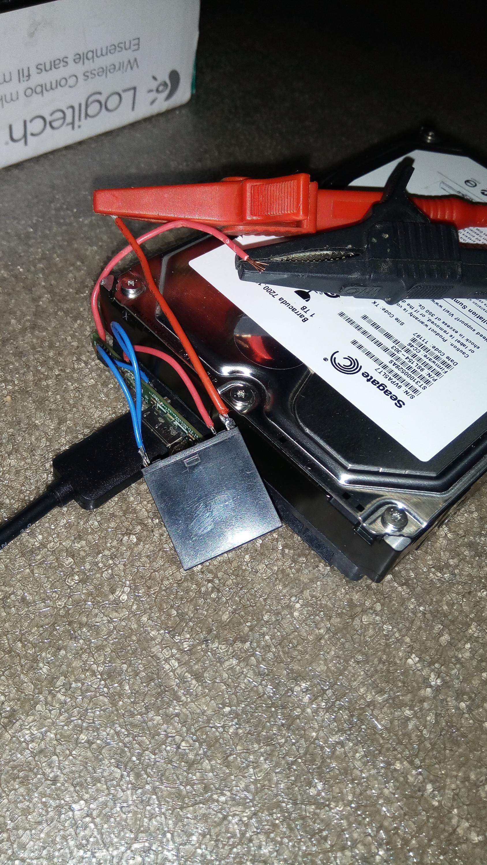

    The converter is actually the board that came from a seagate portable hard drive with a dead drive. Since it was a 2.5" drive and ran off usb, there was no 12 volt rail which is obviously required for a 3.5" drive. The small black relay in the picture is attached to the 5 volt line going to the drive so that when the usb is plugged in, it connects the external 12 volts (from a power supply) to the drive at the same time. This isn't really important just letting everyone know what was going on in the picture.
    And yes I know the drive attached to the converter in the picture is a seagate. That was just the drive I was currently using when writing this.
    I'm quite confused as to why my janky setup will make the drive work without issue but it refuses to spin up when attached directly to a pc.
    Any thoughts are appreciated.

    I bet the drive's firmware listens for the "Drive enable" pin.
    Try grounding pin 3 on that power connector.

      According to that document the drive is enabled when there is no signal and disabled when there is 3.3 volts. I was plugged in through a molex to sata power cable so there was no 3.3 volts to be provided to the drive.
      Another strange thing is that the drive will not spin up when connected to a non-pc input such as my wii or just straight into a 5v usb charger. The seagate drive will spin up and work with my wii through the same converter no problem and also spins up when just connected to the 5v usb wall charger.
      The usb to sata converter doesn't even have pins in the fist 3 slots so there is no way it is feeding 3.3 volts to it either. Just for absolute certainty I did try shorting pin 3 of the drive to ground when it was plugged into power and not spinning but nothing happened.
      The drive transfers at about 150mb/s through the usb 3 converter and seems to work perfectly when it is spinning.
      I'm confused to say the least.

          The Toshiba drive is pictured in the first post.
          My pc is a Asus M5a99fx pro r2.0 board which I believe is sata 3
          The usb adapter is salvaged from a Seagate Backup plus portable drive SRD0F1 That had a dead hard drive in it.

                        Reading through my original post I realized that I forgot to include the fact that when I originally salvaged the drive from a discarded PVR, I plugged it directly into my PC and it seemed to be working fine. I deleted the factory partitions from the drive and then my computer locked up and after reboot I could not access the drive directly again.

                          To use SATA 3 on your motherboard you need to connect to the grey sata ports.The HD has an Advanced Format (AF) 512e Sector Length https://toshiba.semicon-storage.com/...01abaxxxv.html
                          Your usb drive can use the drive because of its chipset emulation.
                          https://superuser.com/questions/1271...sb-controllers
                          Edit: if you use win xp https://toshiba.semicon-storage.com/...ed-format.html
