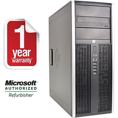

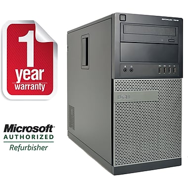

                          OK I never got around to buying a newer computer but like the looks of these two.
                          I like the HP 8300 because of the taller tower but it might be older than the Dell 7010?
                          HP Elite 8300 Tower i5 3.2Ghz 8GB ram 2TB HD $257. sold by Staples.
                          The link has the wrong tower picture.
                          https://www.staples.com/refurbished-...roduct_2445854
                          Dell Optiplex 7010 Tower i5 3.4Ghz 8GB ram 1 TG HDD $271. sold by Staples.
                          https://www.staples.com/Refurbished-...0JPw&gclsrc=ds

                            Age wise they are pretty similar (3rd. gen Core-Ix), but one big advantage of the Dell is that the OptiPlex 7010 series still took standard ATX (24 Pin + 4Pin) PSUs (at least in the mini-towers, I believe this was the last series of OptiPlex to use standard PSUs, newer OptiPlexes also use proprietary PSUs) while the HP uses proprietary connectors which will limit your PSU upgrade/replacement options (there are some adaptors on eBay, etc. and I'm sure something could be "hacked together" as well, but it won't just be a simple "drop in" to replace the PSU with a non-HP unit).
                            Dell 7010 PSU:
                            HP 8300 PSU:

                                  Dmill89.thanks for going to the trouble to post the pictures.
                                  I remember reading an Amazon review of the HP 8300 tower and they said every thing was proprietary. I guess that means all the parts even memory sticks have to come from HP?
                                  HP elite 8300 PDF service guide which I am unable download over 100 pages.
                                  http://h10032.www1.hp.com/ctg/Manual/c03612798
                                  Dell Optiplex 7010 PDF technical guidebook
                                      The memory and expansion slots should be standard (not sure how "picky" the board may be with memory, but the slots themselves are standard). The PSU and Motherboard are both proprietary as is the entire power harness, you may have noted the PSU only has connectors for the motherboard, the harness for the drives plugs into the motherboard (but the drive-end connectors are standard SATA).
                                      Really? Reminds me of old skool Compaq desktops...
                                      They used the same basic tower design for about a decade, but around the time of the 1st. gen core Ix series switched to proprietary components.
