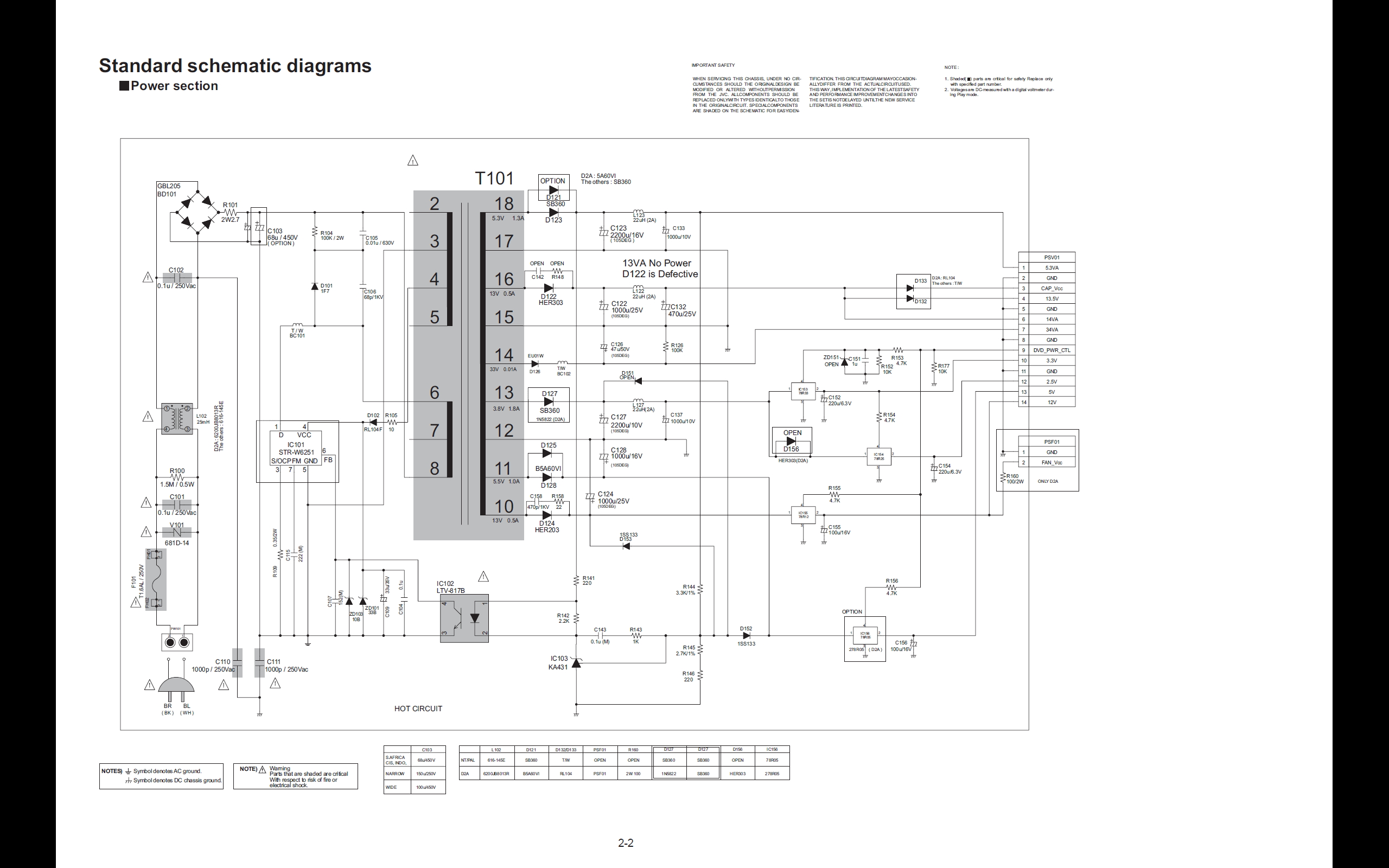

      FWIW here is the Circuit from an SM....it does not say specifically unfortunately.!
      EDIT
      I noted from the Schematic it states C103 can be either 100uF 'WIDE', 150uF 'NARROW', and 63uF 'S.AFRICA, INDO, CIS' - wondering what 'WIDE' is referring to.
      At the moment C103 is a 150uF so its NARROW.
      Voltage in S.AFRICA, INDO, CIS' is 230v

        You must check that capacitor C103 is really rated for 450v as the schematic shows.
        A quick Google search shows it is commonly rated for 250v only (cost cutting option for 115VAC countries...)
        There could be more differences too...
          Thanks Per
          Yes currently C103 is a 250v 150uF - so "NARROW' and lower voltage.
          I could change it easily for a 450V 100uf 'WIDE'
          or 63uF 450V cap..
          Not sure what 'WIDE' gives me as in what input range it then allows.
          the 63uF is meant for S.AFRICA so I know its supply voltage is 230V...pretty close to Australia's 240V supply.
          Then as you say there could be differences not listed in the Schematic...

                      The schematic I posted highlights the different Capacitor C103 as a difference between locations.

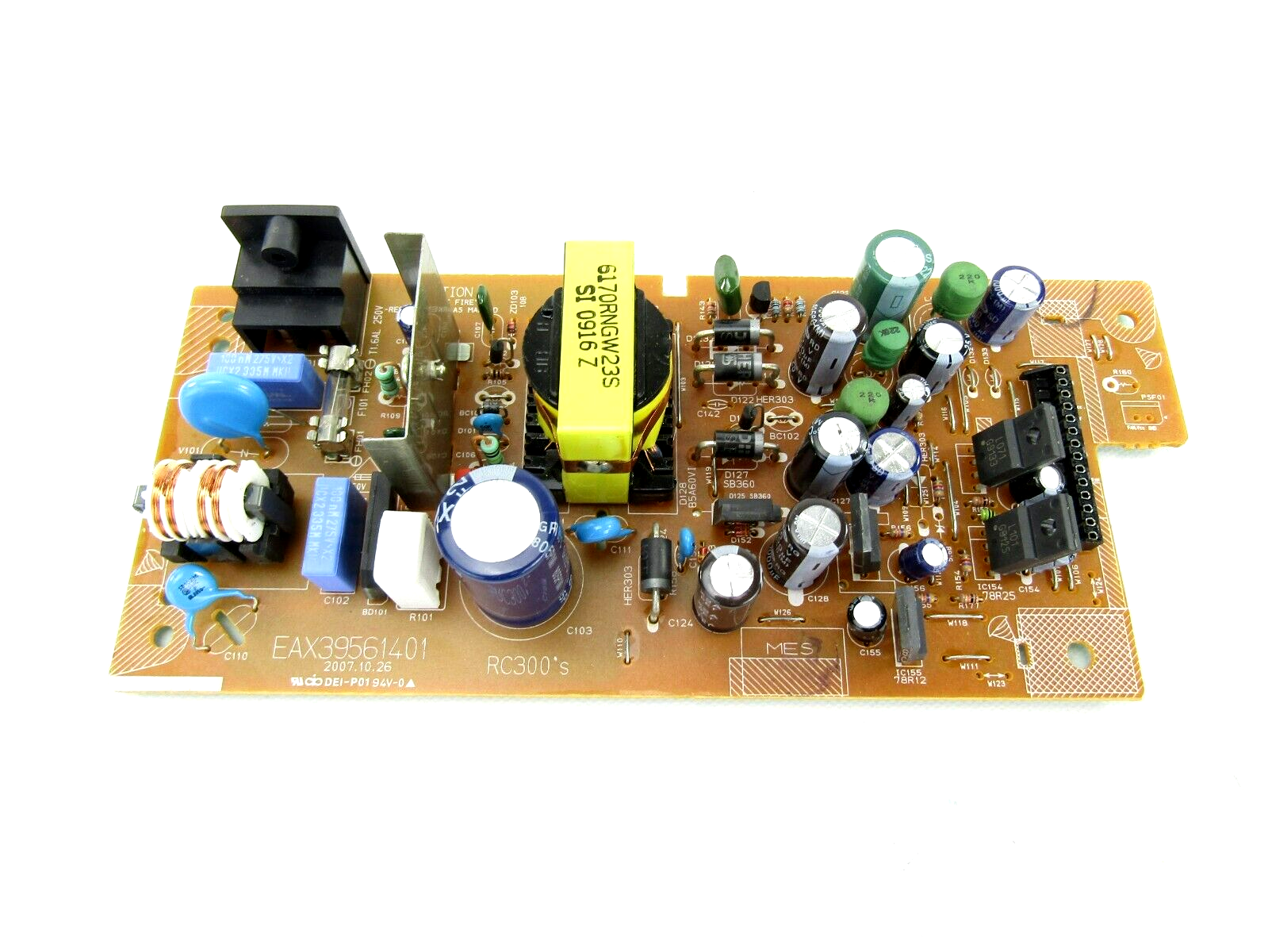

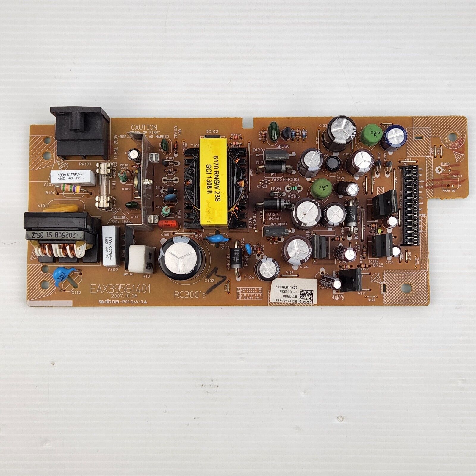

                        Uploaded pictures of a 240v EAX39561401 board
                        and a 120V EAX39561401 Board for visual comparison.
                        Physical size of Cap C103 looks the same between the two boards...so perhaps the terms 'NARROW' and 'WIDE' seen on the Schematic do refer to Input Voltage ranges?!
