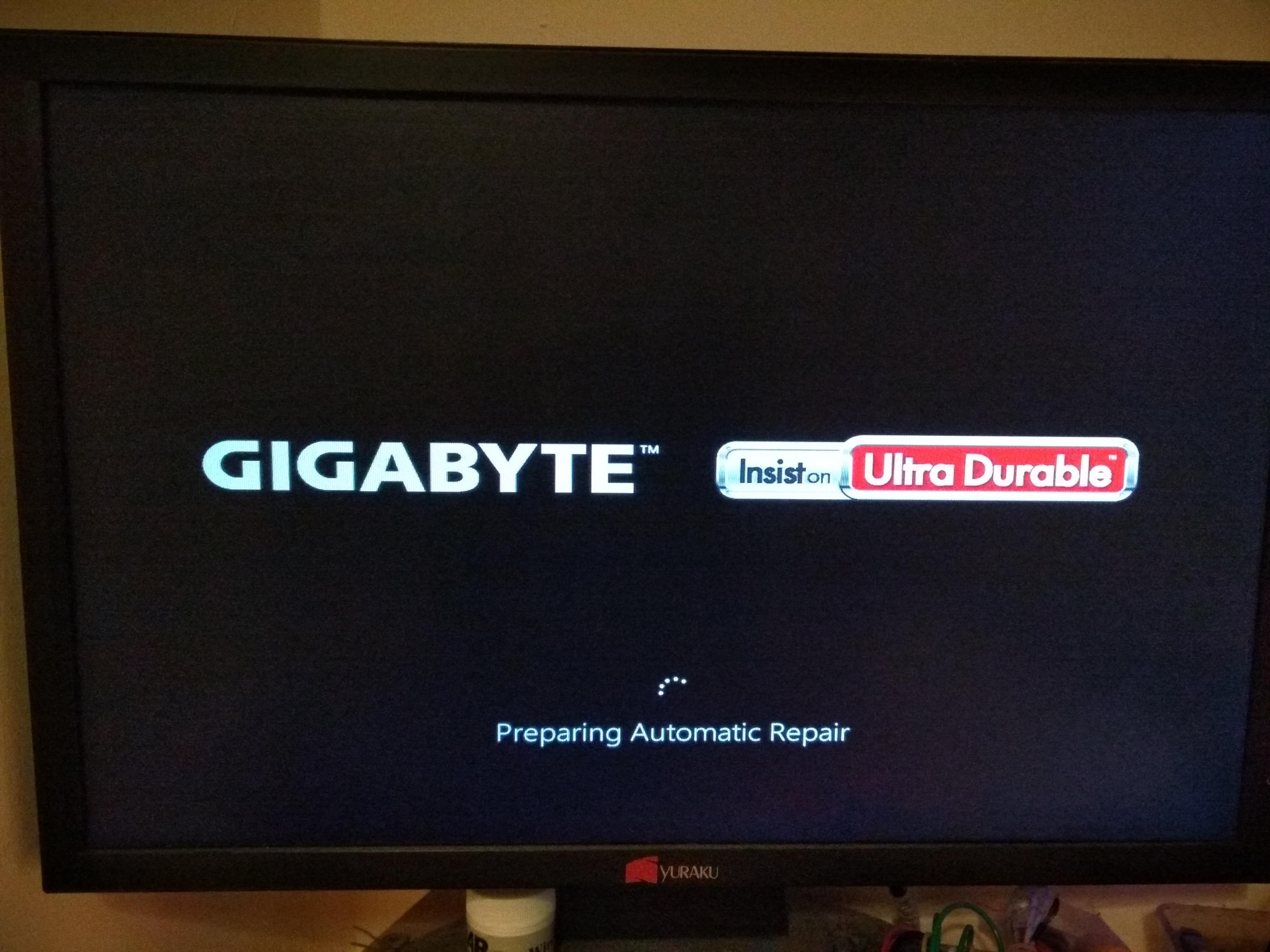

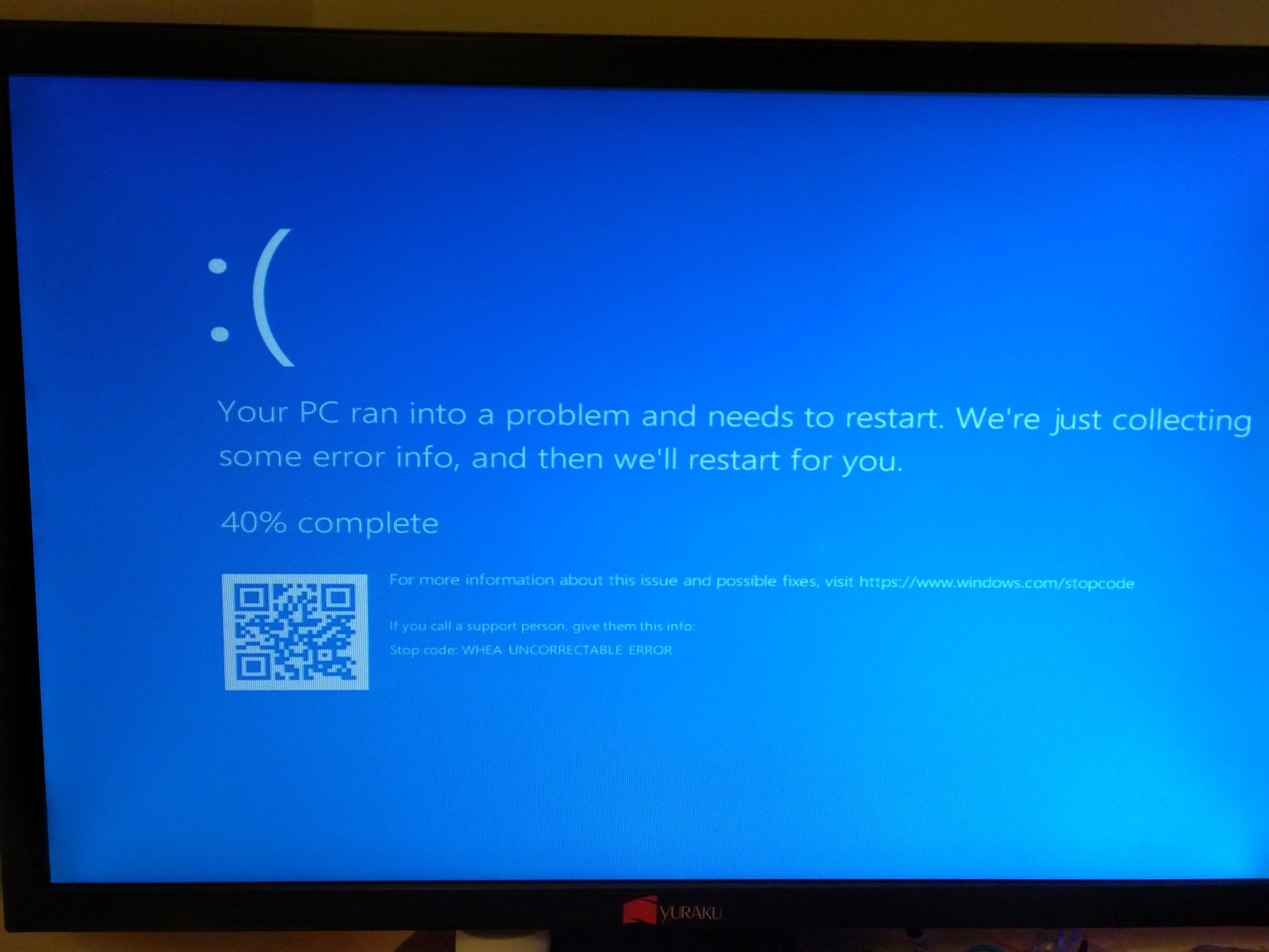

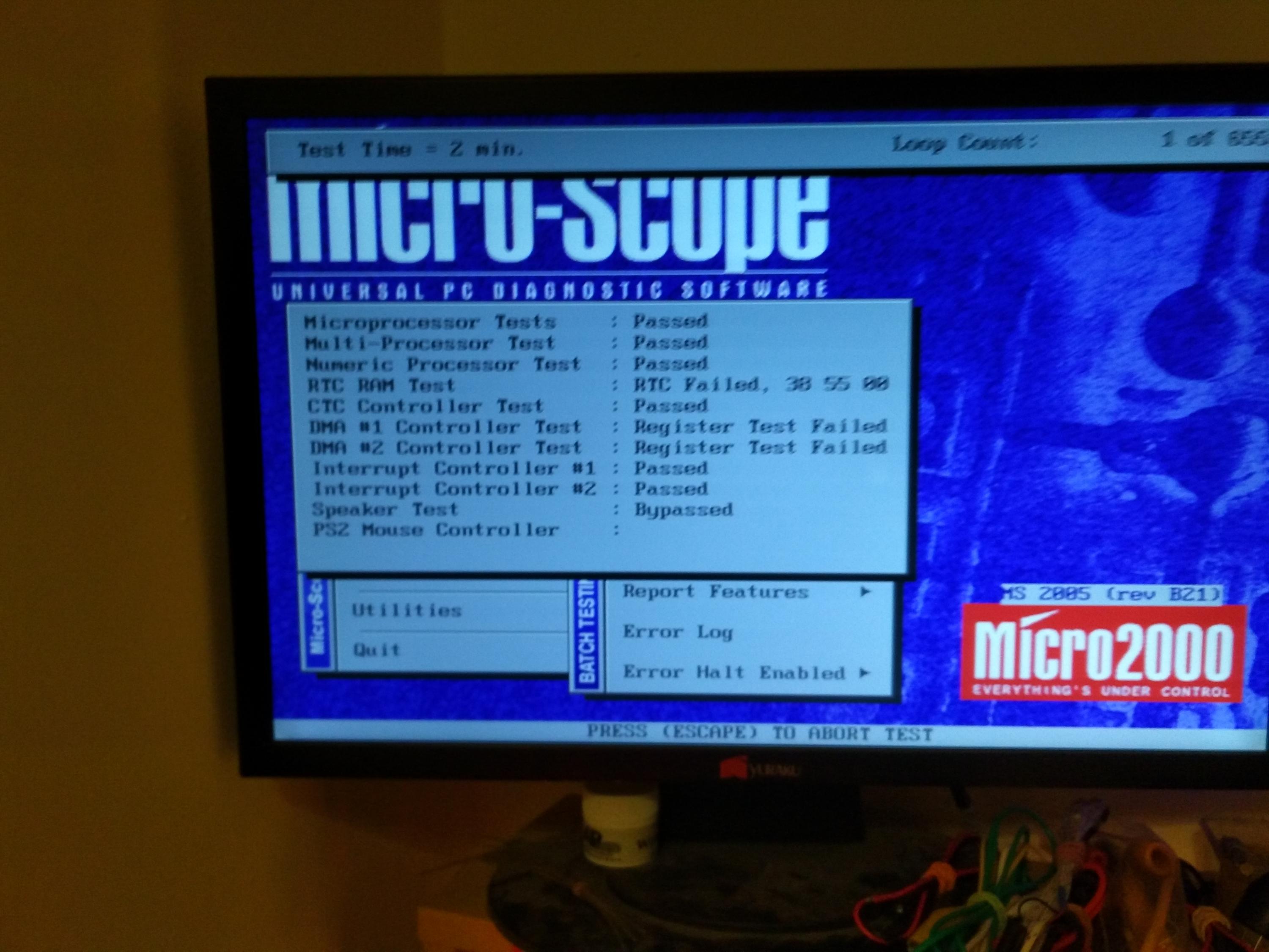

    I need your opinion, guys.
    Regarding the picture, I think that CPU is gone? Thanks in advance.
    Any ideas?

      This PC was built by the customer and worked for a few days only. In the middle of the game, PC was stopped by freezing. The customer turned off PC in a hard way by the power button. After that, the PC never log in to Windows OS.
      I bought a new MB (same model) and tried to boot into Windows. Flashed BIOS a few times. But was the same result as on the customers MB. Can I tell to the customer that CPU is gone?

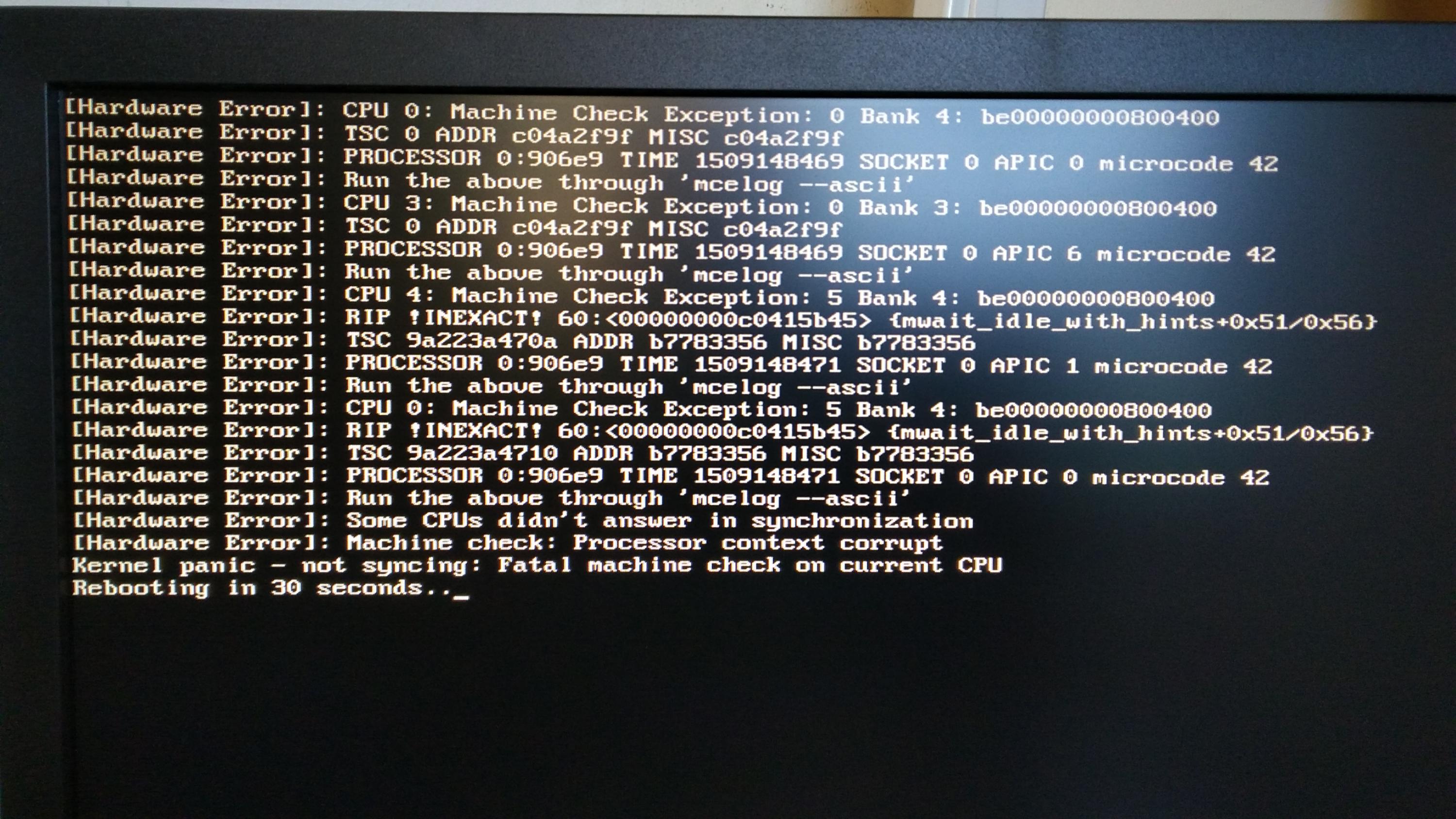

              It's a new build PC worked OK for a few days only. There is one stick of RAM only. When I trying to boot CD I still getting the black picture (see attachment) showing problems...

                  I have MB only. I have no spare CPU and have no spare RAM... When I change the MB and put back customers CPU and RAM there is the same result: can't boot from CD even. Stops and shows the problems

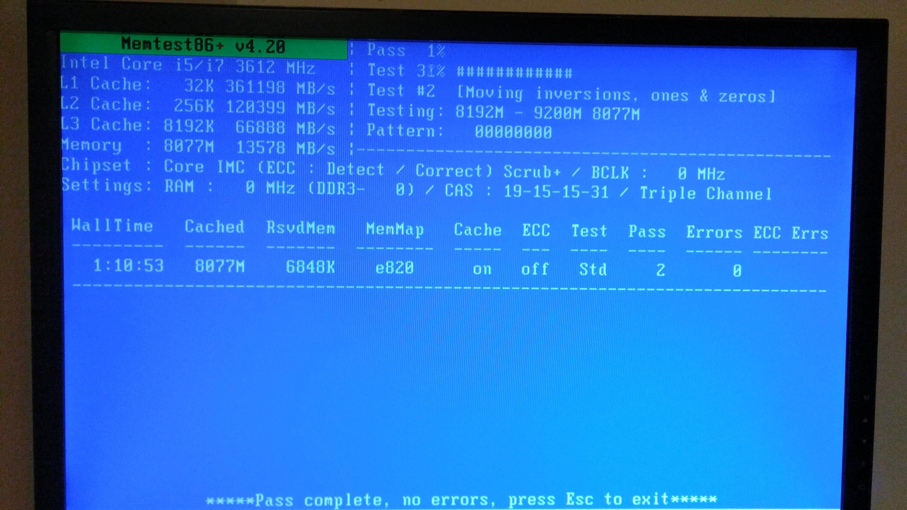

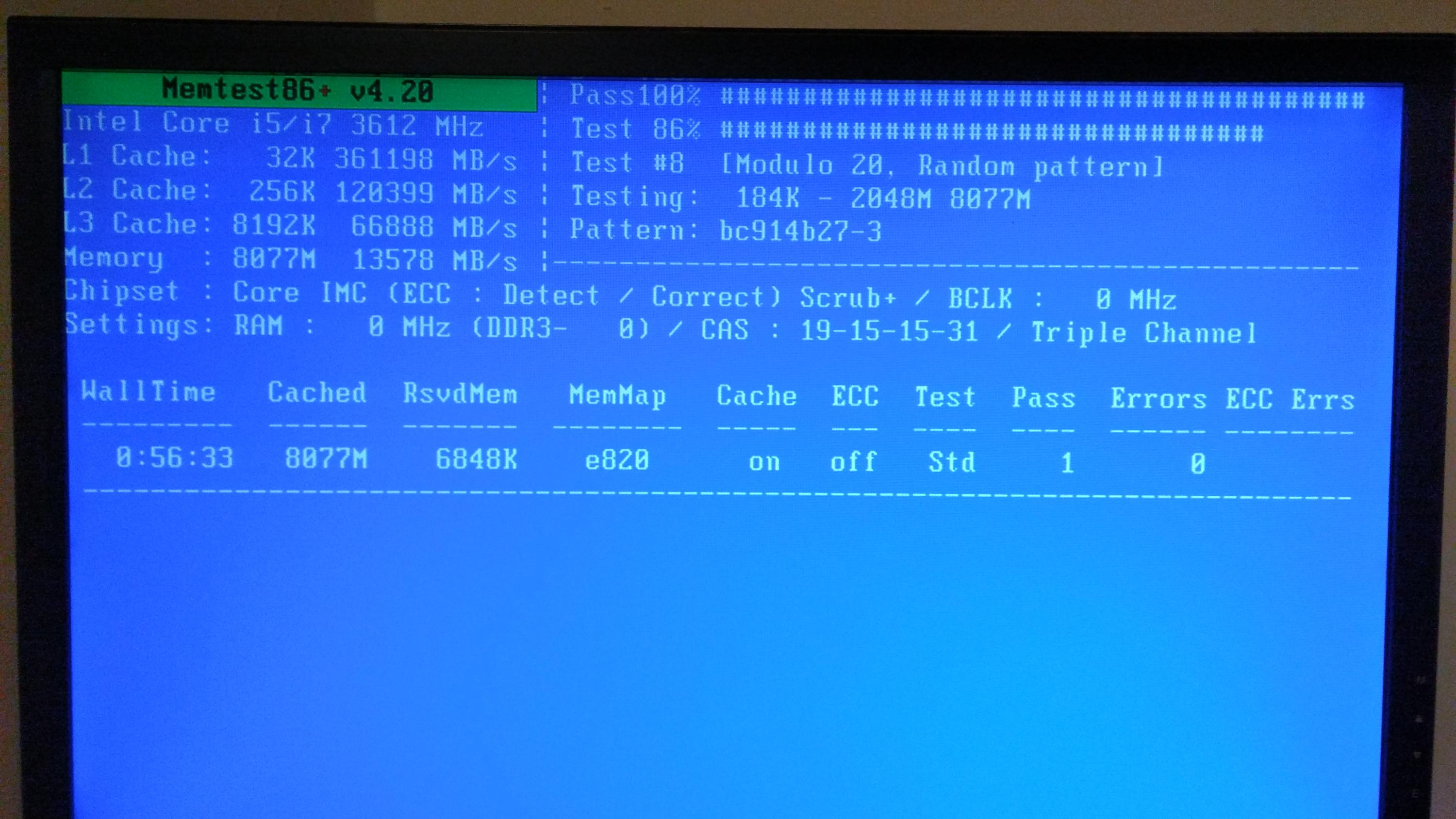

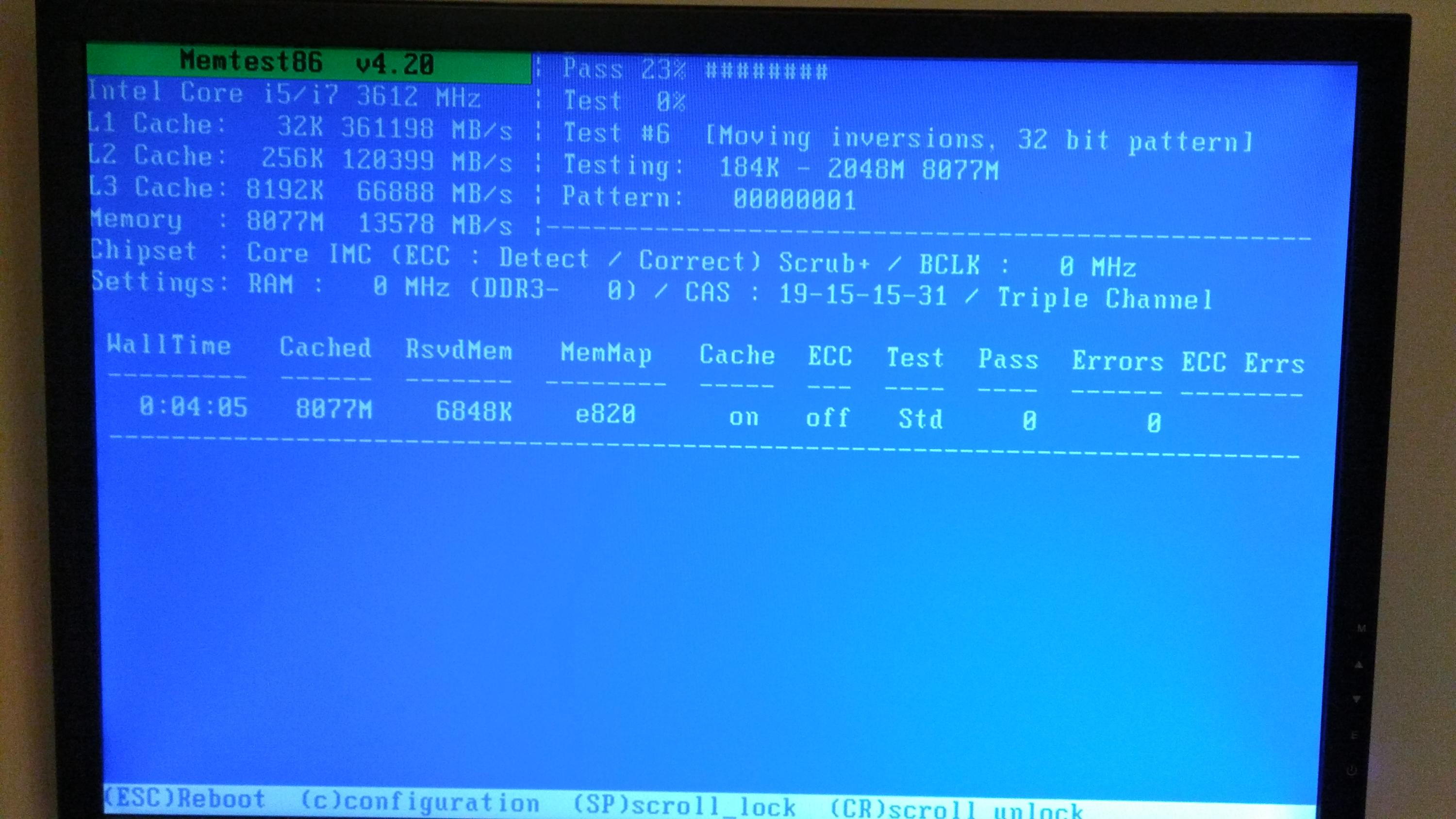

                          For some lucky reason, I got a chance to boot from "Hiren's Boot CD" (see pic). Started memory test. Here's more pics of what is going on the PC

                            Re: Motherboard Gigabyte H110M-S2H
                            Did it pass the memtest ?
                            • antas
                              • Jul 2014
                              • 148
                              • Ireland
                              I think so ... Is that mean that RAM is OK?
                              • diif
                                • Feb 2014
                                • 6978
                                • England
                                Yes, look like it has for a single pass, you've used an old version though. I usually leave it to run overnight.
                                Perhaps check the memory timing settings in the UEFI.

                                  Don't know about the PSU name, because PSU is in another side of PC. PC is on MemTest now. But it is 500W only. And it is brand new. I think that PSU power is not enough for this MB and CPU?

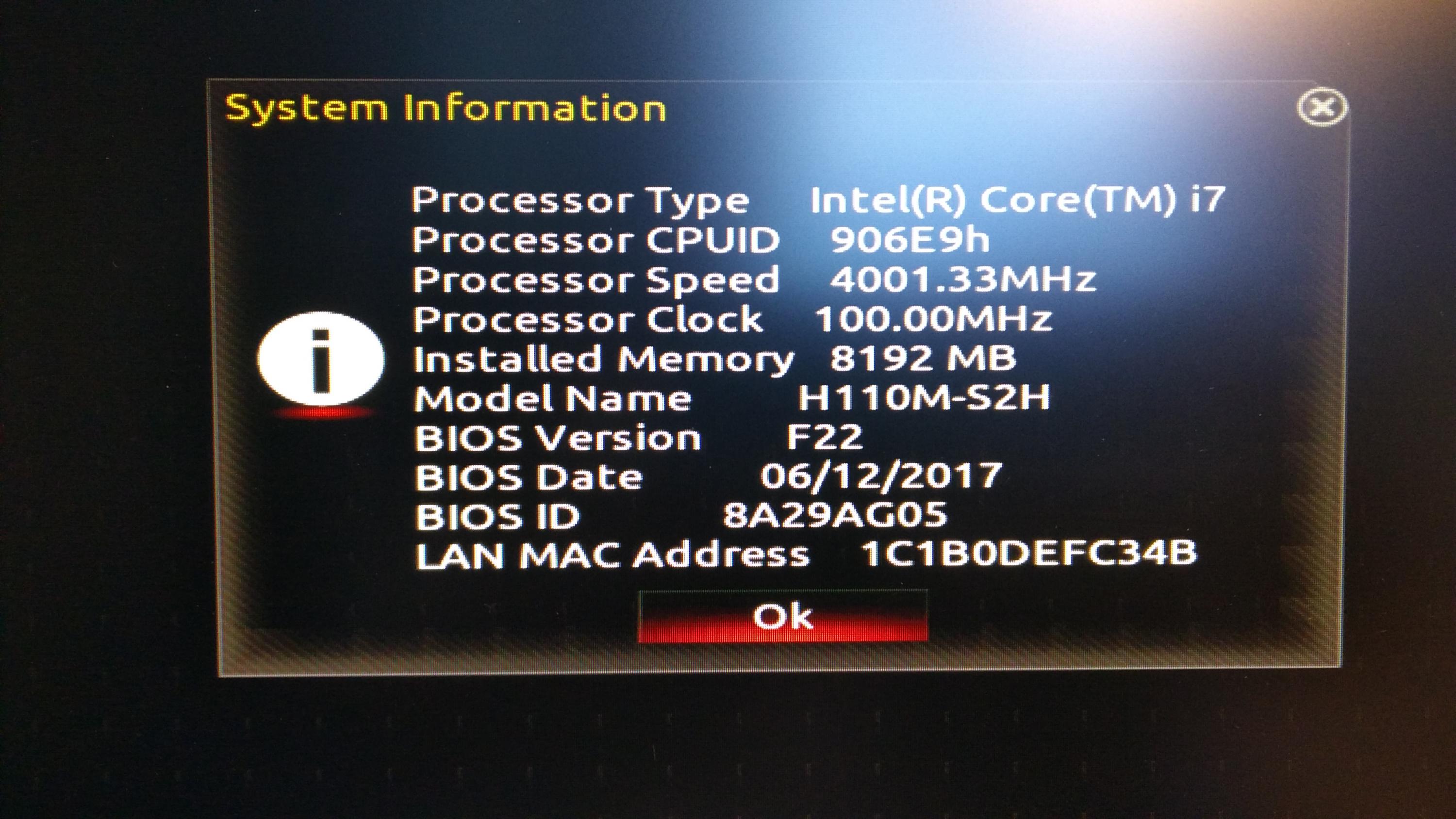

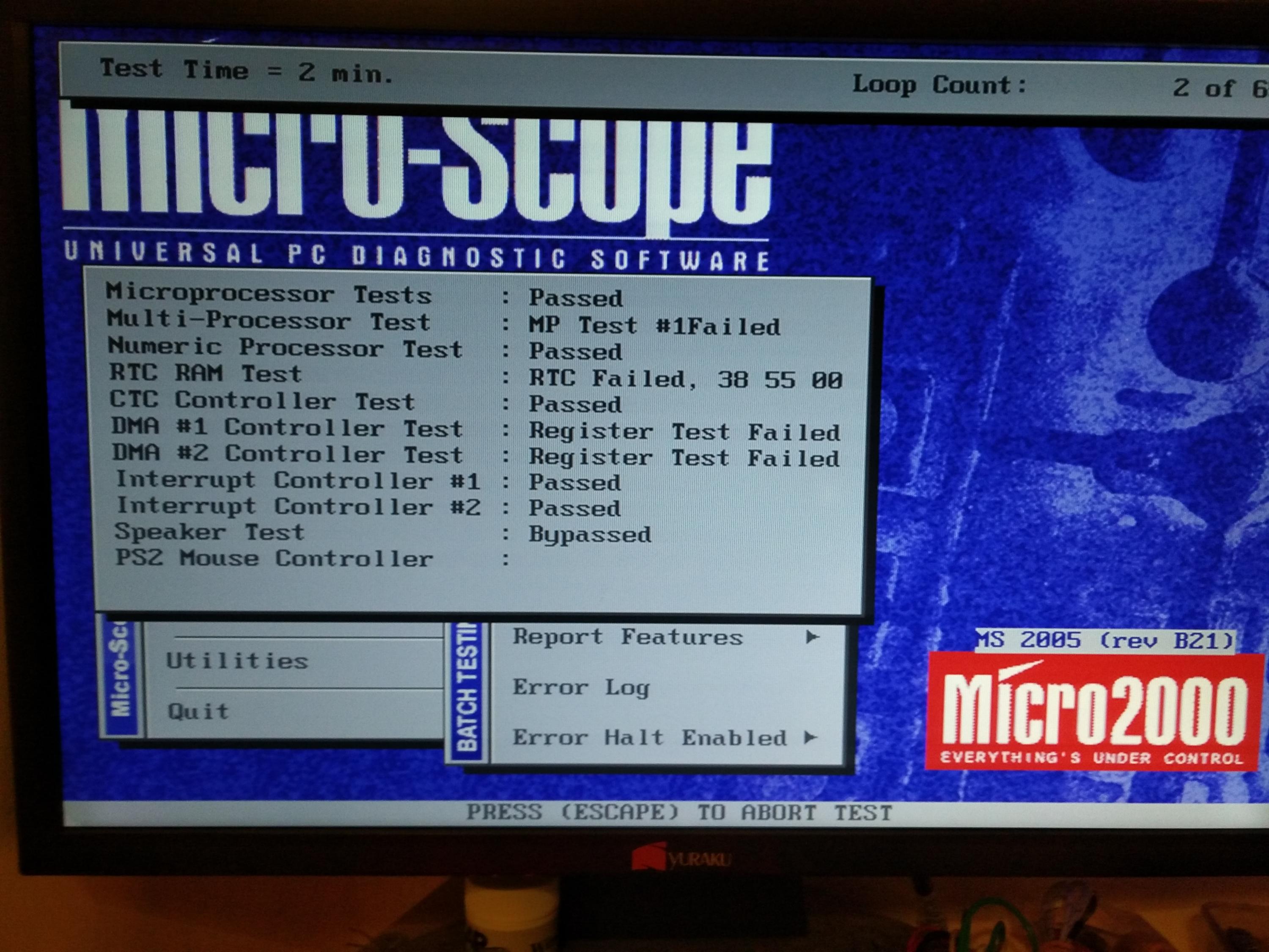

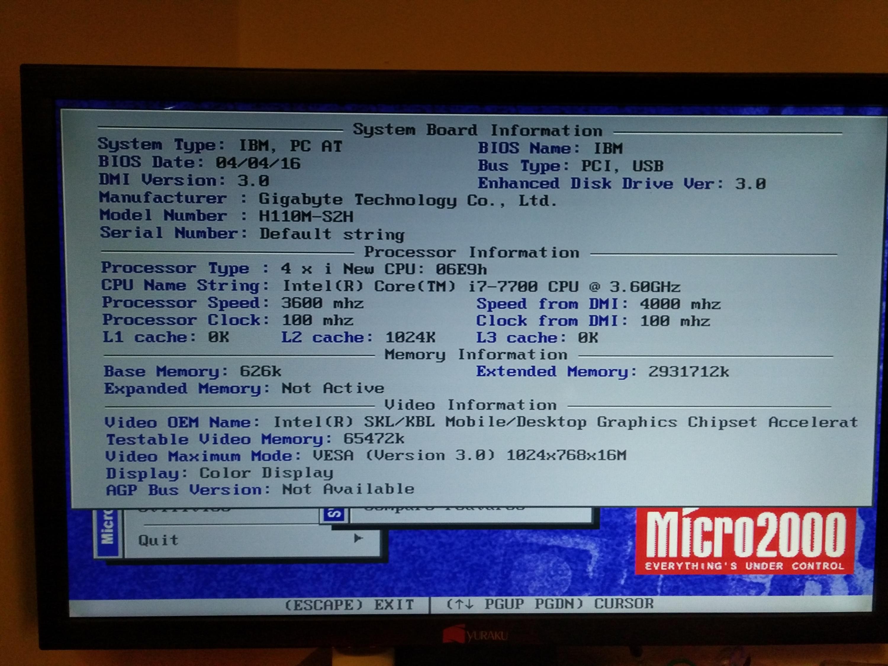

                                      Graphics card is internal. Here is more information on the pic. I have booted to PC Check Disk. By the pic, the CPU is working OK? Or it is overclocked? Here is more pics about it...
