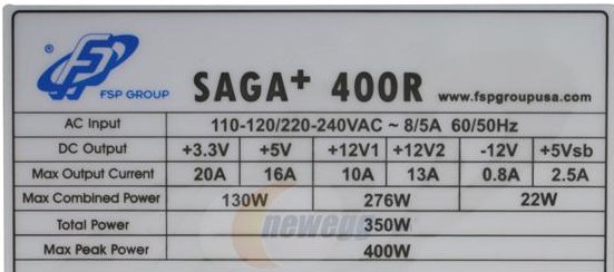

              Checked NewEgg for Fortron models and counted ~26 for desktop PCs. http://www.newegg.com/Product/Produc...13&y=30&Page=1
              The one that caught my attention was the ~$20 Special FSP power supply savings, while supplies last
              FSP Group SAGA+ 400R 400W ATX12V Power Supply - Retail
              * Fans: 1
              * Main Connector: 20+4Pin
              * +12V Rails: 2
              * PCI-E Connectors: 1 x 6Pin
              * Power Good Signal: 100-500ms
              * Hold-up Time: 12.0ms minimum
              * Efficiency: > 70%
              * Over Voltage Protection: +3.3V (4.6V max.), +5V (6.5V max.), 12V1 (15.5V max.), 12V2 (15.5V max.)
              * Model #: SAGA+ 400R
              * Item #: N82E16817104953
              * Return Policy: Limited 30-Day Return Policy
              Price after rebateN82E16817104953(s):$19.9
              Am wondering how it compares to Antec Basiq BP-350B 350W ATX12V Version 2.01 Power Supply - OEM ~$14.00 http://www.newegg.com/Product/Produ...-_-NA-_-NA-_-NA as to best buy.
              While the main use would be for P3 PCs could the FSP be also used with P4s? So question is does the 50 extra Watts offset by extra $5 really make any difference or are they both only good for P3 PCs?
              Gene

                  Definitely be mindful of where the load will be on your motherboards, and make sure the PSU matches. As momaka said, modern boards depend heavily on the +12v rail and most modern PSUs are designed accordingly. A big tipoff is the units that advertise multiple 12V rails. This transition took place during the P4 timeframe, probably closer to the introduction of LGA775.
                  A 12V oriented power supply can really suck at running older boards. Older boards depend more on the 3.3v and 5v rails, and have less use for the massive 12v power provided by most newer designs.
                  For example, I have an AcBel 550W power supply that works great on a modern Core2 board with a gamer's video card. But another, identical AcBel 550W was burned out when I plugged it in to my old 32-bit Athlon system which needs more 3.3v amperage. That system runs perfect on an old 300W Fortron.
                  The 3.3v + 5v ratings seem weak for an old system that needs those rails:
                  3.3v@20A, 5v@16A, total power 3.3v+5v = 130W max.
                  The 3.3v rating might be okay, but the 5v rating worries me and the combined power (130W) is pretty low.
                  I'm not sure how much is strictly needed, but the 300W Fortron that I've been happy with on P3 machines is rated 3.3v @ 28A, 5v @ 30A, combined wattage of 3.3+5v = 180W max. I think I have a Sparkle that's rated 5v@25A and it also works fine. But 5v@16A is worrying.
