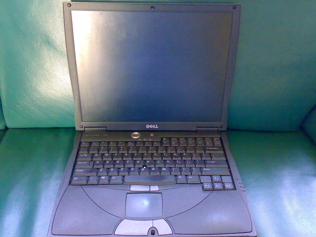

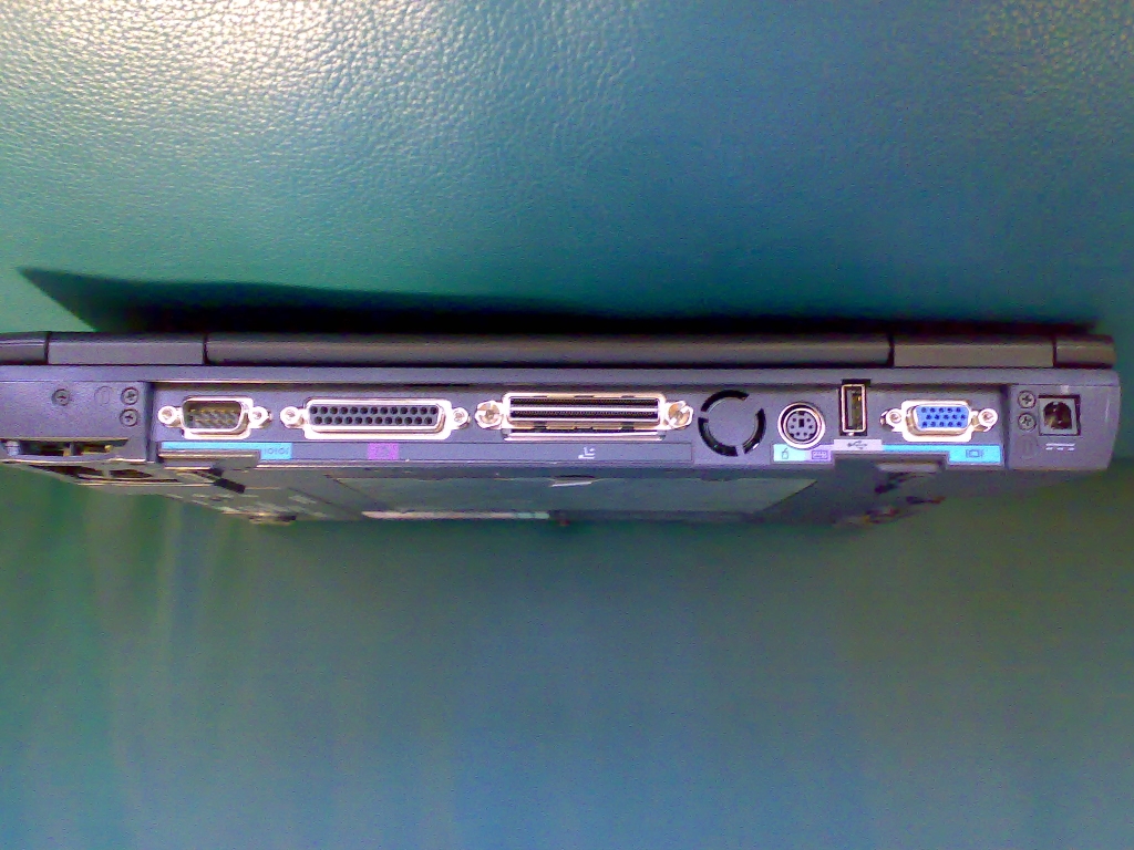

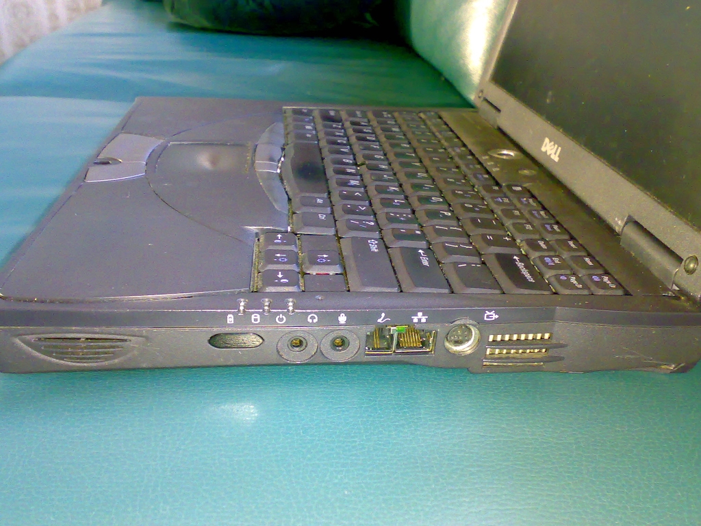

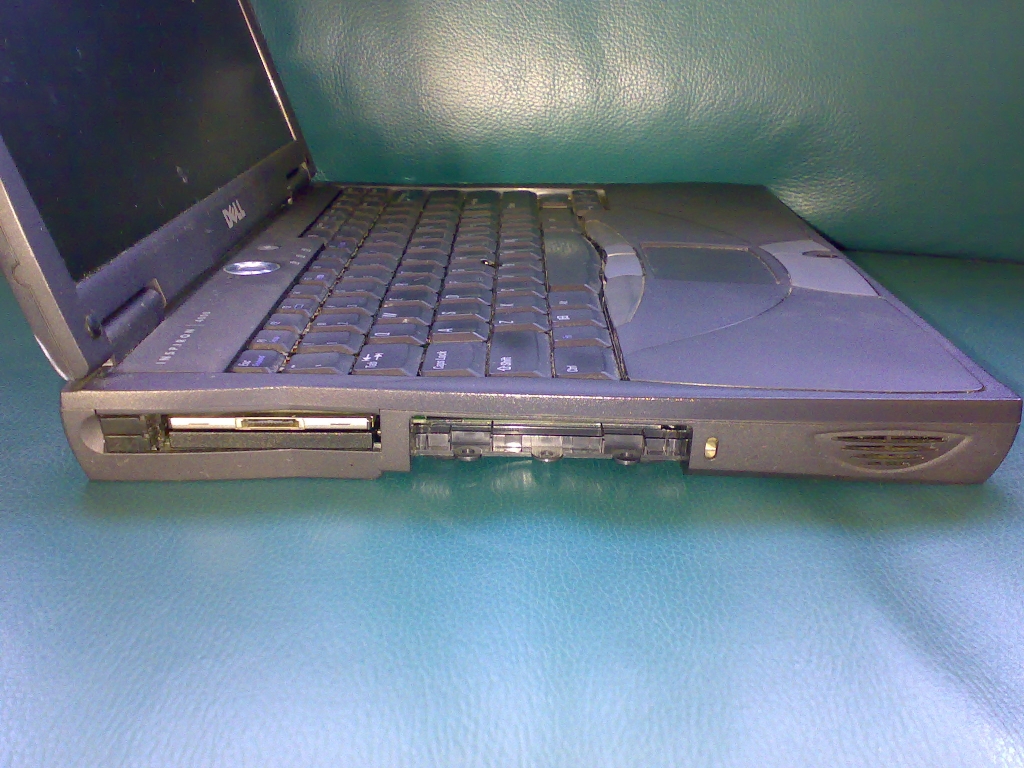

    Today I was bored and decided to take my dads car for a drive to the open market a few kilometers down the road from my place. I was actually going there to look for an IEEE 1284 parallel cable but ended up buying a second hand AS-IS laptop for $20AU and forgot about the parallel cable.
    I was looking through Pentium's thread the other day about his purchase of a Norsat Newslink laptop with no AC adapter and I thought I would never end up like him and buy a laptop with no AC adapter. Well that's exactly what I did so I am stuck in the same boat as Pentium, I don't know if this laptop works or not. The Dell Inspiron 4000 that I bought has no AC adapter. It uses the Dell PA6 AC adapter which I've gotta find.
    I've opened it up and I can't find any visible damage or any being spilt into the electronic stuff inside it.
    What I did find was a large amount of human hair in the laptop (falling in through holes in the keyboard assembly) in which I have cleaned out.

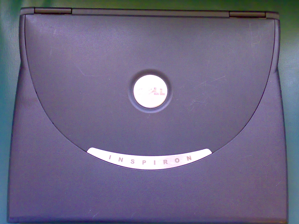

    Physically on the outside it's in a good condition with a few scratches from wear and tear but no bumps or dents.... apart from a small broken plastic tab above the ethernet port, but it's not serious. There's no hard drive caddy so I can't put in a hard drive. The caddy will come later If I can get this laptop working again. It would be nice If I could get this laptop working again because I can then replace the Inspiron 3200 that I currently use for school.

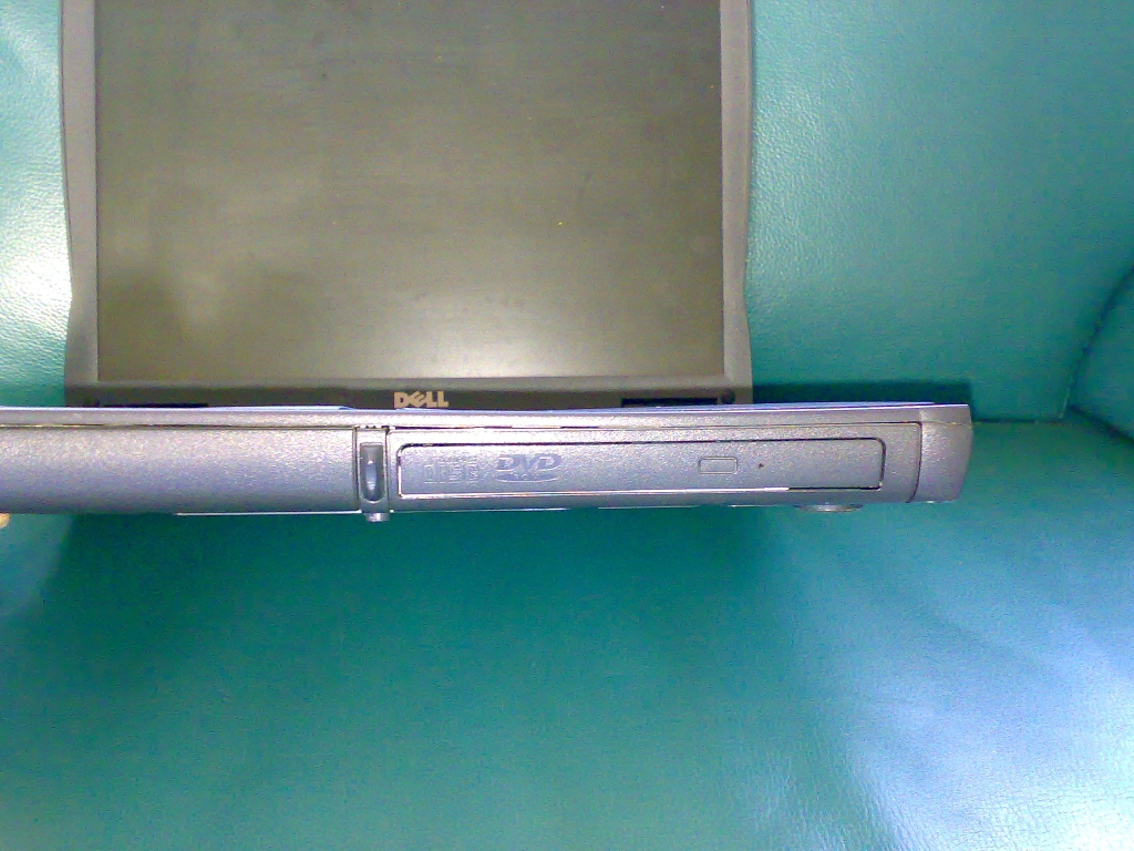

    I don't know what CPU it has, but I can see 2x 64MB PC100 SDRAM chips and a DVD ROM drive. The old owner of this laptop probably forgot to take back the Netgear Network card that's in the PCMCIA slot, so I have that one now except I don't have the dongle part with the Ethernet port.... but that doesn't matter because I have a Xircom PCMCIA Ethernet card here.
    What I did find though was the CMOS battery (made up by a few cell batteries to make 7.2V and is manufactured by Varta). It's leaking some white stuff that looks like a powder and I presume that is battery acid. There is no residue on the motherboard. I think there was like a few specks of power in which I have cleaned out. The battery is mounted on a seperate metal bay and a wire connects this battery to the mainboard (looks like Dell probably knew thae battery was going to leak one day and did the wise thing not to put it on the mainboard).... so this is where I stumble. I don't know where I can find this CMOS battery so I don't know If I can make this laptop become good again.
    What do you guys think I should do?
    Oh, and here are some pics.
    Thanks.

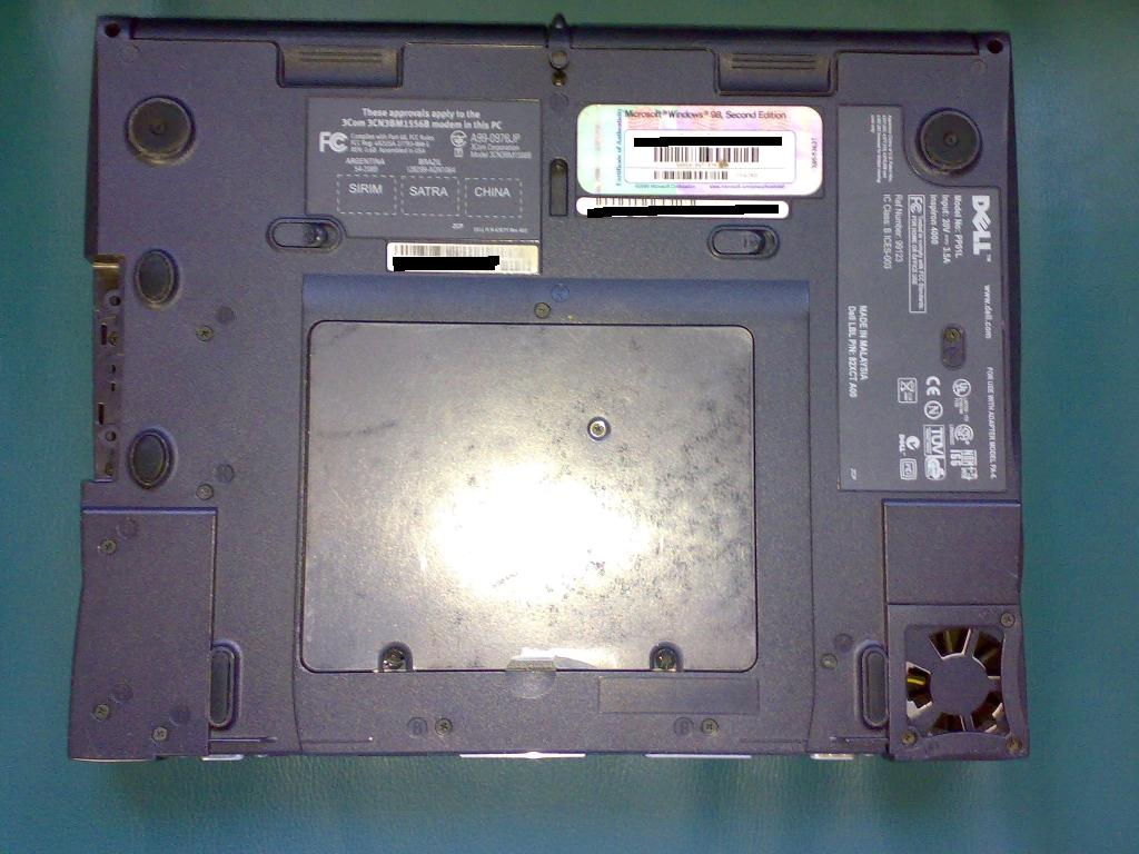

      I don't think that you really needed to black out the code for Windoze 98!
      A co-worker gave me a laptop last year. He wouldn't give me the power supply, he has other laptops and wanted to keep it as a spare. What a dipsh*t, it most likely won't work with a different laptop! And he runs our water meter/meter reading department.
      I ended up buying a knockoff one off of eBay. It was less than US$10, but shipping was twice that. I cleaned it up (WinXP) and gave it to my niece. I guess it still works OK.
      With WIn98 in it, this laptop is a perfect candidate to install Linux on. I would recommend Ubuntu or even better, Linux Mint. Linux mint is a Ubuntu derivative. Both are good for Linux newbies.

            hehehe. That's mobile PIII and you can upgrade it to 900MHz. I own C600. EXACT chassis internally. I picked up brand new motherboard for very little cost (16 bucks) and stuck it in to replace the defective board. The new board is revised for better cooling design and emlimated second 1" fan that is extremely noisy leaving one blower to cool the CPU.
            It will take pair of 256MB PC100 144 pin SO-DIMMs.
            Secondly, power bricks are very plentiful, just find any Dell with same plug, even the one from CPi, CPx also works.
            Cheers, Wizard

              A nice notebook: quite sturdy, P3 with the old but good 440BX (so up to 256 MB of ram per slot, 512 MB in total), ATI Rage 8 MB (enough for dvd playback, but surely not for games); major drawbacks are heat issues and the single USB 1.1 port. Yours laks the trackstick too, that's a pity. You can find manuals at Dell site.
              Try it with a live cd linux: 128 MB should be enough for Knoppix 5.x with XFCE. Once you find everything is working, buy an used Dell psu (it should cost $15-20 plus shipping) and an hard disk frame (I suspect way more expensive than a psu). In a second time, you may even think about upgrading ram to 256-384 MB, which should be plenty for a recent linux distro and sufficient for XP.
              Note: next time do not buy a portable without important pieces unless you're looking for spare parts

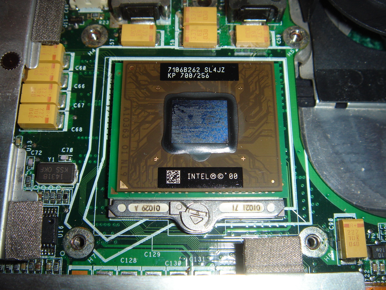

                      Here are some pics of the internals that I took as I cleaned the laptop out. The CPU says KP700 from the picture. Is that a PIII 700 or a Celeron 700?.
                      In regards to why I bought the laptop, well I actually bought it because I wanted the 128MB of SDRAM for my Inspiron 3200. So last night I took the 2 memory modules and put it into my Inspiron 3200 and they worked out fine so I got one part done. This laptop now has 64MB of RAM instead of the 128MB. If I can get it to work again, the 128MB the inspiron 3200 is going back in here.

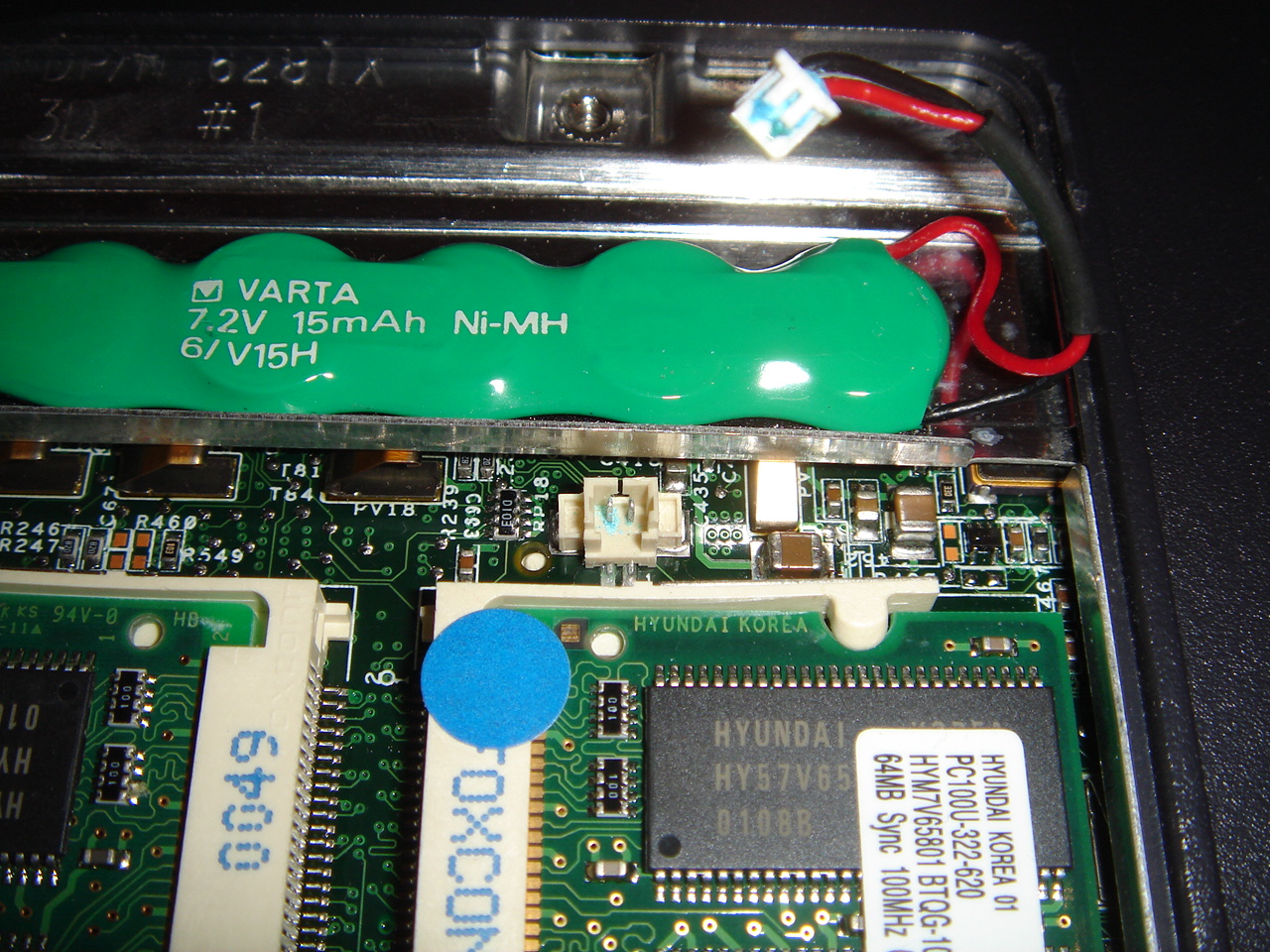

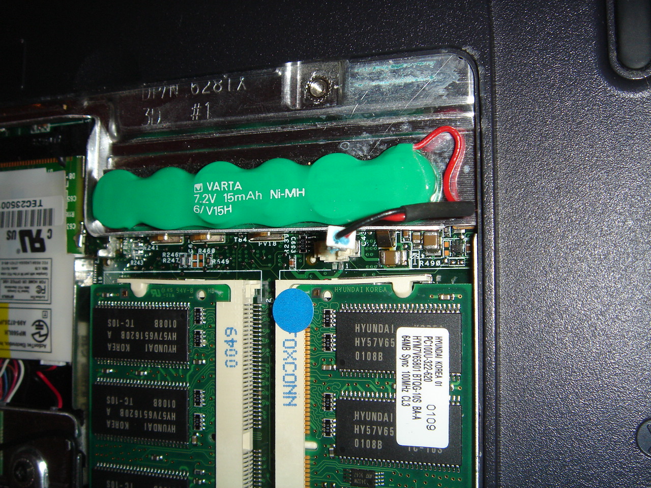

                      I have also enclosed a picture of the CMOS battery which was leaking acid. Um, well I found that there is very small leakage onto the motherboard.... it somehow followed the battery cable and now has residues on the connector. It's very hard to see, I know but there is some blue stuff on the metal connector. None of which has actually touched the motherboard PCB. I cleaned the residue off with isopropyl alcohol and it's about 90% gone, I am just wondering if isopropyl alcohol will damage anything because I have a feeling Ié used the wrong chemical.

                        Re: Old, but new.
                        http://www.google.ca/search?hl=en&q=...e+Search&meta=
                        This is PIII 700 mobile. That is correct way to find out what they are.
                        I use S-spec number.
                        About the battery, you can find the same size of NiMh coins that is used for cordless phones and make new one. You will need new connector or get new battery pack from ebay. Or leave it out wholly because it only serves the sleep power just to keep small areas live while changing batteries.
                        You'll MUST need 256MB SO-DIMMs if this notebook works. No if or buts.

                          OK well I feel more confident that I can just make a new battery. I thought I had to go buy one except they didn't make any at Dell. I just called Dell and they said they don't have any spare parts for this laptop, not even the CMOS battery or HDD caddy. I need to buy a HDD caddy if this thing works so where can I buy a HDD caddy?

                                  hmmm... i dont know what battery is in this laptop, so i cant look up a picture of the connector.
                                  i also had a laptop here a while ago. same problem.. no AC adapter and propritary connector. it also had a battery (of course flat after sitting for more than 1 year)
                                  what i did was find the pinout of the battery pack (as i couldnt find a pinout of the power brick connector) and i tried to charge the battery.
                                  unfortunately i didn't hold a charge..
                                  so i tried to connect a power supply (close to the batteries original voltage and amperage) to the battery pins on the laptop, after i found out what is + and what is - (this battery had 4 pins)...
                                  i was able to power up the laptop..
                                  was beeping all the time (low "battery") but it worked .. good enough for testing
                                  edit: i'm talking about the main battery... not the BIOS one..
