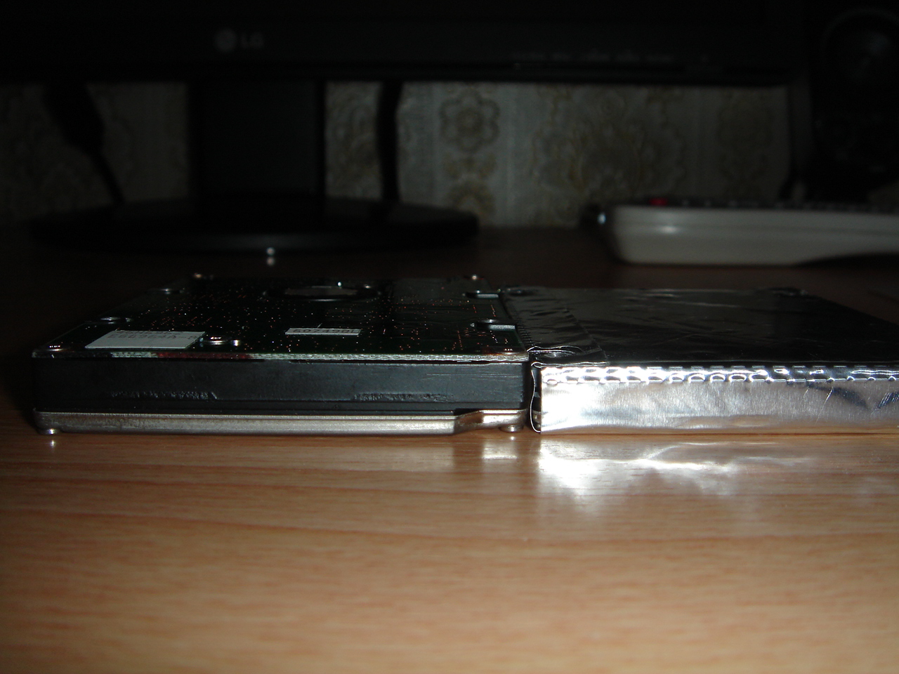

        There are 19 mm, 17 mm, 12.5 mm, 9.5 mm, 8.5 mm and maybe even thinner 2.5" drives. Currently, 9.5 mm is the most common, but 12.5 mm is/was a common size for many years. Barring mini-notebooks, almost any notebook should be able to accommodate a 12.5 mm drive. I'm guessing that you must have tried to squeeze in a 17 or 19 mm drive, which probably won't fit in most Dell notebooks.

          2.5" drives come in different heights.

              The drive I tried to stuff inside that laptop was a 12.5mm drive. the 9.5mm from my Toshiba fits in it perfectly. But I still want to raise the question.... will this Inspiron 4000 support an 80GB hard drive as I've heard that laptops made before 2004 only supported up to 32GB?

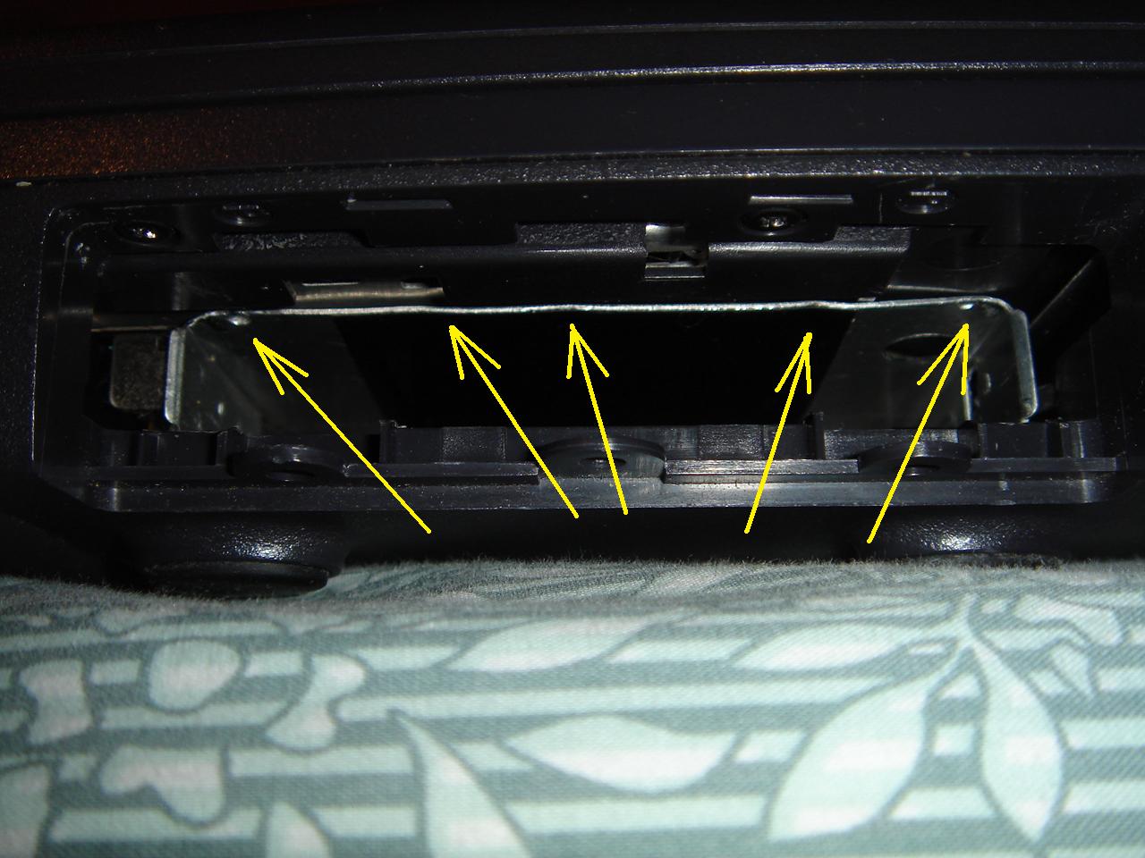

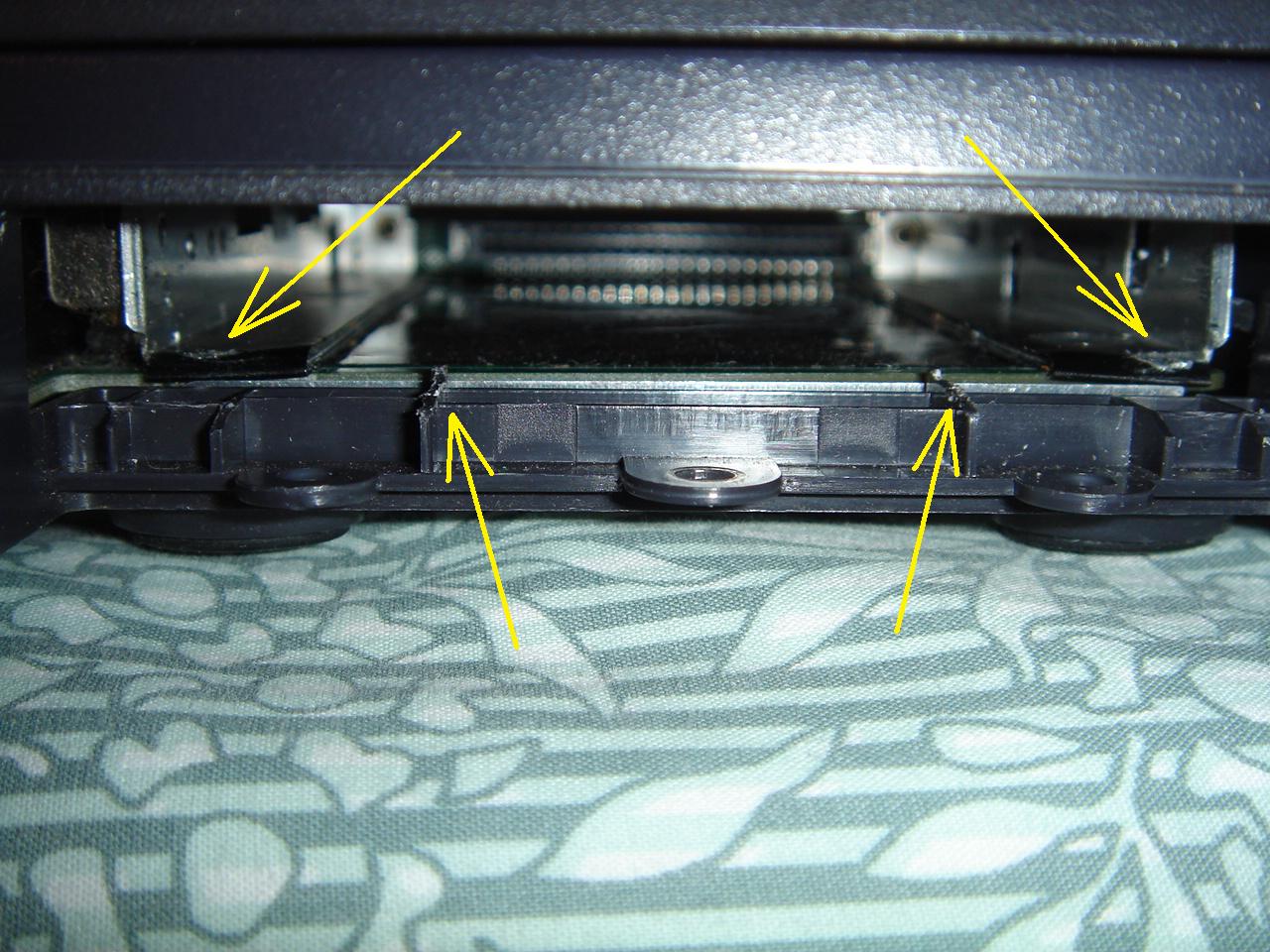

                      #50
                      Re: Old, but new.
                      The following are pictures of the silly damages I made'due to my stupidity when I tried to force the oversized well at least I learnt that there are different thicknesses in hard drives now....
                      Anyway, the yellow arrows indicate the areas of damage. As you will see, the metal cage that holds the hard drive has multiple bends as I used pliers to extend the cage very slightly at those points as I tried to fit the HDD.... I dunno if bending it back to it's original shape will work, but I think that may make it worse so Ill laeve it alone.
                      You will also see that the plastics on the case are slightly damaged and that the thin plastic tape on the har drive rails are slightly ripped as the metal base of the HDD scrapped along it. That also indicates the stopping point of the HDD as it did not fit, so luckily I didn't go too far inside the laptop, otherwise my HDD would be permanently stuck.
                      And also one of the images represents two hard drives I tried. The drive on the right that's covered with aluminium foil is from my Toshiba laptop and fits perfectly. The one on the left on the other hand is a Fujitsu MPC2040 4GB HDD that I was trying to force in which didn't fit. As you can see the drive on the right is thinner.
                      Hopefully the damage I made isn't too serious. What do you guys think? All I know is that my laptop still boots.

                      • i4004
                        • Oct 2006
                        • 2029
                        #51
                        Re: Old, but new.
                        no damage there.
                        when hdd is damaged you'll know allright...hehe
