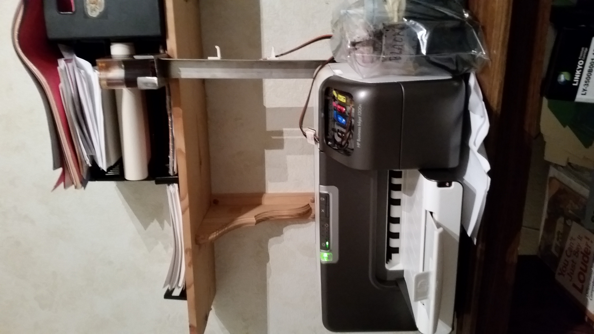

Look what a customer gave me
  • Uranium-235
    Comrade Glimmer
    • Aug 2007
    • 5045
    • US
    I still need a cyan printhead
  • Uranium-235
    Comrade Glimmer
    • Aug 2007
    • 5045
    • US
    Re: Look what a customer gave me
    Ugh it turned out sideways
            Look...closer
            • ratdude747
              Black Sheep
              • Nov 2008
              • 17136
              Squirt bottles of ink?
              sigpic
              (Insert witty quote here)
              • vinceroger69
                • Mar 2012
                • 6714
                • uk
                looks like pipes going to the top of ink cartridges on printer?
                • diif
                  • Feb 2014
                  • 6978
                  • England
                  I think its called a continuous ink system. Uses the cheap bulk ink in the bottles instead of one of rhe most expensive liquids on the planet. Good bits of kit for photographers and dodgy DVD vendors.
                    • 31294
                    cis kits can cost as much as a cheap inkjet.
                    • Uranium-235
                      Comrade Glimmer
                      • Aug 2007
                      • 5045
                      • US
                      This one, did not. Made custom in japan. The printer itself also wasn't a chepo (at least at the time it wasn't). Has an ethernet port too. Hp eprint even works on this old thing on my phone.
                      Each head has a load of 24,000 pages
                      Thing is you have to print once a week or it clogs. Also the heads are getting harder to find
                      • Logistics
                        • Apr 2007
                        • 721
                                this thing has been used by my customer constantly, for years. No jams, only issue he had is with the heads drying up. I found some heads finally, CMY, new for $49 bundled, free shipping. He had an unopened black head I already put in
                                Its a businessjet 1200, its built for high volume printing, but the heads are built like crap if you go without printing for a long enough time, but I think I have that problem solved. On my Ubuntu server I added the printer as an IP printer in CUPS, and have a cron job set to lp a pdf that contains a CMYK print test page every day at 4pm

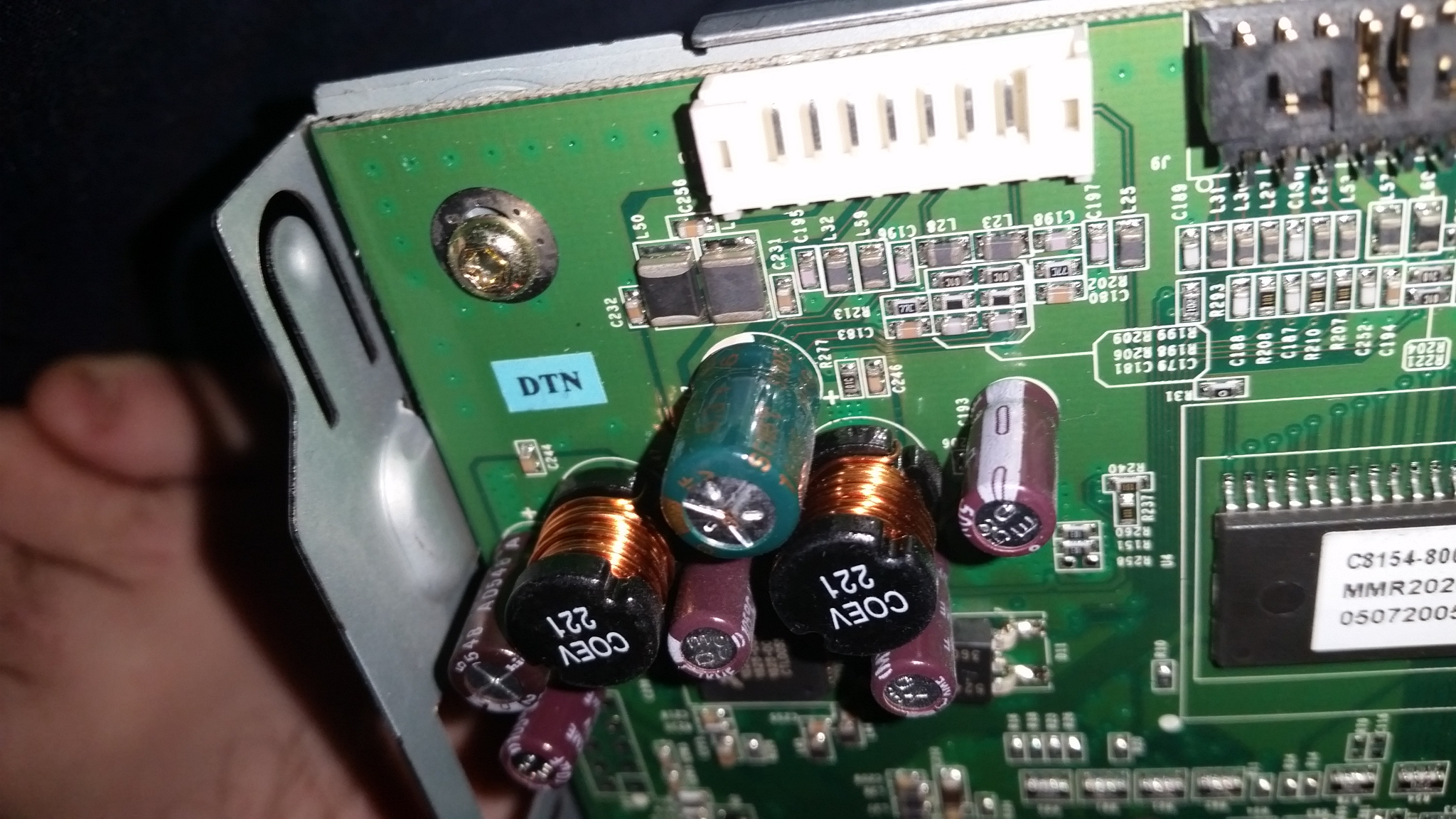

                                  Well well. This printer has displayed some issues.
                                  *startup light blinks, then printer turns off
                                  *middle of printing lan connection drops, printer soft reboots
                                  *unstable high pitched whine from the back before successful power up
                                  As I suspected...fucking taepo
                                  Im guessing sc105c is model and obviously max temp. Taepo pdf says for switching power supplies....so panny FR?
                                    Shame on you!! Cap check is a standard with any free hardware!!
                                    <--- Badcaps.net Founder
                                    Badcaps.net Services:
                                    Motherboard Repair Services
                                    http://folding.stanford.edu/
                                    Team : 49813
                                    Join in!!
                                    Team Stats
                                      • 31294
                                      FR - universal fix!
                                        Well, it worked fine most of the time
                                        But im afraid the unstable voltage damaged the magenta cartridge chip, now reading 0
