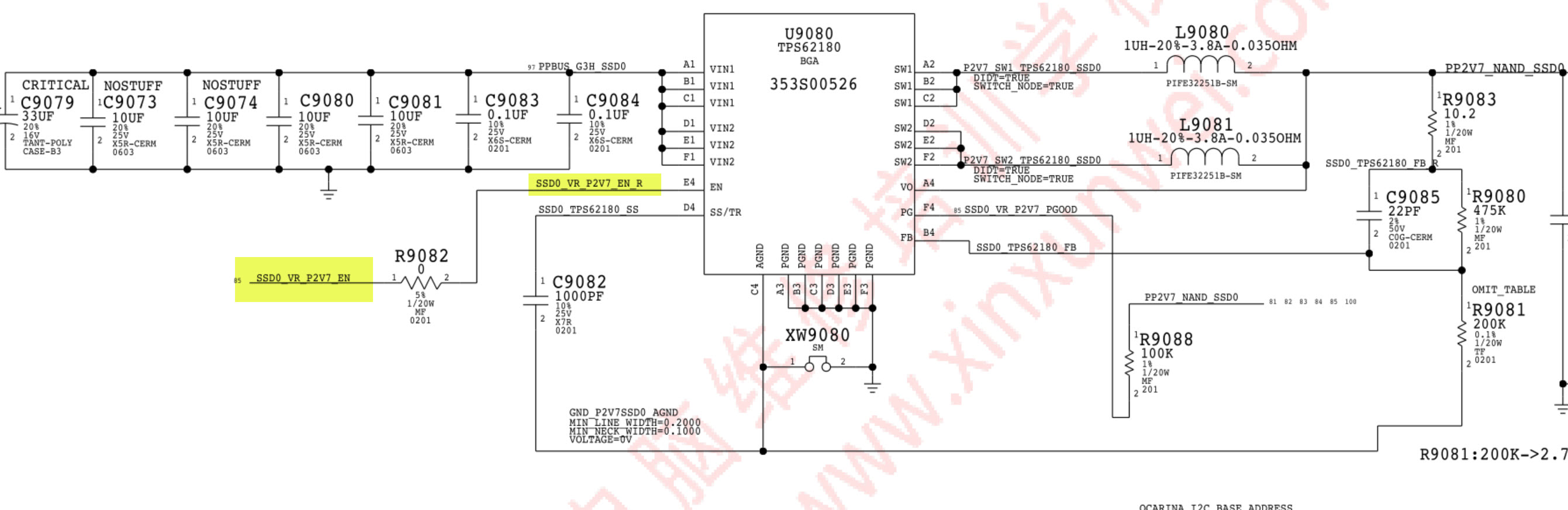

    I'm trying to diagnose this board with no power.
    The board was originally brought in for water damage. Corrosion was not very bad and the board was successfully repaired by a quick ultrasonic cleaning. All corrosion was very surface level and no solder repair was needed at all. No oxidized components can be seen. Customer took the laptop home and it worked fine until it was brought back for warranty. Customer was watching youtube when it suddenly shut down. Customer says last time she tried turning it on it would turn on after a very long while but gave some kind of error. During my own testing I THINK i saw the board try to power on once but have not been able to replicate the customers claim that it would sometimes try to turn on after a long while of waiting
    I tried DFU restore but got error 9xFCA (4042) "Gave up waiting for device to transistion from DFU state to DFU state".
    I am unsure of the most efficient workflow to test voltages on these boards so I went off the sequencing diagram from 820-01598.
    Current consumption
    Starts at 5V .245A when plugging into charger-seems normal
    Then transitions to 20V 0.054A and just sits there, no boot.
    On occasion the current "dips" and it seems like the board trying to boot.
    It will go: 20V 0.00A then 20V 0.035A then 20V 0.075 then it will go back to 20V at 0.054A like at the beginning and sit there again. The cycle repeats every 15 seconds or so.
    Same behavior on all ports.

            PP3V3_s5 as mentioned before is missing. No short here. Diode mode measures 0.315
            PP1V8_S5 is also missing. Diode mode 0.411.
            PP1V8_SSD0=0V diode mode 0.306
            PP0V9_SSD=0V diode mode 0.134
            So looks like the SSD voltages are missing. I installed a button at PMU_ONOFF_L and observed PP3v3_s5 while pressing the button to see if there was any kind of peak but there's absolutely no reaction. Same goes for the current draw, no change at all. I noticed on ocassion the voltage at PMU_ONOFF_L dissappears. This is sourced from the PPVRTC_G3H if I'm not mistaken, however this is only sometimes and does not appear to be linked to any particular action that I'm doing while testing the board.
            I'll get some more thorough reports tomorrow. In the meantime if you can offer any info based on these measurements do let me know. Thanks!

              Okay guys here is the measurements I took.
              I went from PP3V3_S5 all the way to the beginning of the power sequence diagram. Since this chart is for a different board I labeled all the rails I couldn't find here as "N/A". I also put any odd readings in bold.

              I assume that the fact that PPBUS_G3H is at 12.27 is a little low further shows some kind of an issue correct? Would greatly appreciate any help. Thank you!
                Yes, it is low. SMC is a suspect. Check the voltage to ground of the SMBUS lines.
                https://logi.wiki/index.php?title=PPBus_G3H
                The MacBook Pro series uses a 3S2P battery so on the charger it has a PPBus of 12.6V (12.2V before SMC boosts).

                  UPDATE:
                  While investigating the missing SSD0_VR_P2V7_EN line at U9080 I found that the output of this chip, PP2V7_NAND_SSD0, is missing and perhaps shorted to ground. The diode mode reading here is about 0.050. However the short is only 70 ohms to ground which at 2.7V is only about 30 milliamps. So perhaps this is only a MOSFET or gate somewhere turning on? What's odd is that this "short" disappears sometimes. When I removed L9080 and L9081 to isolate the issue the diode mode reading went to 0.340. After re-installing these coils and re-applying power the short re-appeared and went back down to 0.050 on diode mode. Basically at some point the short disappears and the line goes back up to 0.340 but when I apply power to the board the reading goes back down to 0.050. I also can't reliably recreate this issue by injecting power from a power supply. The only way I can reliably make the short re-appear is by applying power to the actual board. I'm not sure if this may be normal behaviour from the nand chips or if it's an actual shorted component. I'm also not sure what it is that makes the short go away. Discharging the line to ground does not make the short go away, it only does so when it wants. But applying power the board reliably makes the short re-appear every time. Maybe I should remove the nand chips to try and isolate the issue?
                  mon2 I will check those lines. Thanks.

                    • mon2
                      • Dec 2019
                      • 14550
                      Re: Macbook 820-00850 20V 54mA No Power
                      Very good diags on the power rail buck regulator.
                      Measure the voltage to ground of SSD0_VR_P2V7_EN_R.
                      Also measure SSD0_VR_P2V7_EN.
                      What is the measurement?
                      The switching mosfets are internal to U9080 and suspecting that this buck regulator is defective. The diode readings, to me are too low.

                        Hello, thank you for taking the time to respond and I apologize for the delay to reply back. Since It's been busy here I had to shelf this one for a little while. Today I had some free time so I went back to it.
                        Voltage to ground on the enable line is 0.357 on both sides of the resistor R9082. It definitely seems however that the short is on the output side of coils L9080 and L9081. The low reading is on the output side of these coils when they are removed from the circuit.
                        Shorted NANDs? Unless it's a shorted cap somewhere on this line. However I find it very odd that the short only appears when I try to power the board and then disappears. As mentioned in my previous post, I'm not sure what behaviour it is that makes the short dissappear but what makes it appear is attempting to power on the board. The short cannot be made to appear if I inject voltage to this line either, it has to be when I try to power the actual board by plugging in the charger. Very odd and this is what makes me wonder if this type of reading may be normal and due to a logic gate of some sort turning on somewhere inside the SSDs. After all at the 50 ohms or so that the short reads, that's only about 30mA of current.
                        That said I do think most likely we have shorted NANDs. Would you agree? I've read around about people replacing these but I haven't done it myself. I've read these don't have to be programmed like an iPhone NAND? Is that true for all macbook NAND chips of this type? Can someone point me towards a source?
                        Thank you!
