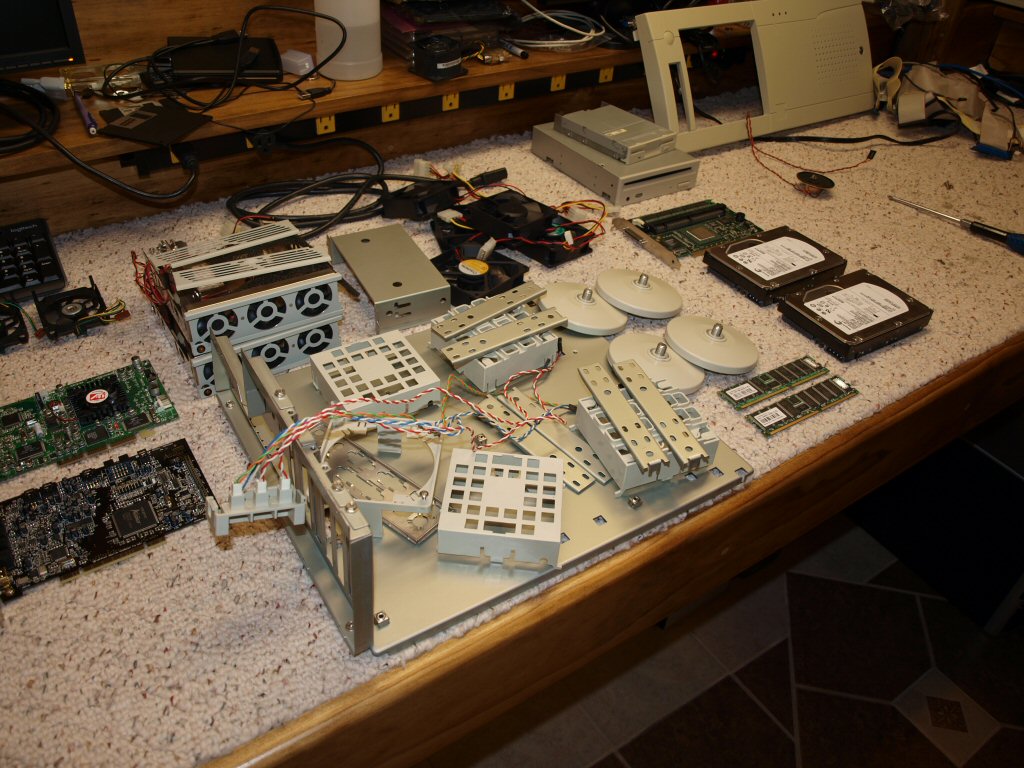

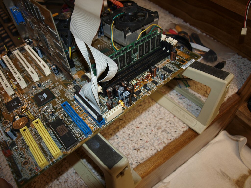

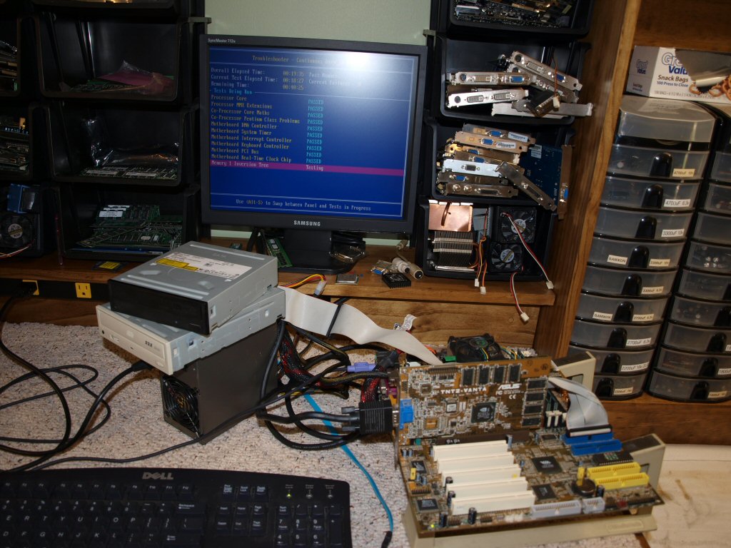

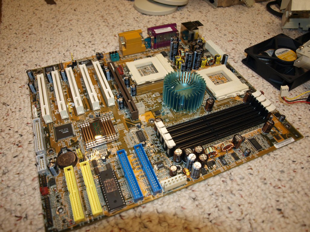

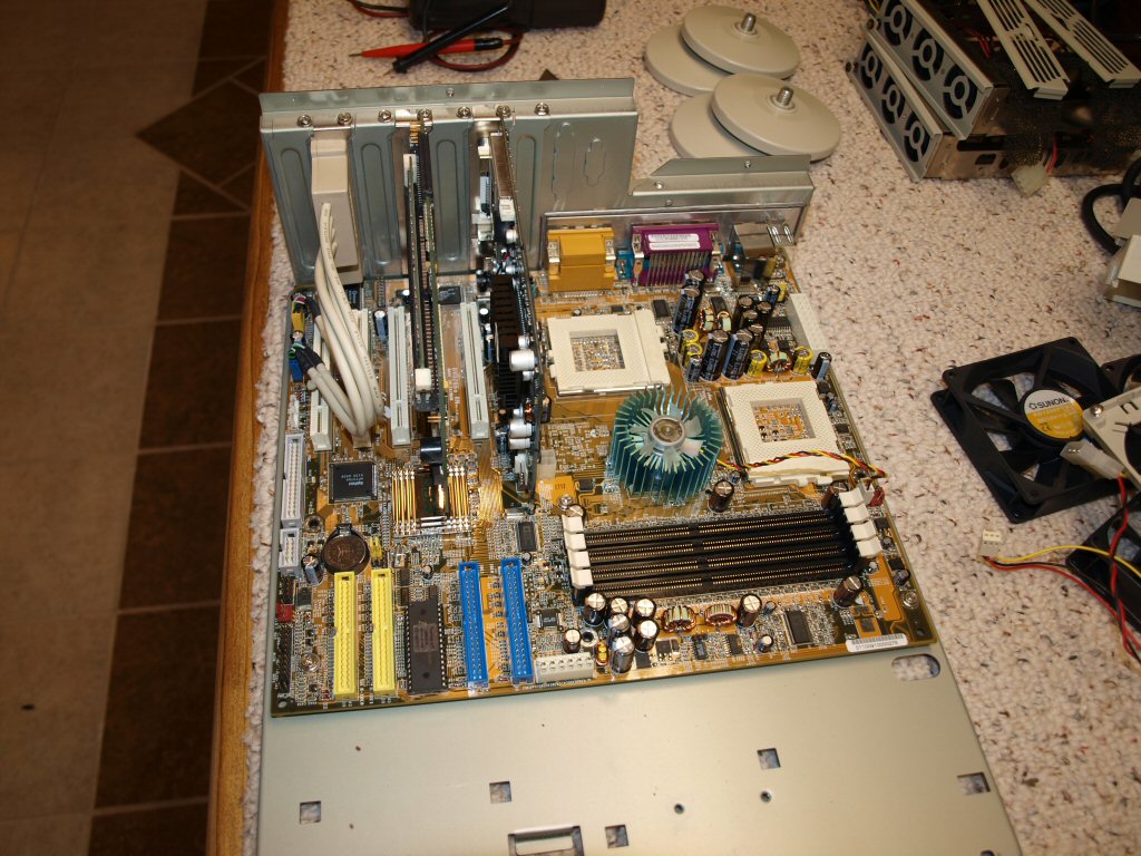

    A few pics...Recapped & testing fine. It would not POST prior to recapping.

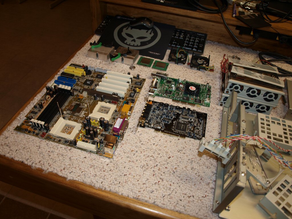

    Preparing to clean the filth:
    Everything hotwashed & dried....

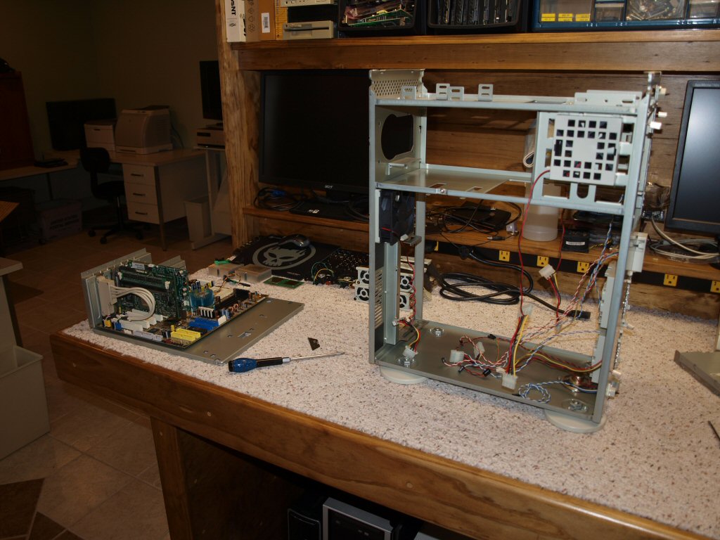

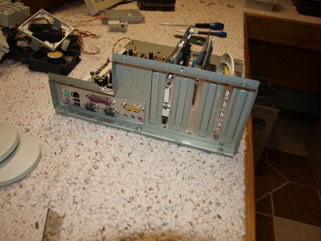

                Been piddlefarting around with this a little today since its too damn hot to do anything outside.....damn that "climate change"....ohh wait, it's July in Missouri, this is quite normal....darn!
                Anyway, I added a heftier fanned sink to the northbridge. I ground the ears off the stock NB sink and put it on the southbridge.
                Once those set up a little, I mounted the board in the tray....I think RD and I were admiring the olden days of removable motherboard trays in some AT cases....here's a rare one in an ATX case. Sure makes assembly nice!!
                That will need to set laying flat overnight to insure the epoxy is cured, or the sinks will be permanently bonded crooked.... The RAM should be here at the end of the week, so the 2 sticks I used in it found their way back into the bin.

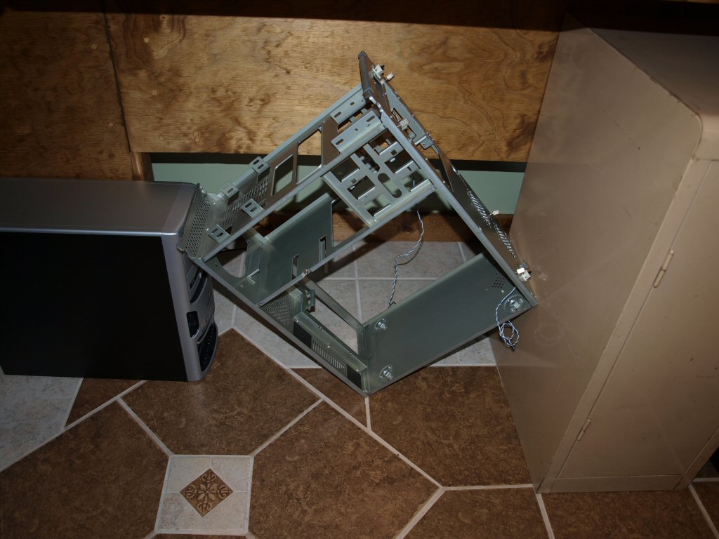

                  you gotta love enlight ATX trays.... I have a side saddle one that was a failed repaint. I even added a breakout board that allowed usage of the tray out of the case.

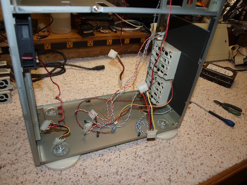

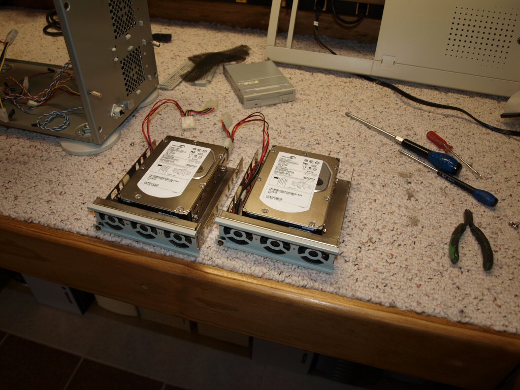

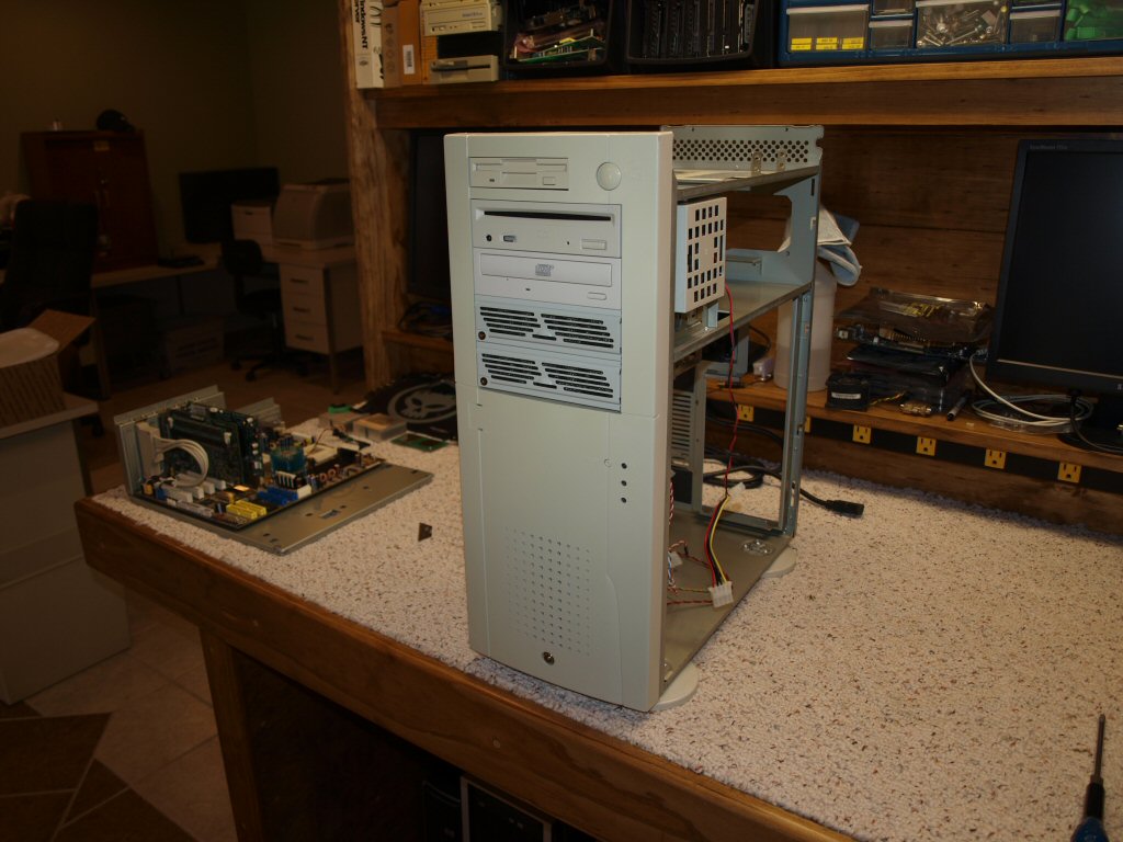

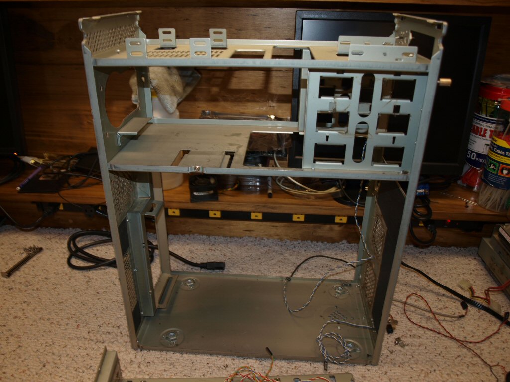

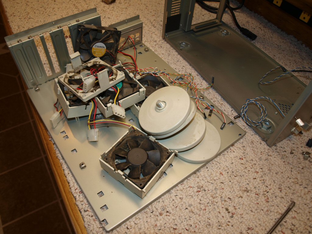

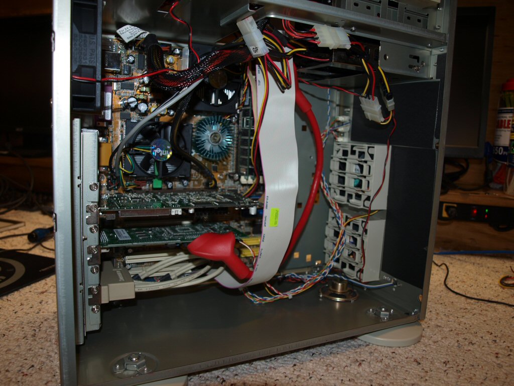

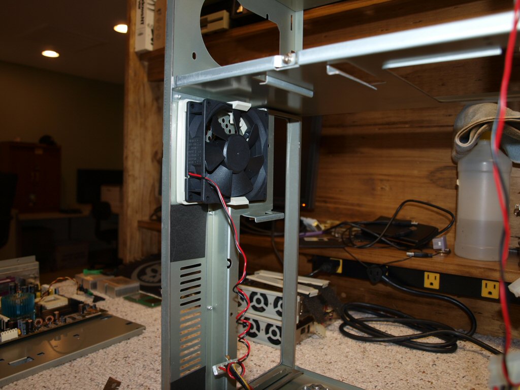

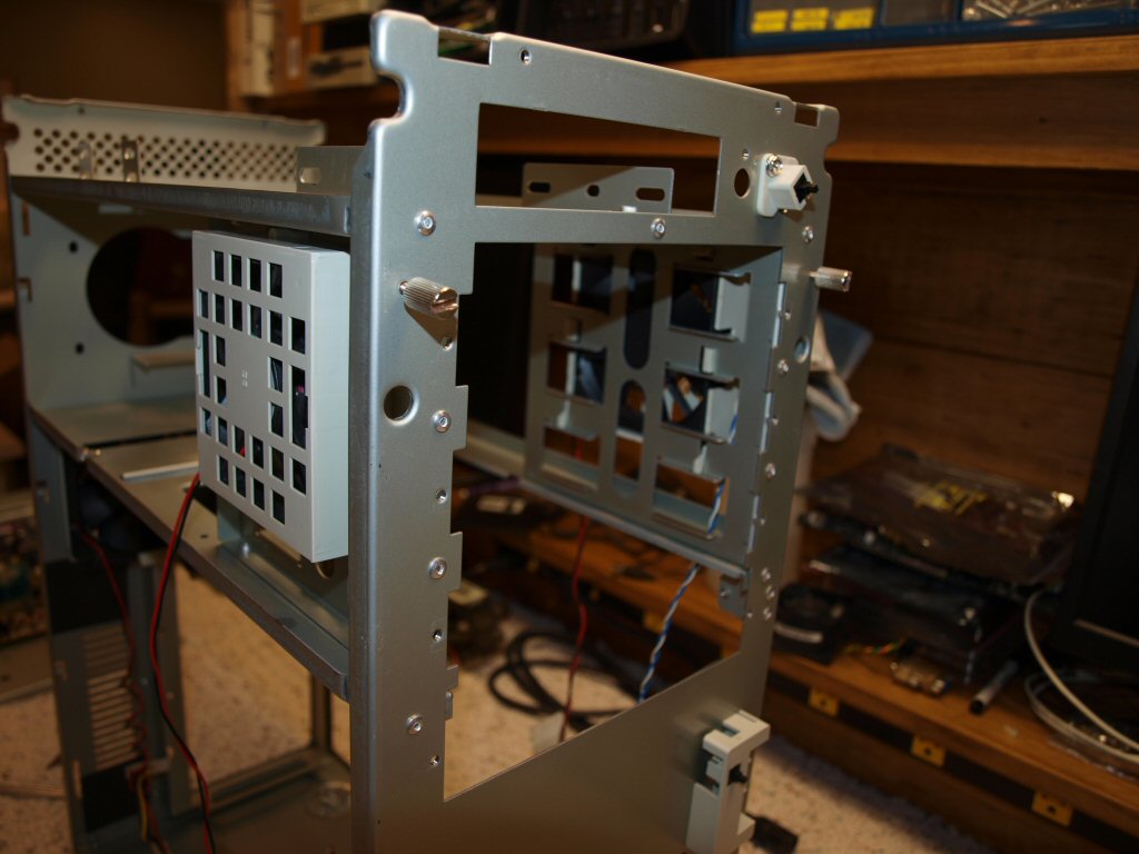

                      I'm waiting for the memory to arrive, so in the mean time, I reassembled the majority of the case.
                      All front panel wiring replaced, along with the 2x 80mm front fans.
                      Side mount 80mm fans.
                      Rear 90mm fan
                      Getting really close.
                      HDD's mounted in their trays.
                      opticals mounted and gaps set.
                      When the memory arrives, I'll finish this one off.

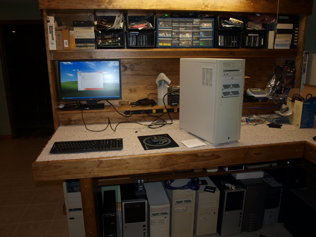

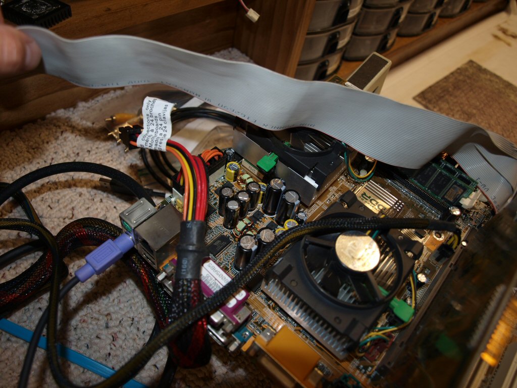

                          ...and this one draws to a close... It still has only 2GB ECC memory in it (bench modules), the ECC modules I ordered didn't seem to play nice with it....but worked fine in another system...but in this system just beep codes. If I use non-ECC modules, 4GB runs fine. Ohh well....2gb is plenty for XP and testing stuff.
                          Modified Specs:
                          Enlight full tower eATX
                          Antec HE550 PSU (recapped)
                          Iwill DVD266u-RN motherboard (recapped)
                          2x 1.4GHz Tualatin-S processors
                          2GB ECC Memory
                          Sony IDE CDRW (nicotine sludge killed the Plextor)
                          Pioneer slot-load DVDROM
                          inclose 5.25 bay coolers (I used those in a LOT of systems)
                          ATI 8500 All-in-Wonder 64mb
                          C-Media onboard audio (Audigy used in VP6 system)
                          Adaptec 39320 U320 SCSI Controller
                          2x 73GB Seagate Cheetah 15K RPM in a 147GB RAID-0
                          WinXP Pro

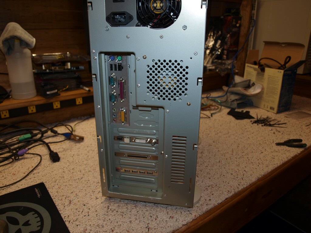

                          Assembled...
                          Found a use for an old supermicro USB header...
                          ...and done...

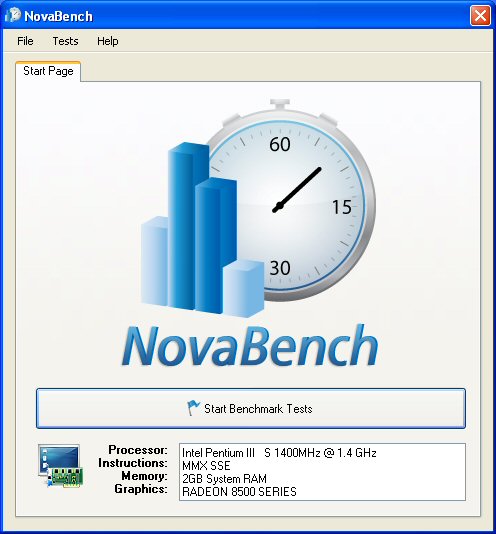

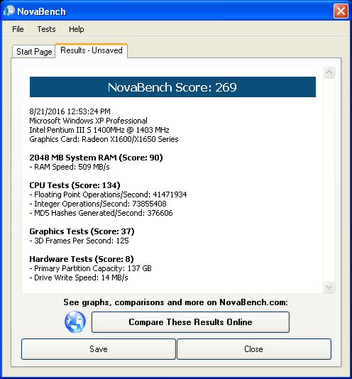

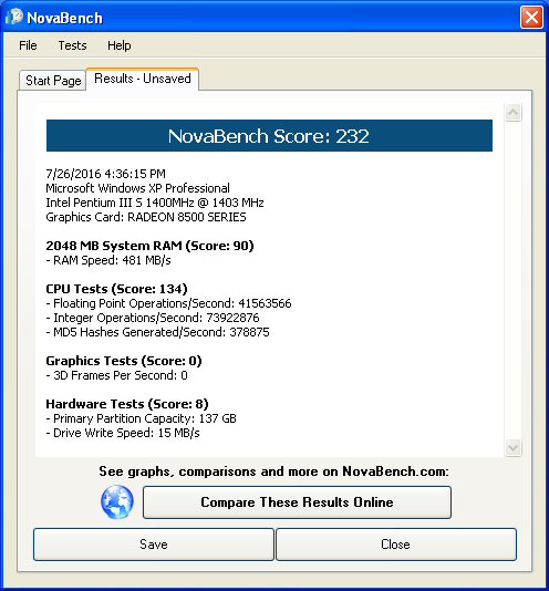

                          Novabench:
                          GPU scored '0', the test spit out an error saying "pixel shader test failed".... too old I guess.
                          crystaldisk test also crashes....and that sucked, I really wanted to see the results of a pair of 73gb 15k RPM cheetah SCSI320 HDD's in a stripe on an adaptec 39320 controller. local file transfers were quite snappy, I wish I had the numbers to post, but I don't....I might diddle with it later on. FF47 runs pretty nice, well until you install ABP...that slows it to a crawl at startup....once you sit there for about 30 second waiting for it to load, its runs nice. With ABP removed, FF47 loads in about 6 seconds.
                          I haven't been ambitious enough to try W7 on this machine yet...but 7 runs nice on the P3TDDE dual 1.4GHz Tualatin system, so it'd probably be ok....
                          Of course, this is posted from it.

                              Re: Ghost of Christmas Past Retro Resto - Iwill DVD266u-RN!
                              You need a video card with pixel shader 2 support.
