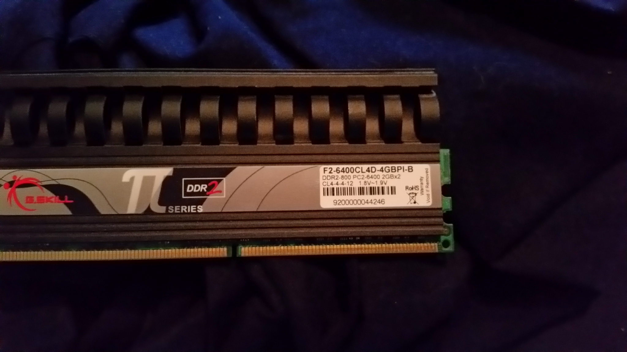

                          • ChaosLegionnaire
                            HC Overclocker
                            • Jul 2012
                            • 3266
                            • Singapore
                            #33
                            Re: Difference between socket 1156 vs 2011.
                            no, no easy way to do that. not without voiding the warranty. u see nearly all overclocking ram modules have heatspreaders on them. this obfuscates what ram ICs are being used on the modules and dismantling the heatspreaders voids the warranty.
                            one way is to just look at reviews of the ram u are buying. some reviewers may pry off the heatspreaders to see what ram ICs are being used but not all reviewers do that. thats also assuming the manufacturer is honest and didnt pull a "bait and switch" by sending to reviewers different stuff than what is actually being put up for sale.
                            so unfortunately, there is no easy way to "check out" a ram module and see what it has under that skirt errr heatspreader... lol

                              • ChaosLegionnaire
                                HC Overclocker
                                • Jul 2012
                                • 3266
                                • Singapore
                                #35
                                well, i had the kingston hyperx ddr2-800 and i found that it overclocks just like the ddr2-1066 hyperx. tested in memtest and prime95 blend for hours in a 4 stick config together with the hyperx 1066. no errors. never had a freeze or any ram related issues in normal and gaming use.
                                so if u're lucky and buy from a reliable and good brand of ram, u may end up lucky and get more than what u paid for...
