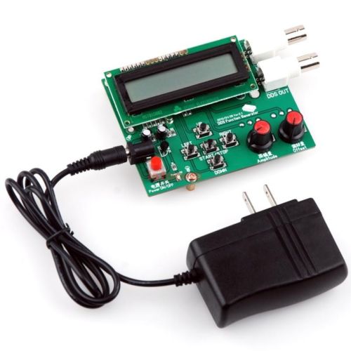

                          Scratch what I said about the pc speaker (square) and forget about parallel/serial ports (also digital). Unfortunately you will have to get an external DDS with a faster DAC or just get signal generator. I ended up doing that, but may end up getting or building a DDS for the heck of it. There are many several MHz DDS chips out there, or you can do it in software, but you'll quickly find out software DDS runs out of steam pretty quickly... and you still need a good DAC.
                          I've been thinking about building this DDS at some point
                          http://www.myplace.nu/avr/minidds/index.htm
                          I'm sure there are other designs out there.
                          • R_J
                            • Jun 2012
                            • 9579
                            Re: Generating a clock
                            There are premade sinewave generator on ebay starting around $10.00 http://www.ebay.com/bhp/sine-wave-generator
                            or build one using a 555 timer ic and clean up the output to get a sine wave.
                            or this one for $22.00
