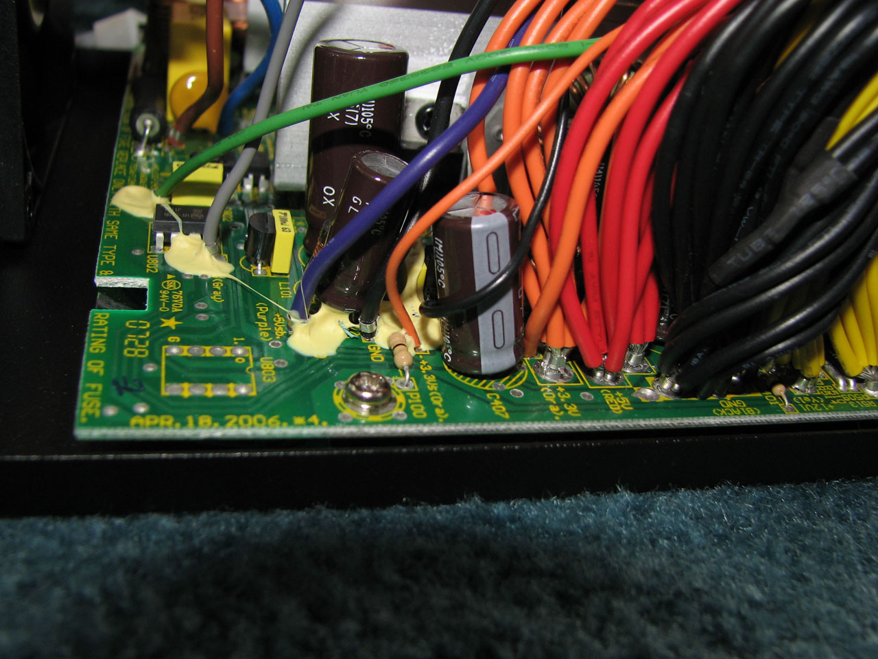

                Just get a good quality supply test it to make sure it suits your needs then recap it. You know what they say if you want something done right do it yourself. I feel that its really futile to find a supply with all top brand caps out of the box.
                Plus even is you did find one manufacurers can switch the internal components from lot to lot which means just because one box has all UCC caps that doesn't mean the next box will.
                Even my Antec which is a good quality supply had Fujiyuus and Koshins inside I replaced the general purpose Koshins with UCC KMG or KME can't remember and the low ESR Fujiyuus with Panasonic FC's. Ironically enough though the input filters were Panasonic go figure.
                It was a little tough to get the 12.5mm diameter FC in the 10mm space but the supply is just fine with 2 of the caps 2 to 3 mm off the board.
                The next issue was getting the cover back on because getting the wires to fit back but after a little Feng Shuing its worked out .

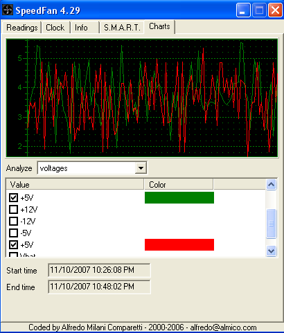

                      But could anyone tell me if my +5V lines are in spec? They seem to go all over the place.

                        Recapping a PSU is pretty easy compared to a mobo. It's a single-sided PCB, so there are no inner traces you can mess up.
                        The parts can take lots of heat compared to those on a mobo, and you don't have those large ground planes (some of them are inside the PCB in a mobo), so there's not much you can do wrong (even with cheap tools).
                        Just make sure the new caps are the right size.
                        Those Speedfan readings are probably rubbish, I doubt your system woud run in the first place at those values. Better use a DMM and/or a scope.

                          I think your 5v line is far out of any regulation, even with the known inaccurate reading of a on board voltage sensor in mind.

                                The speed fan reports the same crazy +5V on this one too, I guess it must be the program.

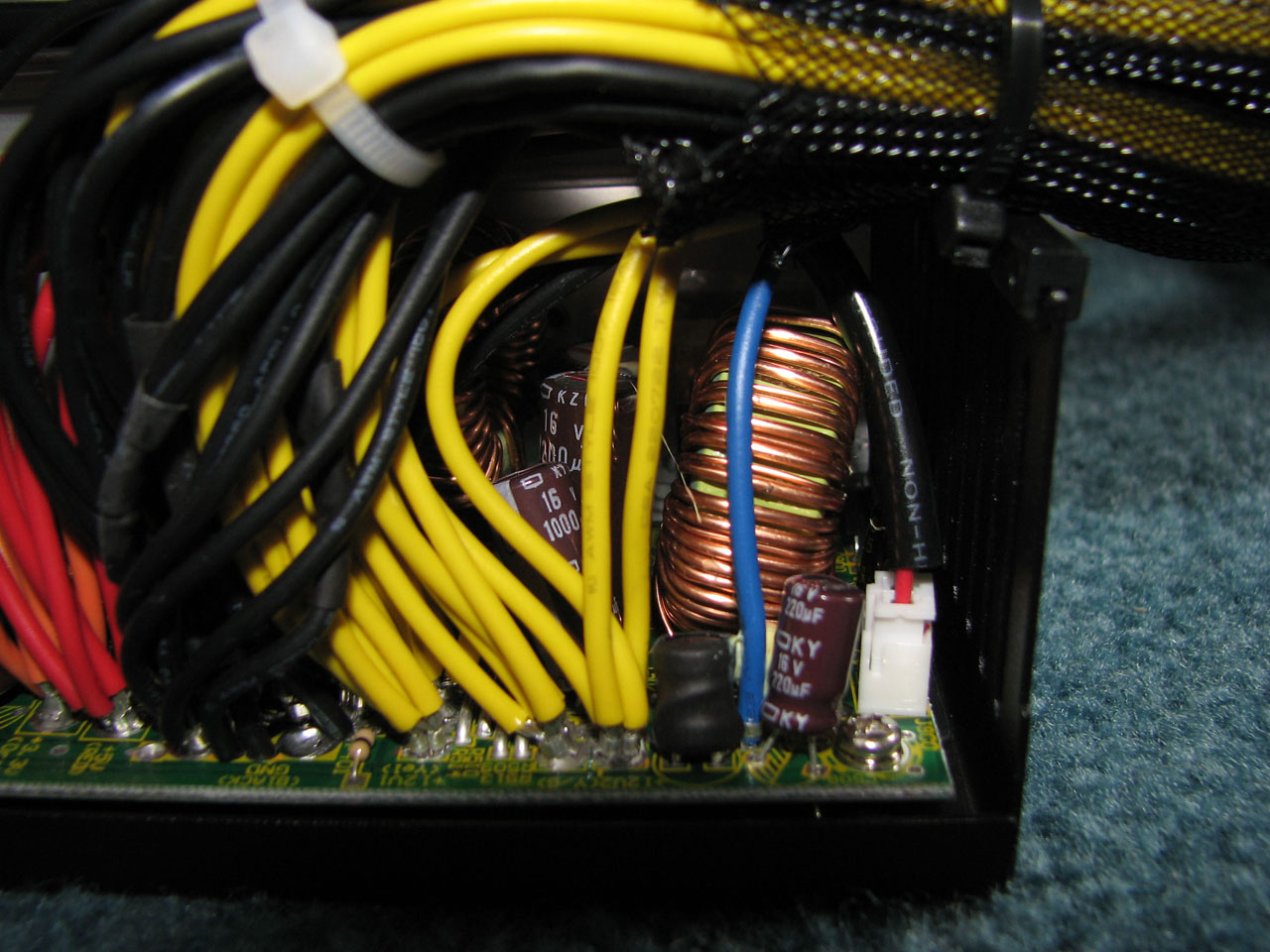

                                any idea on who makes the caps in it? KY?
                                I've seen the same style on a power regulator board proprietary to my motherboard.

                                  Those are UCC/NCC caps. They are good caps. I've had good luck with recapping Antecs and FSPs with good caps and they work great. My power needs are usually small, though. I don't game and rarely have more that 3 drives in a system.

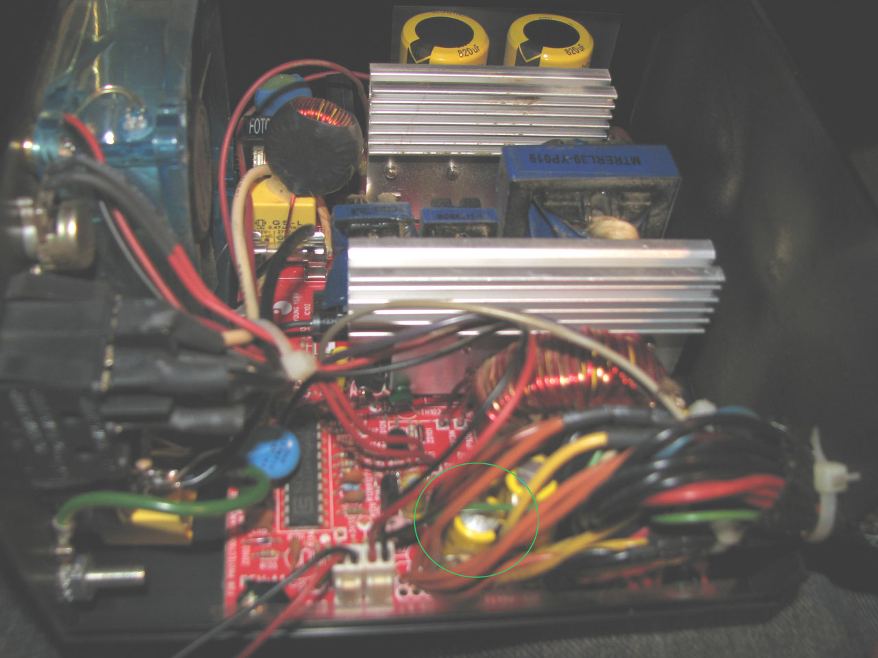

                                    This cant be good;
