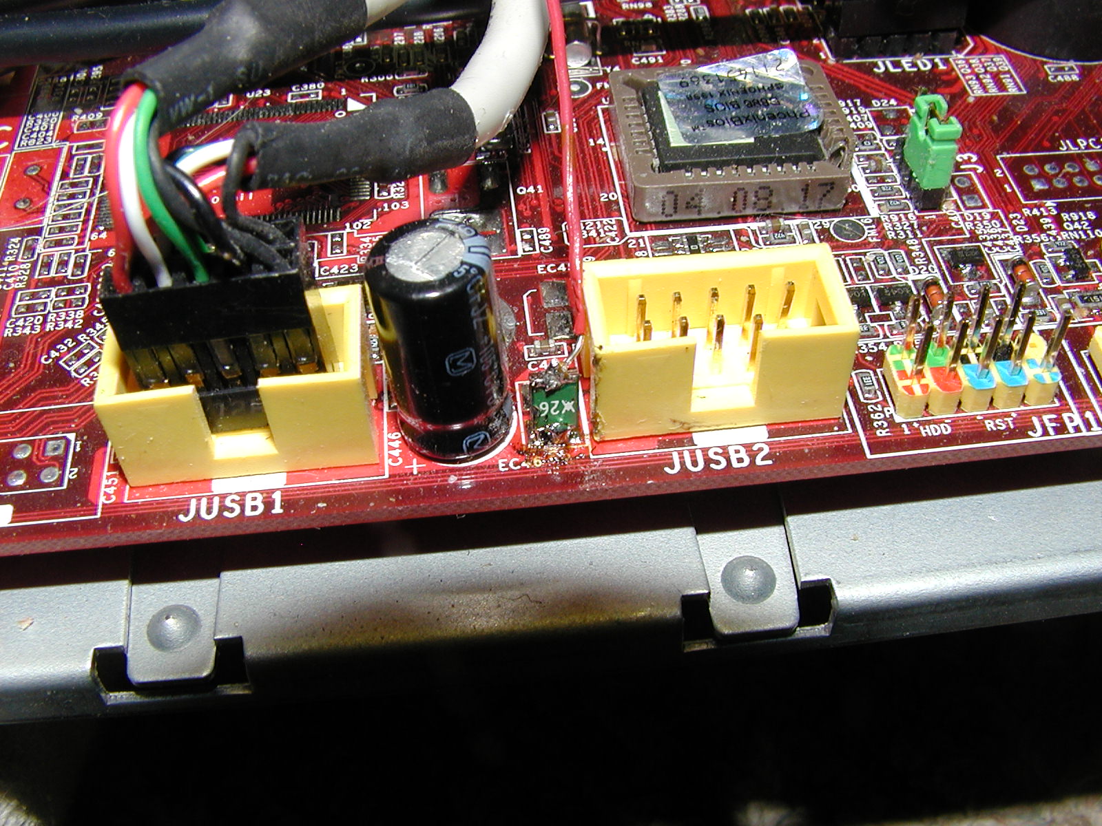

    Second problem involves power to the USB ports.
    There are two headers that allow for an additional four USB ports but the problem is that when the computer is off the ports receive power but when the computer turns on the four ports lose all power and nothing can be done to get power back except turn the system off. The other four ports on the back of the board do not have this problem.
    My plan was to sever the 5V line(s) to these four problematic ports and have the required 5V come from a spare drive connector but I don't know if that will cause even more problems (excluding the loss of voltage monitoring on those ports). Would this rewire (which will also be fused) be okay or will I be smelling smoke?

    As for the USB headers...usually, the board has an option jumper to whether to use +5V or +5VSB through the USB. Maybe your jumper is set to VSB.

      I went through the owners manual and there is no mention of such a jumper.

              I need to know if my USB modification is safe to use soon. I need the system by the weekend.

                Re: Two questions (usb and ram)
                As long as the 5V are relative to the same ground path (= come from the same PS), that should work. But be sure to properly disconnect the old 5V lines.
                The only potential problem (depending on what you intend to connect) is that you might lose the standby power of these ports, so you can't switch the PC on from a USB keyboard connected to a front port for instance. Not really a problem, though.
                  No problem there. The ports will be used by a card reader and a front USB port.
                  I plan to sever the connection at the fuse (Desolder the fuse) and run an extra lead from the power jack on the back of the case (used to send 12V and 5V to some modified sega glasses).

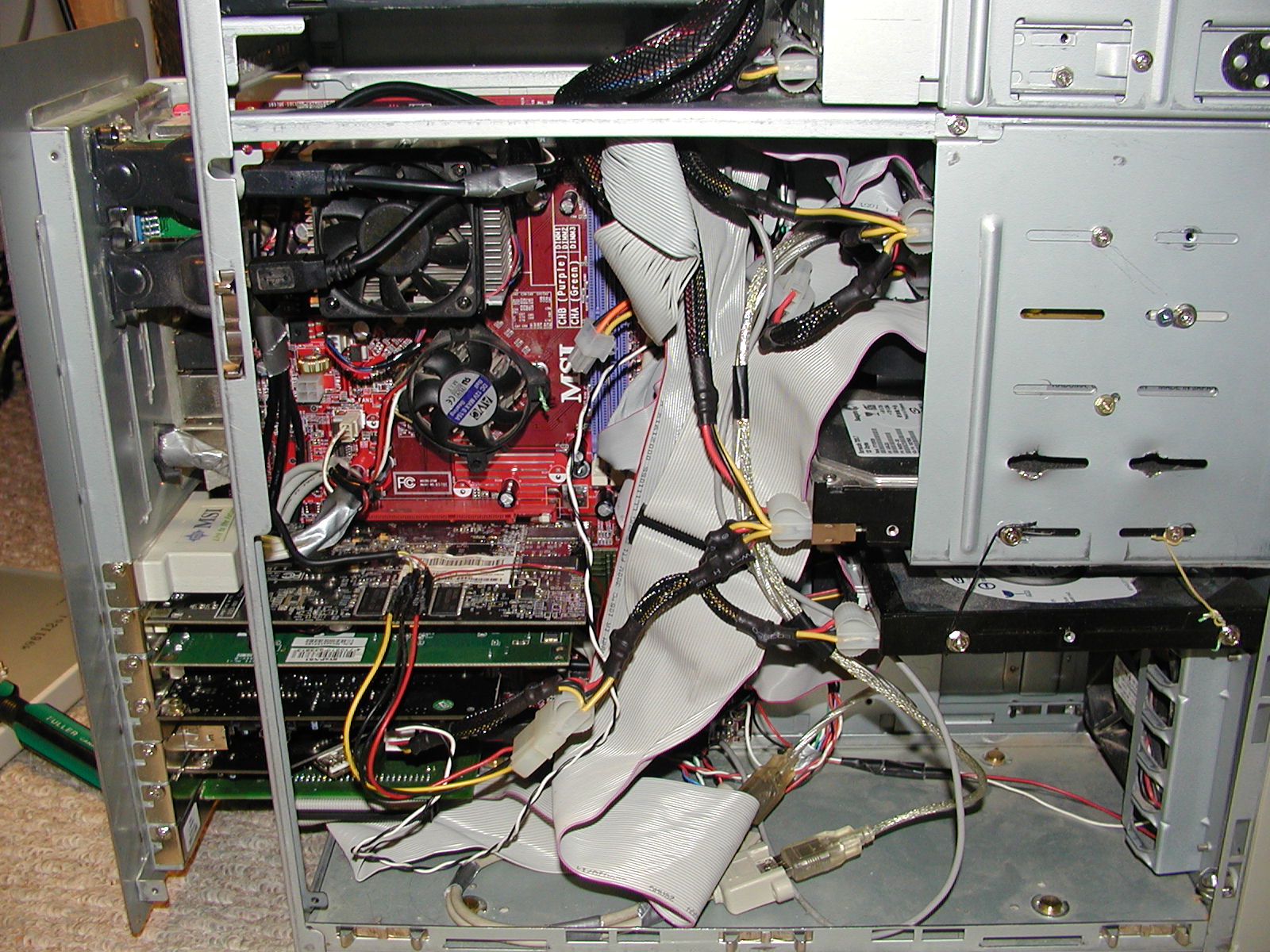

                    I got to clean up the solder a bit but otherwise it's done.

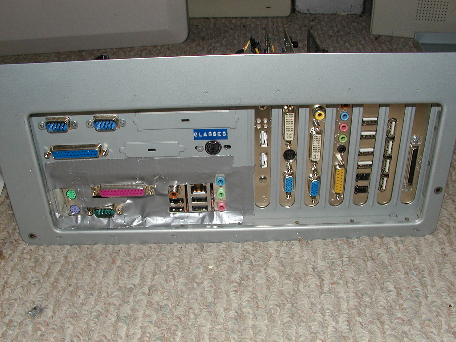

                      Nice work!.... Your USB ports do function properly now.... right??
                      I still don't understand why your motherboard only supplies power to the USB ports when the PC is in soft-off mode.... seems a bit odd.
                      Is your case the type of case that has a removable motherboard tray?? Did you lose the I/O shield for your motherboard?? I see duct tape there instead of an I/O shield.

                        err... pretty drastic. you might have simply cut the cable after the header.
                        regarding your original question: that board supports Dual Channel, the third RAM slot is DDR, too. you SHOULD use it (512MB in each channel; adding more to channel B is okay, too.)
                        btw, I still have that exact I/O shield here, in case you're interested.
                          Yes, I have a removable tray.
                          I never got the shield. This board came from the landfill (which might explain the problems).
