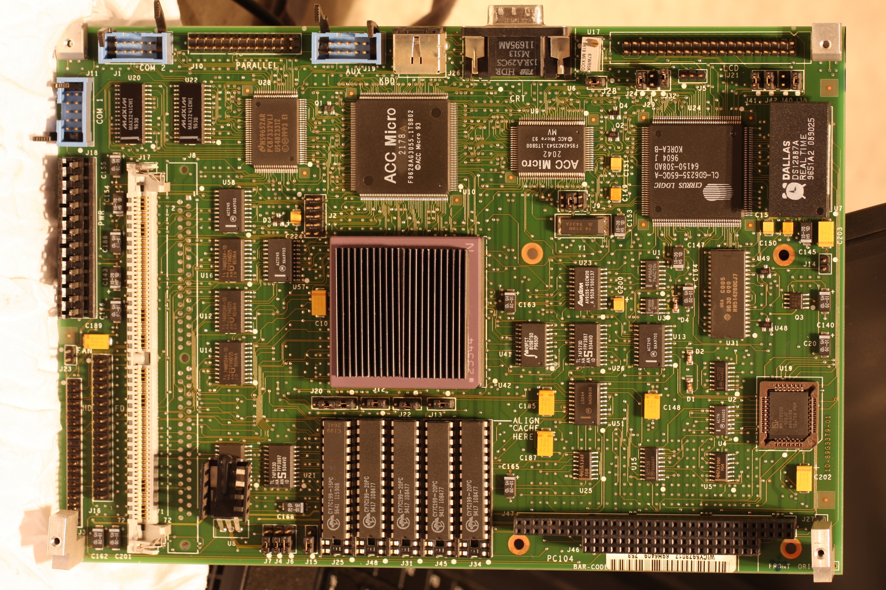

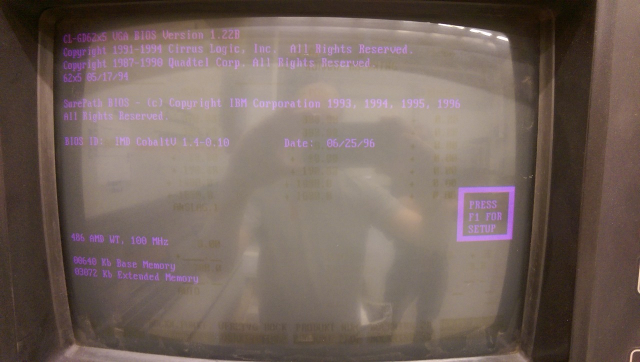

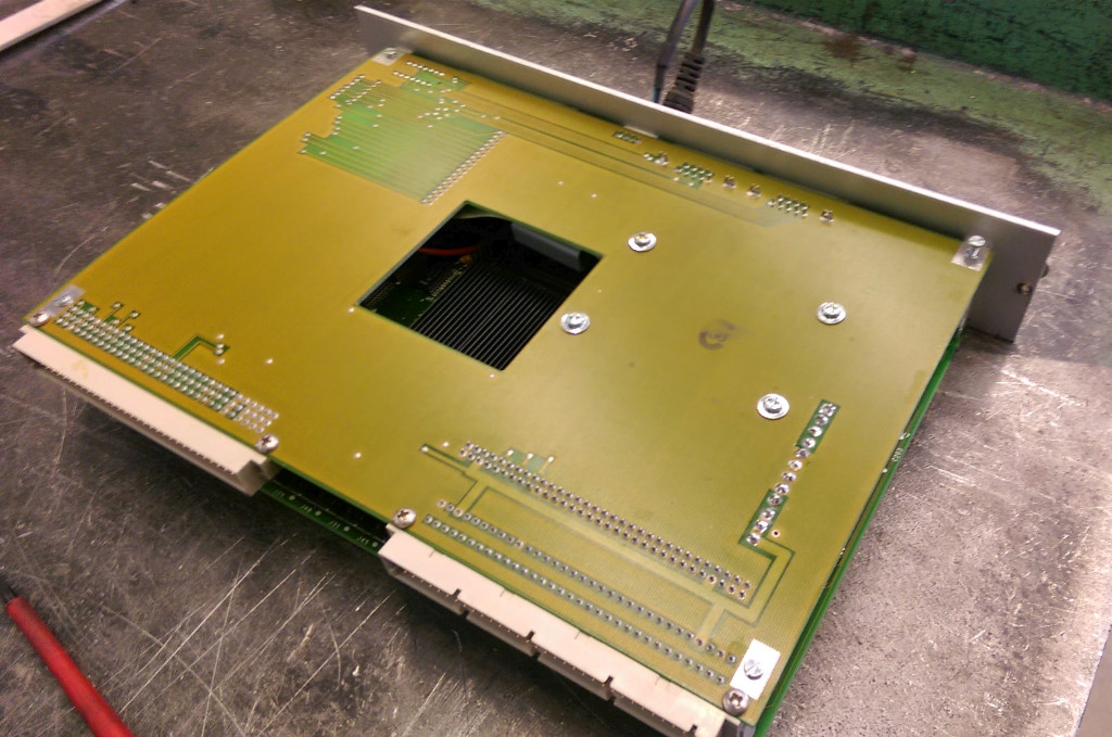

    Hi, does anyone know what this board is? (See pictures)
    It hangs at POST saying "PRESS F1 FOR SETUP"
    But when you do nothing happens, it does not respond to any keypress at all.
    Except CTRL+ALT+DELETE which reboots it, then the message is gone but it still hangs...

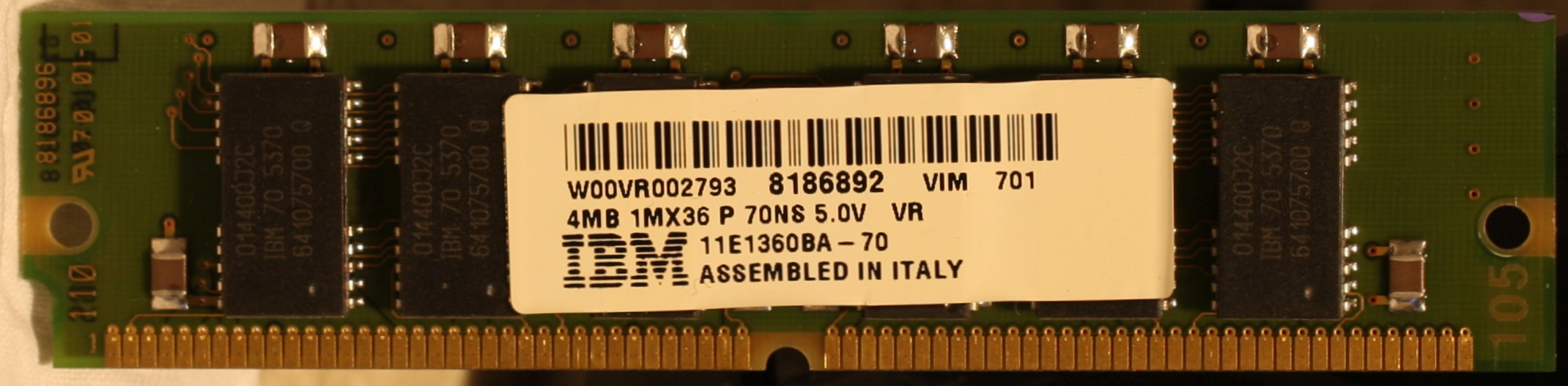

    It has a 4MB memory module and I notice in the POST it lists 3072KB extended memory, could that be it or might the memory be hidden by something else?
    I initially though that the Dallas DS12887A RTC module might be bad due to the date seen in the POST message.
    It still might be bad, but after dumping the BIOS (attached) I realized it was simply the date of the BIOS release...

    In the BIOS, I see the phrase "F2 for setup program" at 0x01D425
    Having 640KB base memory and 3072KB extended with a 4MB module looks ok.

      More info would help but from what I can read it looks like a older cirrus logic motherboard that requires a setup floppy to change the bios (common in these old boards).
      If you can provide a more clear picture of the post screen or list it out line by line as it is displayed I can get you more detailed info on the board.
      Unless you have or someone has a specific need for this its worth more as scrap for the gold content.

        The picture of the POST is as good as it gets, the CRT monitor is simply that much worn & has allot of burn-in!

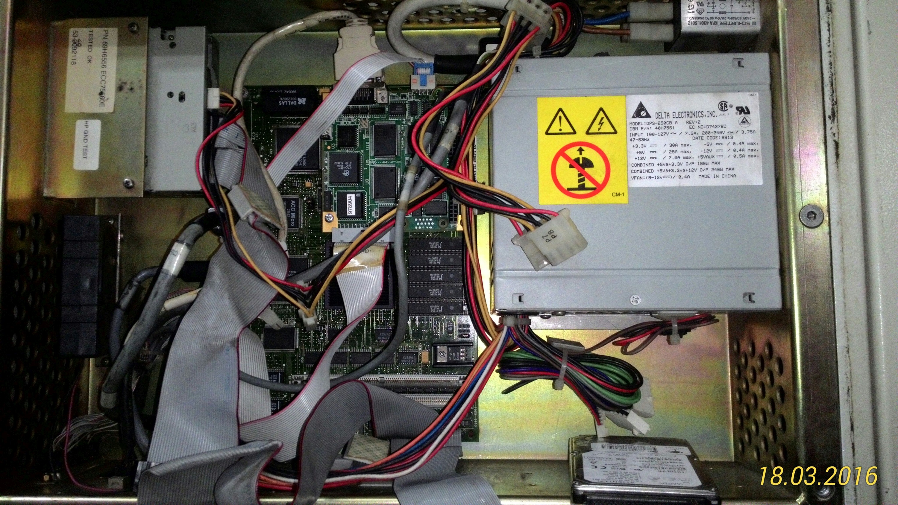

        System comes from a Weinbrenner press brake with a Cybelec DNC control and as such is worth allot to it's customer
        Unfortunately I'm in Lithuania now for moving a machine for two weeks.
        So we had to send this board away for troubleshooting to another company, have not had a chance to look at it more...

            replace the rtc first.
            it could also be waiting for some device to come ready but it should time out.

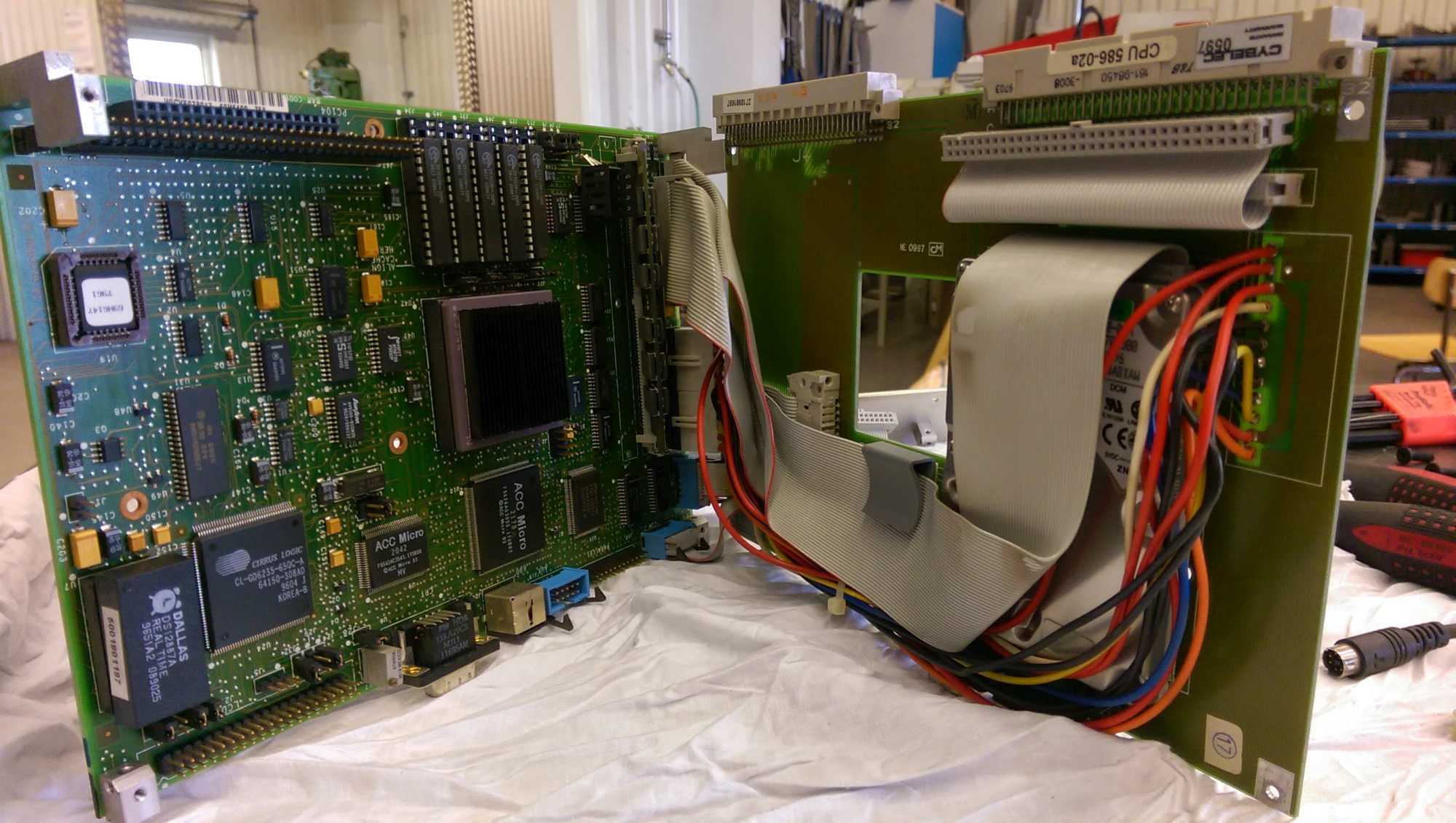

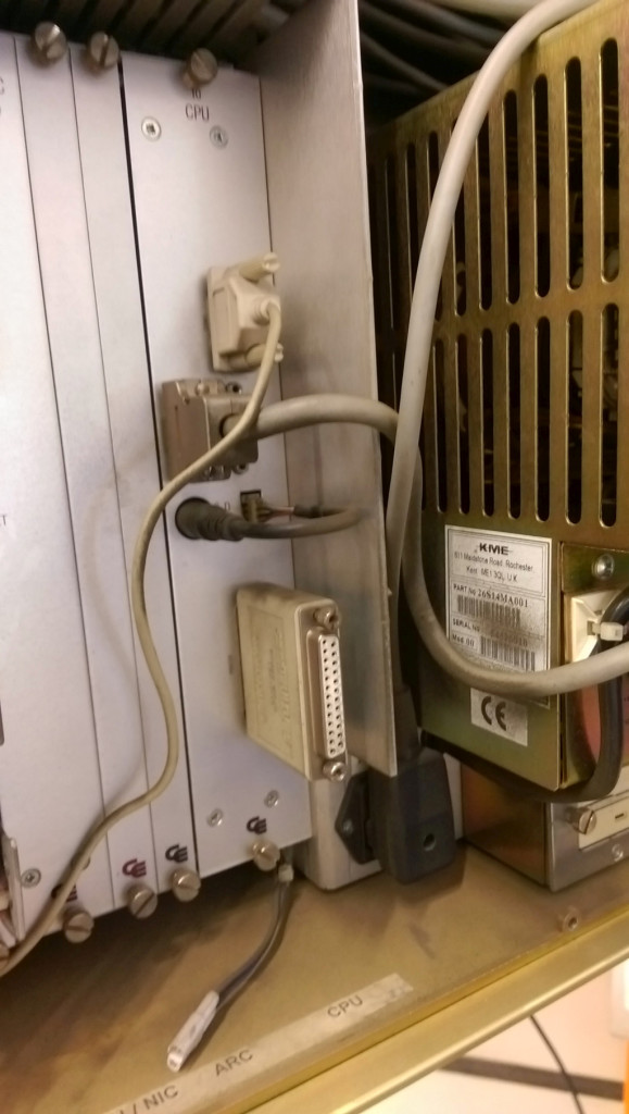

                    stj: I took the whole board as it is, but the PSU is integrated into the machine, not easy to take out.
                    It connects via proprietary connectors at the back.
                    As it is I thought I had an AT PSU at home, that would have been much easier, but alas I was wrong and that's why I did not get any further with the system
                    For the curiosity of others I'll post some images taken when I was at the customers site...

                        The board is alive, all it wanted was a new RTC chip as I originally suspected.
                        The external company we contacted sent a brand new much faster AMD Geode PC104 replacement computer, with newer software aswell.
                        A much better solution of course but as bad luck had it the CF card it came with was bad so many files on the filesystem where corrupted...

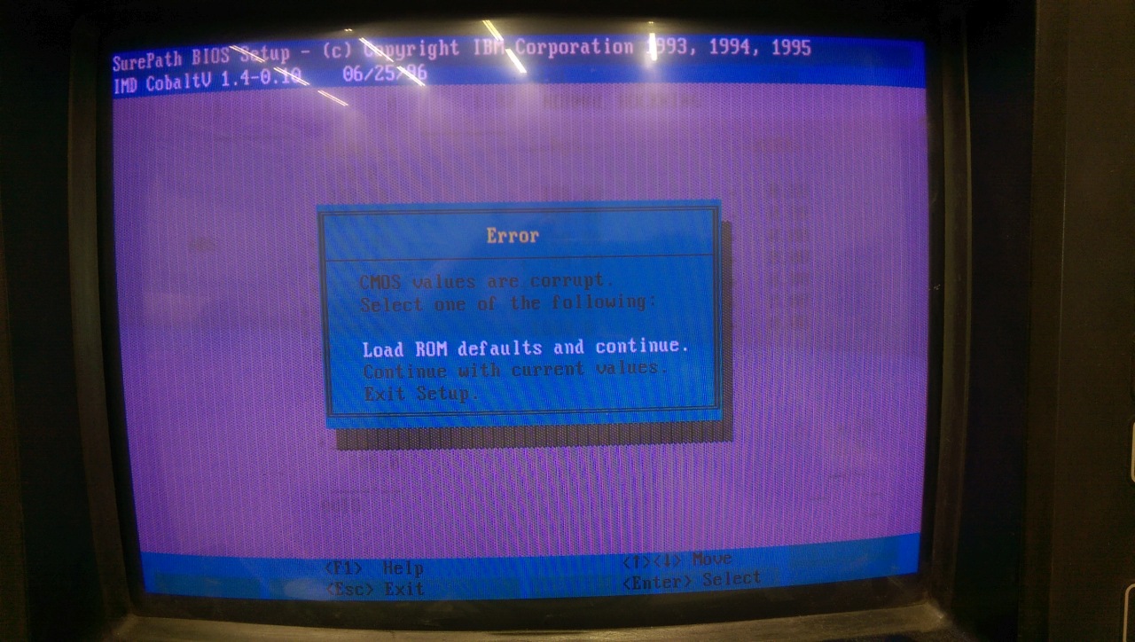

                        So I decided to test the old board again, first I plugged it in without having changed anything, nothing, no picture at all on the CRT and no response on the keyboard.
                        Took it out and put the new RTC in, and then it booted right up!

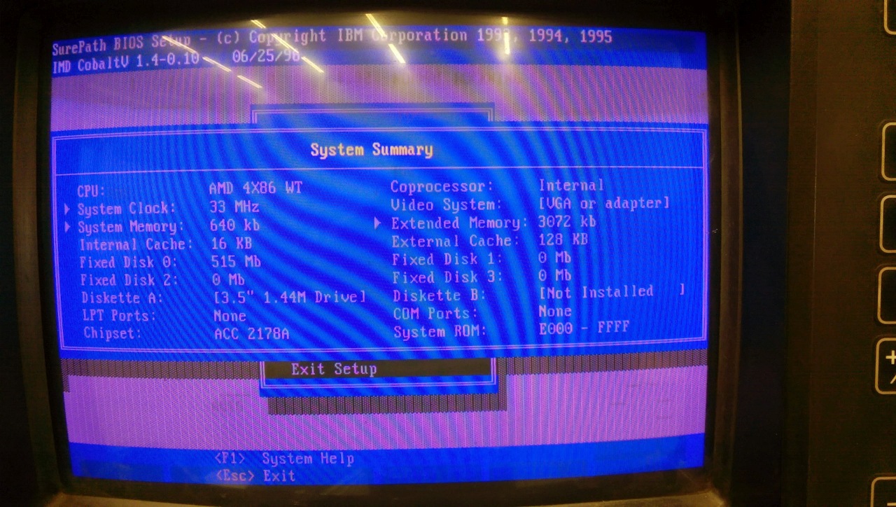

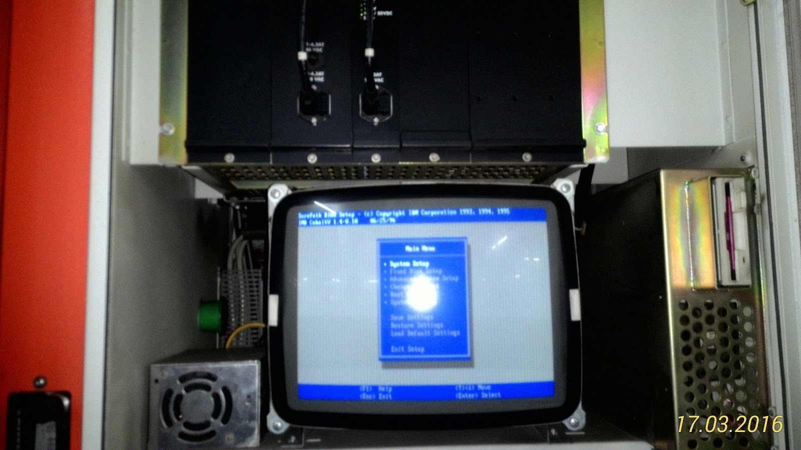

                        I got the first BIOS screen below directly when it booted.
                        I went in simply to set the boot order properly & the system time, and took another picture of the "system info" page in the BIOS.
                        The RTC I used was a DS12887+ bought from Elfa, part number: 73-768-90
                        The plus at the end simply means it is complying with RoHS specifications.
                        The missing "A" at the end compared with the original simply means it lacks "Clear CMOS" functionality.
                        It does not matter so long as a BIOS password is not set & forgotten, or settings making the system unable to POST are used, since the settings can't be cleared...
