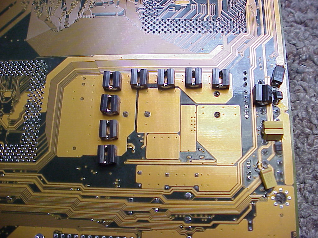

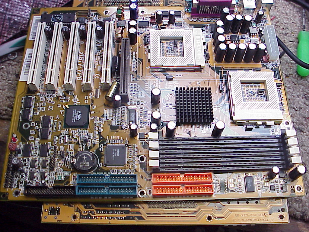

    i have been doing a cost no barrier rehab of a abit vp6.
    all lytics are now high quality jap.
    tc's custom bios.
    kingston gx150 ram.

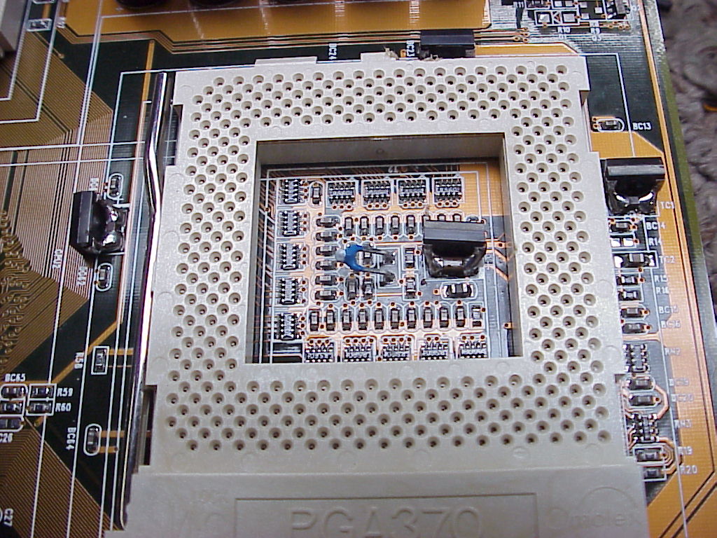

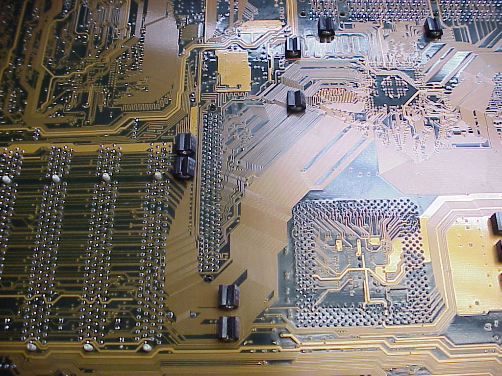

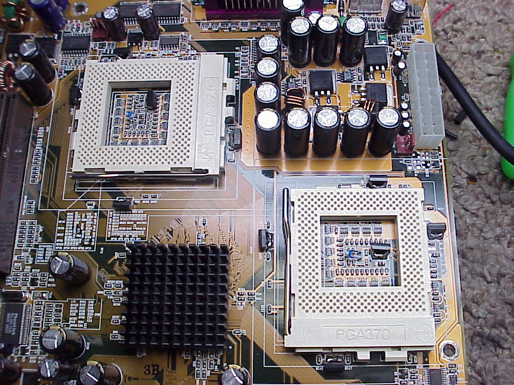

    all lytics on vrm outputs and the mlcc around the sockets paralelled with 470@4v tantalum/polymer chips and mlcc's.
    psu is a fortron 350w with the same cap treatment.
    solid cu hsf's.
    polymer/tantalum/mlcc ultra low esr chips bypassing all supplies.
    hitting this vp6 with everything i have that improves ripple and regulation.

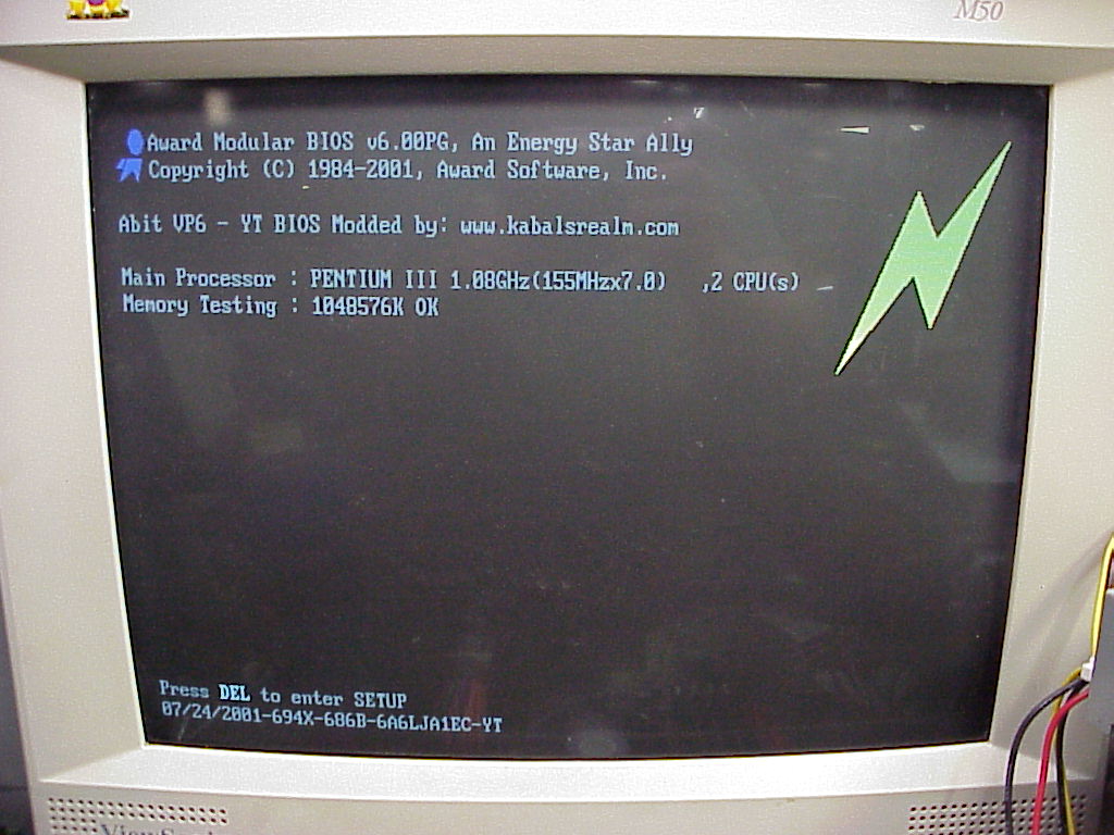

    stage 1 is running 2x p3 933 at stock vcore at 150 fsb.
    folding,playing nws java radar loops and folding 3 days now without the slightest glitch.
    so what was the all time best without all these hotrod parts?

    Forgive my lack of Intel knowledge, but what do those P3s usually run at?
    • kc8adu
      • Nov 2003
      • 8832
      • U.S.A!
      Re: best vp6 overclock of all time?
      the ones i am running now are 933
      at 150 fsb they show 1.05 ghz

                Wow, very nice work and excellent results! I've made several BIOS's for that board, I think that one has Tualatin microcode in it, so a tually will run with the powerleap adapters.
                Keep us posted on its stability!!

                    You're not going to change that NB heatsink for something better?
                    Ludicrous gibs!
                    • kc8adu
                      • Nov 2003
                      • 8832
                      • U.S.A!
                      nope.
                      it runs cool with the air coming from the cpu coolers.
                      i do have a pair of p3 s 1.26 and some lin lin sockets to play with though.

                          1st - Do those MLCC need to be soldered to those VRM cap joints? and why exactly, I see this type of modding for the first time.
                          2nd - Those big caps around VRM and other parts are polys?
                          3nd - (an opinion) I really recommend swapping the chipset HS, it runs cool because it does NOT conduct heat pretty much - I wasn't able cross the 166MHz FSB without changing it, brushing the surface plain clean and adding some paste plus glue for a new and quite heavy heatsink with an active cooler - solved temperature mystery of mine.
                          4th - Ehm, I suppose with THAT modding you pretty sure reached a stable 175MHz at least . Anyways what's new in TC's bios updates? Mainly is the limit of 178MHz FSB pushed farther?

                            Achieved 173,5MHz ROCK SOLID - more info to be found here (scroll down pls):
                            https://www.badcaps.net/forum/showth...?t=9519&page=3
