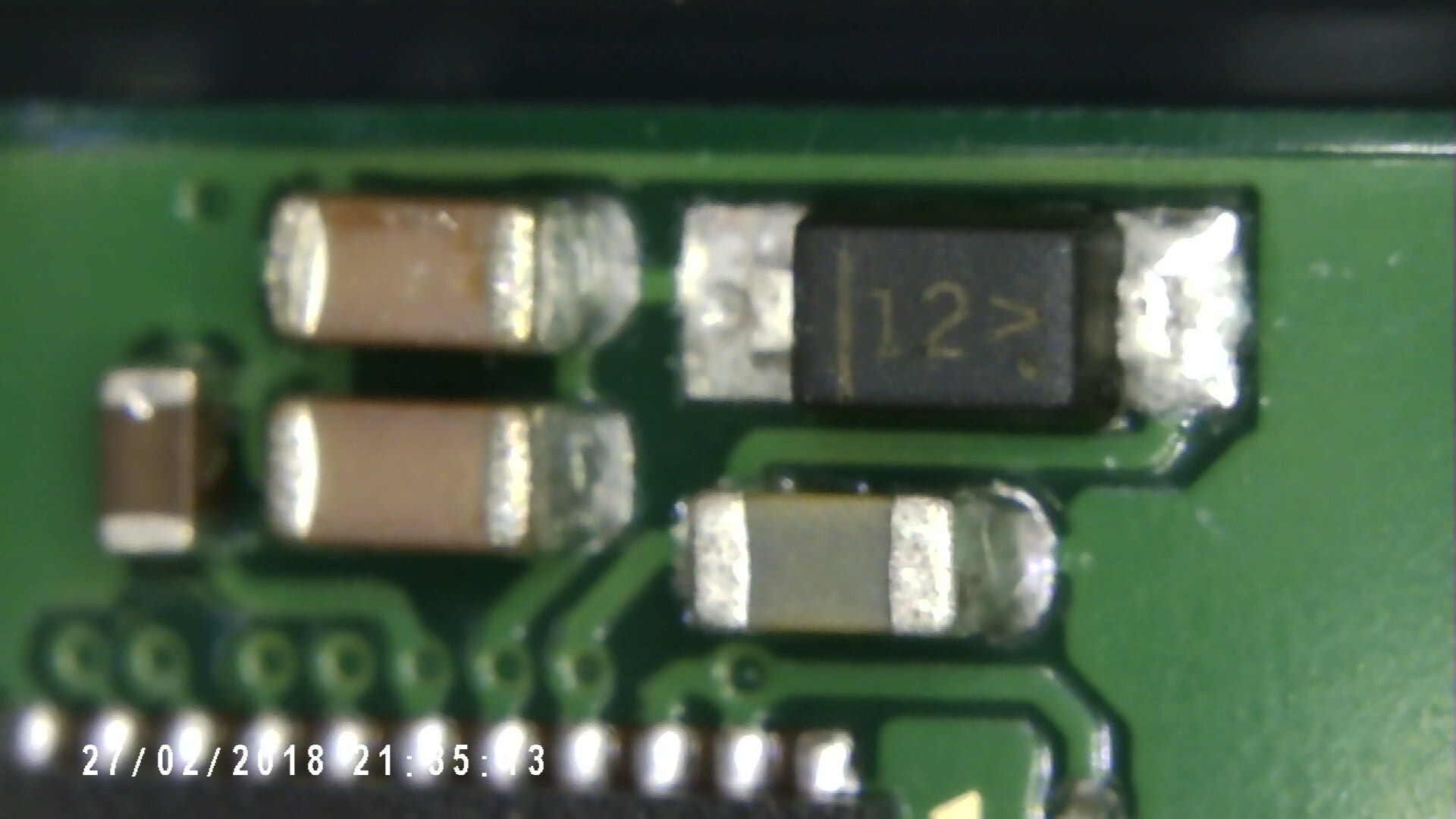

    So after changing the LVDS I decided to not glue the screen again and checked the TFT board for damaged component.
    The only issue I have seen is a cracked ceramic capacitor (but not in short circuit)

    First piscture show the diode (which appear to be a zener diode but not sure and not very familiar with this SMD component, any help will be appreciated).

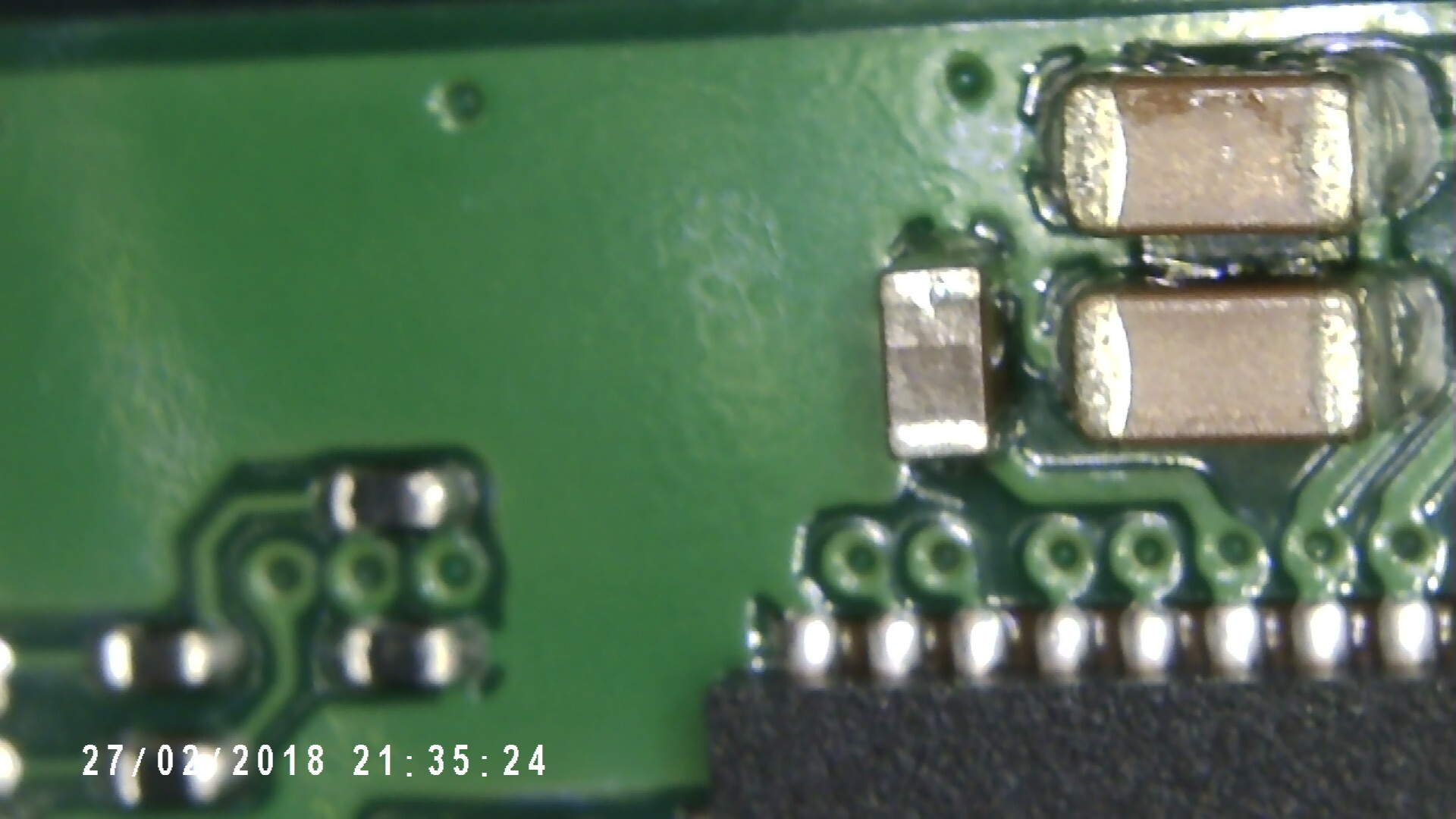

    Second picture show the dent on the capacitor (I read 32kOhm increasing when putting probes on it).

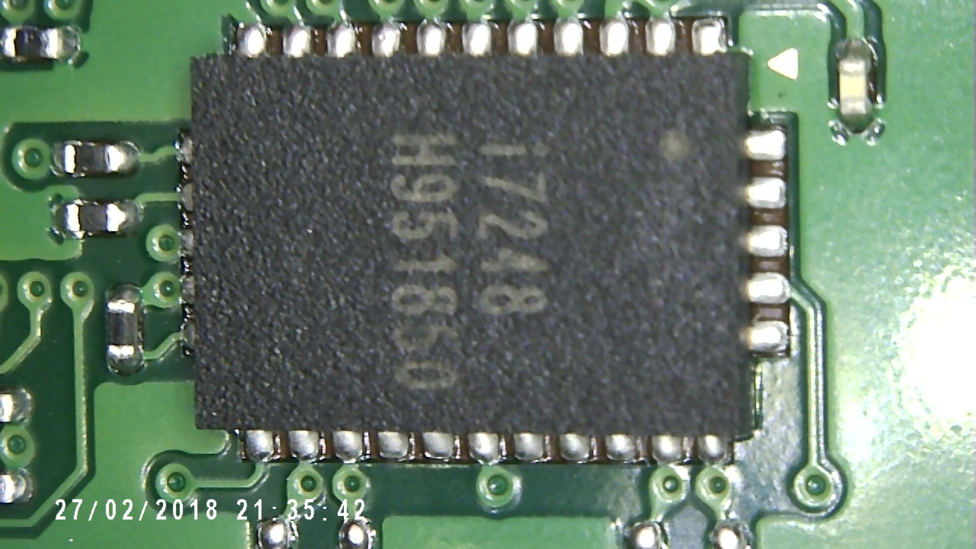

    Last picture shot the controller just under (i7248 H951850).

    Could the capacitor be the culprit and what is the value I must expect (can't find any datasheet on i7248 to see if there is any advice on the value)
    My asumption is that something si missing on initalisation that prevent screen detection and therefore any activation.
    Any help will be very appreciated, the end of warranty is of course overpassed and my friend put a lot of money on it.

                            I have unsolder the 0603 capacitor on the board of the panel => measurement was tricky and capacimeter telling something like 2.6µF (but I have sometimes lower readings in nF).
                            So I replaced with a murata 0603 1µF 10V (ce closest as I have) (25V and 50V are very low capacitors from 22nF to 100nF not much).
                            As it is the initialisation chipset the voltage must be 3.3V (I have measured only 3.3 and 16 to 20V for the main power (assuming for the backlightning).
                            Powering the laptop from cold => Screen works and I was able to play more than 1hour on forza at full FPS.

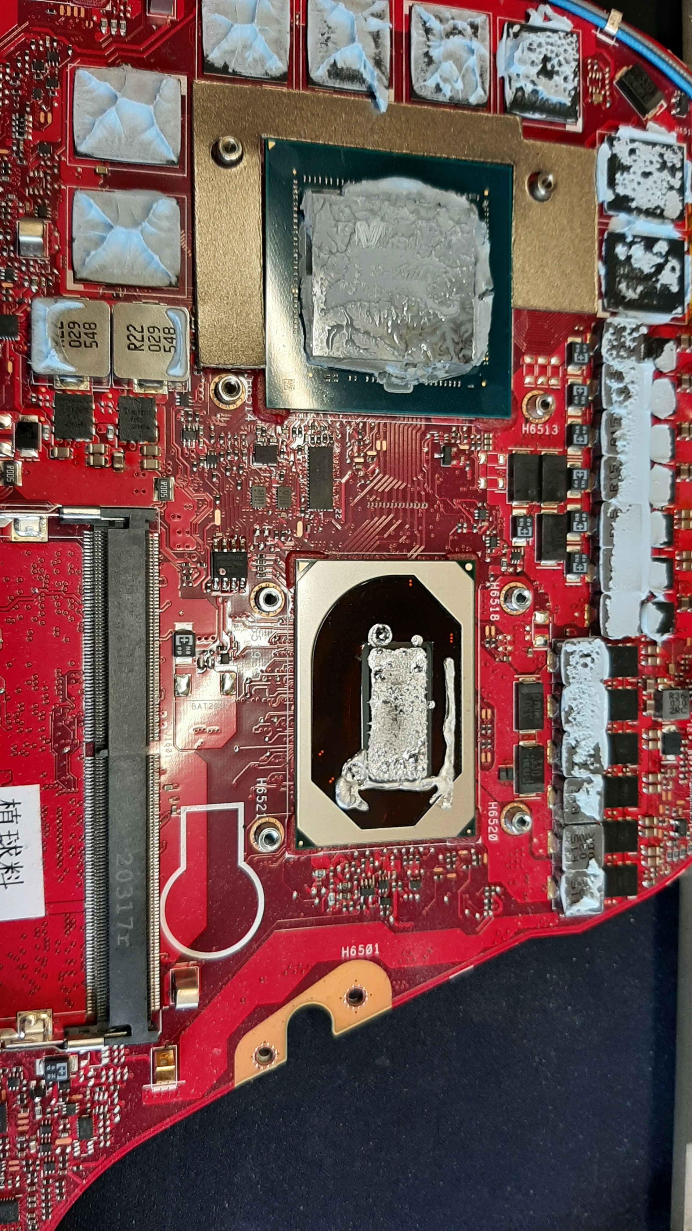

                                    I think you where talking about the U4508 (can't fin the U4580), neither the Q4504 (it is on schematic, but not on boardview (when searching for it, adobe give me the space for left fan !!!
                                    Whatever at first the screen was working fine (start, restart and stop) stopped to working when asking for deepsleep.
                                    I was only able to measure the EN PIN 2 of U4508 and it show a proper 3.3V in all condition (screen working or not), also confusing that I have each time a picture on HDMI and display port.
                                    I give you the picture of the area (I don't have any heasink that can work on the processor which heating like crazy right at startup and with proper heatsink.
                                    So the last safe think to do will be to try a new panel (hope some one can propose the compatible screen at good price ;-)).
                                    For the rest the computer is working fine and there is too much sensitive line in the area that may kill CPU or GPU.
                                    I remain opened to any new Idea.
