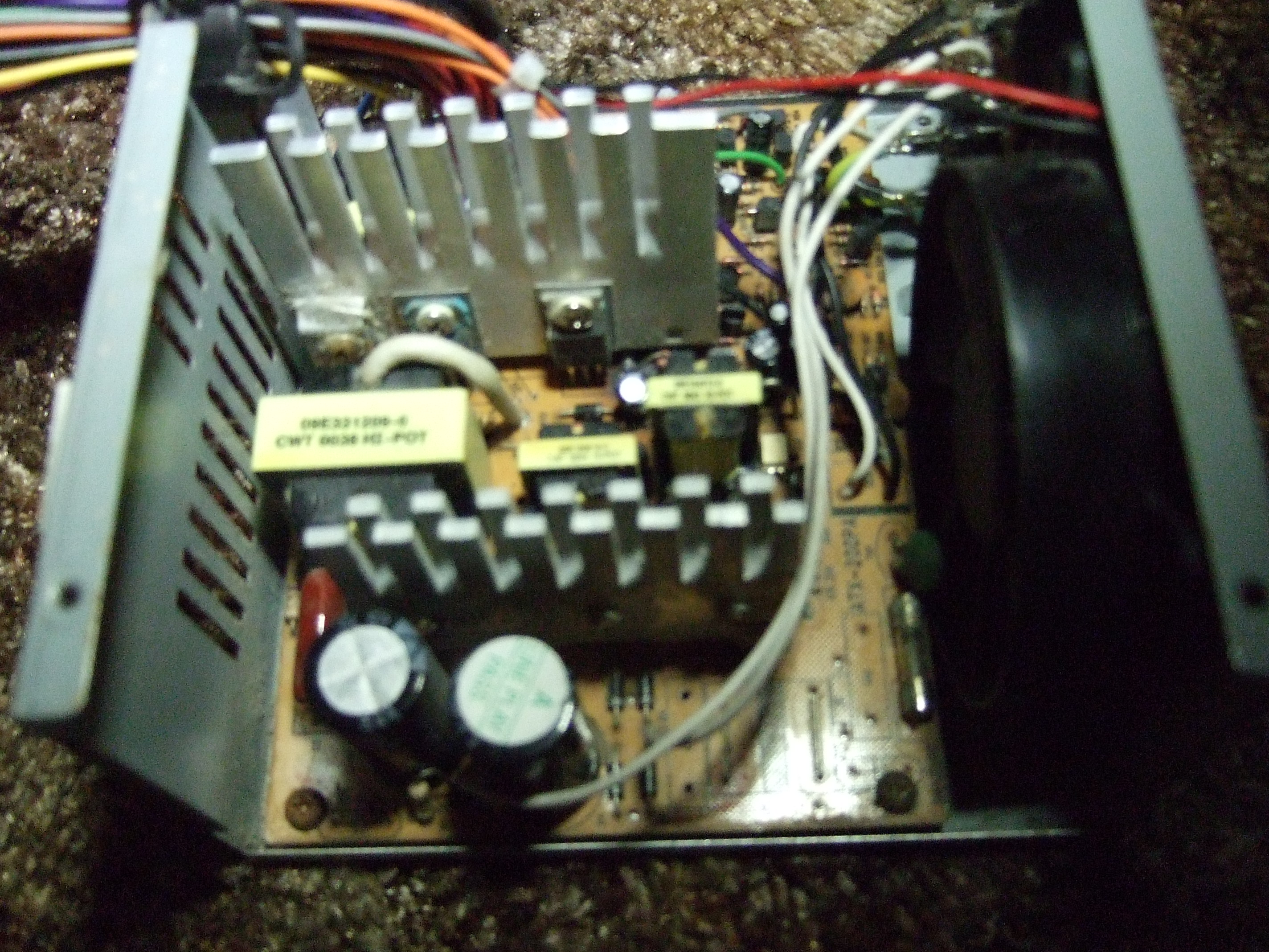

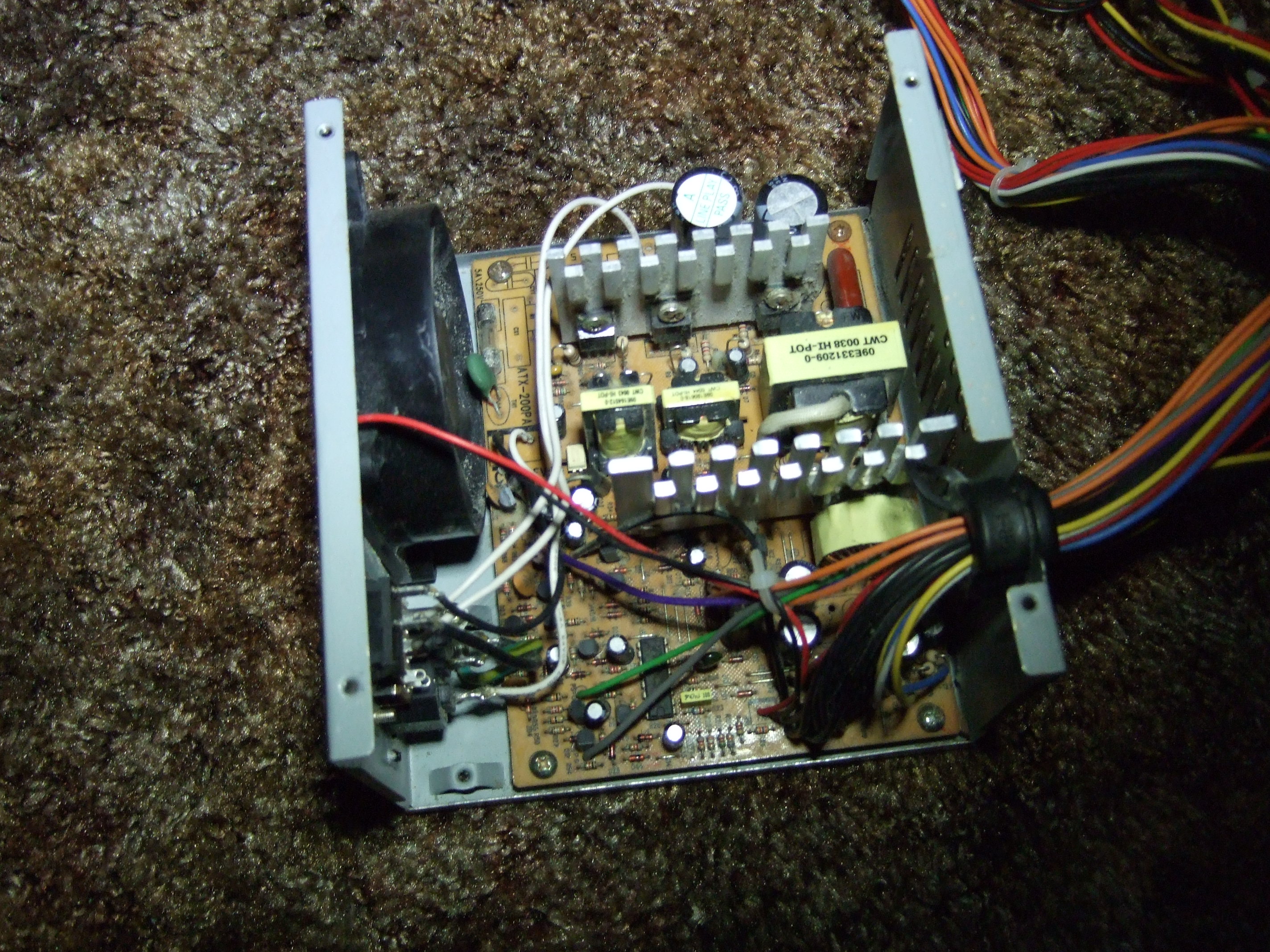

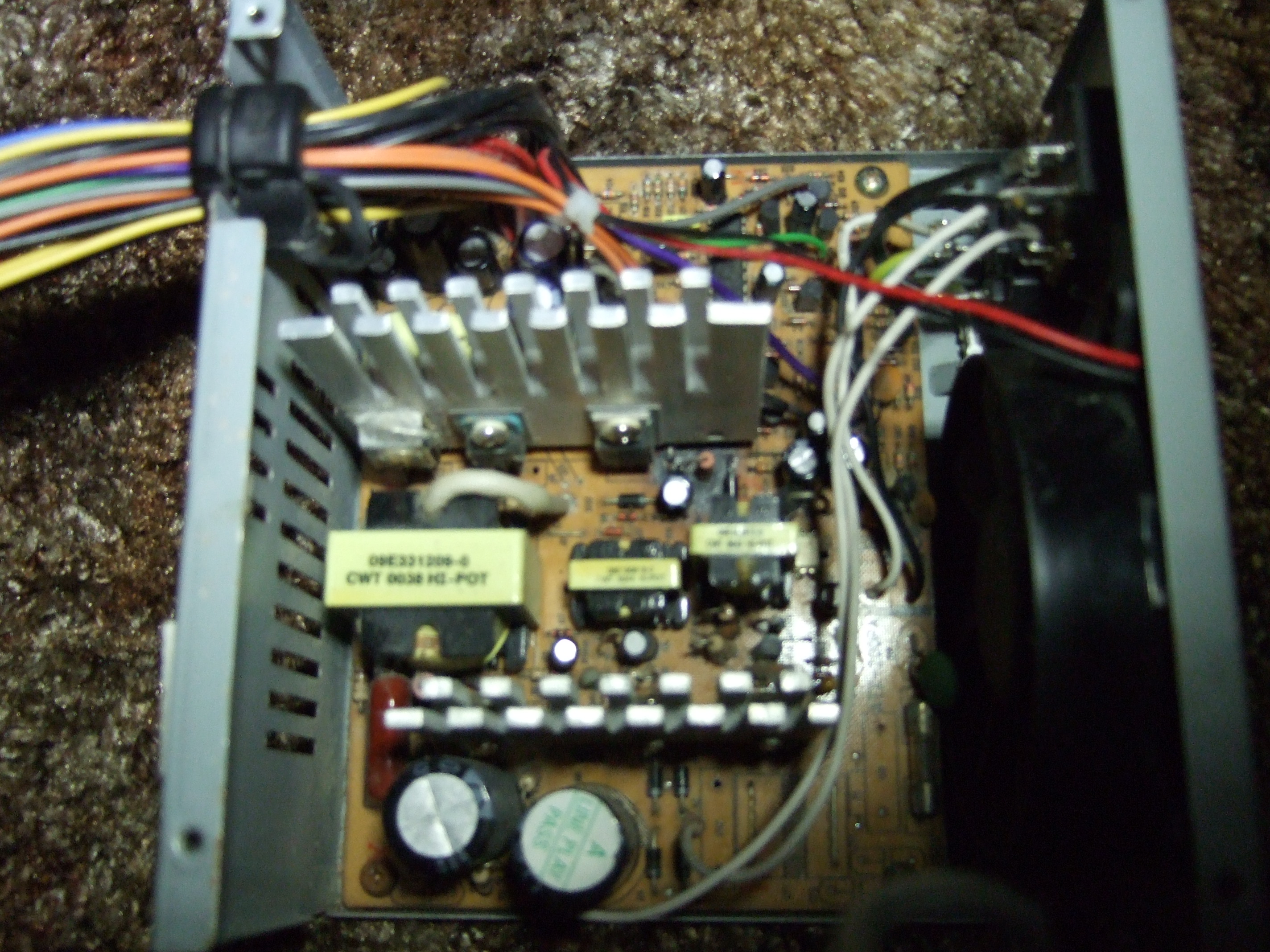

      Hi, thanks for the quick reply.
      I'm real sorry the psu that had the meltdown was on a different one. The fan was liquified and the metal melted there was fan all over the computer box lol.
      The bad psu that was on this one had a burn mark on the board. It was a Sunny Technologies Co.,LTD. MODEL: CWT ATX-250ATX. I noticed it had bad caps so I did a quick re-cap just to see if it would work so that is why there are some new caps.
      I'm a total noob to motherboard repair so um... could you appoint me to the southbridge.... lol

      • goontron
        5000!
        • Dec 2011
        • 4108
        • US
        Re: Broken Pentium 2 Motherboard
        Originally posted by momaka
        Brand and internal pictures of the old power supply that had a "meltdown" would help. If this is one of those cheap gutless wonder PSUs with a suicide 5VSB circuit (i.e. the infamous 2-transistor circuit that made the Bestec ATX-250-12E become known as a "motherboard killer"), then chances are the Southbridge is gone. But it could also be bad caps too.
        yep, that's the one!

              Originally posted by canadaboy
              25The bad psu that was on this one had a burn mark on the board. It was a Sunny Technologies Co.,LTD. MODEL: CWT ATX-250ATX.
              Okay, do NOT use this power supply on ANY computer right now. That power supply has the same suicide 2-transistor 5VSB circuit I mentioned, and the burn mark is exactly because of that.
              If you have a multimeter, though, plug the PSU in the wall (but do NOT connect to a computer) and measure voltage on the 5VSB wire on the main 20 pin connector (normally, this would be the purple wire... so measure between purple wire and any black wire). You should get about 5V (and plus/minus 0.25V max). Try to do this quickly and don't keep the PSU plugged in for too long.
              As far as the I.Q. caps - those aren't very good. Because of that, there's a chance this problem may be a bad caps issue too. If that's the case, then all you would need to do is recap the motherboard (particularly the caps around the CPU) and it may work like new again.
