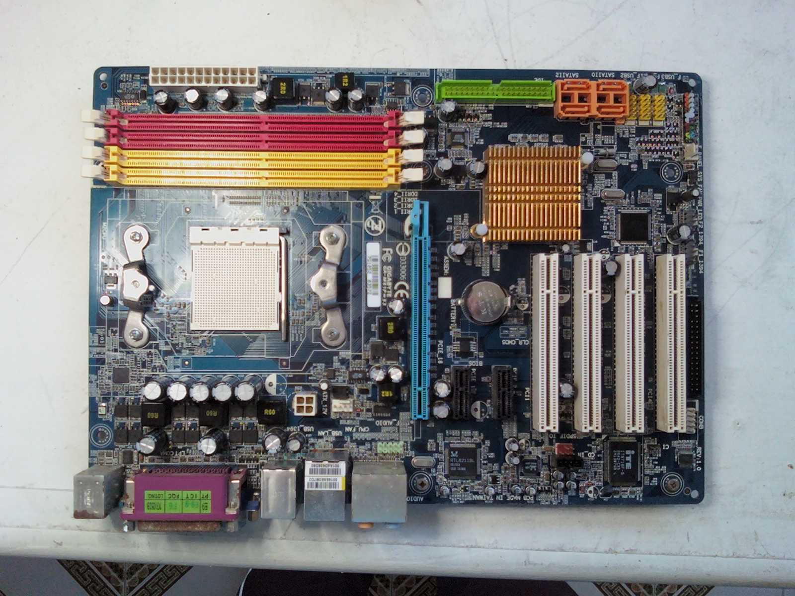

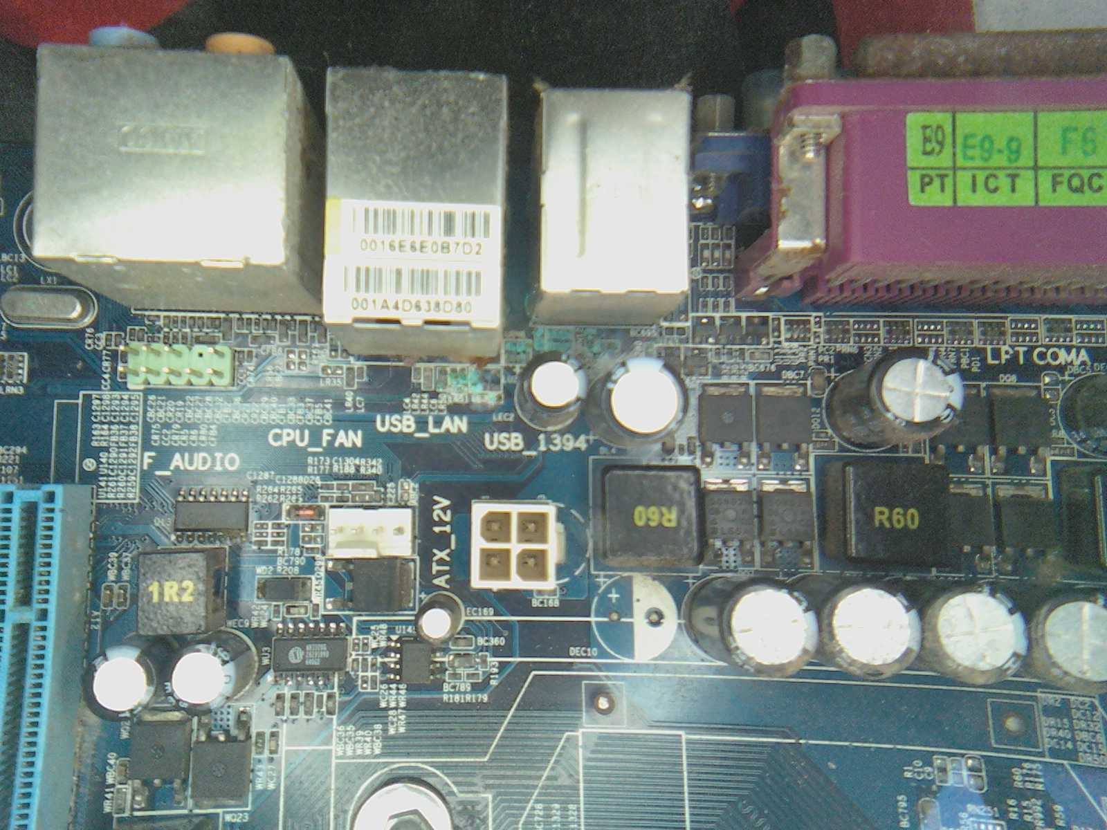

    This mobo I got c. 2007 worked hard for a couple of years in a dusty, salty environment, and then became more and more difficult to boot.
    Once I learnt about the great cap swindle, I thought it might be the caps.. but none are showing obvious signs of failure.
    Could the corrosion visible near the USB_1394 label and the general dusty, salty appearance of the mobo bring on bad-cap-like symptoms of failure?

    i lived near the south coast and can tell you that it will do that, it also has a habit of blowing inverter base aircons. we will need to see pic of the whole board bottom and top so we can recognise any possibly bad caps.

      Not sure, but if the motherboard is very dirty, give it a wash with warm water and any non-clorine-based detergent of your choice (liquid soap or liquid laundry detergents are generally fine). Then let the motherboard dry for a few days and try it again.
      Before you wash it, though, make sure to remove the CMOS battery.

        I was dabbing the corroded area with a cotton bud dipped in isopropyl alcohol, and one of the tiny SMD components just came right off the board and attached itself to the cotton bud. The contacts were very corroded, so perhaps this board is too far gone.
        Thanks for the tips momaka and goontron, I'll get some pix of the whole board later.

          If it's just a ceramic cap, the board may be okay. I guess pictures will confirm. If the rest of the components aren't too bad, you should wash it - the sooner the better.

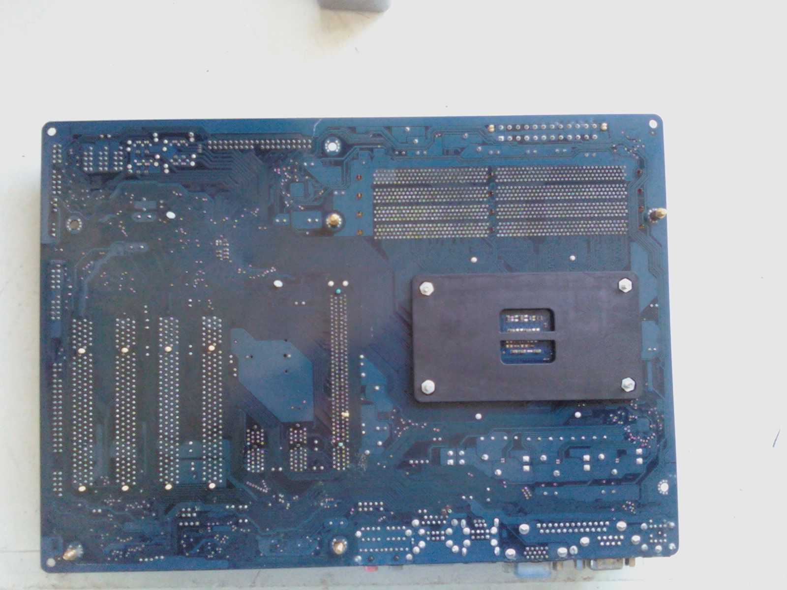

              Mobo photos with dodgy phone.. and yes, I live near a windy ocean, with a dusty yard

                bloody hell! was this in your carport?

                  Wow! I've seen corroded computer stuff, but nothing like this.
                  Yeah that kind of corrosion can definitely make contacts on slots (CPU, RAM, etc.) not connect properly to whatever they are connected to. Could also be rust that has fallen from the ports and partially shorting signal traces. Give it a wash and scrub and see what happens.

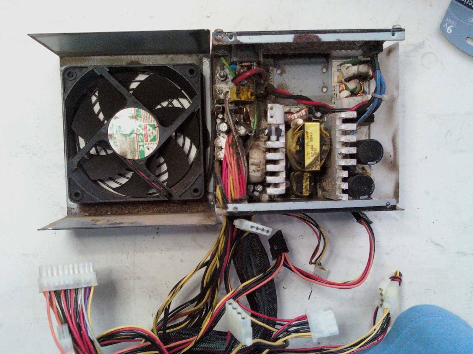

                        Here is the PSU from said computer. Oddly enough, it is reluctant to start. Methinks time to discharge caps and give it a bit of a clean.
                          Looks like the stuff that can literally cause things to go bang!
