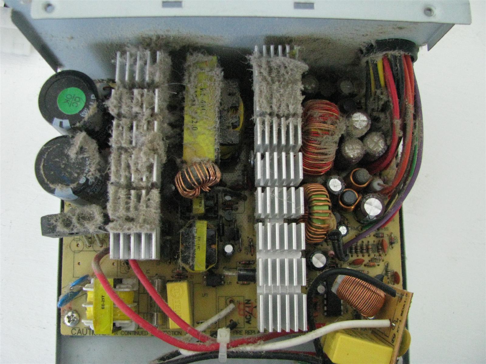

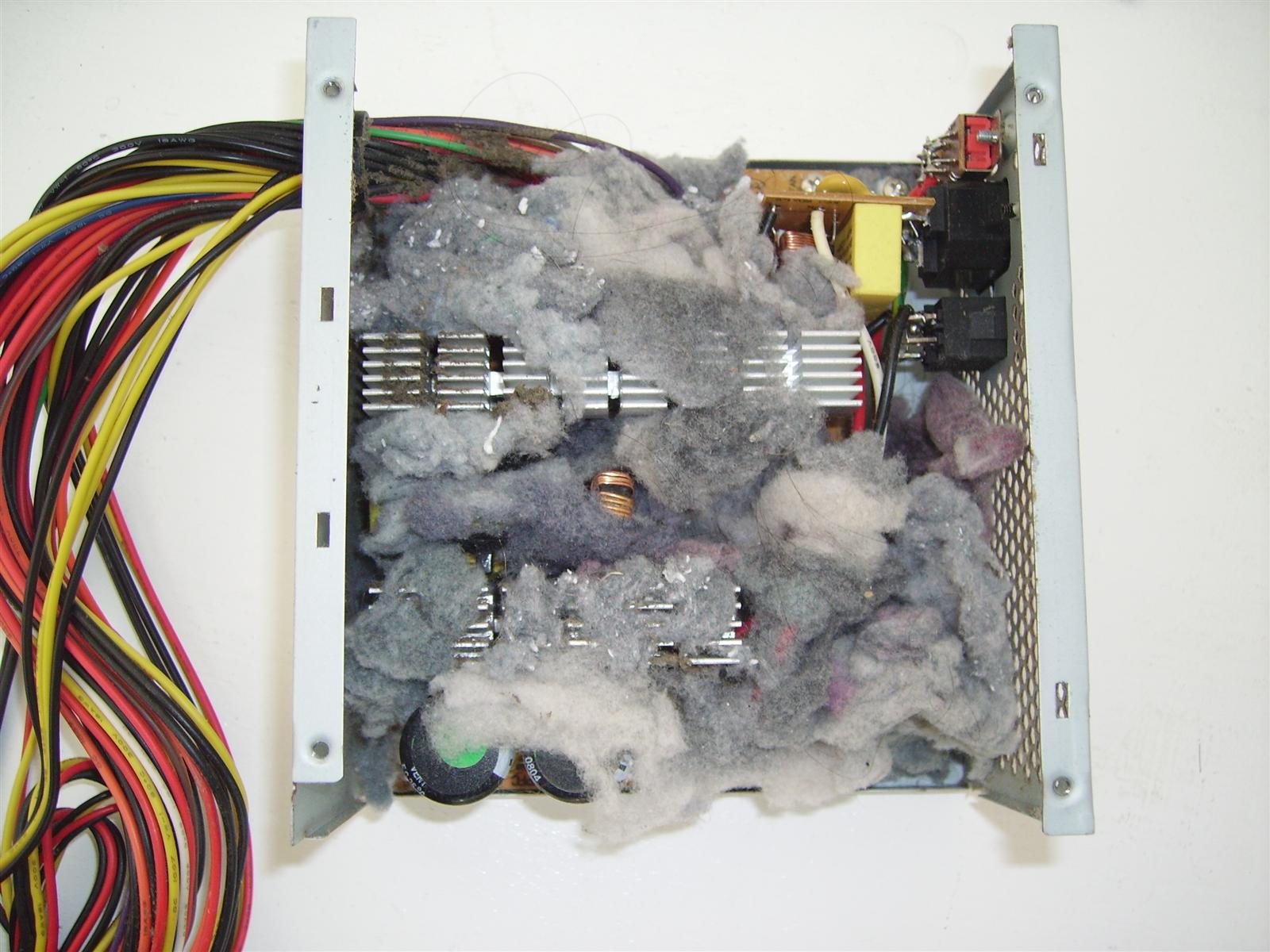

    So, this came my way recently. A Thermal Master 420W PSU, made by Sun Pro, but it was totally packed with dust.

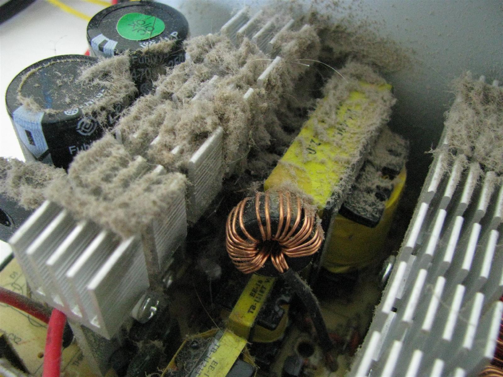

    As you can see, there is a fair amount of dust packed around the switching transistors.
    Rather than cleaning and refurbishing the PSU, I decided to use it for an experiment - Could this kind of thing really start a fire? I've long suspected that an exploding transistor could, but never had the chance to prove it. So, I loaded it up to 350W on the tester. This load is actually safe normally (I have load tested a similar PSU before, which managed 350W OK).

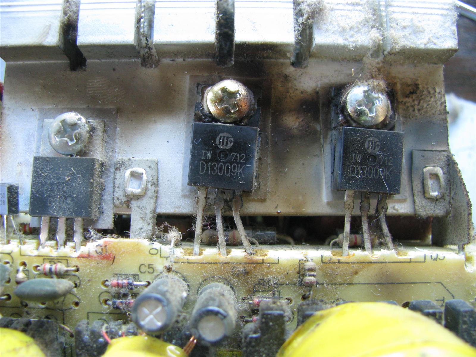

    After less than a minute, there was a massive explosion, and flames shot out the back grille. The PSU stayed on fire for several seconds...

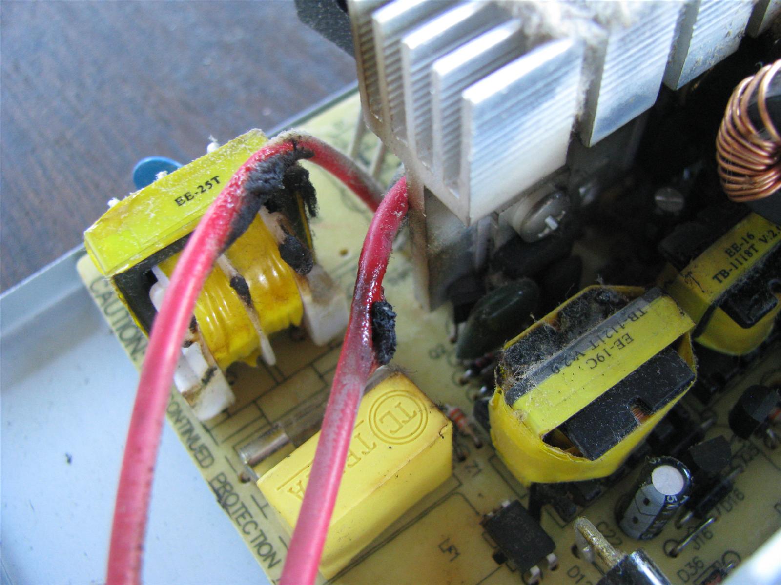

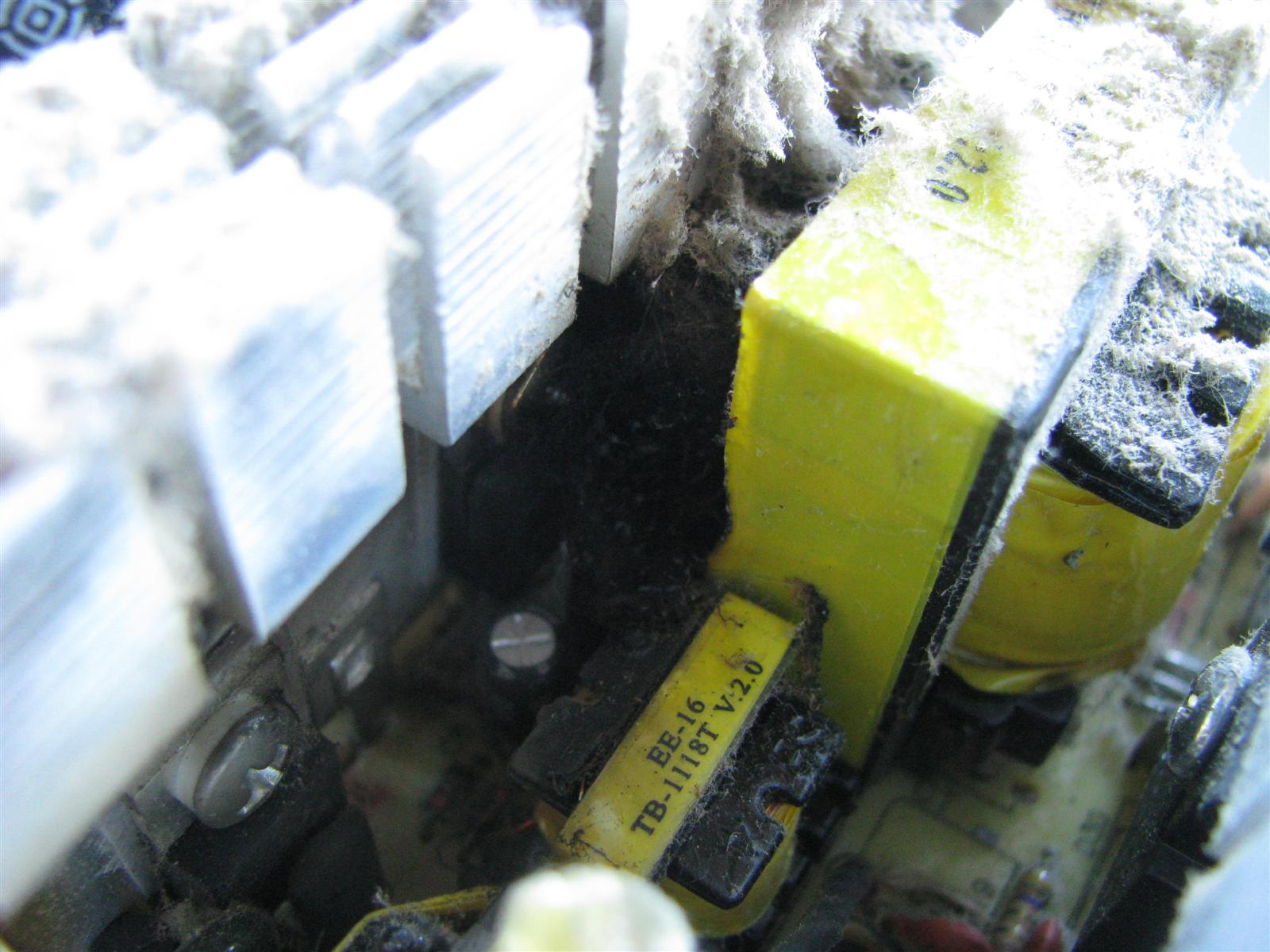

    ...which melted the wires on the voltage switch and charred the EMI filter coil somewhat,

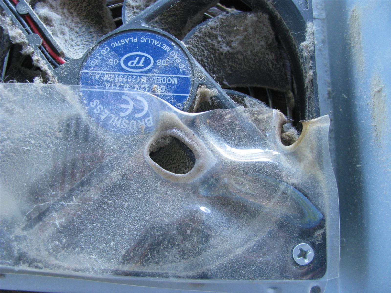

    melted the airflow baffle,
    and gave us some pretty nasty charring on the heat sink. Both of the switchers were just about blown in half.
    Thankfully, the fire did self-extinguish after a few seconds, but I certainly wouldn't count on that happening every time, if there was a little more dust in the PSU than what I had here.

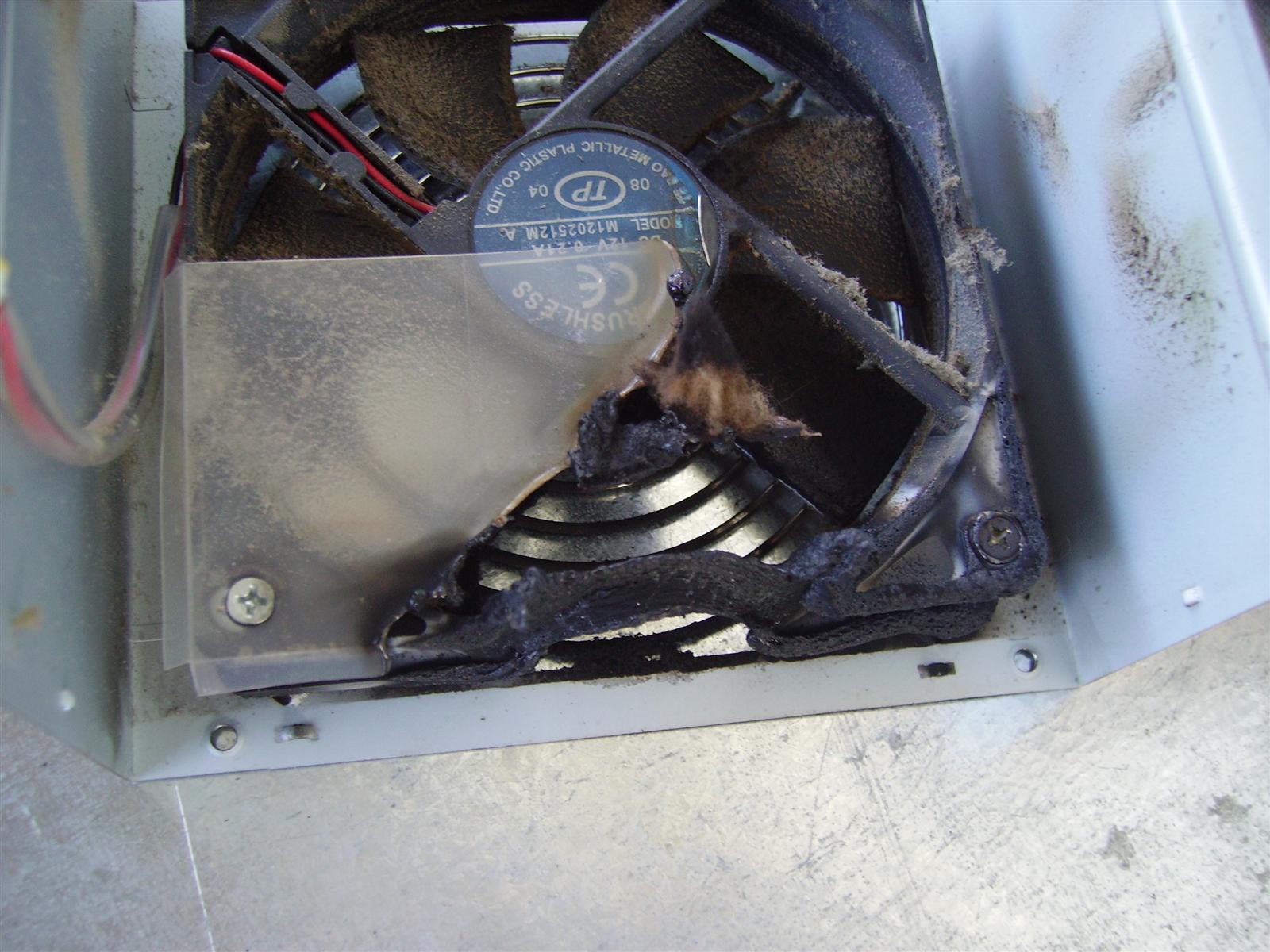

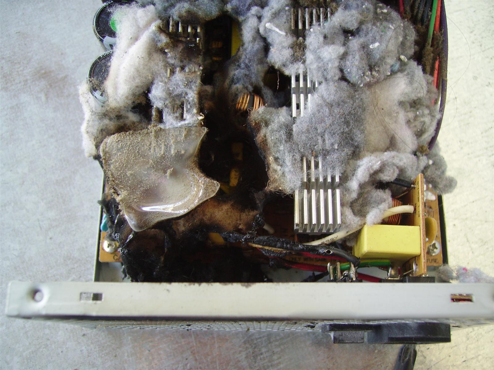

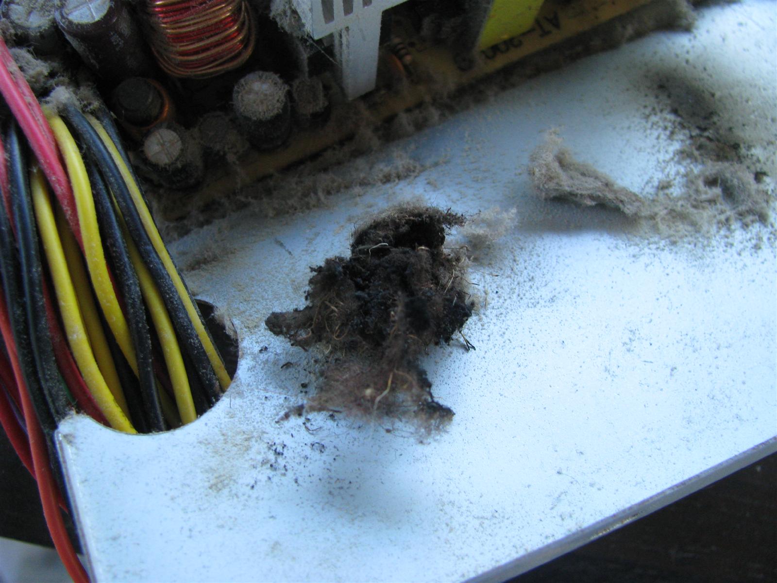

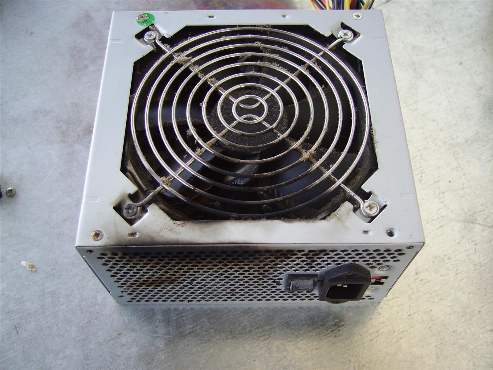

                            I decided to repeat this experiment, as I got my hands on another identical PSU which was destined for the scrap heap. This time around, I added the dust. I used a lot - as bad as the worst I've ever seen before.
                            Yup, that's packed with dust. That's about as bad as I've ever seen it get. Let's load her up to 350W and see what happens...
                            The fire really took hold this time. That looks pretty burned.
                            Bits of melted plastic (presumably from the fan) on the test bench
                            Um, yeah. That's wrecked. A re-lube isn't going to fix this fan
                            It's surprising just how much of that didn't burn (and how much of it you don't need for a fire to take hold)
                            The only reason it isn't worse than that is because I put the fire out after just over a minute (the smoke would have annoyed the neighbours if I had let it burn out). If I hadn't done so, I think there would be nothing but charcoal left.
