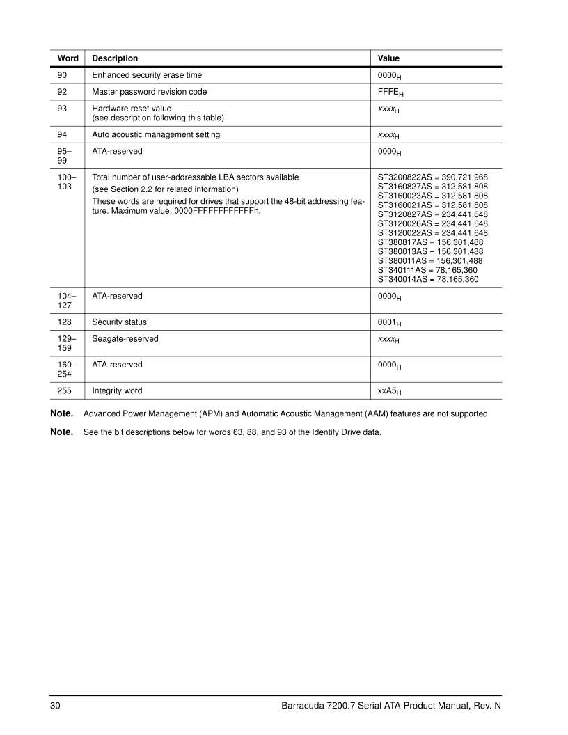

      Page 30 of the 7200.7 SATA manual. Can you see what's wrong???
      • Shocker
        Banned
        • Dec 2011
        • 635
        Re: Old HDD discussion
        No-one's responded??? It specifies that word 94 is the AAM setting BUT it also says the drives don't support AAM.

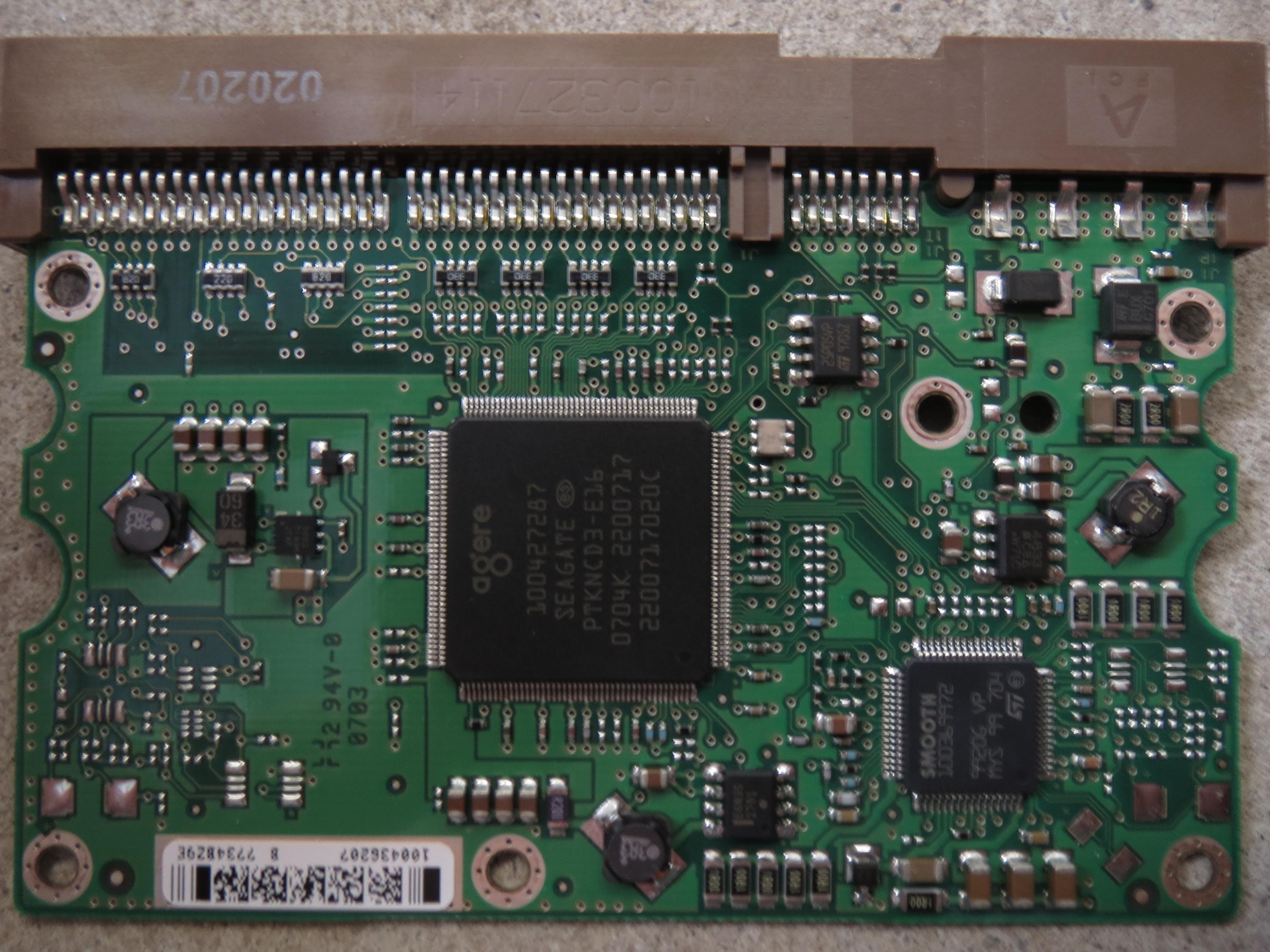

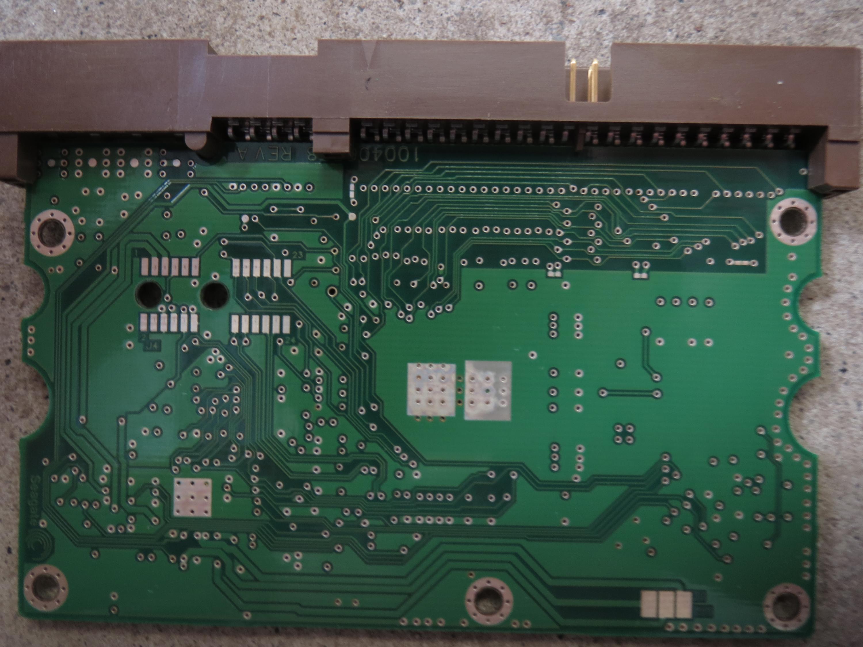

                  PCB photos of the ST3320620A I have

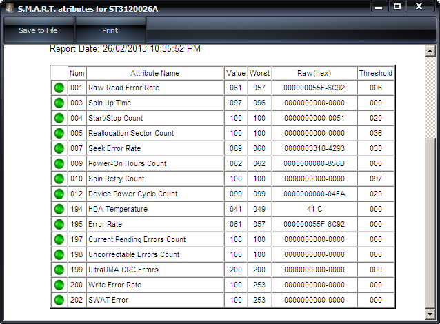

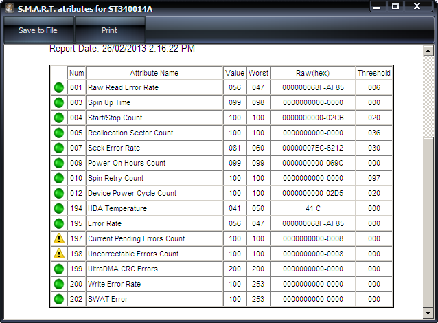

                                  While the aforementioned ST3120026A still has a spotless S.M.A.R.T. record even after 34,149 hours, its smaller counterpart isn't doing quite as well even with only 1,692 hours. See the attachment.
                                  Not to say I treated this ST340014A too well - anyone remember what happened to it last year??? Not surprising now that the last few attempts at loading S.M.A.R.T. on that drive were so slow.
                                  So yeah, please don't store your only copy of something on a HDD that has been subjected to substantial operating shock. Not that you should use any HDD for storing your only copy, but you get the point.
                                  EDIT: Reload, both of the alerted values have gone up by 1. I'd run KillDisk, except it doesn't work on this PC for whatever reason.
                                  I also noticed that with said ST340014A powered up without a data connection, I heard, very faintly, something that bears a slight resemblance to the click of death.
                                  By manufacturing date, the mentioned ST340014A is actually older than the ST3120026A by a bit (17/09/2003 and 12/10/2003 respectively). That's no explanation for what's happened, though.
                                  EDIT 2: The real kicker is that I actually ran KillDisk after the incident (before KillDisk stopped working on this PC) and it seemed fine.
                                  Of course such a short run-time does leave the opportunity for the drive to prematurely fail from a manufacturing defect.

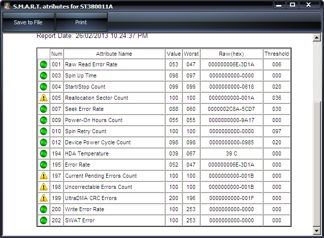

                                      Worst fears confirmed
                                      What else does that ST340014A do but click.
                                      I do have two more ST340014As. One of them worked fine the last time I checked, but has a SMOOTH chip. The other has a missing ceramic capacitor. I might use a capacitor from the dead ST340014A to fix the damaged PCB.
                                      The ST380011A seems normal.

                                          Okay, SERIOUSLY?????
                                          Scratch that. 27 and rising by the minute...
                                          The reallocations and CRCs were there before. The pending and uncorrectable sectors are new. I don't know if it's some kind of demonic influence or such, or if it's just a really strange misfortune. The ST3120026A seems fine though.
                                          Okay, but WHY did two similar drives get affected, but not a third???
                                          And WHY did it happen on the same day I got a Raptor???
