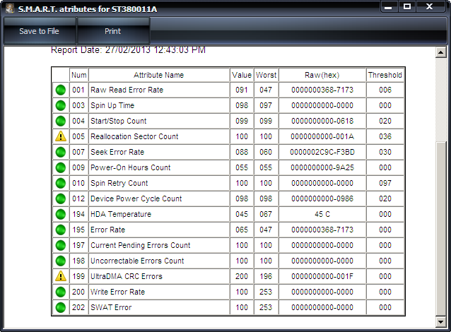

      I attempted reformatting to see what would happen. The format process seems to be stuck at 20%. I'll swap the master/slave positions of the ST380011A and ST3120026A to see what happens.
      • Shocker
        Banned
        • Dec 2011
        • 635
        #43
        Re: Old HDD discussion
        Done. Nothing seems to have changed much, except that the pending and uncorrectable counters on the ST380011A have gone up another 3.

          ...50...

            I found an option to erase the drive in HDDScan. I started it for the ST380011A and will see how it goes.
            • Shocker
              Banned
              • Dec 2011
              • 635
              #46
              It might be "healing" itself. The pending and uncorrectable counters have reset to 0 and the reallocation counter is unchanged. Although the ST340014A is dead, maybe this one will survive.
              • Shocker
                Banned
                • Dec 2011
                • 635
                #47
                Finished the wipe. In all reality, the drive seems fine. Currently formatting...

                    Re: The aftermath
                    It seems fine now.
                    Scratch that. The pending and uncorrectable counts are up to 90 and the reallocations have gone from 26 to 30. The runtime is 39,473 hours. Looks like this one has had it.
                    At least the ST3120026A is still hanging in there.
