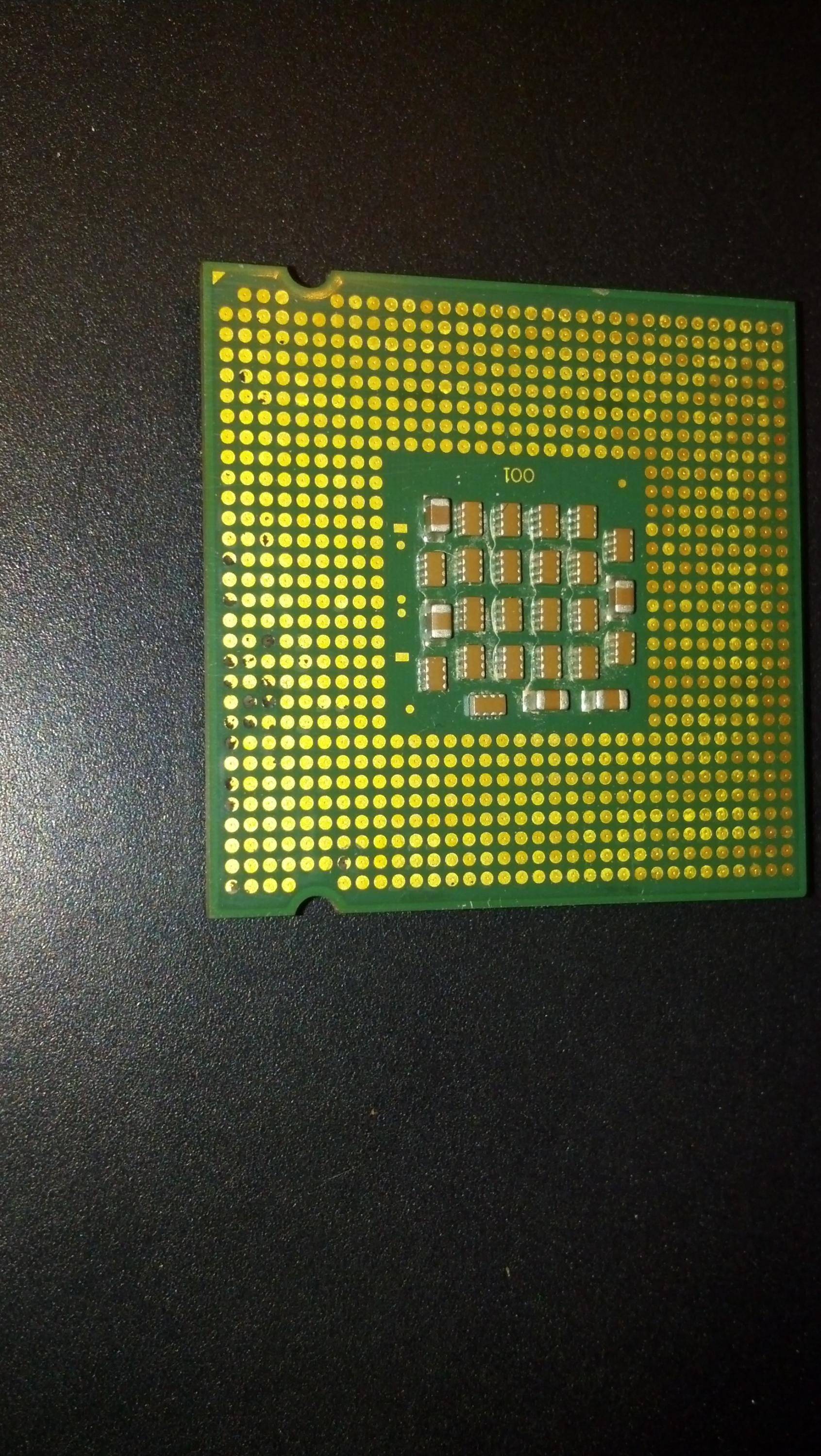

      Be careful this doesn't happen to your cpu !
      The kid that brought me this non booting Dell Dimension said he allowed his "friend" to borrow his CPU while a new one arrived to replace his buddy's last one. Too kind.
      Said "friend" claimed it should be fine "it was working OK in mine".
      I don't suppose anyone knows how to re-deposit a layer of gold on the damaged pads ? Without having access to Intels' fabrication plants that is !!

        ohh wow.....I really wonder how that happened..... Too much socket removal and reinstall could explain maybe one or two like that.....but there's a lot of damage there. Poor handling would be my guess.

          That or he decided to shine it up with a scouring pad ! Shame, about $200 in the can..

            What proc was it?

              Actually the sockets are only rated for 20 inserts and removals I think. (Can't find source of this)
              And there where some problems in the past with the sockets themselves, making poor contact and thus burning the CPU's contacts pads due to arcing... (Just like the pic above)
              http://www.anandtech.com/show/2859
