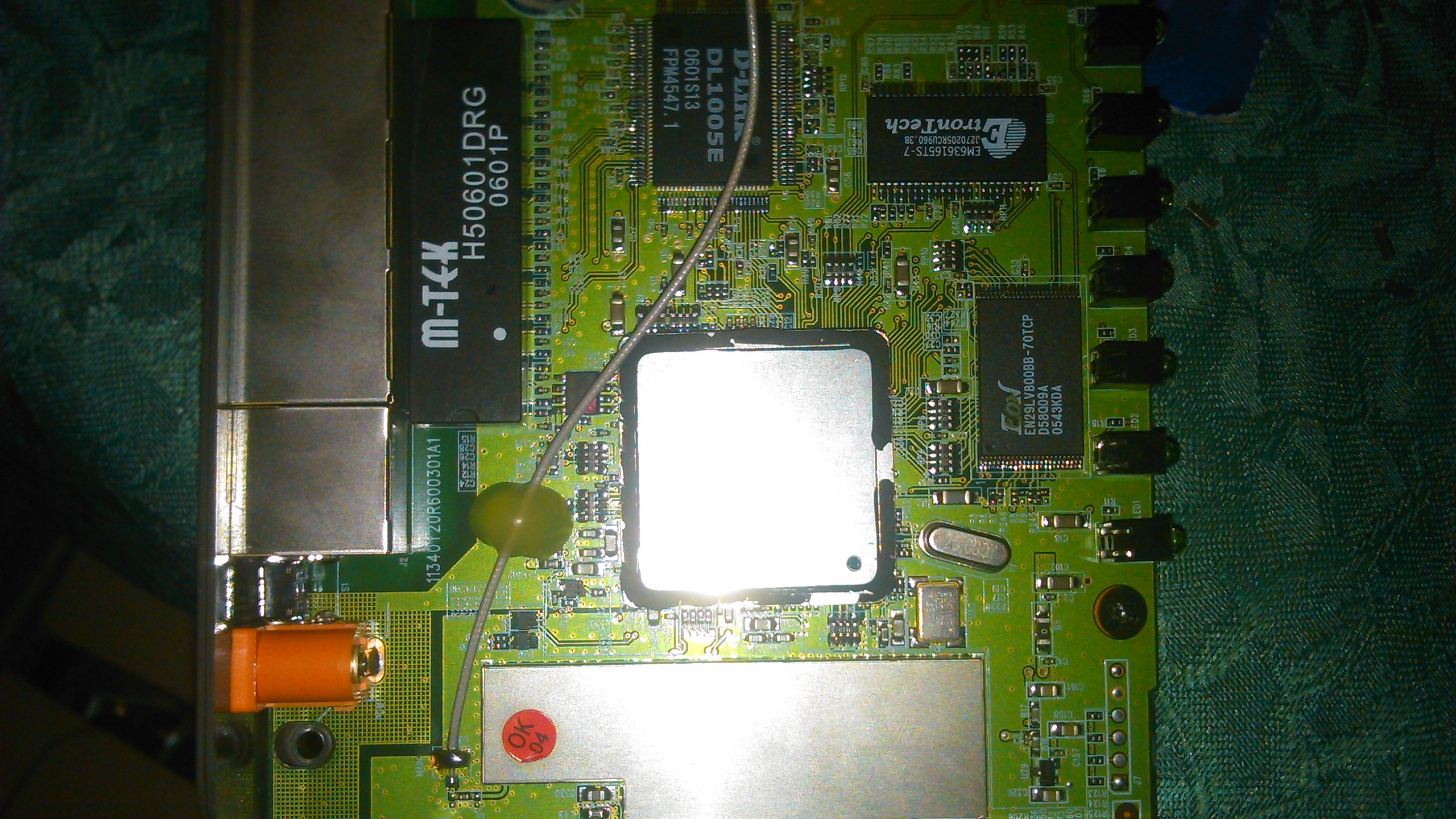

    the star of today mod is a dlink di-524 router that i want to prevent from overheating using as you see in the image attached a ihs from a s478 p4 flipped upside down and stuck to the procesor using ceramique 2 thermal paste in the middle and super glue in the 4 corners of the main processor of the router
      • 31151
      #282
      Re: The ghetto mod thread
      superglue vaporises when it gets hot.
      i have a big tube of thermal glue for such things

          even without it doesn't get hot i put that just to be sure it never gets and for superglue i put it just to be sure it doesn't fall of and ceramique 2 also act as a thermal glue it self which i have seen in action in my old belkin router

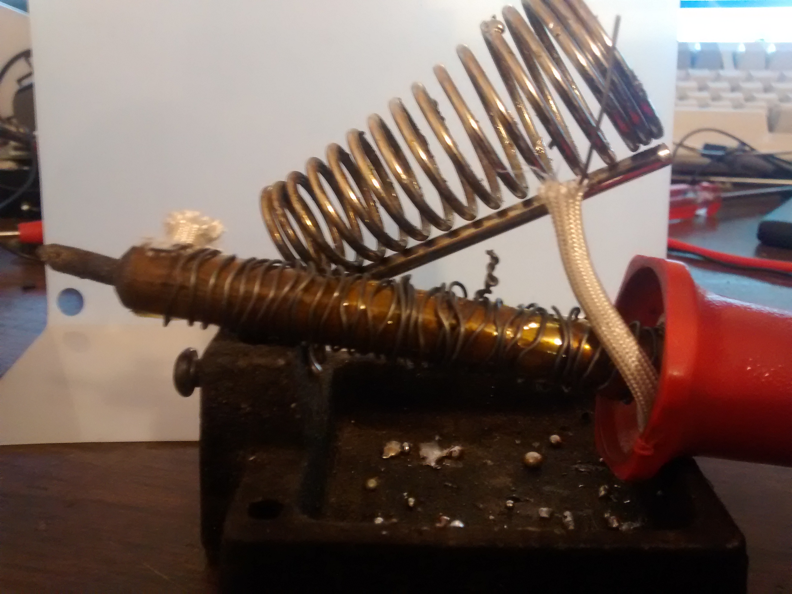

            In contrast to the post above, here is something that is suppose to get reaaal hot. 175 watt soldering iron. 50w main element 125w secondary.... Notice its a crap $10 soldering iron.
            It had a meltdown before I could even post this.... Jeezless!
            I need to try a woven ceramic sleeve next time. The kapton let go.
              Yes, many ceramic-based thermal compounds tend to become "sticky" when they get heated up and especially as they age. In fact, I once even pulled a CPU out of a motherboard (ironically, it was a s478 CPU too) when I tried to remove the heatsink from it. The AS Ceramique 2 was actually freshly-applied just an hour prior to that, too. And yet, it still stuck. Imagine if it had aged there for a few years with a Prescott HT CPU.
              The heat spreader you put should definitely help make the temperature changes more gradual for the IC underneath it. I did this to a motherboard SB. I think the mod is a few (or more) pages back, though.
              Someone needs a better iron here
              Kapton tape is heat-resistant, but only to a point. You need mica insulator sheets.
              Better yet, just make a new bigger tip out of a solid piece of copper. The iron will then have more "heat reserve", so you won't have to crank it that hard.
              Nonetheless, cool mod. I guess whatever works to get those big solder joints unsoldered is all that matters anyways.
                I'm hoping to get a good hakko station around May

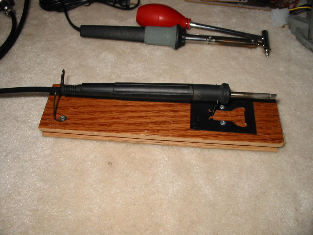

                  This is what I use with a 5 mm bevel tip:
                  https://www.circuitspecialists.com/l...l-display.html
                  Not the greatest quality (it's an Aoyue inside, I think), but nothing it can't handle in terms of solder joints.

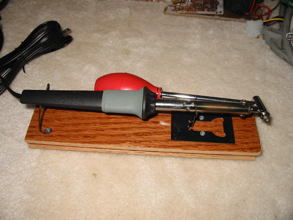

                      While on the subject, here's the stand I use for my station above:
                      https://www.badcaps.net/forum/attach...1&d=1456445392
                      Why? Because I got the station second hand and it didn't come with a tip holder, which is why I made the above. It also fits my Radio Shack bulb desoldering iron, as you can see .
                      Materials used: piece of hardwood flooring, steel wire, screws, and the black metal bracket that actually came with the RS desoldering iron.

                        you should replace that bulb with a pump & footswitch or button on the iron shell

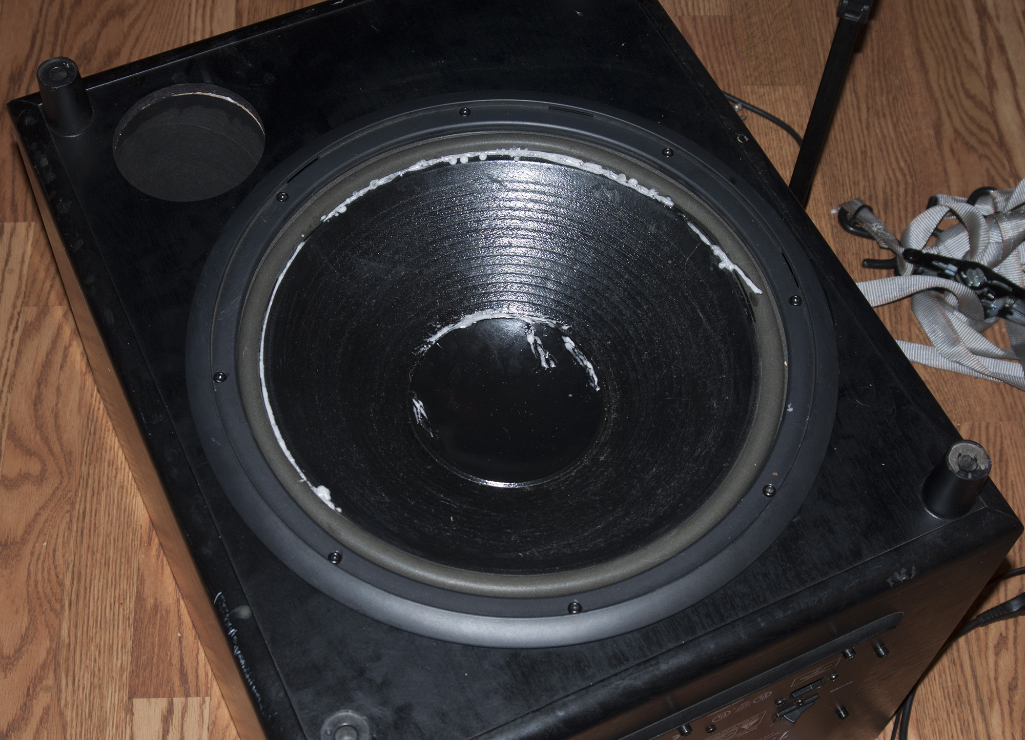

                          Picked up a $15 Advent AV550S untested as-is. Got it home and frrrrt frrrrrrt. Yup, blown sub. After examining and working at pulling the dust cover I realized the cone wasn't wasn't attached to the foam at all.
                          After some redneck foam gluing with gorilla glue (what I had on hand) it's now working fine with only some cabinet rattle. Not the best designed cab but unless I'm driving it at stupid levels it's fine.
                            That's not a blown sub . Just a tiny bit weathered .
                            Gorilla glue for the rescue. Nice!
                            You sure the rattling is not coming from the speaker? Any rips in the foam or tiny spots left unglued to the cone or basket will produce a ton of rattling and/or creaking noise (I know this from my paper surround experiments). Try playing a very low frequency - something along the lines of 5-10 Hz, and see if you can hear any bad mechanical noise coming from the speaker itself. If yes, then it needs more Gorilla glue.
                            Yes, I could... but I hardly use even as it is anyways. I only bought it to desolder flybacks from TV boards and ICs on single-layer boards.

                              Basically the problem was the surround not attached to the cone and when the cone hit the surround (because it wasn't attached) it was making the vibration fart sound. Once that was reattached the problems are all gone. Working fine in the living room now.
                              It probably is supposed to have rubber but I'm just ghetto modding, not going for ghetto car stereo as well. Doesn't start to rattle until it's at beyond reasonable listening levels (aka drowning out everything else).

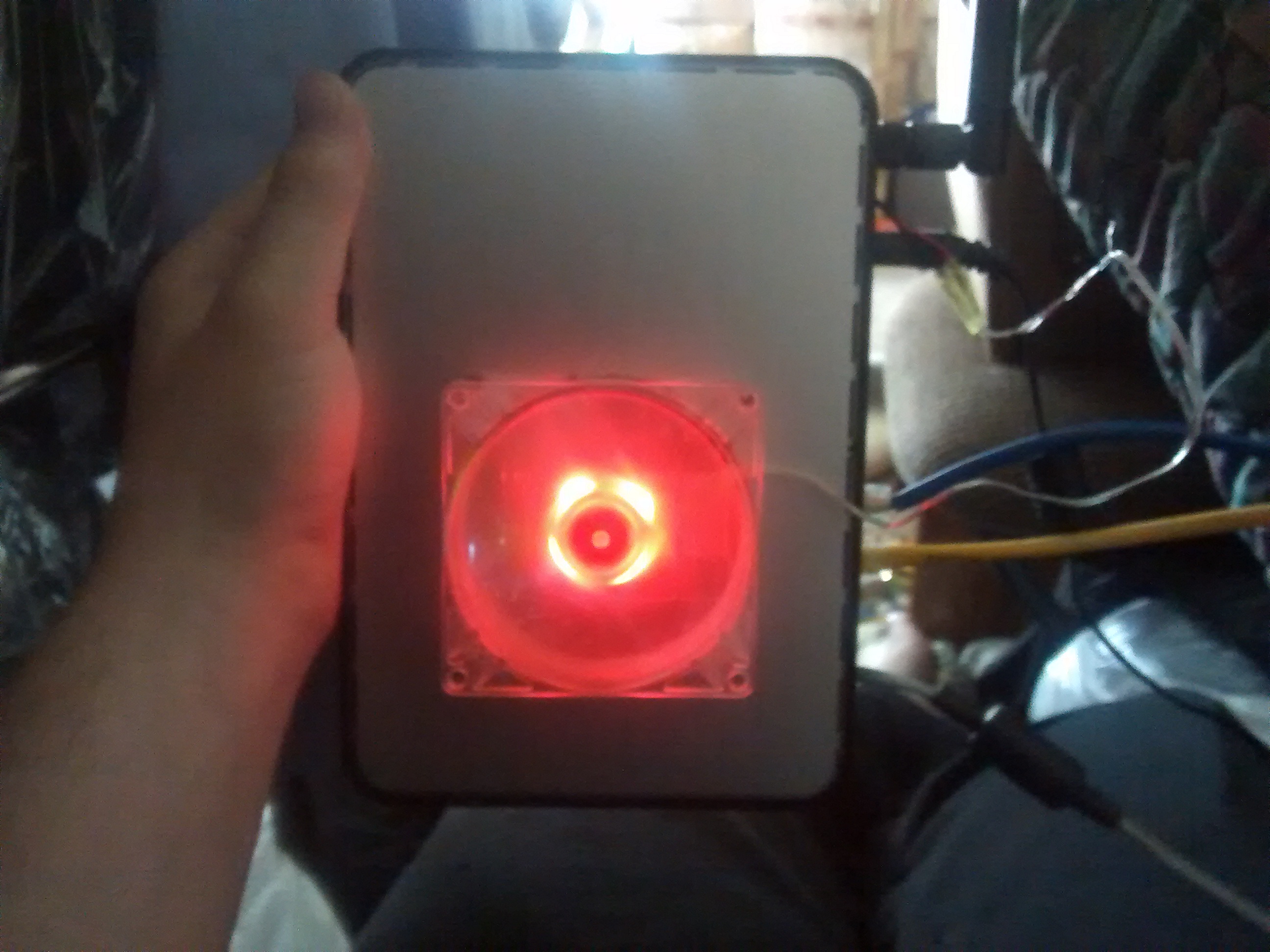

                                  C1000a died... Got a replacement a version older, made sure it wasn't going to cook or crash!

                                    I hope it's not too loud
                                      12dba, 32cfm at 1700RPM... The fish tank next to it is louder!

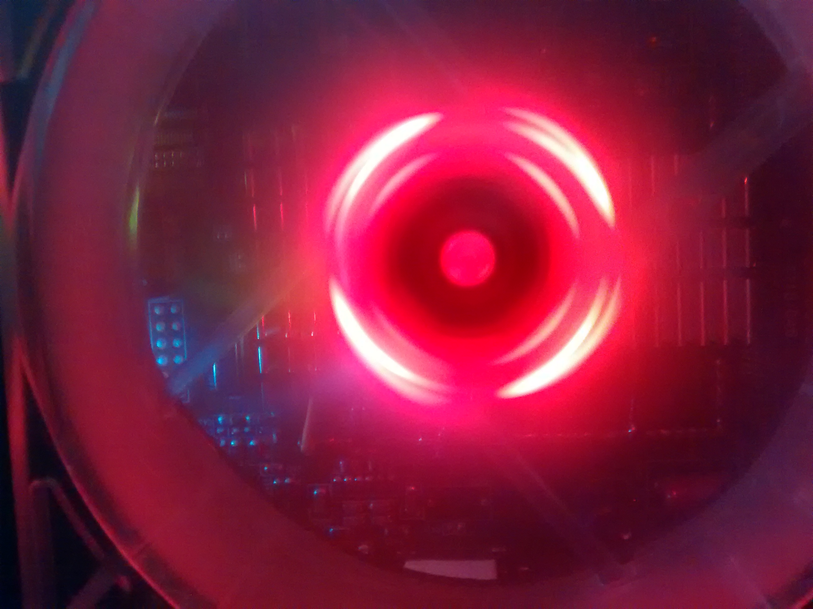

                                        I just noticed something... "I'm sorry, Dave, I'm afraid I can't do that!"

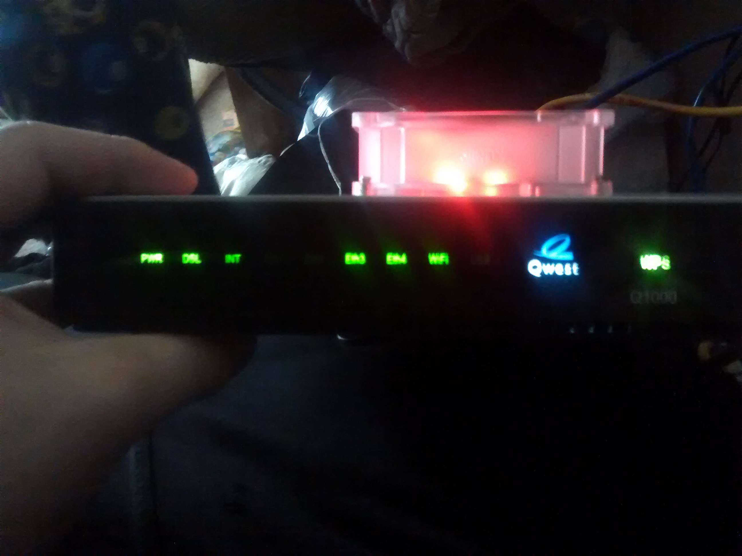

                                          I was about to say... yes that red circular glow...
                                          I have a Q1000 as well, and for a period of time it kept on crashing. Apparently Centurylink can remote update firmware in these modems and they don't tell when... which is annoying.
                                          For the past couple of weeks it's been OK. Not sure what was up.
