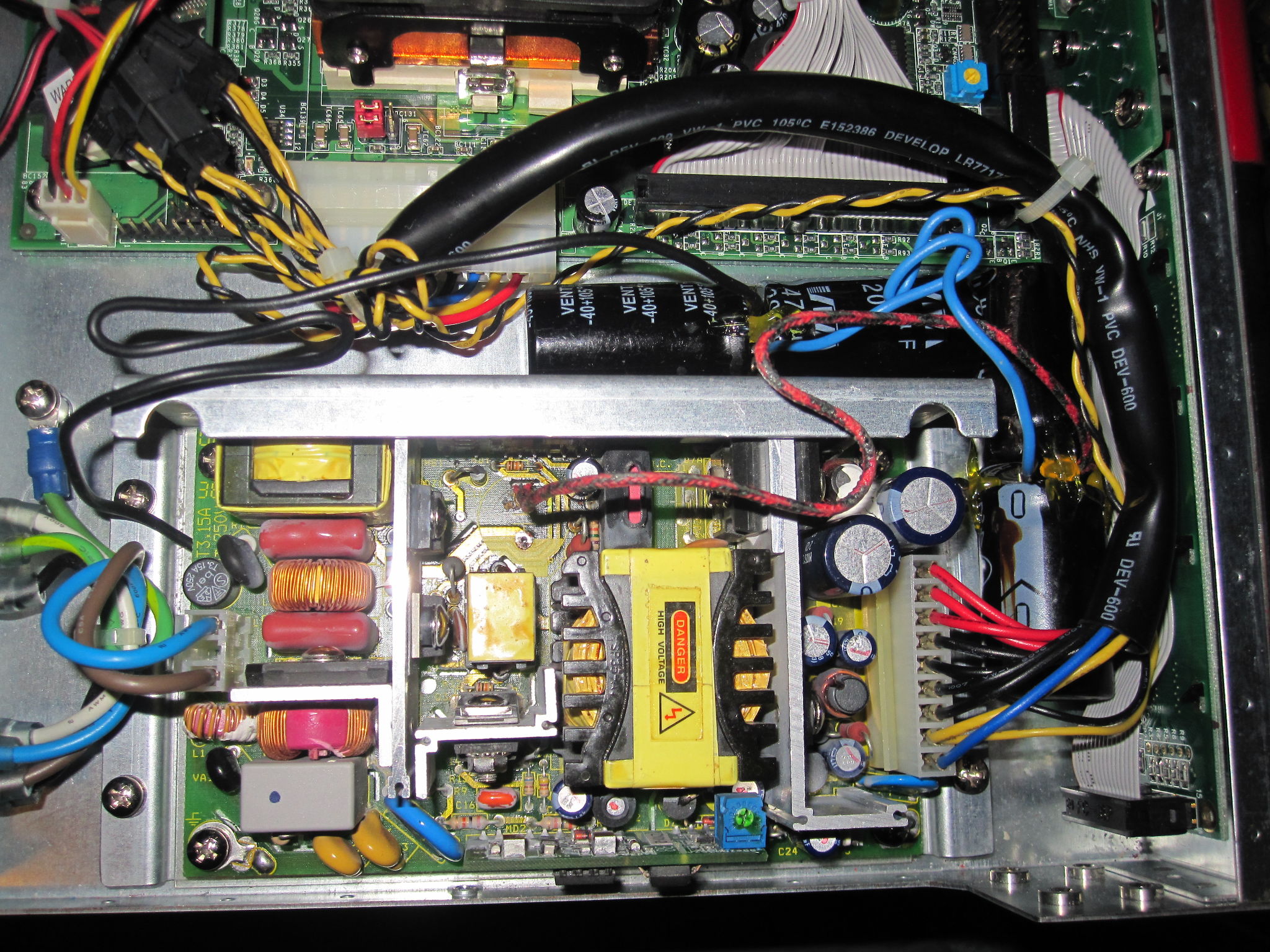

                          Oh NO. That terminated Skynet got a ghetto fix!
                          If you look carefully, I routed out the 400V APFC boosted voltage with long inductive wires to four junk 470uF 200V capacitors in series (each of which measure 350uF or less), secured together with hot glue. JEE I wonder how long these caps will last, VIVA la ghetto! (I measured the four capacitors to be a hair under 80uF, so this is much closer to the desired 47uF. Plus best case this should be "good" for 800V though I'd derate to 600V - well above the 400V needed.)
                          I hope this is a bit "less" temporary, I just want less things that are half opened... but this still needs a proper fix.
                          And YES IT'S WORKING NOW, the machine boots up fine once more!

                            ^ Oh my!!!
                            The radio/CB dudes will certainly love you for this "invention"!
                            Oh, and you got to take your JEE joke back . (The VIVA one made me chuckle too ).
                            Speaking of the repair... did you install balancing resistors on the caps? If not, be prepared for
                            I would have also only gone with only two of the 200V caps in series if the original cap was rated for 400V. Sure the capacitance would have been much higher, but the APFC circuit would have probably been more than happy with that (and you'd get much longer hold up time).
                            Also, I'm not sure if installing a big (1-3.3 uF) 400V/450V film cap in parallel with the APFC cap would help with some of the high-frequency suppresion, but I did it on my ThermalTake M850W PSU that had a blown APFC cap. I'm hoping the film cap basically makes it easier for the 'lytic APFC filter cap.
                            Anyways, I was just starting to wonder the other day if this thread was dead or if I should post something to revive it, but looks like you beat me to it.... and with a great ghetto fix, too!

                              Nope, no balancing resistors. I was thinking about it but decided against it because I overkilled on the total voltage rating. I tried two at first (actually two ~200uF due to bad cap or just within tolerance) and measured the apfc voltage to exactly 400V across the two. I shut it off right away as likely one of the two caps were slightly overvoltage. With the four caps, only two of the four need to bear the brunt of the 400V so I was thinking that this should be sufficient and not install balancing resistors which would complicate assembly immensely.
                              In that respect only 3 is sufficient (plus I'd probably need to put in balancing resistors), but I had these caps in pairs and I can't think of a reason why I'd only need one at some time. I have more pairs of these caps anyway, unlike 47uF 420V...
                              Another weird note is that I tried measuring the caps before putting this together, just to get a feel for what the total capacitance would be like. Oddly enough each of the two "matched pairs" that I measured - i.e., both JEEs and both VIVAs - capacitance were within 1uF of each other (!) despite the JEEs not equaling the VIVA caps:
                              JEE #1: 350uF
                              JEE #2: 349uF
                              VIVA #1: 330uF
                              VIVA #2: 330uF
                              Note that all four of these caps are labeled 470uF...
                                Ouch.
                                That doesn't matter, though. The caps with the lowest leakage current and/or lowest capacitance will take on most of the voltage. Of course, getting closer to the cap's (actual) voltage rating (which can easily be 10-20% higher than the printed rating on the cap) will make the cap leakage current go up, so that should balance out the voltage somewhat. But you really don't want to rely on that, because when running caps near their maximum voltage, they have a greater chance of arcing-over internally and failing. And once one of the caps fails, now you will have 3 caps sharing that voltage, until the same scenario repeats. And if one of the caps fails open circuit, say goodbye to your APFC section.
                                ... so I was thinking that this should be sufficient and not install balancing resistors which would complicate assembly immensely.
                                Lol, how would balancing resistor complicate assembly?
                                You just solder the same value resistor across the legs of each cap.
                                You could use just one - phone charger with huge input cap and thus overkill hold-up time?

                                      Originally posted by momaka
                                      Ouch.
                                      I was wondering about that too so I actually measured the leakage at 600V for the 800V stack with my Sencore as 600V is the limit... it actually was in the microamperes or less in leakage!
                                      So I should be glad I still have APFC working when that initial 47uF cap pretty much failed open when it leaked out all of its electrolyte?
                                      I was also worried about too much capacitance blowing the inrush resistor!
                                      Note that I had to freehand wire them in series - no PCB - and try to make sure there were no sharp points pointed toward metal edges, with minimal cost (so minimize extra insulation, so the current design has ZERO heatshrink in this whole "design"!). I ended up pointing the capacitors together with a short piece of wire to hook then up in series, and wires going into the middle of the two "stacks". The hot glue made sure they don't twist and short together, plus the wire insulation prevents additional twisting too. Adding the resistors would make it tougher to solder together, it's more stuff to solder.
                                      In any case, this is only temporary, holding over until I can get a proper fix. As I have lots of radio equipment, I know I've got more than enough electrical noise around here...
                                          Yes, you should.
                                          An APFC boost coil without an output cap is like energizing and de-energizing a relay without a snubber diode - you get massive voltage spikes, and there's no telling what those are going to take out.
