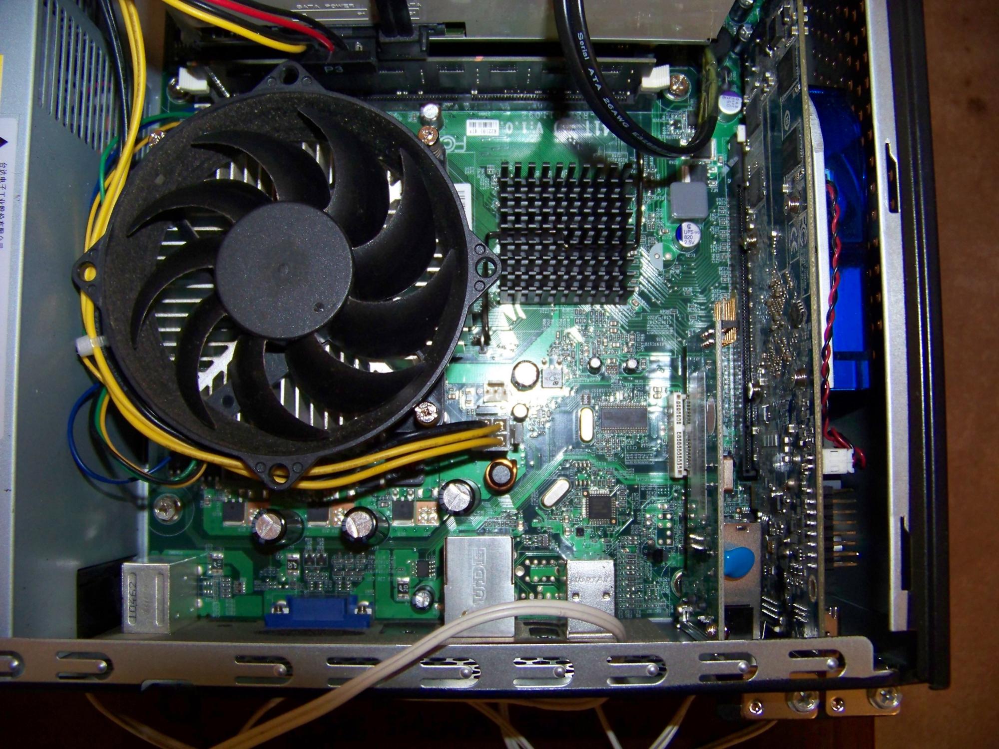

    Well I finally decided to break down and take some pics of my latest poverty rig.
    The CPU is still running a tad bit warm for my tastes even after installing the 120mm fan on the side panel. I tried hooking it up to the motherboard's 3 pin power connector but the BIOS has the PWM output set so low that the fan won't even spin up. Its amazing that the scythe fans still even work, had them since like circa 1999ish with god knows how many thousands of hours on them... nothing like good old fluid dynamic bearings. Since there was essentially no other viable way to power the fan I just decided to hack a couple of the crimp connectors off and use a spare wall wart with a bit of terminal block foam taped to the side to make the connections. My DMM reads 11.65v... a bit high perhaps for a 210ma unregulated 9v rated PSU.
    Now with the fan running it takes about ~25-30 mins of Prime95 before my CPU temps top out around 67-68C... quite a bit of improvement over the ~5 minutes to reach that temp before. I still think its running pretty darn hot for what it is. Going to attempt application of Artic Silver and see if that helps my core temps go down any. AFAIK the heatsink has never been removed but who knows. Would be a great time to use some scrubbing bubbles on it and get it nice and clean.
    I think Friday is going to be full tear down day... gonna finish cutting another air hole up around the graphics card and try to BSEL mod the CPU.

    Looks good. I would clean the HS though, its probably clogged with dust.
    I also wouldn't call this a poverty rig... one of those would be a dying celeron unit that is 10+ years old and riddled with bad caps and severely yellowed due to having an ashtray in the front. It would run an old version of bootleg XP with no AV and enough malware to give the best of us a bad day at the least. (I've seen these before, they do exist )
    What you have is a ModBox... Extremely modded, yes, but clever and showing of the owner's skill (in a good way). Be proud that you know how to actually do this, as it will both turn heads and save you money down the road.

      Dust? look at the pic. there's barely a spec of dust in sight.

        If it hasn't been removed, I'd check anyway... Looks from that angle are sometimes deceiving.

          If you can see the fins that well, its fine. This is when it's a problem...

            Actually I think the only cleaning I done to the inside of it was to sloppily take a q-tip to the inside of a couple fan blades. I wonder if the dork squad cleaned it for me.
            Also speaking of wondering, I'm not for sure why it has a separate NIC in it when there is a port on the motherboard.
            Also I think I see a couple GSC caps on the mobo. Those will probably need to go at some point.

              The graphics card should be cooled well enough by the side vent.

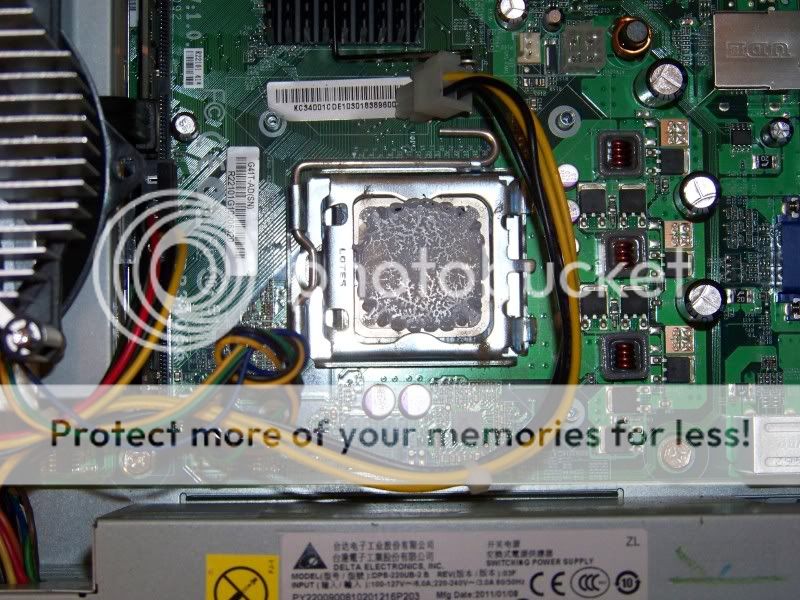

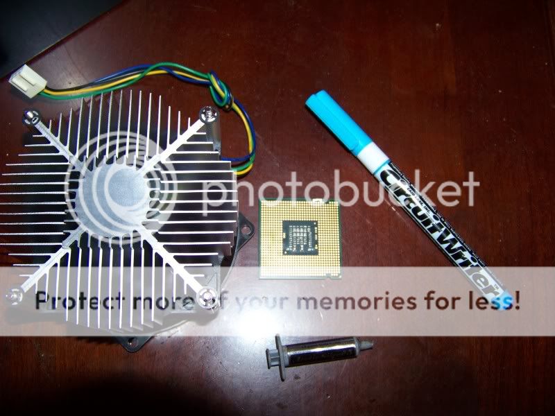

                This afternoon I finally got around to attempting a BSEL mod using an extremely overpriced CircuitWriter pen from Radidio Shack. The results? Well it worked. Sorta.
                Basically I got nothing when attempting to use my DDR3-1600 Gskill memory... nothing but one big long continuous beep. Tried clearing the bios, single stick, one new stick one old stick nothing. Popping in the old memory resulted in the computer booting up into windows, but it was behaving quite weirdly. Prime95 would run, but took a while for both cores to come up to full load, and CPUID was reporting that the CPU was indeed running at 1066FSB and 3.4ghz. But it was also reporting a 2.0v vcore. Temps were below below the previous typical readings of 68C. After noticing the core voltage reading I had to forcefully shut down the PC by yanking the power cord. So I think its definitely safe to say my CPU is capable of a 30% overclock, but my motherboard is just a crappy POS that won't let me.
                Also have a couple side notes about the CircuitWriter pen and the stock heatsink goop. The pen does indeed work as advertised and the shit is conductive as all hell. Easily passed the DMM bleep test with flying colors. I think it should be mentioned that the pen was dried up and clogged when I got it. Had to immerse the tip in some camp fuel (petroleum ether aliphatic hydrocarbon blend... pretty gentle stuff compared to benzene derivatives like toluene and xylene). Once I got the pen going I found the ink or whatever is not very easy to apply neatly. It seems like it does not want to drag evenly across the PCB, rather it wants to sort of blob up on the sides of the trace being drawn and leave a hollow part down the center. Of course that can be overcome by gently squeezing the pen but that makes over application very easy. Its actually a whole hell of a lot like the consistency of white out. Also the ink doesn't seem to want to stick to the PCB worth a damn and the traces are easily scraped off with fingernails even after several hours of curing, which can be a good or bad thing. Any oops can easily be completely removed with a q-tip and a bit of camp fuel while still wet. And possibly the most important thing that comes to mind that when using one of these things on a CPU (or anything else for that matter) is it doesn't take shit to short out a couple pads with a near invisible "ink whisker".
                On the upside I found out why my CPU was running so damn hot... way too much shitty thermal compound was applied to the base of the CPU. My CPU temps with Artic Silver 5 have not gone over 59C after an hour of Prime95 (and this is without the side fan running), and eventually settled to around an average 56C... this is typical of AS5 it takes a while for it to "cure". I did notice however that during the stress testing the north bridge heatsink was getting hot as hades, so for now the side fan stays.
                  That, combined with the shitty all-aluminum cooler
