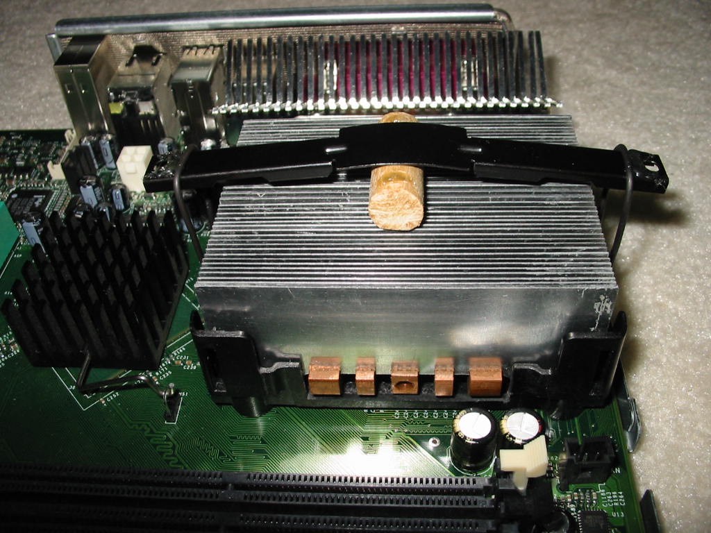

    Good think you can't see the underside. I had quite a bit of a struggle with just my 35W Radio Shack iron. In fact, if it wans't for the heatgun and the flux, I wouldn't have been able to do it.
    After seeing that the board worked, I decided that when I have time some day, I will modify a case so that I can make this my daily-use computer. Of course given that I didn't have the original GX270 CPU heatsink and that the retention mechanisms from other P4 did not fit meant i had to come up with a way to hold a standard P4 heatsink in a non-standard GX270 retention mechanism.
    After playing around with various hardware for a few hours, this is what I came up with:
    https://www.badcaps.net/forum/attach...1&d=1334645782
    Yup, it's totally , but it works just fine. Flipping and moving the board around doesn't make the heatsink move at all. The rubber band that holds the fan also happens to dampen the vibrations from it, so the fan is a lot more quiet.
    Here's another close-up of how the heatsink is held in place:
    pic 4

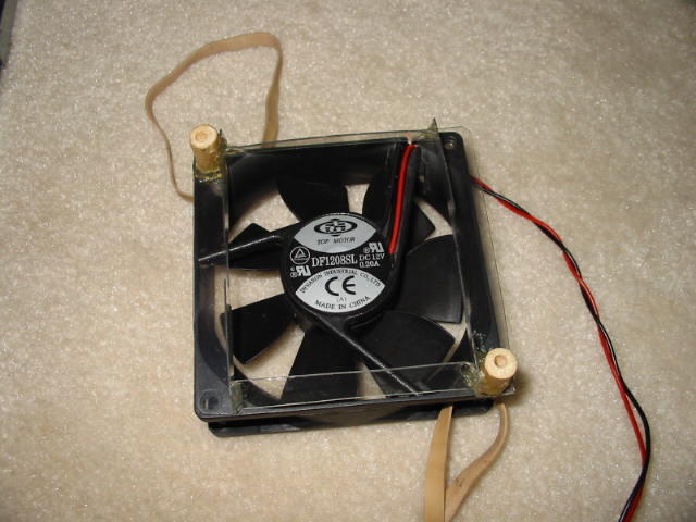

    Basically, the hardest part about this mod was to think of what to use to hold down the heatsink. Having lots of random hardware laying around is very useful. I'm not sure what that metal spring piece came from, but it's what made this mod possible. It's balanced on that piece of wood so that it inserts a force at the center of the heatsink and it's held by thick steel wire down to the plastic heatsink retention/holder.
    And here's all of the hardware (minus the plastic wind-deflector piece on the fan):
    As you can see, very simple (unlike the initial plans I had). I can actually install/uninstall the heatsink faster than a regular heatsink.

                              Didn't work with the one I had, so I had to cut the original GX270 bracket a bit. Once that was done, a standard P4 heat sink I had fit perfectly.
                              And even if a standard bracket did fit, I wouldn't think it's a good idea to have the caps being put under constant pressure on one side. Could probably ruin the seals over time and make the caps dry. Besides, I definitely wouldn't want eletrolyte to spill. That rotten fish smell is very unpleasant .
                              Also, I forgot to mention, but I also trimmed the MOSFETs' heat sink a bit because it too was exerting some force on the VRM high-side caps. Now it fits like a glove.
