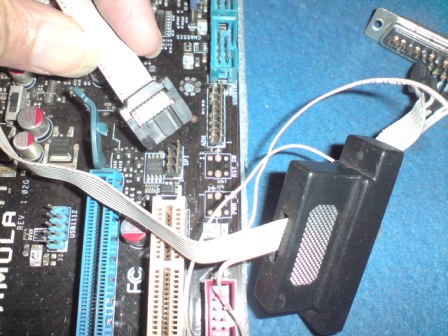

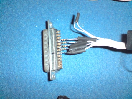

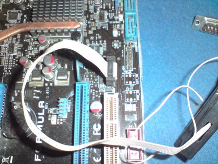

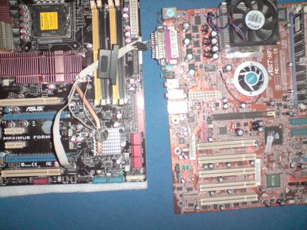

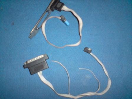

          hi.. looks like the bios is borked ..no beep ..no sign ..just spin of fan
          i succesfully managed to bring back maximus formula motherboard that suffer from dead bios ..just fan spinning ..no beep
          i flashed the bios through SPI header on motherboard using diy spi flasher (from parallel/lpt port to spi header) ...read ..identify ..unlock ..erase ..program
          finally maximus formula got back again ..alive as normal board ..
          so ..if you have SPI header on that mobo ..do it for experience
          here is my simple spi programmer ..based on the site you linked
          part list :
          - parallel to serial idc 10pin
          - 4x 120/150/270ohm resistor 0.25w/0.5w
          - cwsdpmi (program need to run spipgm2)
          - spipgm2.exe
          - motherboard with parallel port ( use old trusted abit nf7-s)
