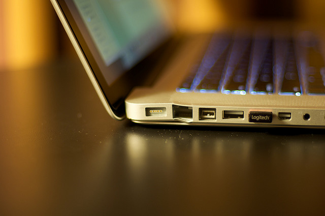

    As the title states, that's the problem I'm trying to fix. My friend dropped her Macbook Pro onto the floor while cleaning up. It was off at the time so the HDD is all good. Nothing wrong with it and works really well without a hitch... except there's a dent on the side. She wants it fixed... I think it can be fixed too, it's just a simple bend so I think a rubber mallet and a vice can straiten this back out again. Only problem... where are the service manuals for a Macbook Pro? I've worked on numerous laptops, but never a mac :S
    And this is the bend...

    I doubt there is a service manual... and if there was, it would say "buy a new mac".
    yeah, i'd carefully use a rubber mallet.

      im more concerned about cracking that aluminium whilst bending it back :S

              Hi,I doubt that will work,if it doesn't,get another base on eBay and Ifixit is indeed your friend.

                    I looked at AppleCare for a neighbor's kid going off to college. Basically covers everything -EXCEPT- physical damage caused by drops, falls, kicks, etc.
                    For that, she would have to spend money on an extended warranty that offers Physical Damage Protection as an add-on. Square Trade is one and there are others out there. BUT, she would of had to buy that within 30 days of purchase.
                    So, if no extra warranty protection exists, she's up the creek without a paddle, so to speak.
                    If it works, I'd leave it alone. All you need to have happen is while trying to bend it back, have something go *snap* and it's all over.
                    I'm sure Apple would fix it, but I'd bet it's several hundred dollars to do so. Just the labor alone to get all the guts out and into a new case...

                      Take some dry ice and that should snap it back into it's original form.
                      or
                      Take some small C-clamps and cut a piece of wood to fit in the hole and press it back into it's original form. Might take some time to do it. Slow and easy.

                        I think I'll try my best to bend this stupid thing back without having to take everything apart.
