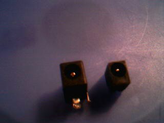

    ok this is hard to explain but i shall try...
    My laptops DC-IN Port broke, and fell right out of the laptop! It's in two peices, I can't figure out how the DC-IN port connected to the MB before...
    It looks like it would only have two legs. DC-IN ports can have only two legs?
    I have a few 3 leg DC-IN ports, but there totally different. The DC-In came from an old winbook XL2 laptop, has anyone replaced a 2 pin/leg DC-IN or seen one?
    I would like to get some pictures of what these 2 pinners look like so i can attempt a repair. i will post some pics, and maybe someone can help me put humpty dumpty back togather again?

    Re: DC-IN Port, 2 pins/legs help!
    Well, DC is only positive and negative so that is pretty logical isn't it? ;-)
    Post a pic of how it looks (now)
      Typically there is 3 legs, one on the right and left thats negative ( I guess just for stabilty). 1 down the back for positive. I would guess if you just had 1 negative it would still work, never tried though.
        TY thats what i was thinking!
        but the prob is it seems like it should only have 2 legs, because of the MB, but 3 by the DC-IN port. anyway here are the pics. The one on the right is the broken one. left is the 3 leg im used to. I'm sure you can see were i was having probs...
        Thanks im sure i can fix it now, well if i can get this winbook open enough to solder. Anyone work on a winbook XL2? <-That maybe a different post.

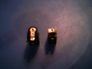

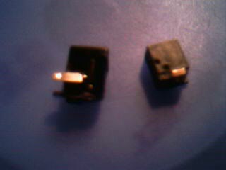

          BTW the 2 pin DC-in is in the same position as the 3 pin. (Pictures.)
          anyone know were I can buy DC-IN ports? Pics a big plus..
              thanks for the URL! Well i put the DC back togather, the winbook XL2 got power, well LEDS were on etc... no HD movement no post, DVD rom wouldn't open. It's a start!
              Thanks again guys!
              PS: that was with one negative connected... The DC was/is so broke i had to use short wire to connect it to the board. I'll work on it somemore and let ya guys know how it comes out!
                  Cut off the power cable and solder it directly to the mobo; that is a pro fix
                    hehe I didn't think of that. I'm to close to the project! Then again if this laptop doesn't work maybe i can off the parts on e-bay, dont know if cutting the DC would be smart. I'm hoping it's just the darn DC and not something else.
                    no post is not a good sign... I just wanna get this thing fixed for an older man that can't afford a computer. thanks for the urls KC8ADU! i found this http://www.laptopking.com/partpictur...ategory=dcjack it seems the darn thing is 3 pins..
