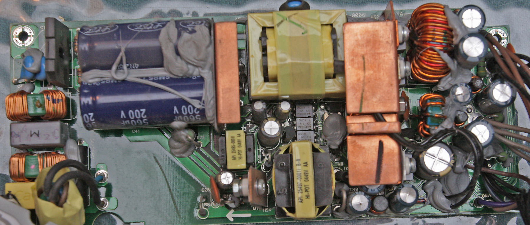

    For some unknown reason I decided I'd like to learn a bit about Macs.
    I haven't touched a Mac since the Mac Classic back in the 80s.
    So I aquired 2 iMacs this week.
    #1 iMac G5 I got from a car dealership, they say it was displaying pictures all day every day, then died.
    I disassembled it. Looks clean, and the motherboard has lots of beautiful flat-topped Rubycons.
    The power supply is another story. Full of crappy bloated Elite and Ltec caps.
    So I'm starting with the power supply. Have replaced a few caps, including the one under the heatsink. Managed to get it out, and another in without removing the heatsink, which has about 6 TO-220 devices on it.
    THere's friggin glue on almost every cap, and some of the through-holes have been a pita to desolder.
    A few of the values I don't have in stock, so will be ordering some caps.
    The 1000 uF @35v is a pita, I have both Panny FM and FC in stock. The FM is too tall, the FC is too fat
    Will report more this weekend.

            >>The 1000 uF @35v is a pita, I have both Panny FM and FC in stock. The FM is too tall, the FC is too fat <<
            You must have the 50v FM and the 16x20mm FC.
            Both 35v FM & FC come in 12.5x25mm.
            You can fit up to 30mm high caps in these.
            The coil on the output side looks good (unburnt), so it should be a simple *ahem* recap to get flying.
            >>the motherboard has lots of beautiful flat-topped Rubycons<<
            That may or may not last. It depends how much crap they had to deal with from the PSU. I've seen Ruby's blown in these from the heat.
            Good Luck!
              My mistake. I thought it was too high as it was above the heatsink, but it's the same height as another cap.
              Oh, iMac #1 is alive!
              I finished the PS recap, and removed the 2 256mb DIMMS and popped in 2 1GB sticks. assembled it, and pushed the button.
              It fired up nicely. Now to figure out how to drive it.
