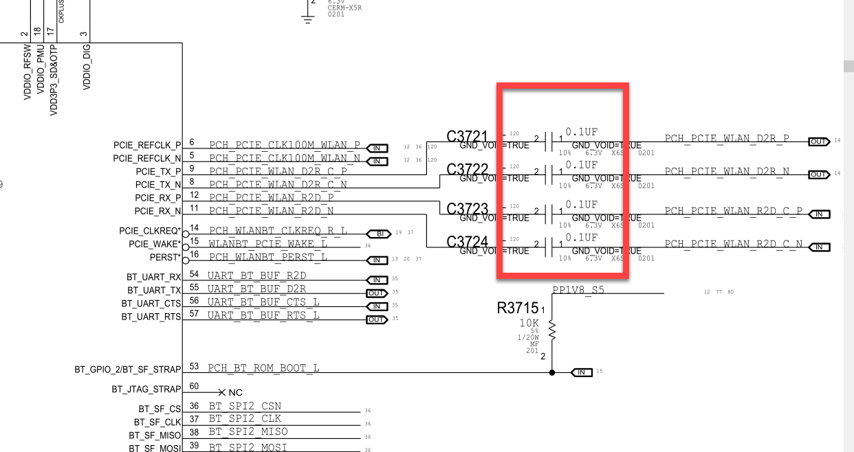

    Working on an 820-01700 board that has no WiFi (WiFi equipment detected, but when I click to turn WiFi on/off, the OS doesn’t do anything—doesn’t turn on or off, never shows WiFi networks, etc), no Bluetooth (missing completely) and no iSight (“no camera detected” and “no capture devices” in system information). Figured an issue with the 3v3/5v supply as with older boards, so swapped it just in case as I’ve seen odd issues even with all enables present. Still no dice.
    Everything else works fine, including an external drive that I copied data over to without issues. Just no WiFi/BT or iSight. Tested with 2 known-good units/LCDs etc. Also, I can NOT get the unit to PRAM reset, but wasn’t sure if maybe some funky T2/etc issue might be conflating that.
    Unit had liquid to top-case that was cause of no-power, but replaced without issue. Liquid to keyboard/tpad might be related. Board did have VERY minor liquid, but it didn’t touch anything at all (literally no components, just minor residue). Keyboard/tpad took brunt of the damage.
    Any input or recommendations on where to start? Trying to avoid wiping board and reflashing T2 if at all possible.
    Thank you in advance!

      Re: 820-01700 A2141 No WiFi, BT or iSight
      WIFI on this logic board is a PCIe device.
      Confirm the attached referenced caps are present for the PCIe interconnect.
        Thanks, mon2!
        I had more time to sit down with the board today, and made some progress. I did first confirm all of the caps for PCIe are in-tact and undamaged.
        Eventually found PP3V3_G3S_X shorted to ground completely; removed everything on the rail before finally splitting the connection for PP3V3_G3S_X-->PP3V3_G3S_WLAN @ R5530. Once I did this, short went away. Of course with PP3V3_G3S_X being pulled low, that means our RTC signals (for cam, BT, etc) can be all screwed up.
        Starting to suspect U3730, I found P1V2_WLANBT_VLX also shorted to ground completely. Not much on that line, so pulled everything except U3730, which I'll do next.
        I had a question about U3730, however: Is this chip programmed at all? I have several 820-00850/01041 boards but only ONE 01700 parts board. So, I can pull U3730 from the 01700 board of course, but wanted to check if U3720 had programming in case I damaged that single 01700 U3730, or if I had "several chances" with my other 00850/01041 boards. Does this make sense?
        I'll go ahead and get U3730 pulled now to confirm it resolves the shorts. Will then put everything back before replacing U3730. If there's no programming on U3730, I'd rather pull it from an 00850 because it will be easier.
