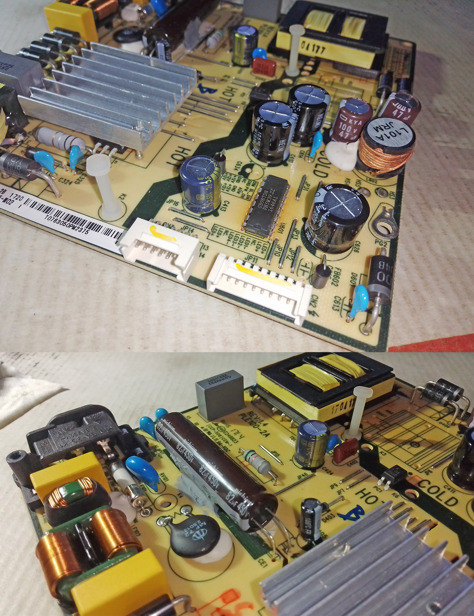

damn. I'm disappointed these high quality caps made my power supply worse
  • link626
    • Feb 2019
    • 36
    I thought my tv power supply was stable. It's been stable for a few weeks since I swapped in nichicon, united cc, panasonic caps to replace the cheap china caps.
    But today it caused my tv to have a flickering spasm again.
    what a letdown.
    I swapped back my backup power board which has cheap china caps, and the tv backlight stopped flickering.
    Sometimes these high quality caps just don't make things better.

    Re: damn. I'm disappointed these high quality caps made my power supply worse
    what a letdown.
    Three items:
    1. Capacitors aren't the only thing that fail in PSUs. Trasistors and MOSFETs like to blow up as well!
    2. Did you get legit caps? If you got them on eBay or alibaba/aliexpress, then they very well may be fakes.
    3. Were they the right caps? The ESR has to be close, the voltage rating high enough (more is fine, less isn't unless you're sure the rail won't go too high), and the temp. rating high enough (in a TV, I would go for 105C or higher, 85C will burn/blow from the heat!). Just matching size and capacitance isn't enough.
    This all assumes the recap went well and the soldering was good... if the joints failed or something got overheated from a really rough install, all bets are off.
      soldering was good.
      legit caps bought from mouser.
      all 105C rated, exact same capac and voltage specs as the original china caps.
      most of these new caps are low ESR, but I'm not sure if the original china caps were low ESR. I'm guessing the chinas were general purpose.
      I'm gonna swap back the cheap china caps and see if the flickering goes away.
      With the china caps, the original board did not cause backlight flicker.
        Did you take ripple into effect, not just ESR?
        Also, PSU caps don't need to be low ESR. Low ESR tends to be used for things like motherboard PSU's. If your ESR is too low, that can cause problems. Switching PSU's won't operate right without the esr and especially ripple being within a certain amount as the original caps (though the temp being higher is always better)
            Originally posted by sam_sam_sam
            Can you please tell us what series of capacitors did you use
            how do I account for ripple?
            I didn't intentionally buy low ESR caps. They were just the only ones available of the same dimensions as the old caps.
            These were the caps I bought...
            Mfr. #: EKYA101ELL470MJC5S
            UCC 100V 47uF 480mA ripple
            Mfr. #: UHE1E681MHD6TO
            nichicon 680uF 25 Volts 1400mA ripple
            Mfr. #: EEU-FR1H100B
            panasonic 50VDC 10uF 250mA ripple
            Mfr. #: UPZ2W820MNY9
            nichicon 450V 82uF 730mArms 730mA ripple
            Mfr. #: URY2C330MHD1TO
            nichicon 33uF 160V 130mA ripple
            Mfr. #: EEU-FC1H101B
            panasonic 100uF 50volts AEC-Q200 615mA ripple
                      what a letdown.
                      Backlight flicker isn't regularly caused by bad capacitors... and much less if they weren't bad to begin with.
                      You need to do more troubleshooting on your end. Shottgunning parts (swapping without having identified which components are failed) is not the best way to troubleshoot (though in some situations, it does make sense.)
                      As for the discussion regarding the replacement caps not having "proper" ripple current specs or generally made for PSUs - that's irrelevant to the problem here. If the original HEC caps were truly failed and the cause of the problem, then any GP (general purpose) cap replacement would have at least gotten the set to work fine, and certainly for more than just a few weeks.
                      So again, I highly suspect the issue with the backlight flicker here isn't related to the caps at all and O/P should check the backlight system of the TV. If it's an LED-backlit TV, check for open/shorted or just plain-intermittend LEDs in the backlights (well, that's certainly easier being said than done. ) A bench PSU with high enough voltage and variable current output would be the best way to check the strips. The LED driver circuit could also have components that are bad or drifted out of tolerance. If it's a CCFL backlit TV, one or more of the CCFLs may just be approaching its EOL. Or it could be that there is a bad solder joint somewhere. A few good pictures of the bottom side of the PCBs may help spot those.
                      Other than that, good job with the recap. The replacement caps you picked are actually suitable for PSU use.
                      Now, if the TV runs really hot, more special caps may be needed... but that's unlikely to be the case.
                        I have another power board with original HEC caps that I swapped in
                        and the backlight does not flicker at all right now.
                        so my conclusion is the backlight is fine.
                        Even the original powerboard would not flicker like this before I replaced the caps.
                        That's why I'm thinking something is wrong with the combo of new nichicon/chemicon/pana caps I put in.
                        The new caps also caused the transformer to make buzzing noises it didn't used to have
                          I still wouldn't conclude that.
                          Consider this: every time you take out / swap the power supply, you're also moving around connectors and parts inside the TV. A bad solder joint or connector could easily cause this kind of intermittent problem to make one board seem good and the other one not.
                          I'd give it more time and use before concluding that. Also, consider the ambient temperatures in the room too. Now that Fall is coming and we get cooler weather, this too can affect any intermittent joints and connections.
                          Re-check your soldering then, along with the entire rest of the board that you worked on for possible solder joint damage from handling on other parts.
                          The cap series you used are overall quite normal for PSU use. Probably only the 100V 47 uF UCC KYA and the 33 uF 160V Nichicon RY may not be the best choices when it comes to low ESR caps, as those two aren't exactly low-ESR. But Panasonic FC and Nichicon HE are fine for PSU use. FR, FS, and FM I would say it depends on the PSU - most will work fine with them, but I have found there are PSUs that would become louder / whine after recapping with FR/FS/FM. So I don't usually recommend those, though they should work in pretty much all cases (and I personally have not seen a PSU that hasn't.)
                          As for Nichicon PZ - that's not low-ESR... but that's your input bulk cap, and it's standard for those not to be low-ESR. In fact, PZ is just a smaller version of the PT series, and the PT series is what the PlayStation 3 uses in their power supplies on the primary side (i.e. same application as in your PSU.)
                          So if you do suspect any problem with the caps, you can test your theory by swapping caps between PSUs and seeing if the problem follows. If not, then it's not the caps. On that note, if you do decide to swap caps around, try starting with the Panasonic FR first, then the UCC KYA and Nichicon RY.
