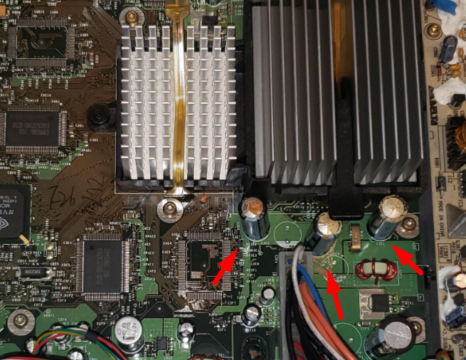

    Anyone have a recommendation for a 3300uf 6.3v cap for an original XBOX?

    just use panasonic FR 3300uF 6.3v 10x25mm caps. the vrm design doesnt look like it uses a high switching frequency so esr is not that important. better to keep capacitance the same.

      The inductor core looks like Micrometals Type 52. I'd guess the switch frequency is around 200KHz. Also, the original Xbox, IIRC, is a late 90s design, so ultra low impedance types probably would not have been used. Panasonic FR or FM look like good choices; from Nichicon, maybe HE or PA; from Chemicon, maybe KY or KZE; from Rubycon, maybe ZL.

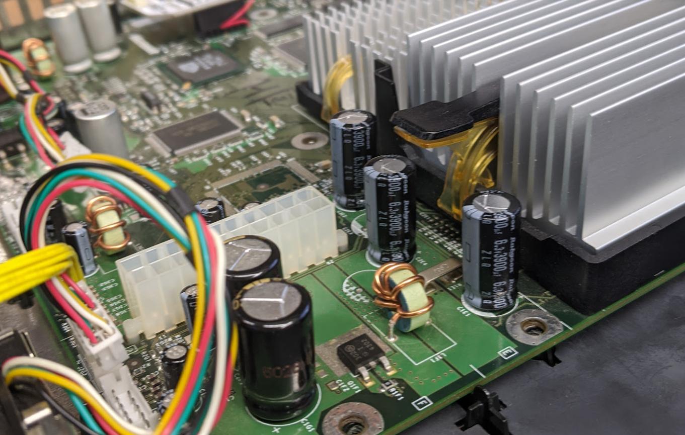

        Here are some I've been looking at.
        https://www.digikey.com/product-deta...1475-ND/589216
        https://www.digikey.com/product-deta...1493-ND/756009
        https://www.digikey.com/product-deta...085-ND/3563770
        Needs to be 5mm lead spacing and no taller than 20mm, width can vary.

                      the first two u picked are too fat and may not fit as there are a couple of spots on the pcb where the caps are side by side and there may not be enough clearance to fit 12.5mm diameter caps in there.
                      the last one has too low ripple current handling and too high esr and is more meant for general purpose rather than low-esr applications.
                      so since it cant be taller than 20mm so it may interfere with the cpu heatsink clips, u can try panasonic fs 3300uF 6.3v 10x20mm caps instead.

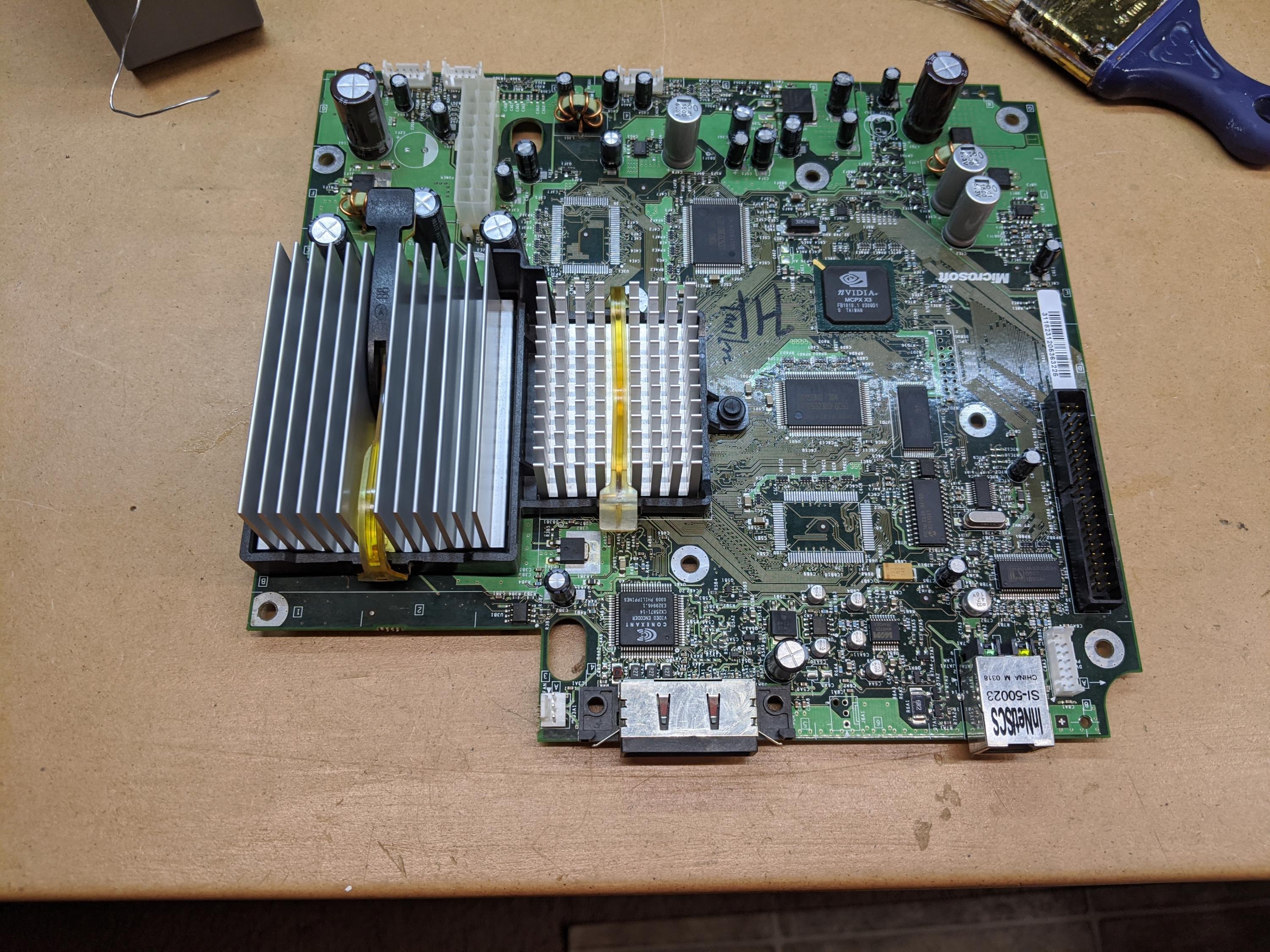

                              Nothing bulging on this V1.3 board and clock cap already removed. Would you proactively replace anything on this board?

                                the cpu caps will fail at some point.
                                other than that, i'd leave it till it fails - then change all the smaller ones
                                  Yes.
                                  Replace all Nichicon HM and HN series caps with H01xx, H02xx, H03xx, and H04xx date codes. These WILL go bad, if not already (sometimes they don't bulge/leak, as I found out on an Intel 845 board that kept crashing with normal-looking HM caps, but they tested quite out-of-spec once removed.) No point to wait for them to fail. If you have the caps in stock, and since you already have the board out, just replace them.

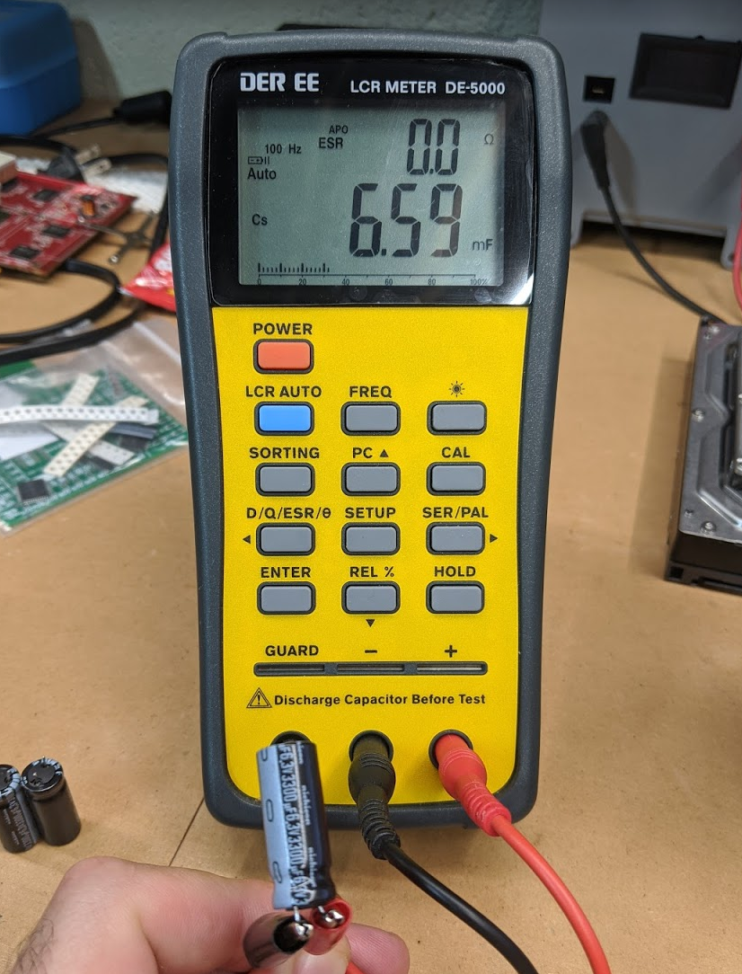

                                    Just replaced them. What is going on with the old caps. All three old 3300uf Nichicon HM caps are reading almost triple their stated value???
                                    One was 7500uf, one was 8900uf, and one was 9000uf. I tested with 2 different meters.

                                      ^ That's completely normal... for BAD/FAILED/FAILING Nichicon HM and HN caps, anyways.
                                      What you are seeing is high leakage current - a.k.a. the capacitor is loosing charge between [+] and [-] plates as if there is a small-value resistor placed in parallel with the cap. This leakage current is essentially fooling your meters into thinking the caps have larger capacity - which they don't!
                                      This is why there is also a tolerance specified on the capacitance... and for electrolytics, this is typically 20%. So a 3300 uF cap can read as low as 2650 uF or as high as 3960 uF and still be considered in-spec.
                                      My advice, however - at least for ultra-low grade electrolytic capacitors - is to be wary of them if they jump more than 15% high in capacitance. If they are at or close to 20% higher capacitance than printed on sleeve, they are probably EOL or nearly there and should be replaced.
                                      This is why I suggested you change these caps, even if they didn't look bad. Nichicon HM and HN with H01xx, H02xx, H03xx, and H04xx date codes are known to go bad like this. In addition, some HM, HN, and HZ series with H05xx date codes (particularly 6.3V -rated caps) have had problems too. United Chemicon KZG and KZJ series, along with Sanyo WF usually fail in the same way. All of these are ultra-low ESR motherboard-grade capacitors.
                                      It's not that all ultra-low ESR motherboard-grade capacitors have these problems, but the ones listed above often do. So if you see these anytime, always check them.

                                        Thanks for clearing that up. I was baffled. When I saw the low ESR rating, I thought I replaced them for nothing. I feel better now. I actually replaced 4 caps in total tonight. I plan on doing more or less all of the electrolytic's when I have more time. Here is what I replaced tonight...
                                        The three 3300uf HM's got replaced with 3900uf Rubycon ZLQ's and the larger 3300uf 10v cap got replaced with two Panasonic 2200uf 10v FM or FC I forget.
