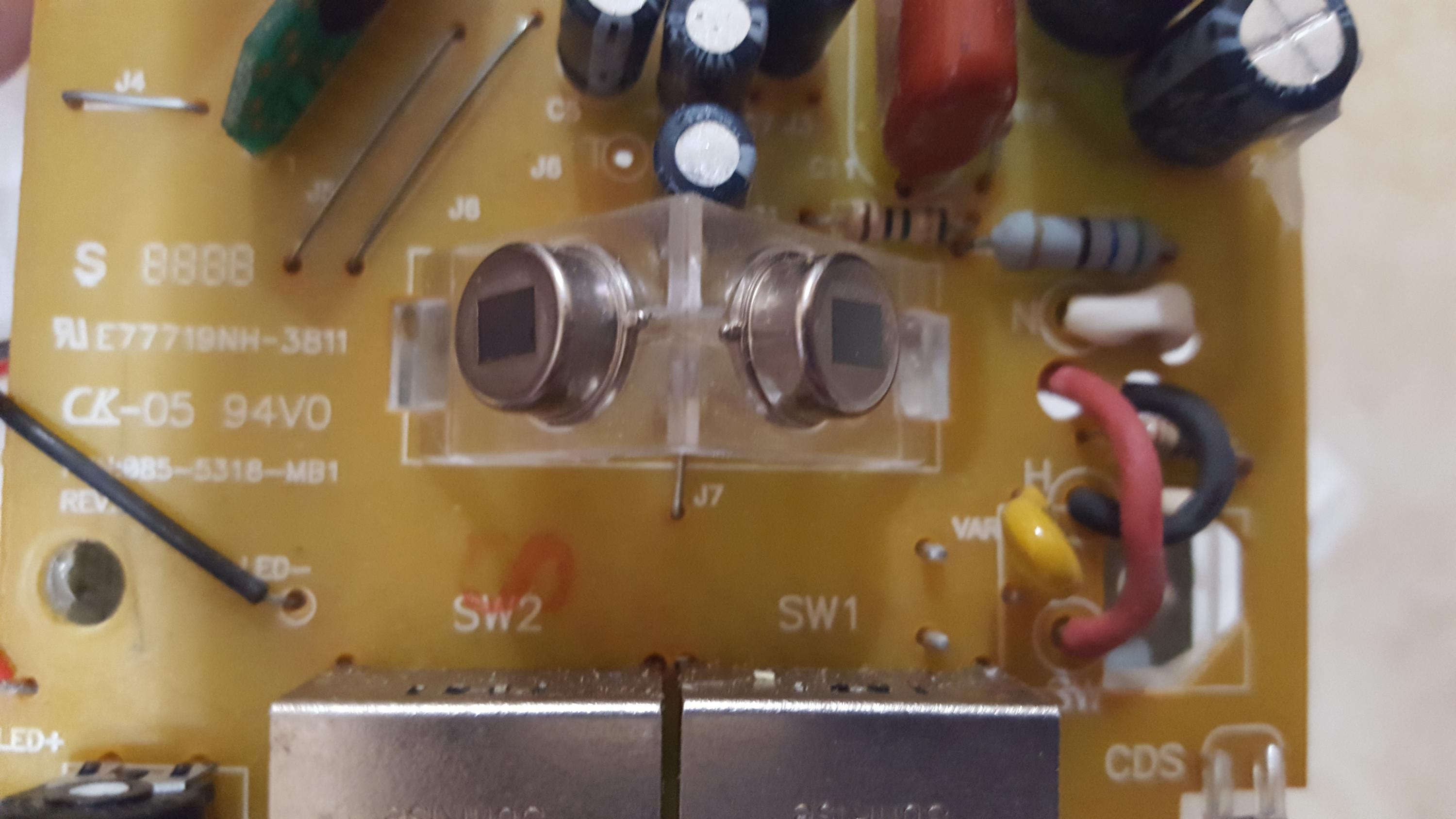

    I have the following ceramic capacitor that I would like to identify. I need to purchase another one like it or an equivalent. Here is the text on the capacitor:

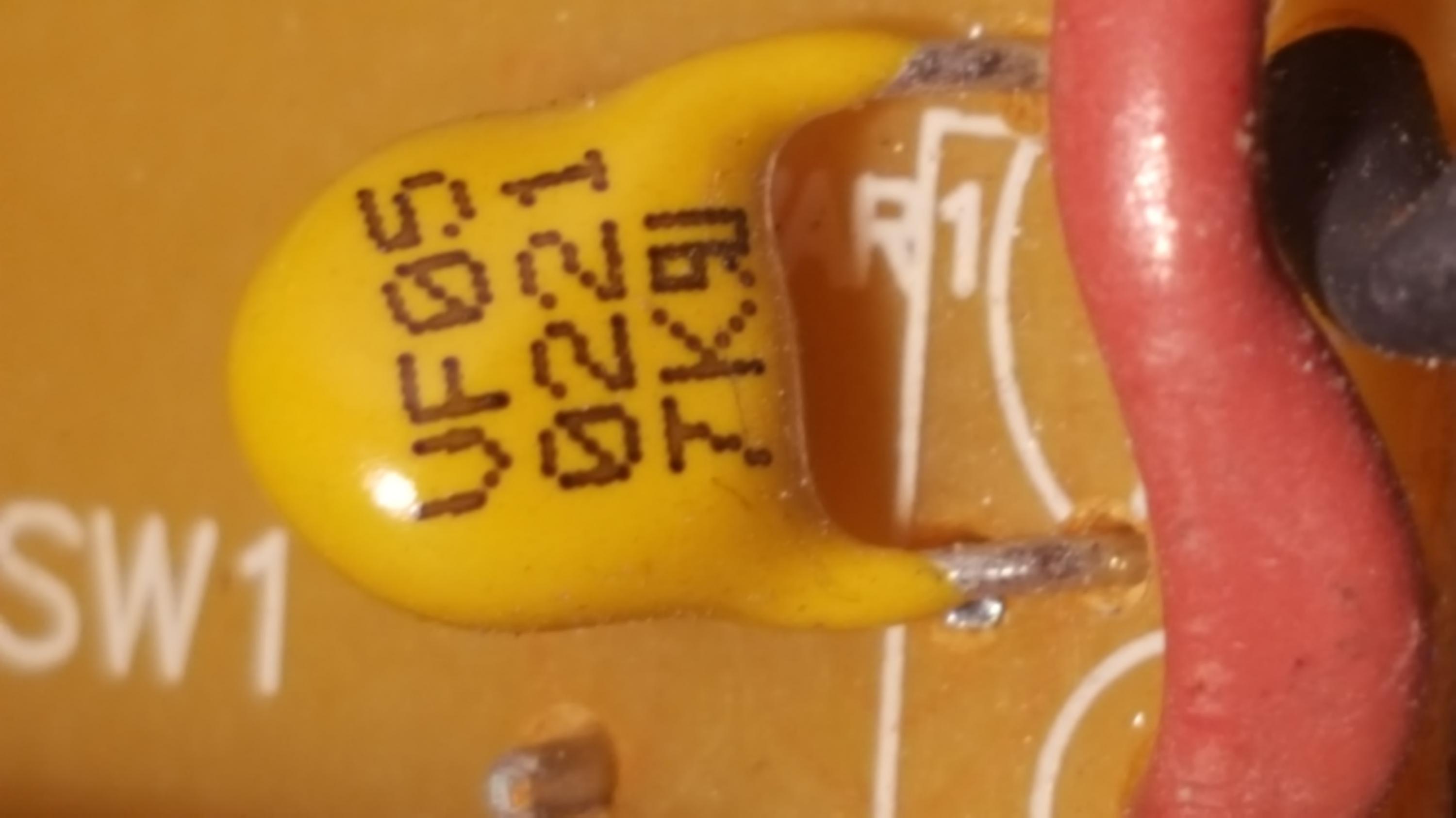

    Capacitor is Yellow in color. It has three lines of writing:
    VF05
    0221
    TK RU (RU = Underwriter's Laboratories Logo)
    If anyone knows an equivalent on fleabay please let me know. Thank you I appreciate your help.

    something looks wrong, it may be a MOV not a cap
    post a photo

        It is MOV/Varistor (Designated as VAR1). 5D = 5 mm Dia., 221 = 220V
        http://www.xiaheonline.com/MOV-5D-Series.html
        Why do you think it is bad? It is not blown.
        What kind of device are you working on and what is it not doing?

          Thank you! It has no resistance and no capacitance. How do I test if it is working? Which would be the correct replacement on that link? It is on a light motion sensor.
            Re: Need help identifying Ceramic Capacitor
            There is nothing wrong with it, it will conduct when Voltage exceed the rating then it conducts into low resistance, the capacitance is really low in pF range. It is a protection device, it is not needed for the circuit to operate. Look some where else for problem as to why your device not working.

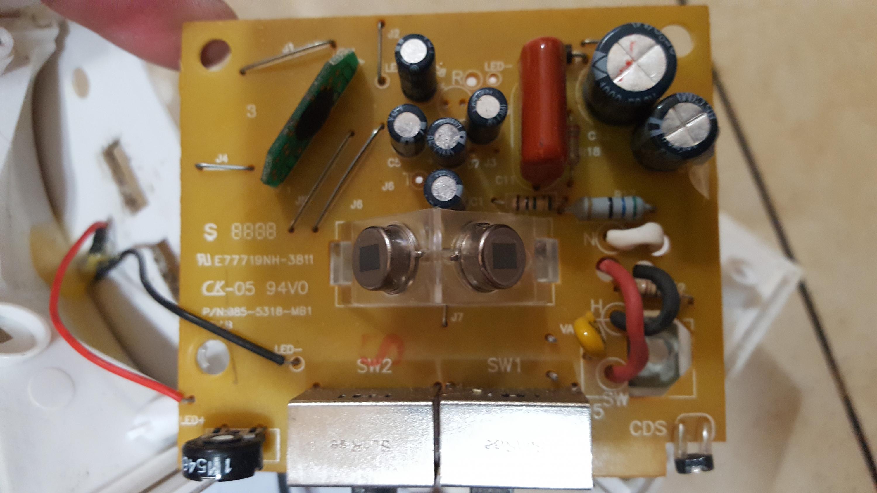

            If you want help troubleshooting, you need to up load good clear pictures of the whole top side and bottom side of the boards. What kind of testing have you done so far?

                  Looks like a motion detector board from a outdoor light. (Heath/Zenith SH-5597 or similar) If I'm wrong I know "someone" will say I'm wrong.

                    Sorry, the symptoms are that at night, the lights no longer come on. Yes, its a Heath/Zenith security/motion light.

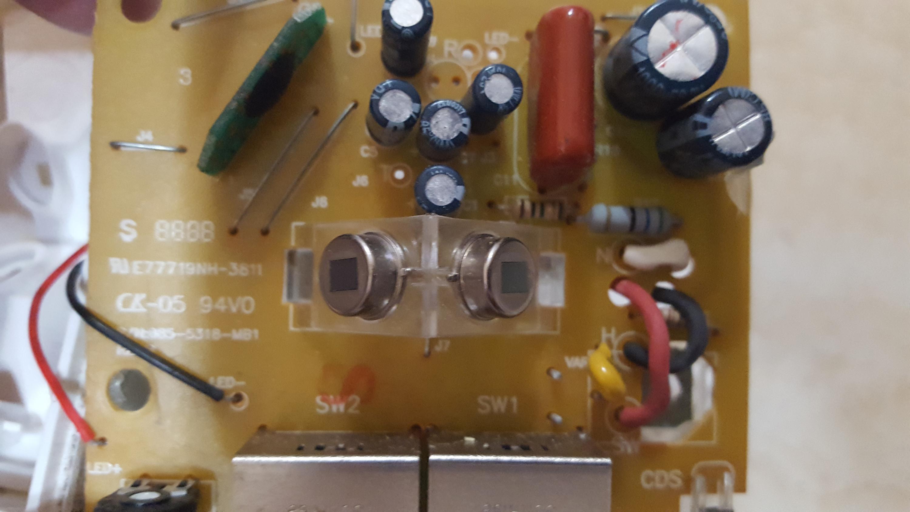

                        whats going on next to the red wire where it goes through a hole ?

                            Close! It says "SL-5318-A" on a sticker and on the metal plate it says "SL-5316-A".

                              That red wire is going through the hole to one of the two lights.
