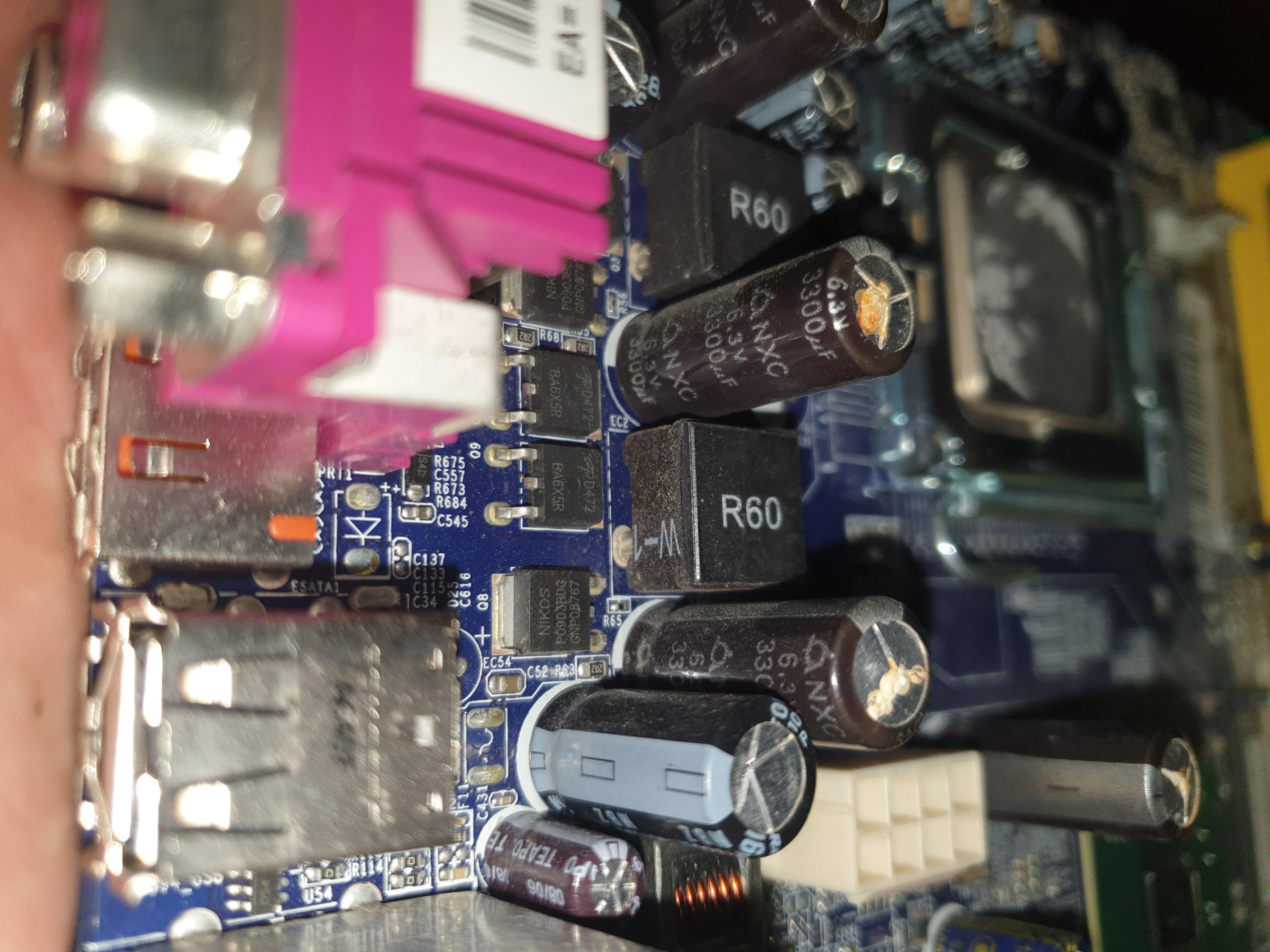

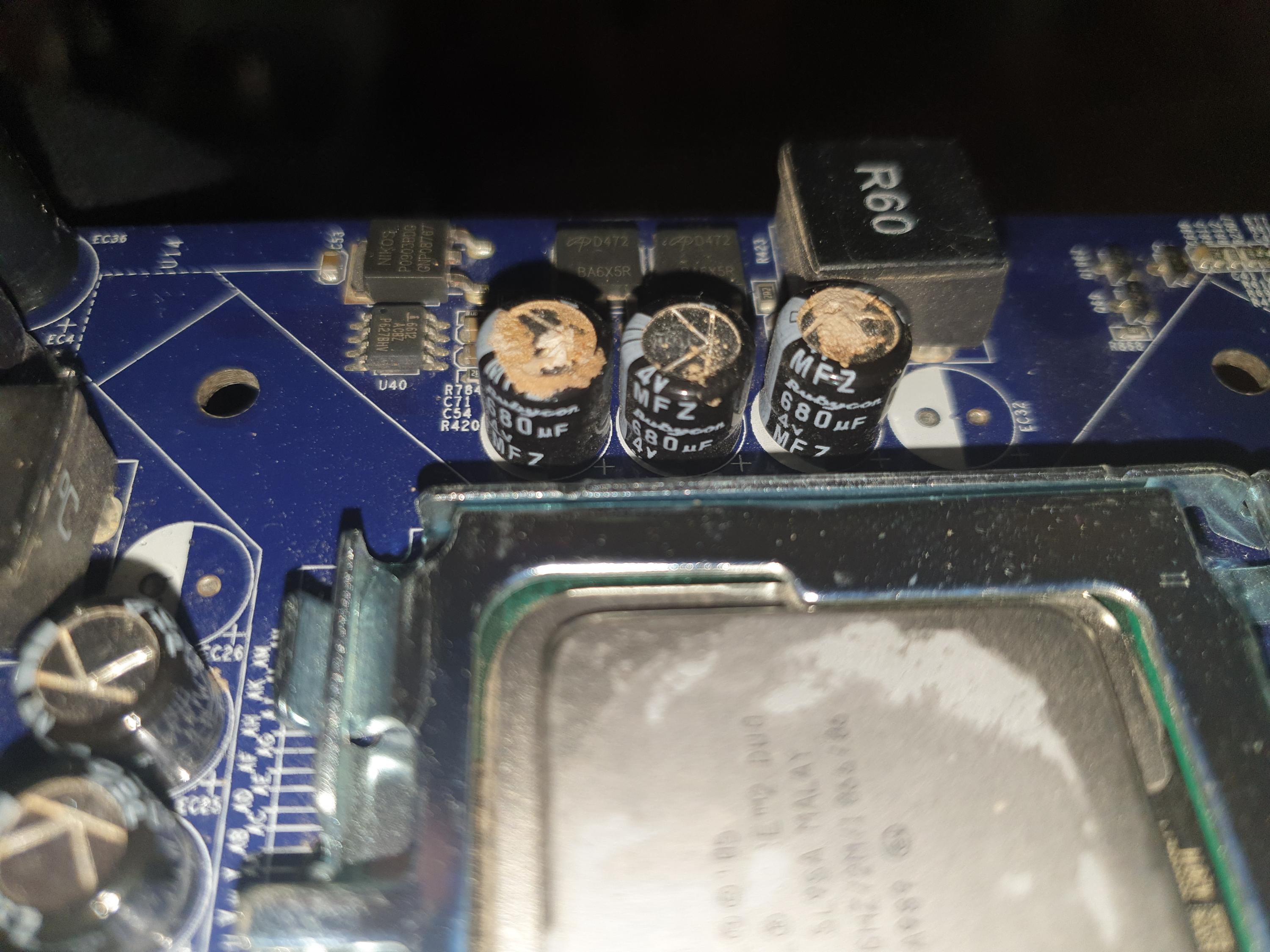

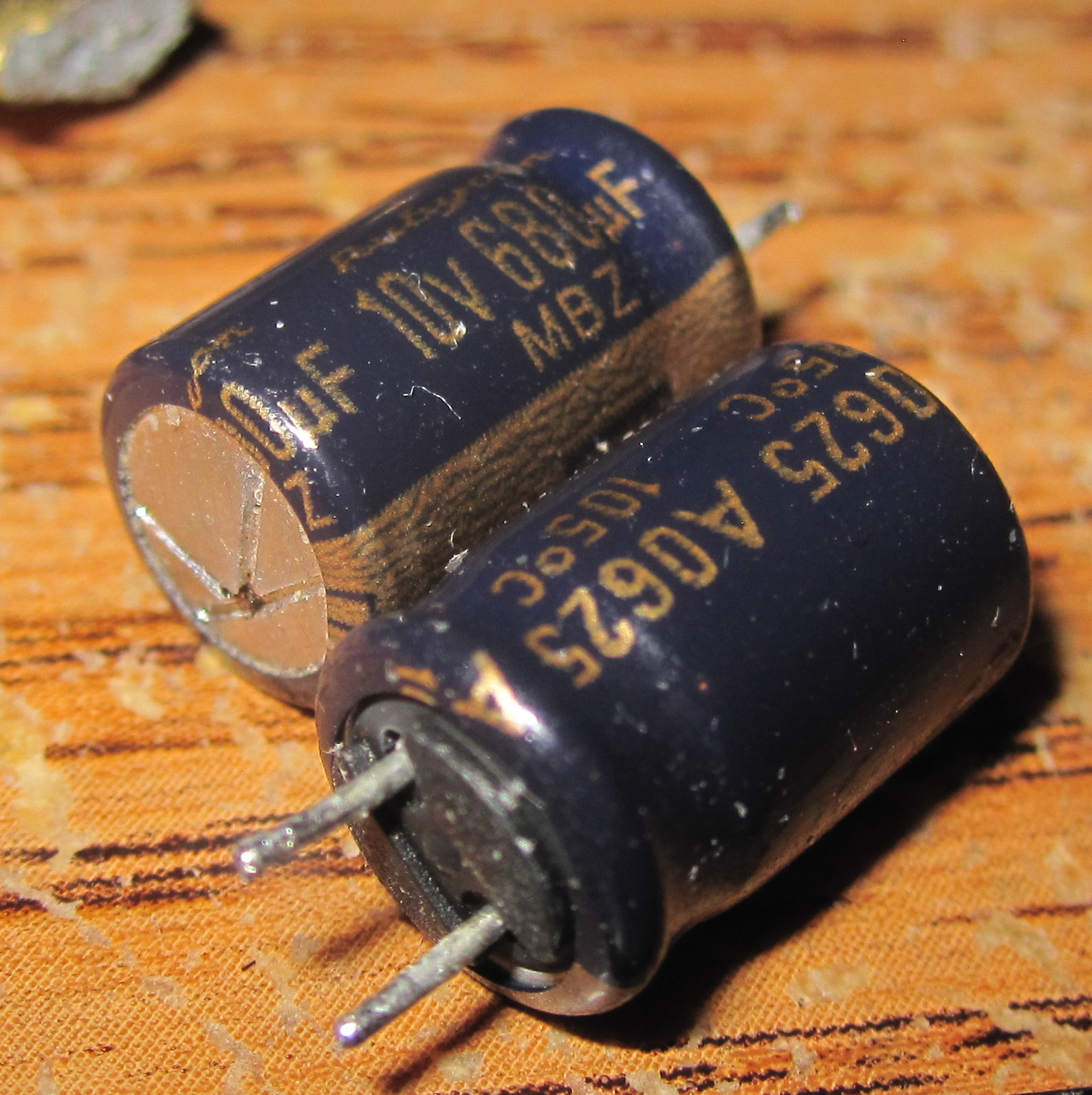

    I pulled these from my Foxconn board as I was seeing ridiculous ripple. After pulling them I find that their ESR was off the scale.
    As I didn't have any spares I ended up jury rig soldered capacitors that were too big for the allotted space, unfortunately it didn't solve the problem despite their horrid ESR.
    But this is most strange, are these fake? Surprised they went basically OC. Then again the area around these caps did get quite warm... plus probably 14 years old ...

    They look real to me. Classic K vent. Correct bottom bung.

      They are probably genuine.
      Rubycon MBZ does not like heat, well better said none of the high aqueous ultra low ESR models do.

        Ah okay, thanks. Assuming they are 105°C caps I'd think they could survive some heat. The stricken board has a lot of bad caps on them and I've been trying to find and replace the clearly bad caps and these stuck out. As replacing them didn't change the outcome (they were over 5Ω ESR), I'm at a loss what these capacitors were actually doing...
        There are a bunch of other caps that have also burst but as I don't have spares on hand I had to make the decision to replace the ones who aren't filtering properly first (by 'scope).

          14 years = 122,640 hours.
          Datasheet says
          https://cdn.badcaps-static.com/pdfs/...a384835b7e.pdf
          2000 hours for 105C.
          Or
          2000 hours at 105C
          4000 hours at 95C
          8000 hours at 85C
          16,000 hours at 75C
          32,000 hours at 65C
          64,000 hours at 55C
          128,000 hours at 45C
          MBZ might have lasted its lifetime depending on temperature of the motherboard.

              They look genuine to me as well.
              Board may have ran very hot if you have a lot of them bulging. Either that or the board sat too long on the shelf and the electrolyte at through the foil layer (on that note, 6.3V and 10V electrolytics tend to be more susceptible to that than their 16V siblings.) Or as retiredcaps suggested, maybe they reached the end of their service life.

                  Look genuine to me. They just wore out.

                    Actually it's a intel chipset graphics board, no dedicated GPU.
                    The board is a mishmash of different brands, these caps I don't know what it's connected to but they were close to the PLL. The chipset filter caps are a different set of caps that are also in bad shape but the waveform was not as bad as these. The CPU VRM caps have also burst, but probing with a scope they still look functional unlike these.
                    There are still a bunch that haven't burst, the only ones that have burst are the CPU (make a wild guess at brand... yep Nippon Chemi con KZG IIRC) and northbridge/chipset graphics chip VRM capacitors that burst (These...I believe were OST), and then these Rubycons. There are also some more caps on the CPU VRM but I don't recall what brand they were at the moment...
                    The OSTs were just simply dead just like these Rubycons. But the KZGs appear to still be doing their job despite popping. Probably not for long, but I wonder what I should do with this motherboard overall, I botched removing an OST and have jumper wires...
                    As for making the machine working again I decided to remove half of the memory - one pair of the 1G DIMMs - and the machine started working a lot better than before. Then I stuck in a pair of 512M DIMMs back, the machine appears to still be working and stable once more, unlike with just the Rubycon capacitor swap. Maybe it was just bad RAM even though the waveform at the capacitor is better than before?
