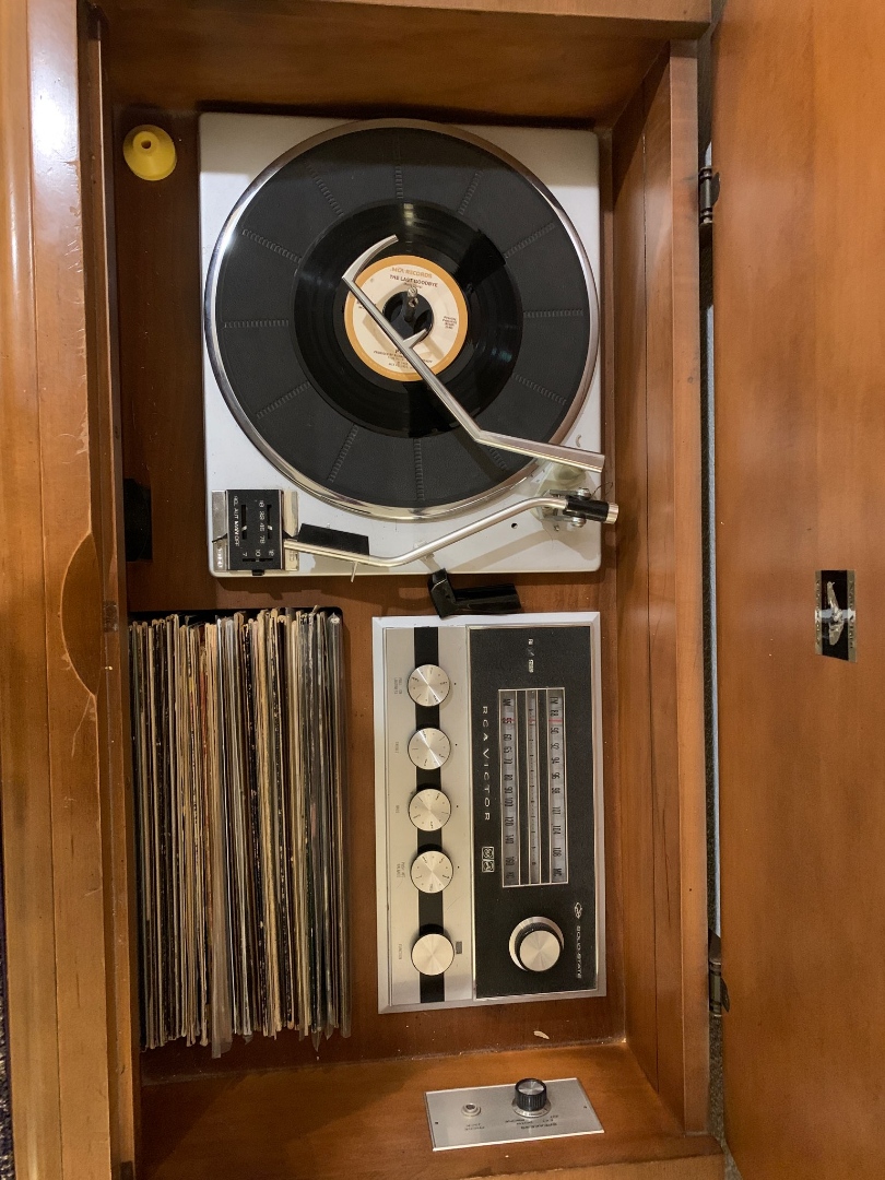

    Vintage 70's victrola
    customer of mine is thinking of buying it. Says it's been sitting in basement for years (arkansas, cool, damp). He says "it tries to turn on"
    so i'm thinking capacitors. I think we have one guy who is a master of these things? Any advise?
    interior pics supposedly coming

        Re: Vintage 70's victrola
        These stereos were built well, I doubt it is a cap issue, It uses a linear power supply and if the caps were bad you would here a loud hum, I would suspect oxidized switch contacts and controls.
          he says it hums when it is turned on
              I asked him if the hum changes with volume or changes when switching inputs, so we can narrow pre-amp, ground loop or PSU caps (I did a little reading)
                On older stuff like that, lytics & resistors....with lytics being the number 1 suspect....but over time, resistors will drift far out of spec and cause issues.
                      If it hums when he turns it on it will need the power supply cap(s) for sure. It may need others, If you do get it, and you have a scope, thats the best way to find the weak capacitors.
                      I would not be too concerned with the turntable at this point, it will need a complete going over, clean the idler wheel, remove, clean & re-oil motor bushings, clean and lube turntable platter bearing and shaft.
                      Looks like a RCA model: VHT-52W I worked on a many of these but not in a long time. (the caps were not that old then)
                            It's got FM stereo, RCA New Vista Victrola, Campobello model 1967 VTJ-61 chassis perhaps.
                            Have to look for the chassis number on the back and see if a schematic can be found. I think it would have germanium transistors and surely need re-capping.
                            They put out pretty good, I would add a stealth Bluetooth module for an aux. input or replacement for the phono input.
                            The turntable mechanical would be hardest to fix and a cartridge/needle might
                            be hard to find. I faintly remember they used idler-wheel drive, no belts.
                              Originally posted by redwire
                              ...it would have germanium transistors...
                              I'm ASSuming rather than simply short like modern silicon diodes/transistors (easy to diagnose), these would just become weak & leaky? I'm sure I've encountered these many many moons ago....but that's been many many moons ago...
                                  It must have some silicon in the tuner to pull off FM radio at 100MHz, but you're right it's easy enough to replace germanium transistors with silicon. The power amplifiers would need the bias circuit changed for the different voltage 0.3V vs 0.7V
