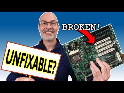

    I'm trying to troubleshoot a vintage Acer V58 motherboard, ALI chipset 1541/1543. Symptoms are: it's very dead.
    The CPU in question, a plain Pentium 200, it works on a different board. I have checked the voltages, the clock and the reset lines. All checks out.
    However I have ZERO activity on the CPU data/address lines. It's like the CPU is told NOT to start but I cannot figure out how. A post-card shows "--" and there is of course no activity on the BIOS address/data lines.
    I checked the HLDA (Hold Acknowledge) line which could indicate the CPU is told to wait - but no.
    Does anybody have any pointers for me to check?
    Thank you!

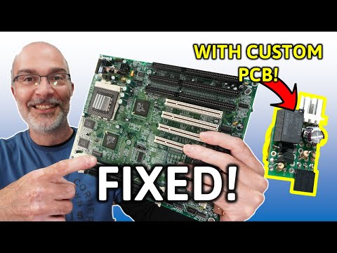

              I had forgotten I had a thread here on BadCaps about the Infamous V58!
              I've managed to fix this board - well fix... It's not really a fix!
              Made my usual videos 😊
              Part 1:
              Part 2:
