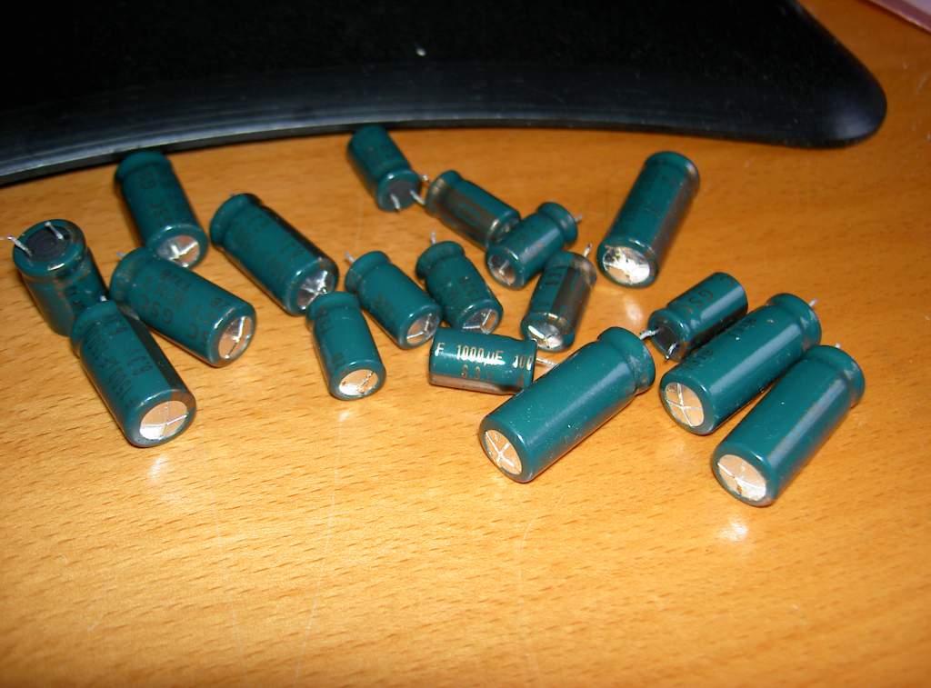

    Hi, I bought a Epox 8RDA+ for 5$ knowing it's cap's where bad...
    I've located replacement caps on elfa.se. They are Sanyo MV-WX types...
    However I was thinking of using Sanyo OS-CON caps instead, just for the heck of it ;-)
    But I need to know how many farads they should be... The caps on the board that I'm going to swap out are:
    2200uF 10v 4x (25x10mm)
    1500uF 6,3v 5x (1x 15x10, rest 21x10mm)
    1000uF 6,3v 9x (15x8mm)
    I found an old thread here on the forums where a GFX card manufacturer had chosen to use 360uF OS-CON caps in the place of normal 1000uF electrolytic caps (without modifying the rest of the cards components or PCB in any way)
    So does someone have some chart or description on how to interchange these cap types?

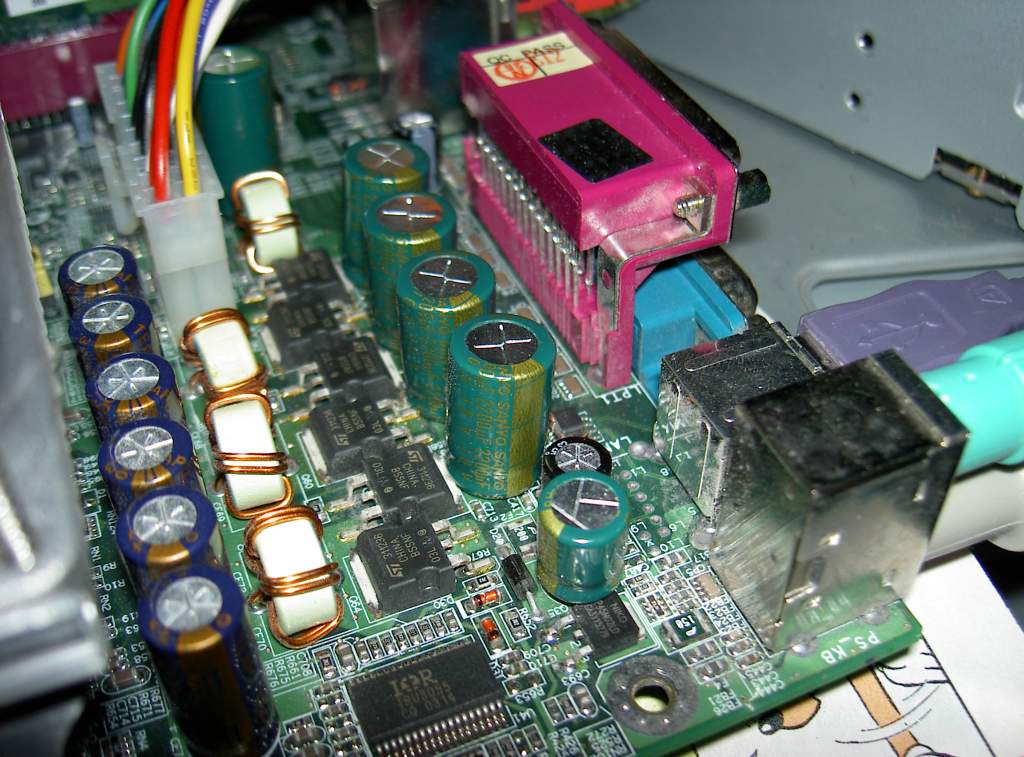

        Recapped the board yesterday, it's working perfectly fine now...
        Voltage on middle leg of CPU VRM's are 1,71v and 4,86v respectivley, on the filter caps it is 4,82-4,86v this is running 3DMark01 so stress on CPU is high... Since the voltage on the caps are fluctuating slightly but not the voltage on the VRM's I'm assuming the caps are doing their job now... I expect that had I done this measurement with the bad caps the voltage would have fluctuated on the VRM's?
        The coils and VRM's are below 60°C after hours of 3DMark looping, Memtest86+ passed 12 hours of tests...
        I'm running the CPU at 200x10,5 which should really stress this poor board with no fan on the northbridge...
        All in all I think this was a very successfull repair work.

          that row of teapo gonna get replaced also?
          i have heard the same for oscon, about 50% repacement uf value and same esr but never seen any application notes in that respect.
              you can change em now or wish you had later.
              teapo's can look good but be open.thats >20 ohms esr.
              had some ibm thin clients come in for lockup,no post,ect that were full of teapo's
              a few pokes with a scope probe told me they had to go.

                Regarding the TEAPO caps: I had no idea the caps could look fine but be dead...
                Unfortunantley I do not have a scope nor the knowledge to know what cheap scope would fit my needs of eBay... So I'm stuck with my multimeter...
                But I mean the GSC caps looked really crap, and these TEAPO caps looks perfectly fine... Plus my now almost 2 years old highly OC'ed and quiet (read very hot) Epox 8RDA3+ uses TEAPO caps for everything and they look fine to me...

                  Measured the voltage on the TEAPO caps and they where 1,71 volt not fluctuating, just like the VRM's...
                  BTW, at what microfarad rating can I expect caps to not bulge anymore, someone told me in another post 470uF and below, the black cap you see in the picture at the top is 470uF 16v TEAPO...
